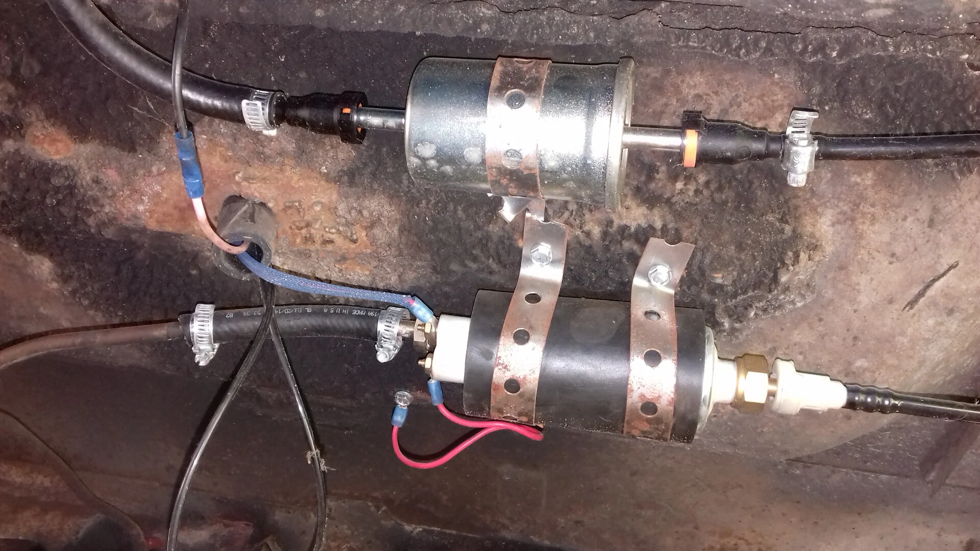

Goodies from Jegs today! My first shipment of hot rod parts in like...O, 30yrs!!! holy crap! I've got car parts mind you, but not for fun parts. My last parts were from P.A.W. Always with the big add in the magazines. Don't know if there still doin it or not. Not in any of my recent magazines.

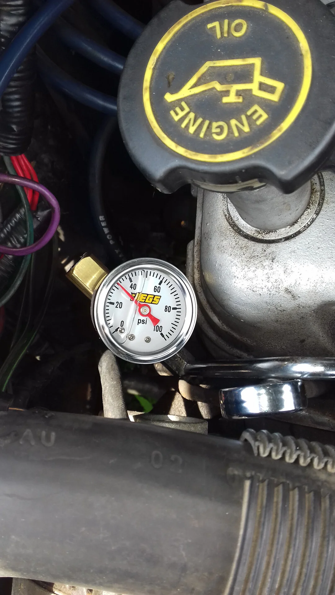

Fuel pressure gauge installed between thunderstorms, some real doozies too!. It shows the pressure running. It goes up to 38psi then rpm's go down. Then pressure drops, rpm's go up. Drops to 20 or so and repeat. Don't know what to think of that actually. And it does have a return line it is rubber fuel line and the feed line is 3/8 copper going to rubber then the injector line.

The return uses the vent for the gas tank. There is no vent. Maybe I should try running it without the cap on once.

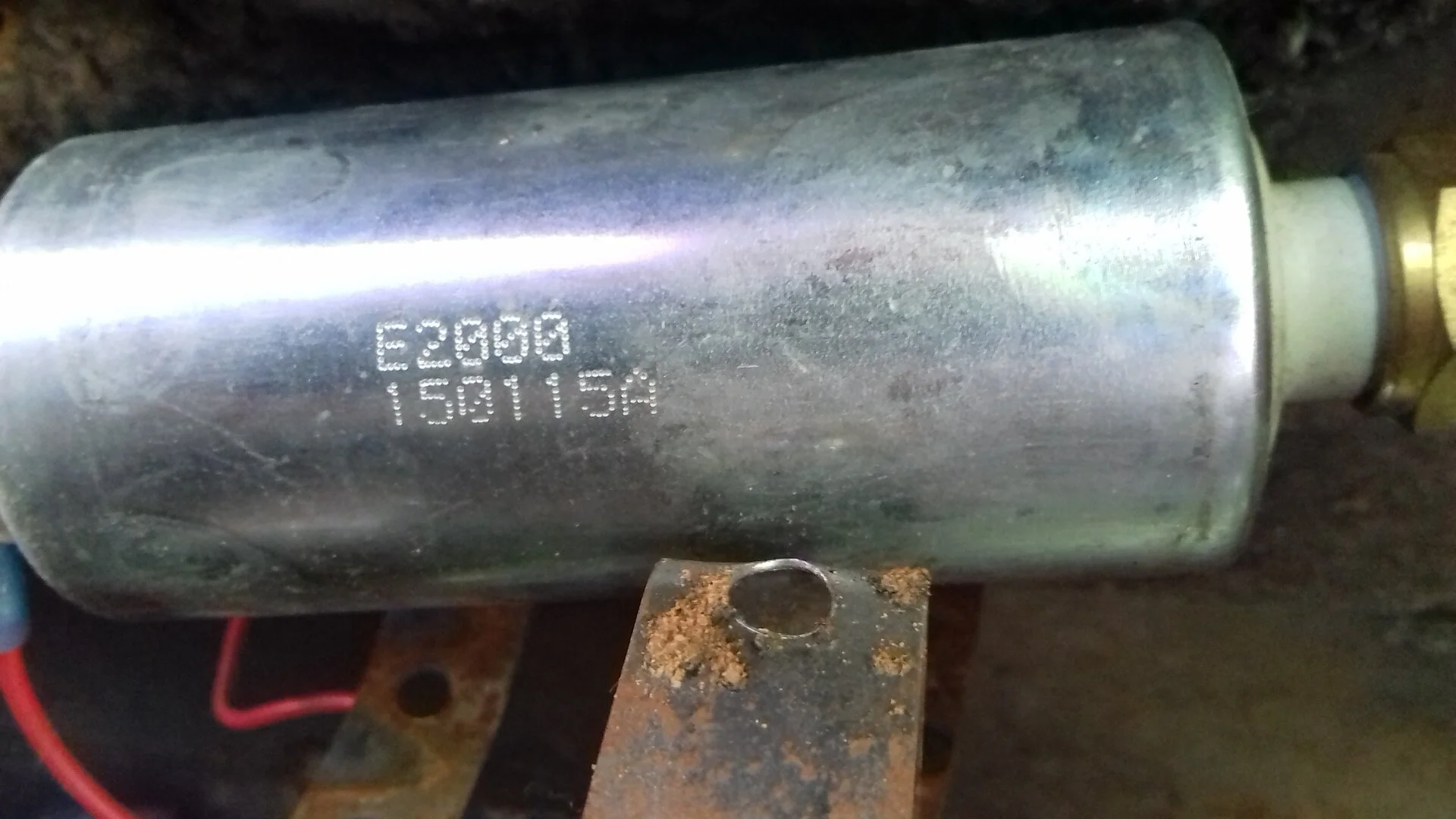

I haven't yet but will look up this number see if I find anything on the pump. Other than that today was work on boat day. So I am off, for now. I'll be back. I thought maybe I should just find a Falcon forum or something but I don't really have no question or need to. After-all it IS the Mustang Beta version, right?
The fuel pressure regulator is controlled by vacuum so it'll fluctuate if the vacuum moves around. Fuel pressure should go up with the vacuum line off.
There could be a vacuum leak at the lower intake gasket. It's a common thing with these cars.
This pump seems to be very popular E2000 Summit, Amazon and even Walmart carry it. Seems to have good reviews and is warrantied for life...thats what they say. Says its quiet, hmm compared to what? Cuz it's not quiet in my book. Cannot find fuel pressures on it though someone states it's near 100 and they used a regulator to get it down to 60. So should be just fine. Doesn't need to be replaced directly but is on the list of future upgrades due to noise. Maybe a box over it would help. It does seem all out in the open and could use a cover of some sort.
