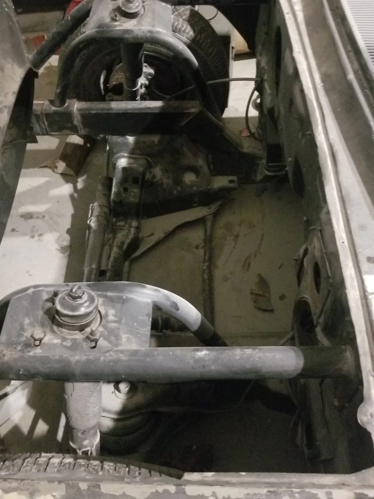

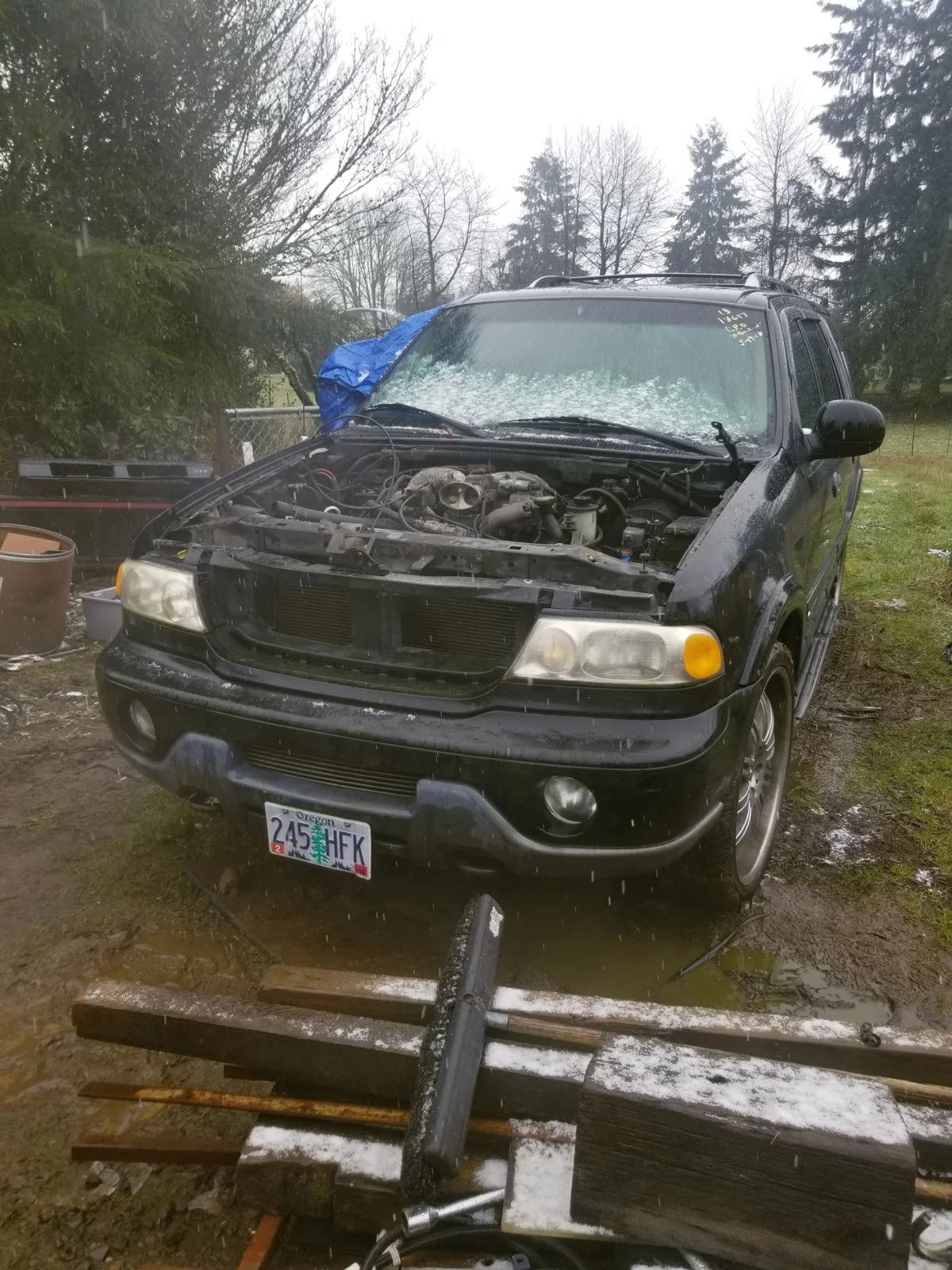

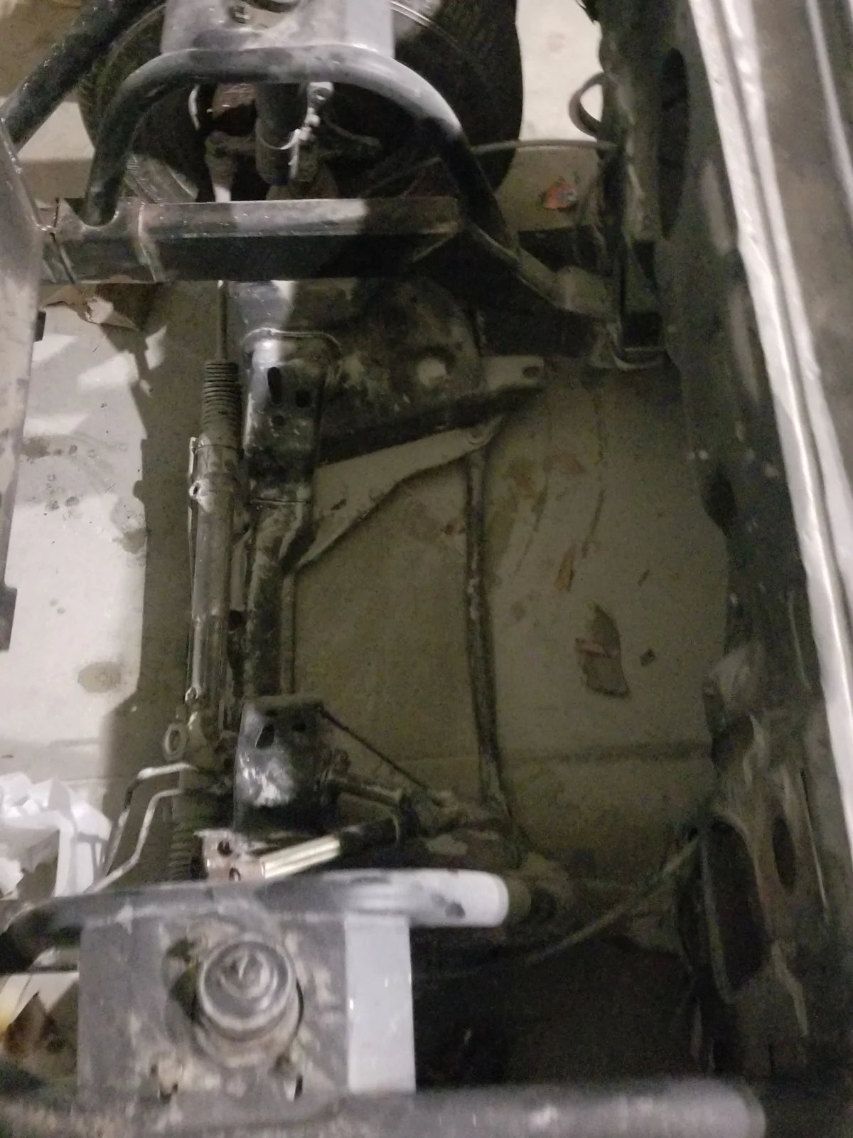

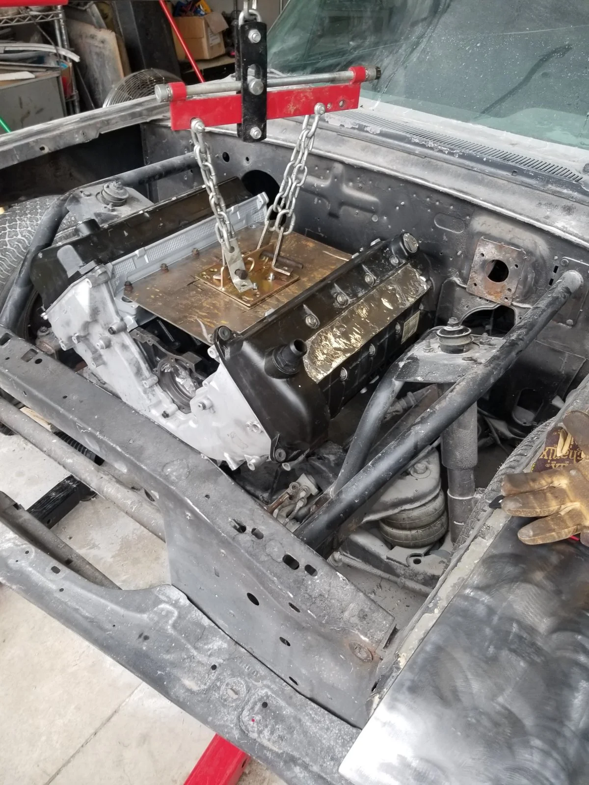

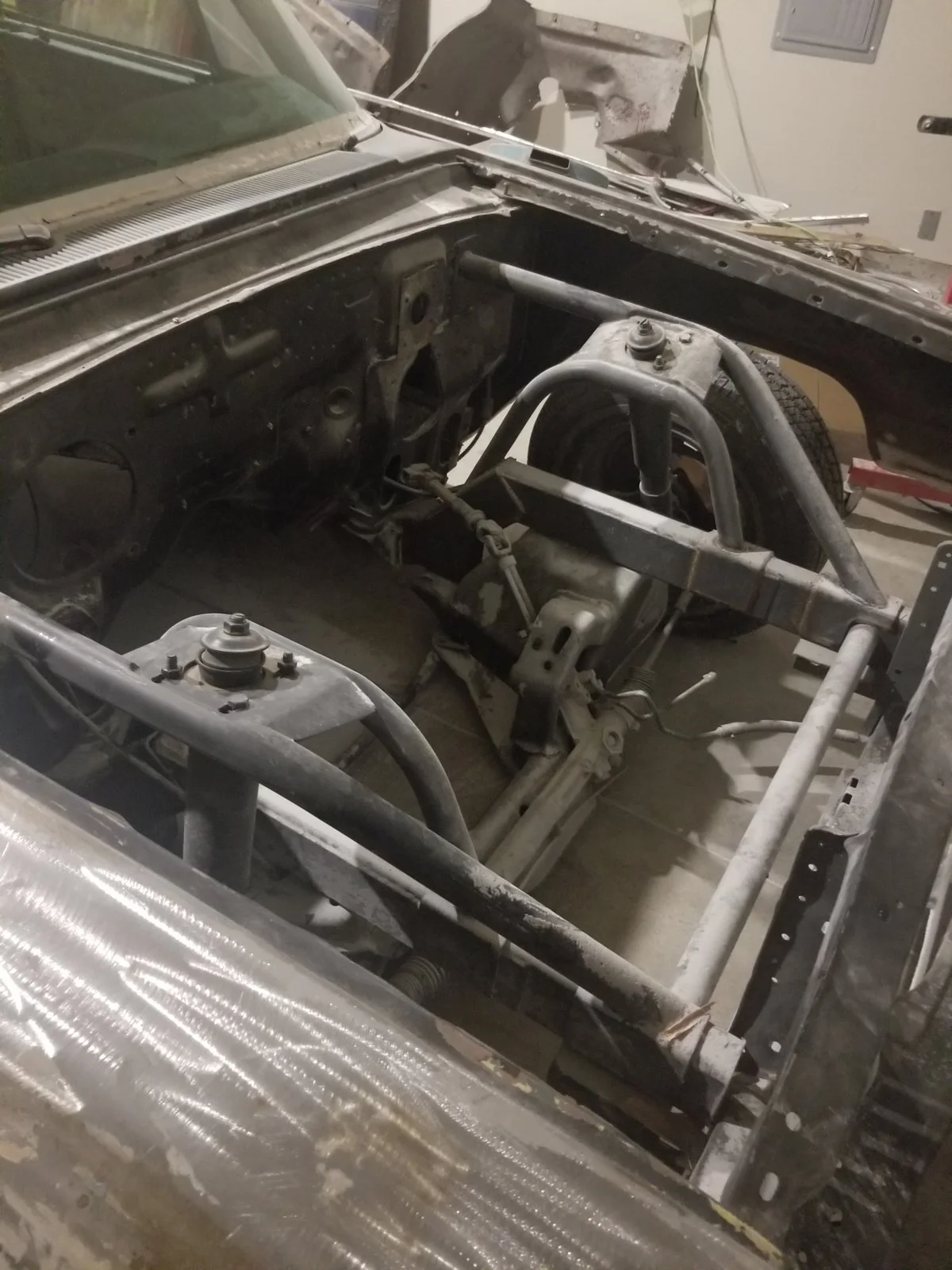

I'm new here and I'm in the thick of a 5.4 navi swap into a galaxie. I opened an account cause I was looking for information on motor mounts to get the motor to fit.
The front of the galaxie has a 94 gt front end. I need to know what motor mounts I'd need in order to fit the navi in there. Any suggestions?
here are the pics

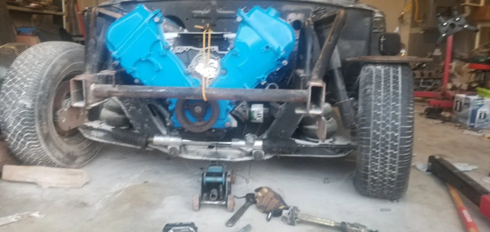

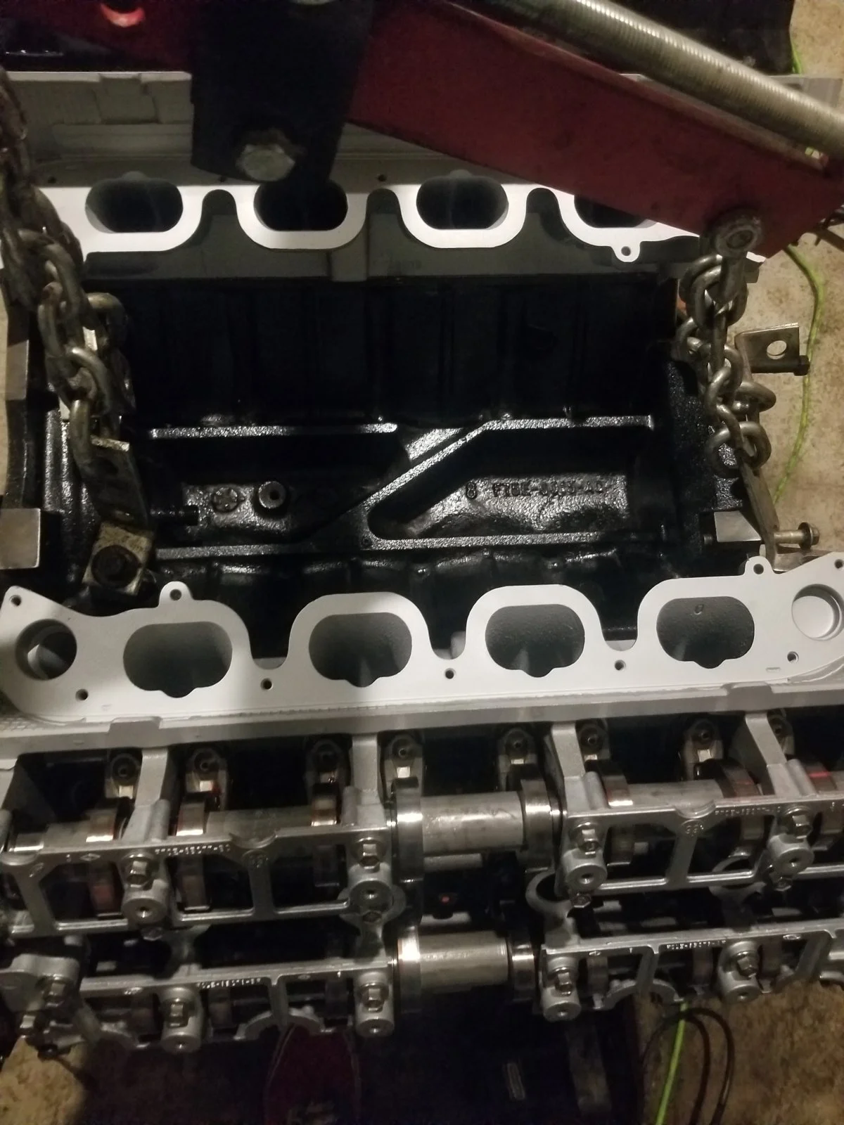

Motor was rebuilt by EPM machine in portland. $2100 for a rebuild if you're reusing the rods and pistons. This a slow low cruiser so no need to go forged anything. plus they gave a 7 year 70k warranty on it.

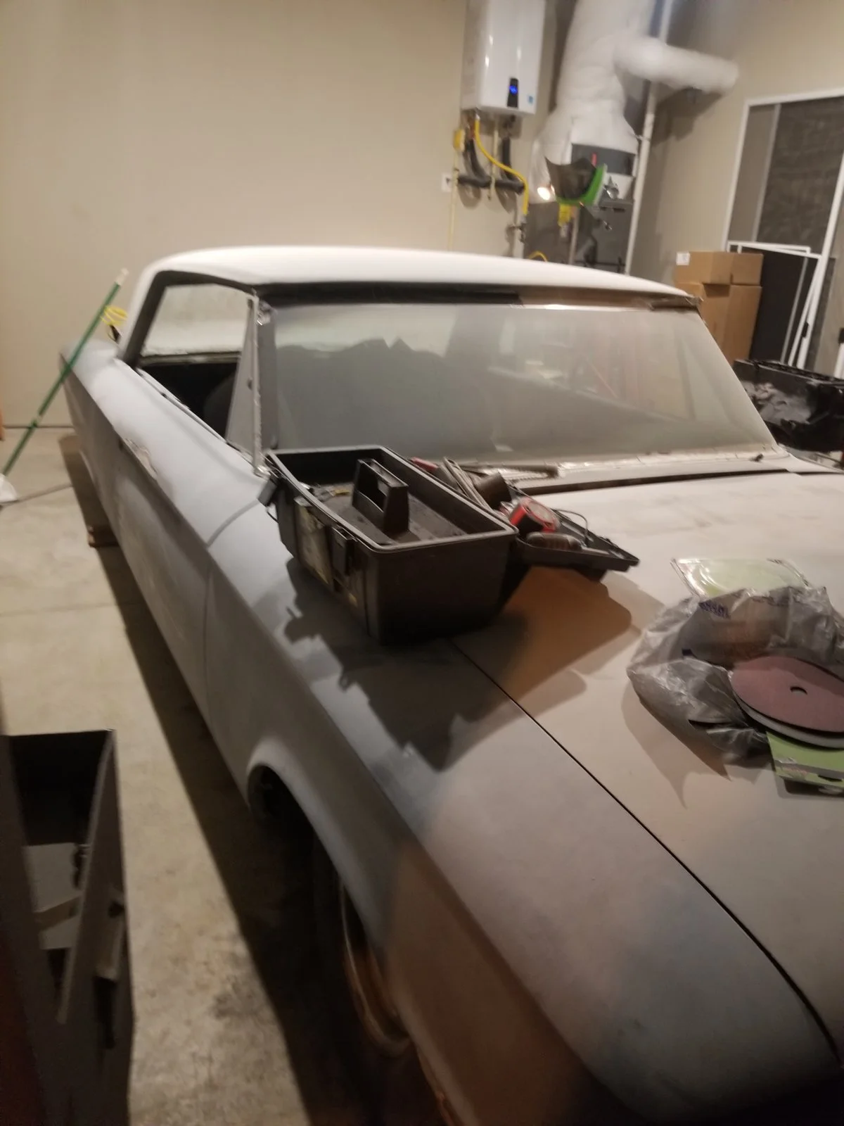

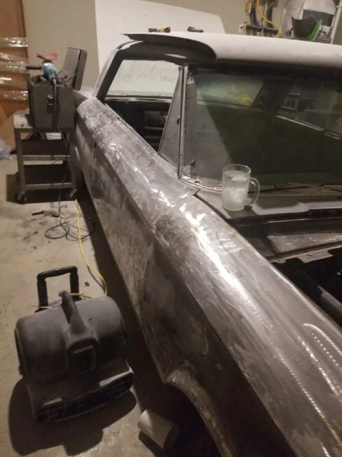

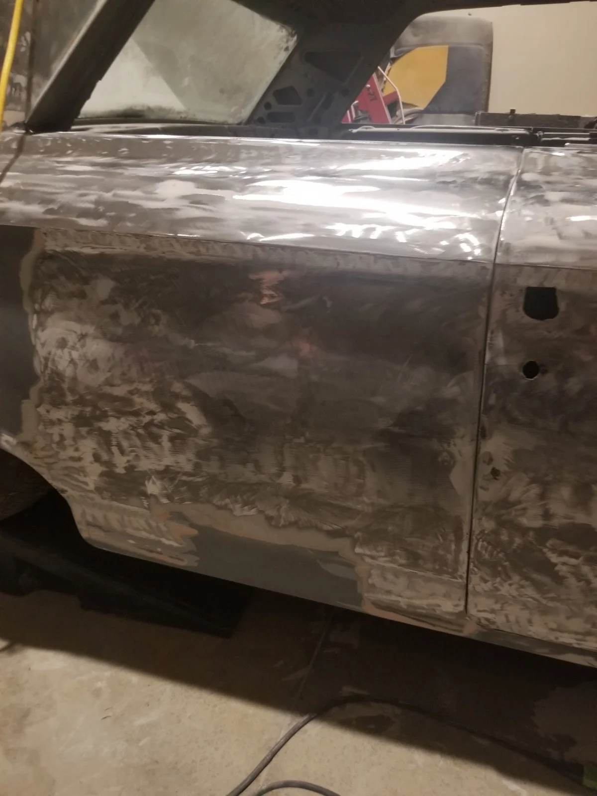

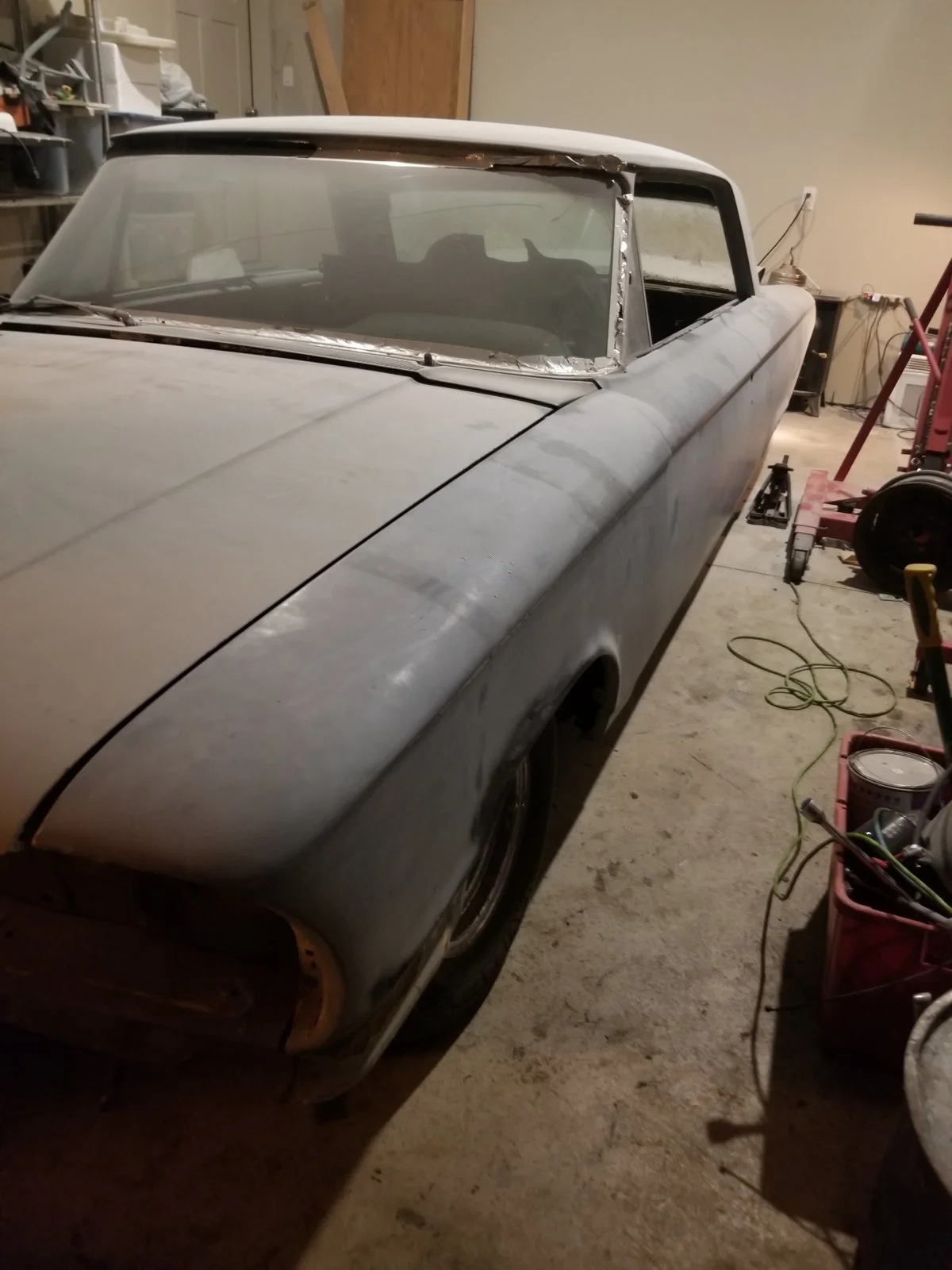

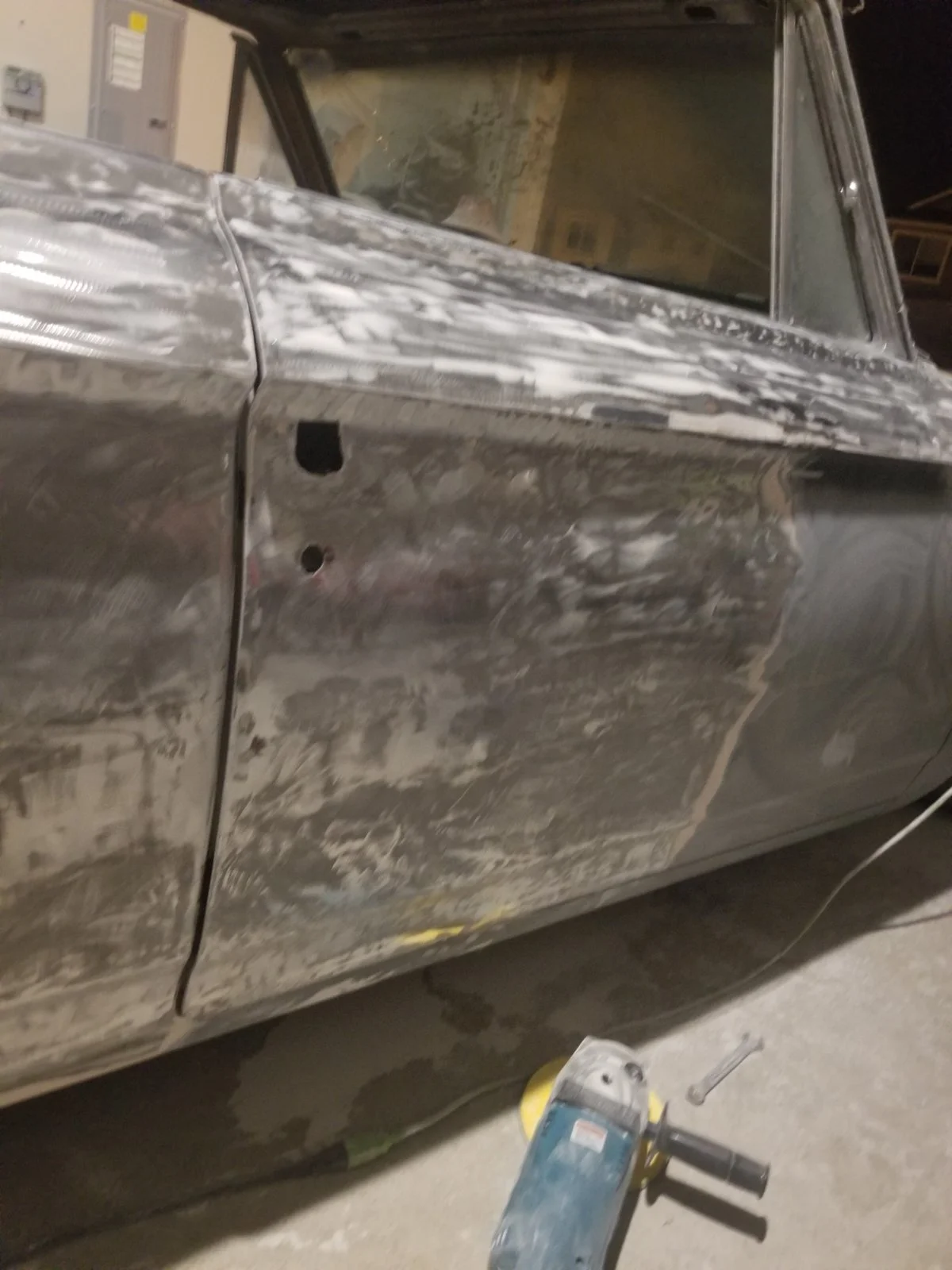

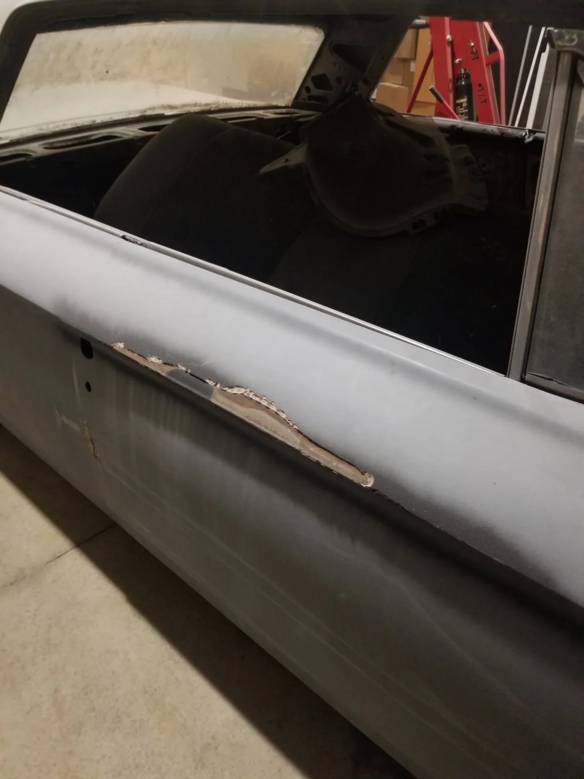

there was a ton of :poo: ass body work done. at a qtr inch of bondo over the whole car. the thing is, it's pretty damn straight to begin with so I dont know why they would dump that much bondo on it. either way I removed it and am in the process of straightening the front fenders now.

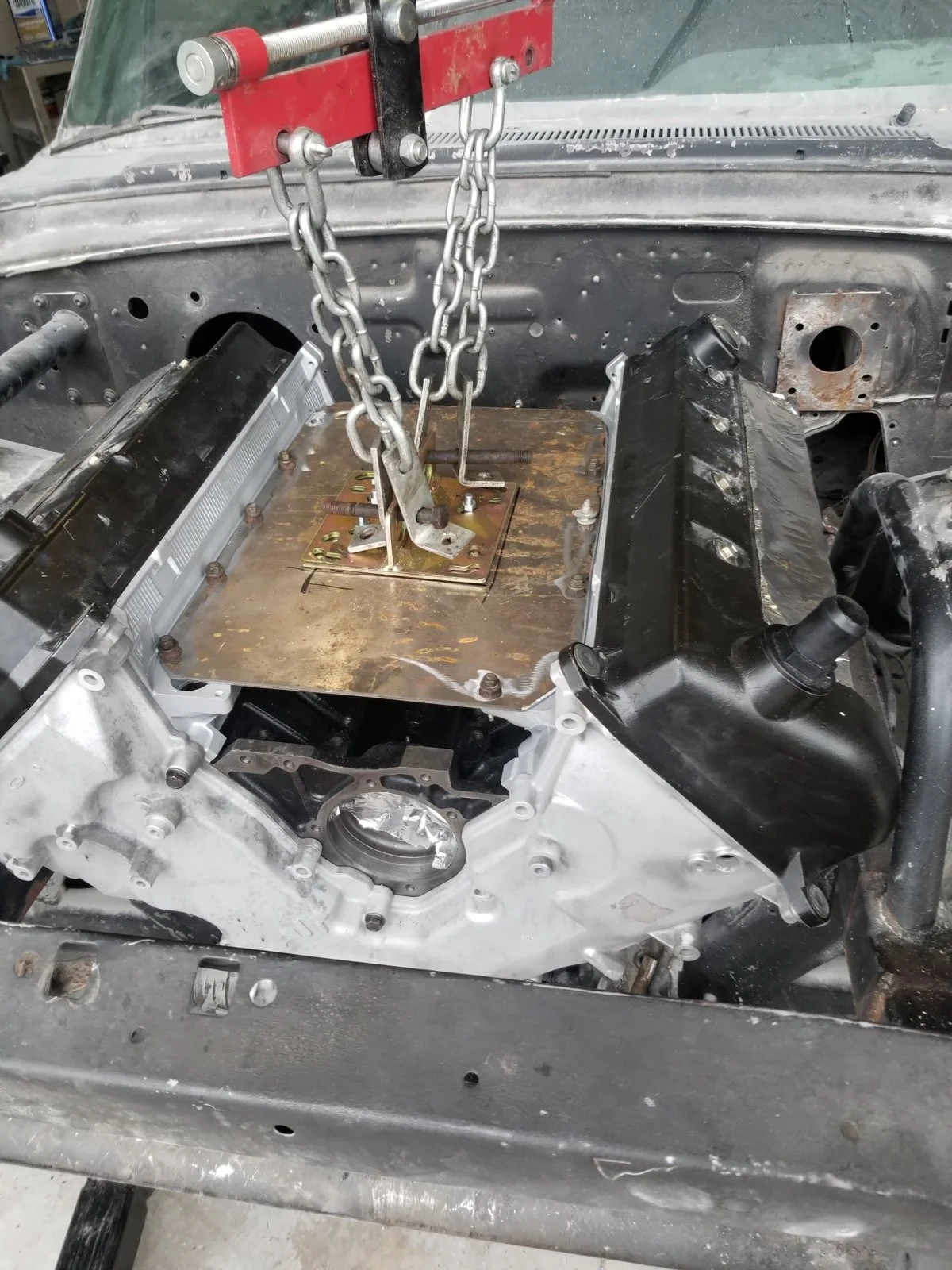

I built this adapter for the motor lift plate. best $9 in steel I ever spent.

You've done a lot of work already it looks. Just grinding the bondo off looks like a lot of work
