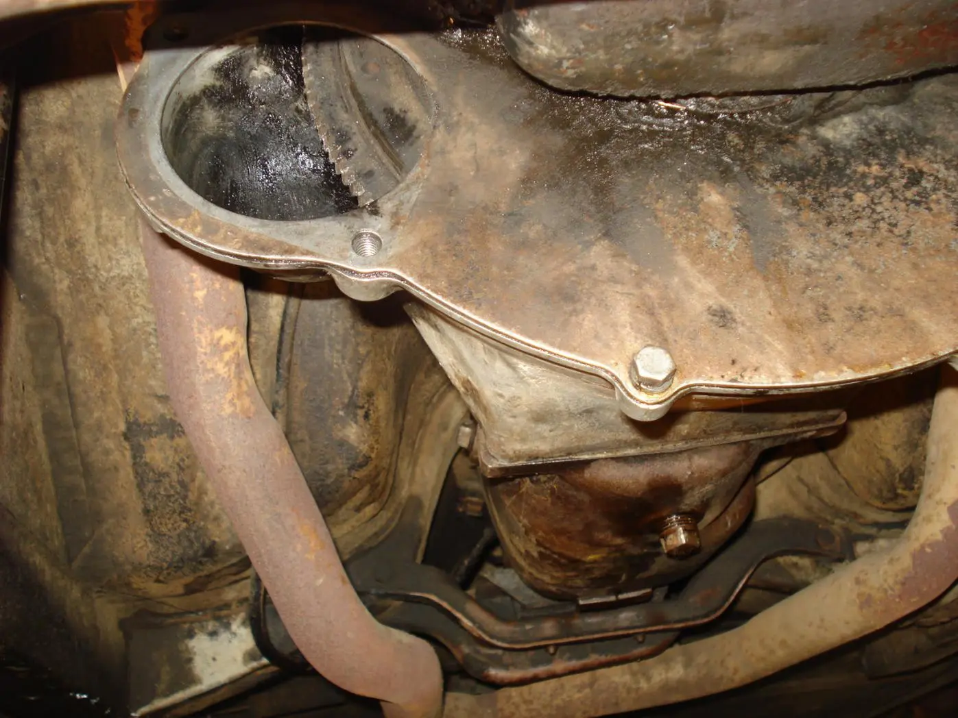

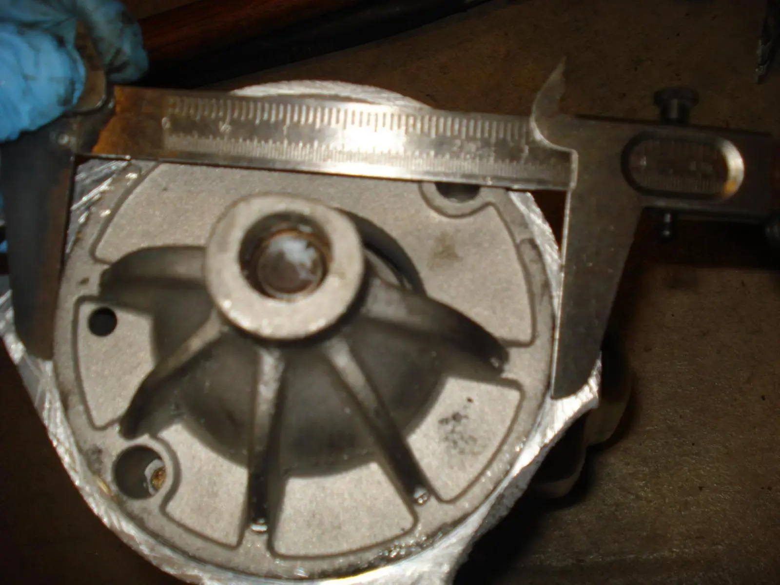

mustang starter 032.webp I recently purchased a 1964 1/2 289 4bbl, 4 speed coupe (all stock) and the starter went out. I thought this would be an easy fix so I did not keep the original starter. Now each replacement starter is too large to fit into the starter cavity. the hole is 4 1/16 and all the starters I have gotten from parts stores are 4 1/8....any advise on what to do?

I have had this issue as well with my 1965. I even went so far as to dremel the plate to get mine to "flush" up. I thought at first it was because of a "shift" in the plate between the tranny and the bellhousing.....I finally said to heck with advance auto and went to autozone. Unfortunately, it is hard to keep skilled people working for what they get paid. I have the "fix" starter in the floor of my office right now. Will let you know how it goes.....
Finally solved the problem. I used a starter from a 64 Falcon automatic from NAPA.

If you still haven't resolved the issue, try part number 3980 from advance auto.....
it fixed my situation...although they couldn't tell me what the part was for other than a Ford...which narrowed it down :) Basically, the starter has a longer shaft...
