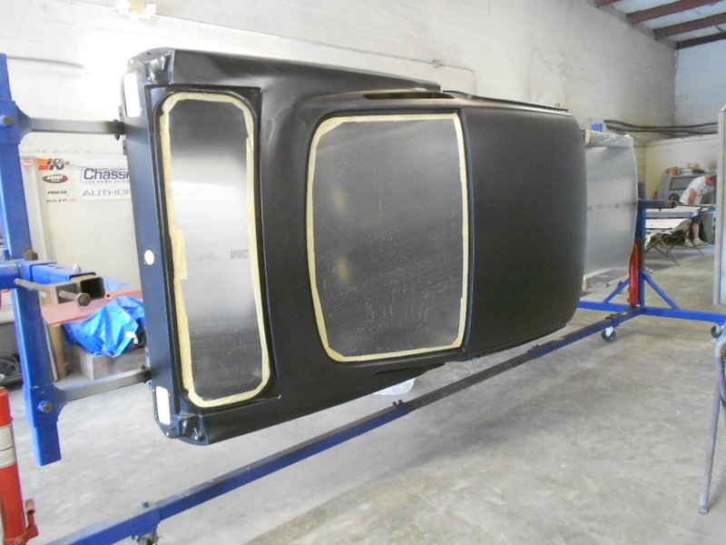

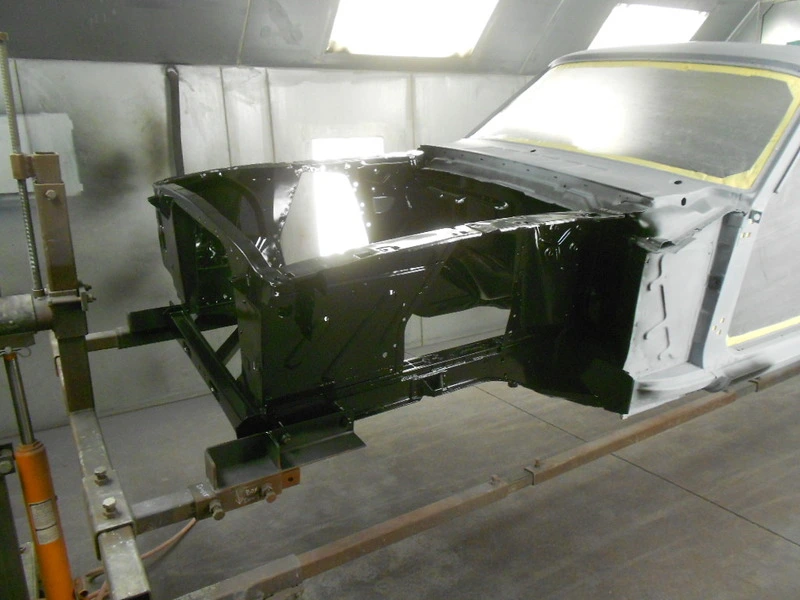

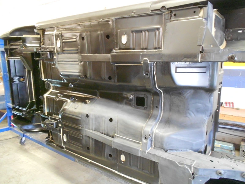

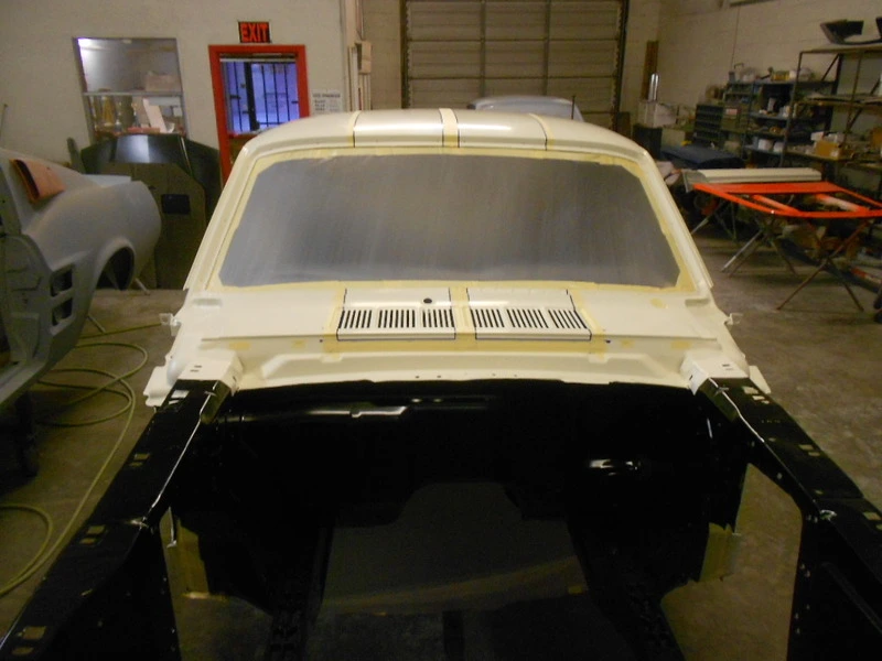

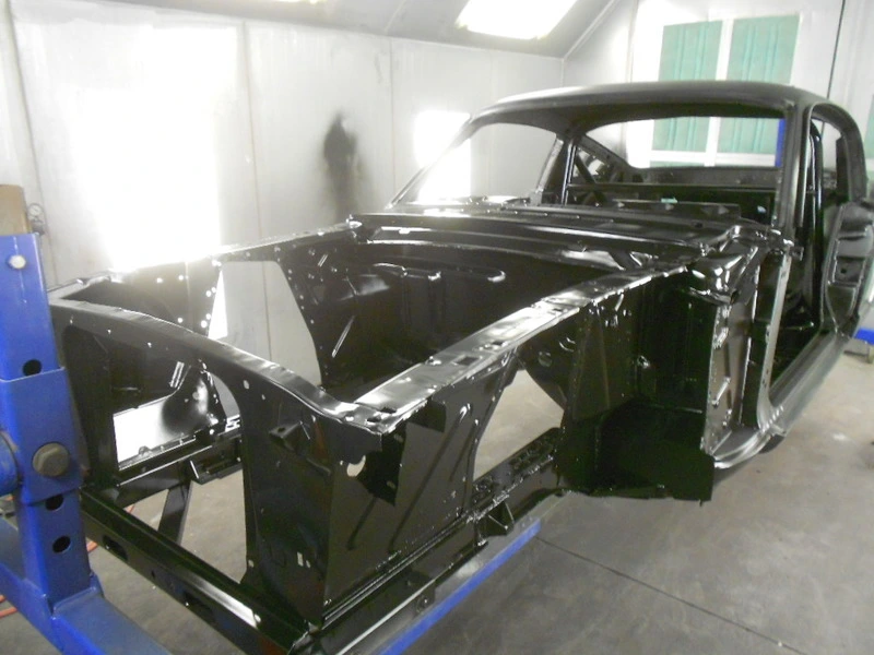

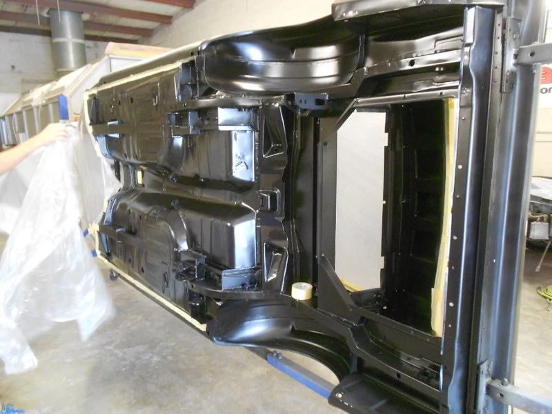

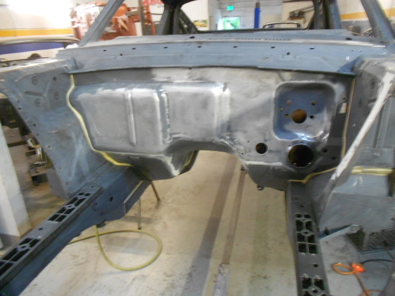

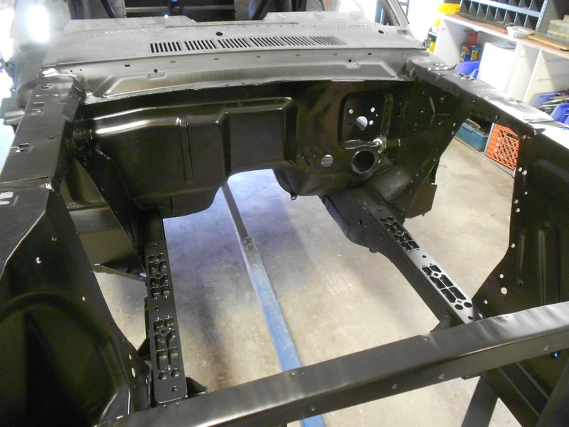

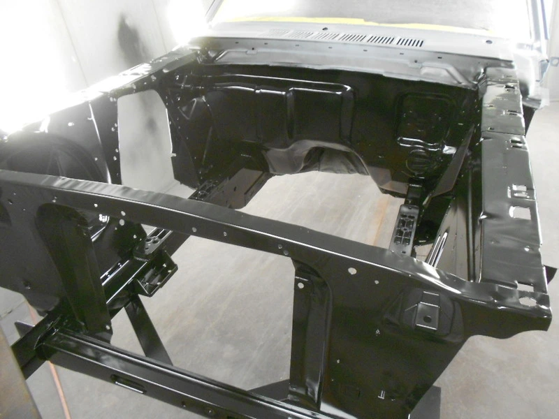

The undercarriage, engine compartment and interior was seam sealed.

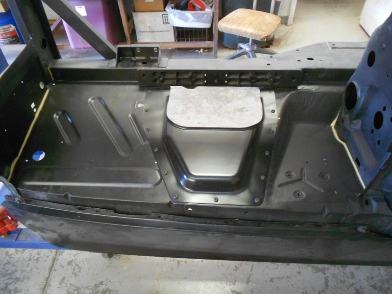

The extra firewall holes were filled in

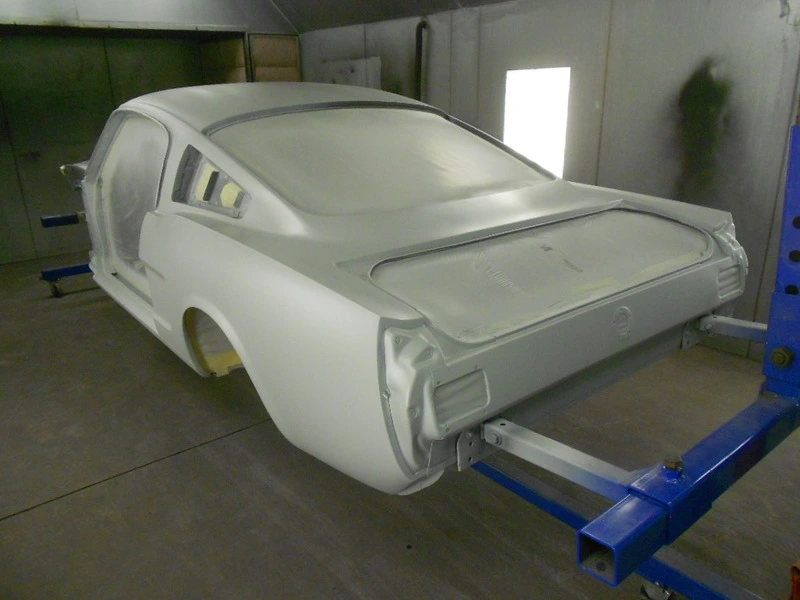

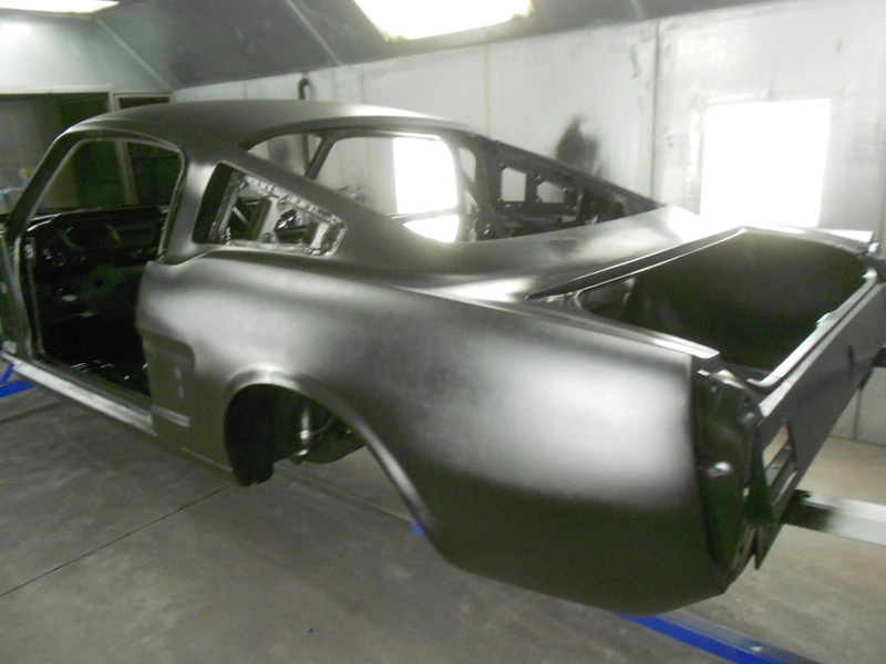

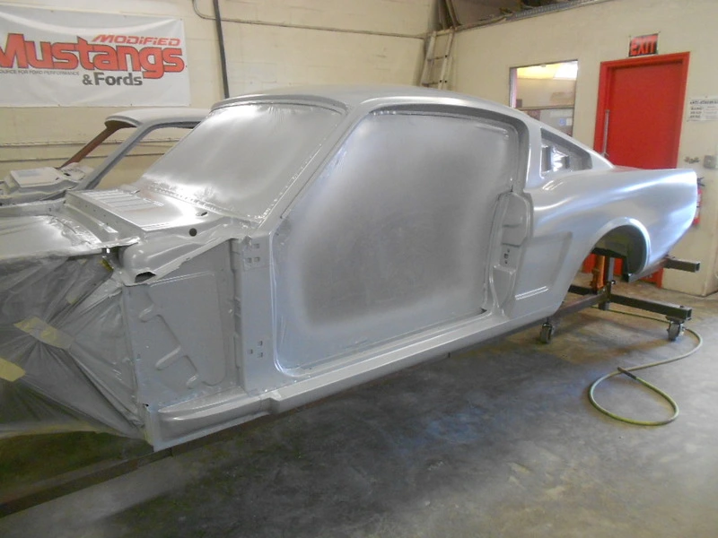

Epoxy primed

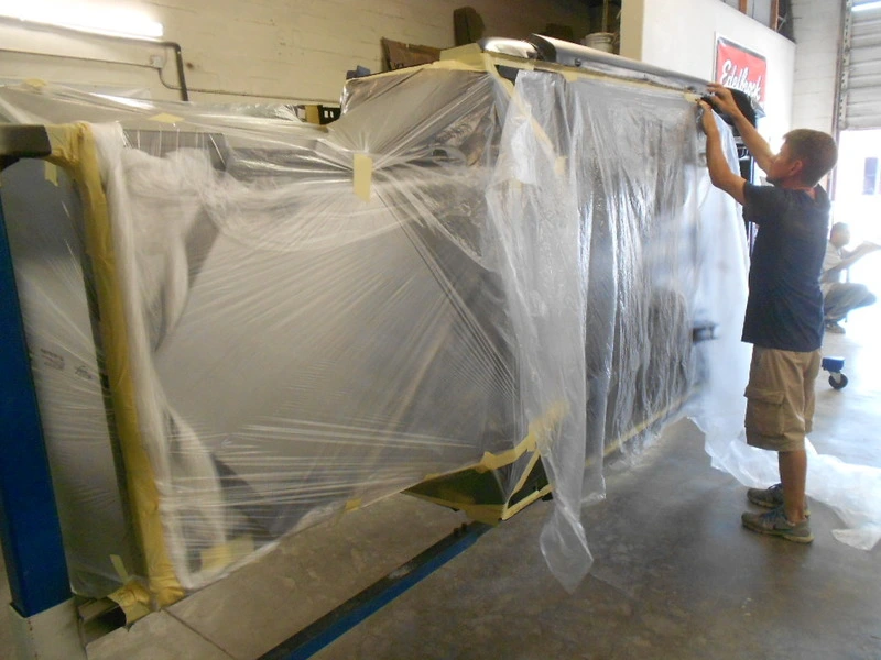

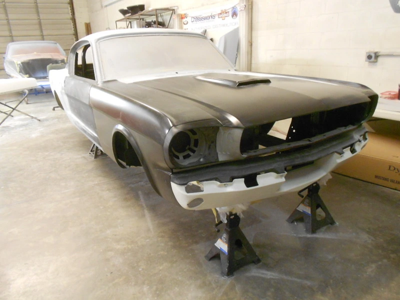

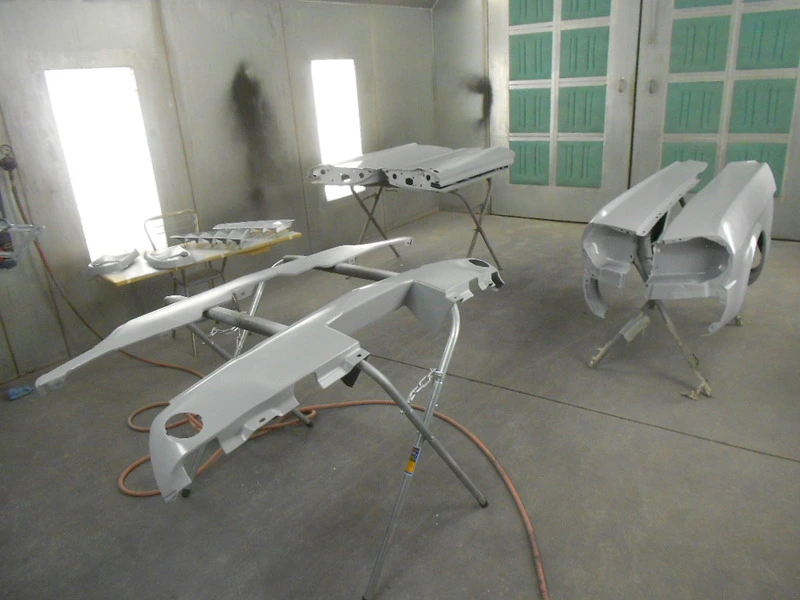

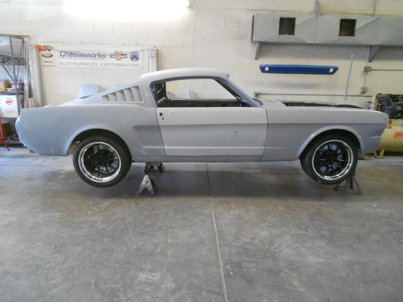

Brian is taping the body so we can spray a couple coats of Slick Sand primer

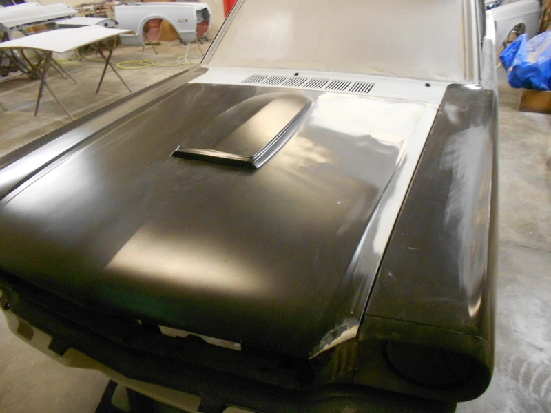

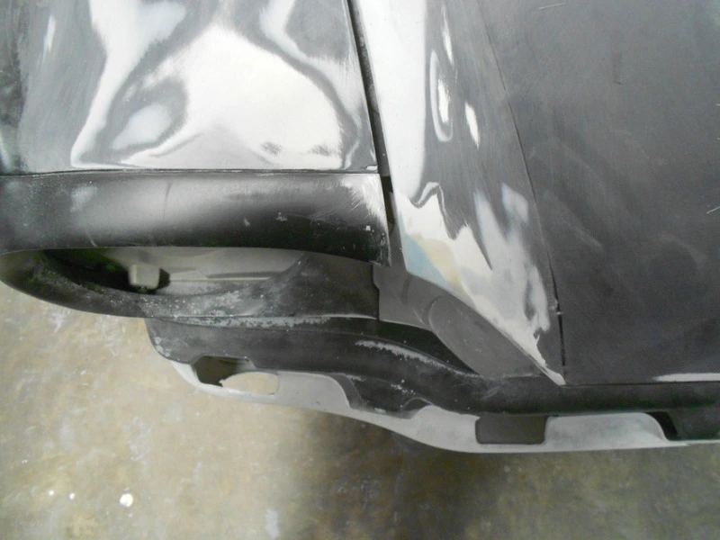

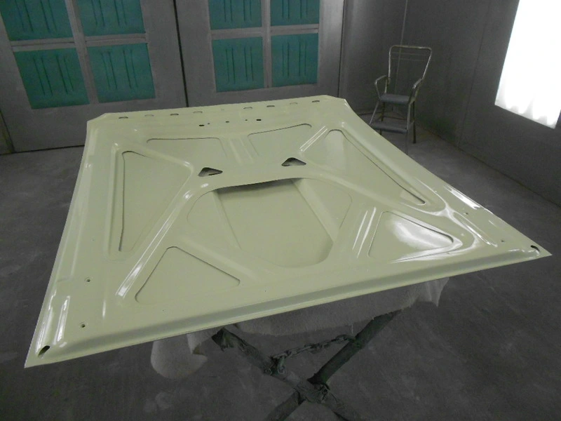

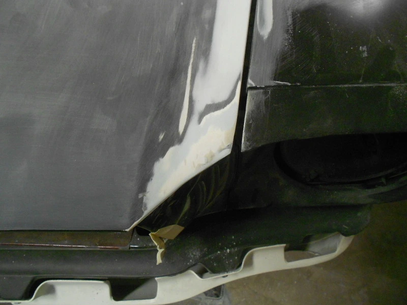

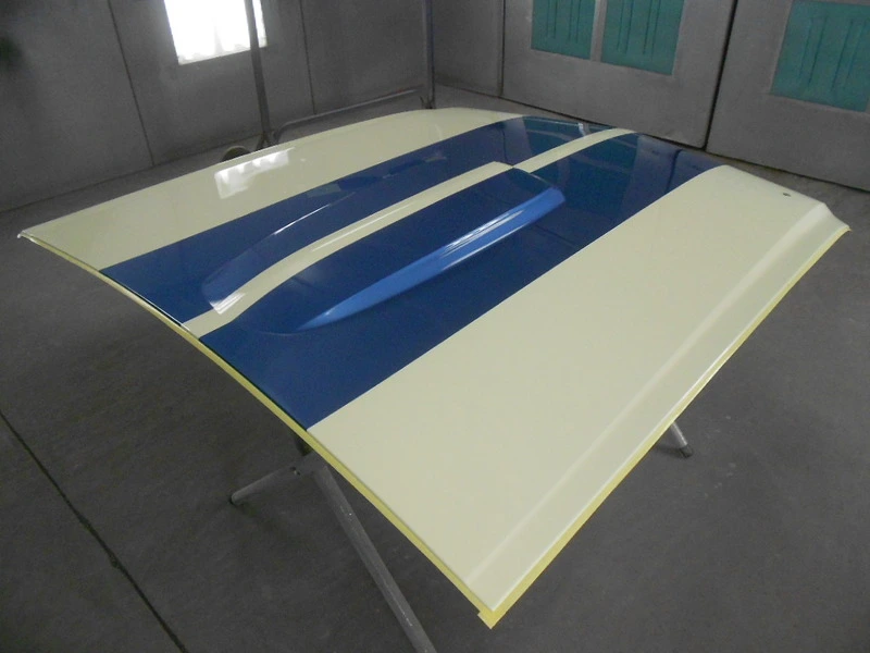

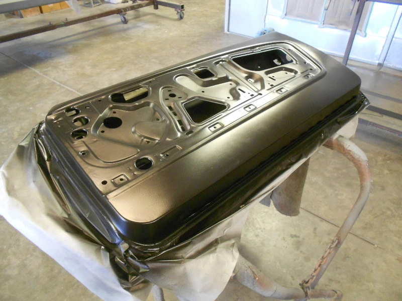

We had a problem with the original fiberglass hood and front valance so we ordered replacements from NPD. The hood required a little work but the front valance fit great and it was a Dynacorn part.
The hood had a low spot in the back and the front corners needed a little fiberglass added to match our front fenders
Our new employee Marco is almost finished with the hood
Brian was shocked that an aftermarket part fit and doesn't need to be modified and top it off it is fiberglass!!!

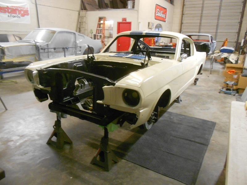

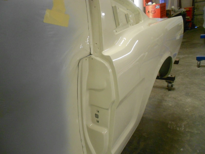

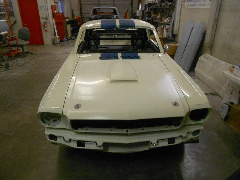

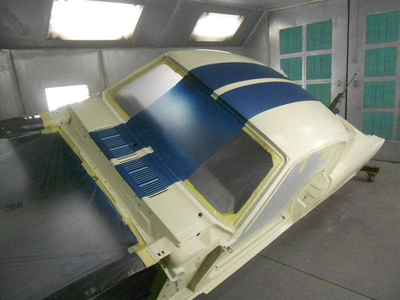

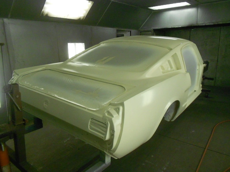

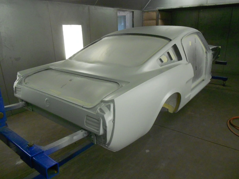

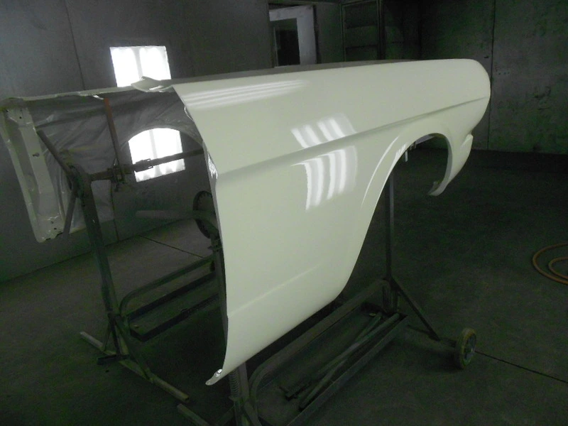

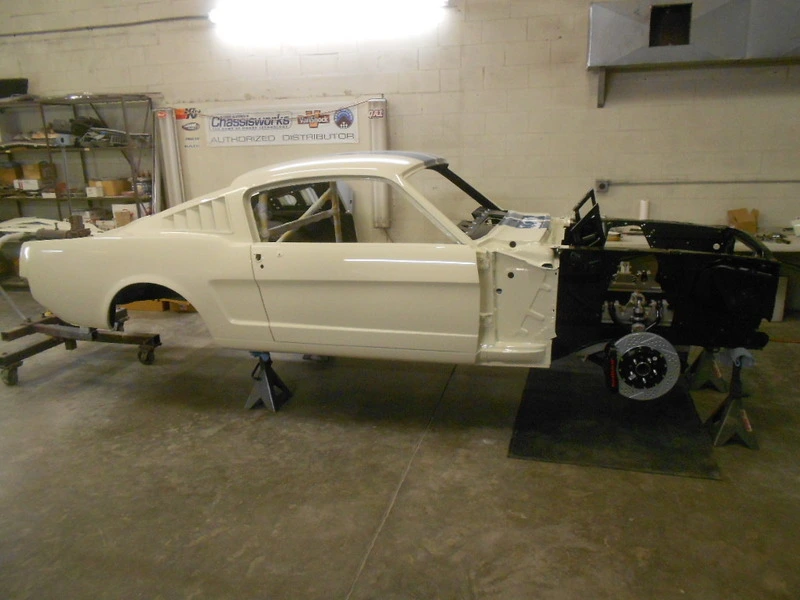

The body was epoxy primed for the last time and wet sanded with 600 before paint.

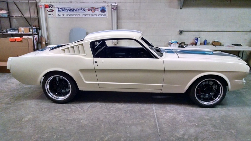

Three coats of Wimbledon white followed with a coat of intercoat clear

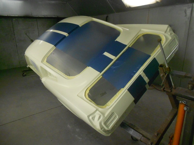

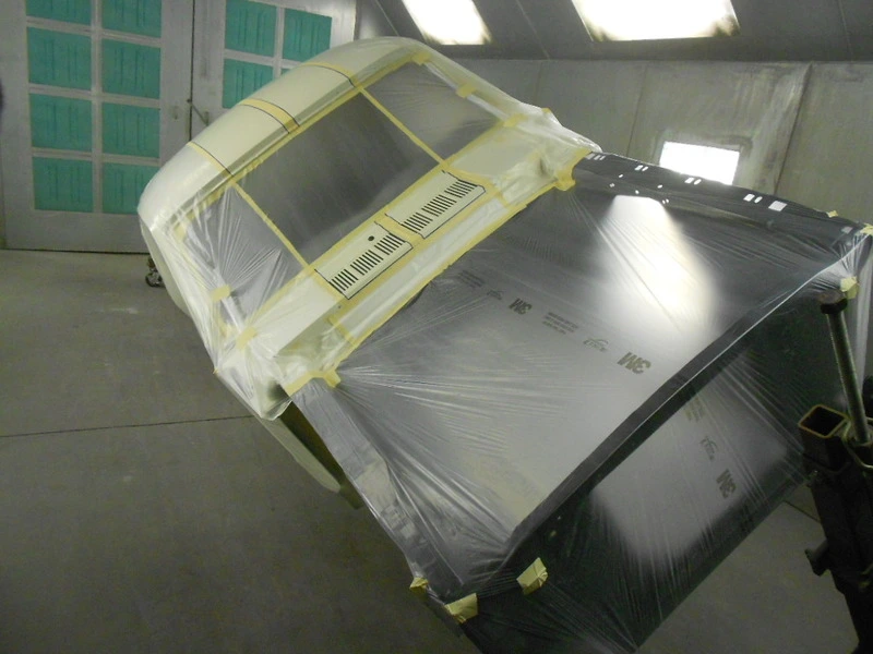

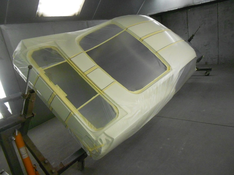

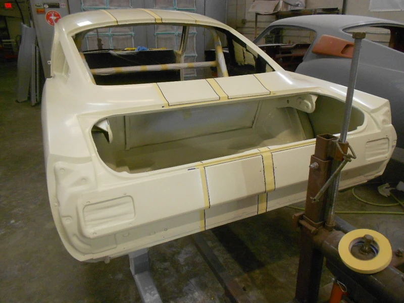

It's not a quick job laying out the stripes and taping the body
Three coats of Guardsman blue yesterday
Brian removed the tape today and tomorrow I will spray SPI Universal clear.

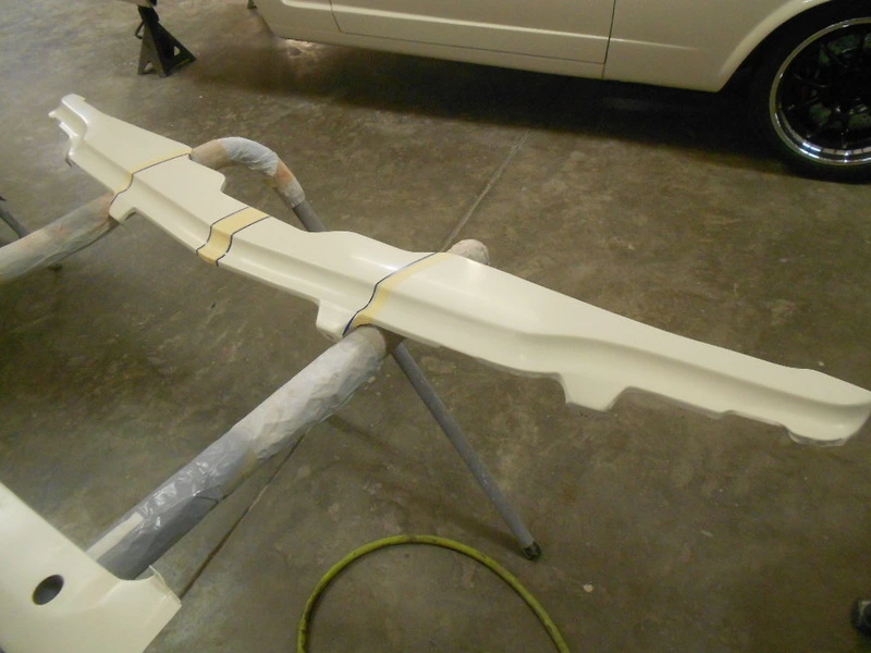

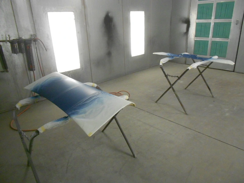

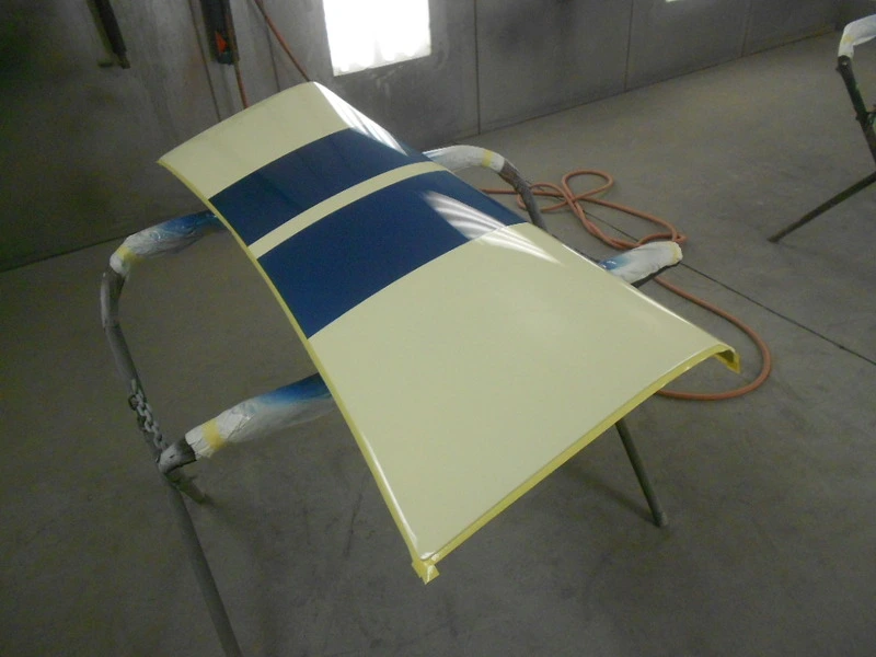

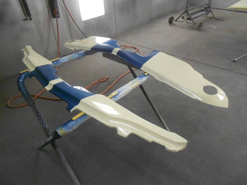

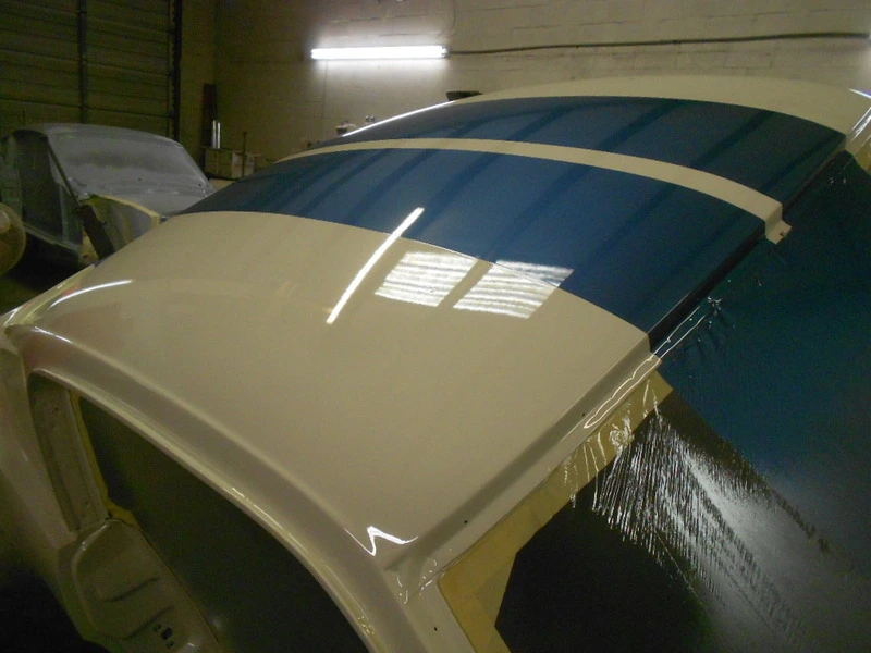

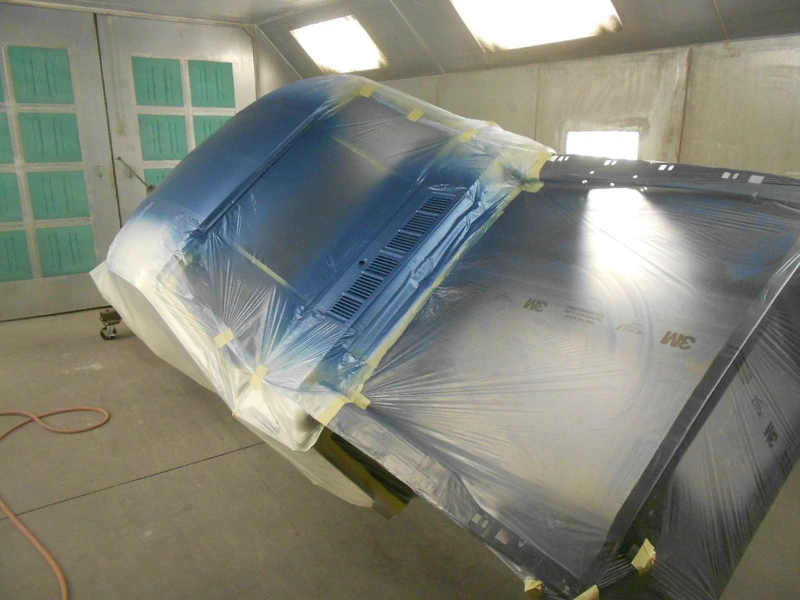

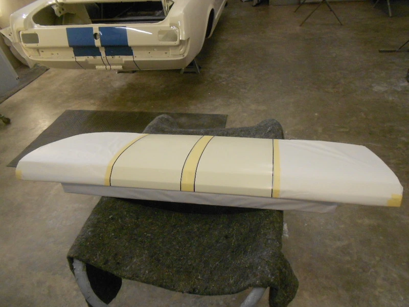

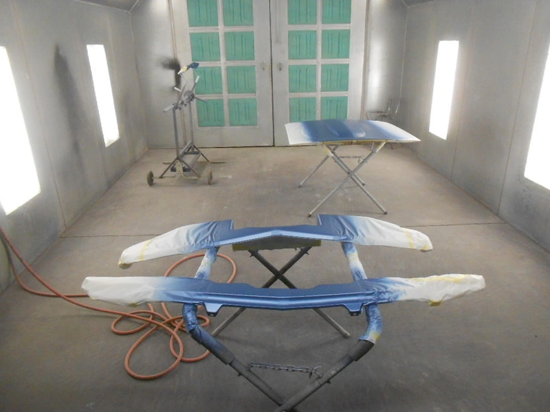

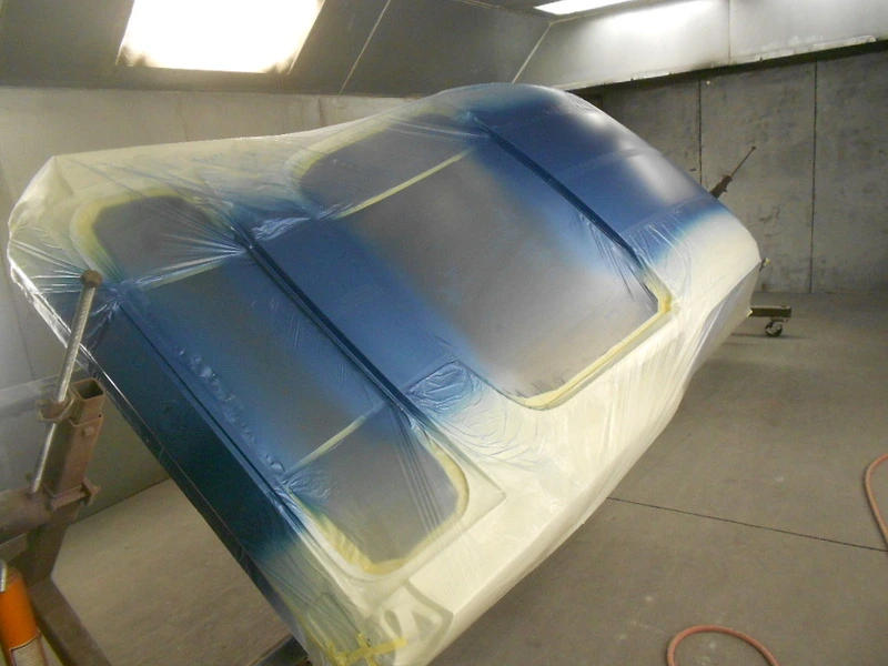

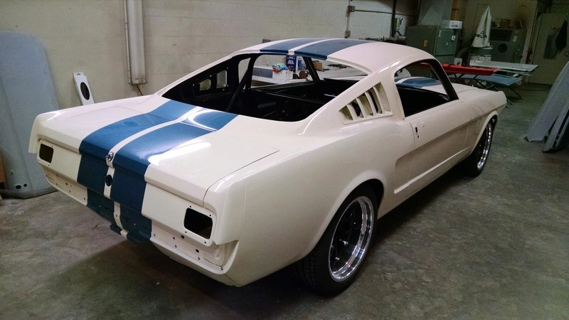

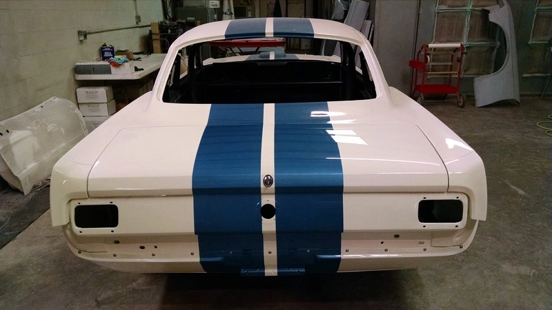

Deck lid taped off and ready for blue along with the rear valance
Removed the tape and clean a little and spray three coats of SPI Universal clear

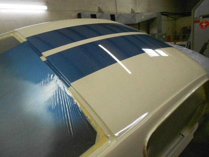

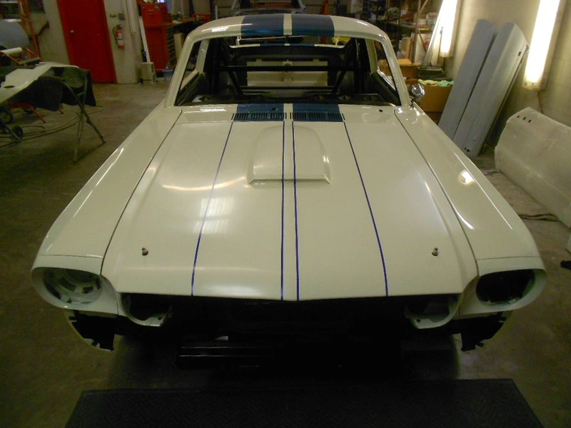

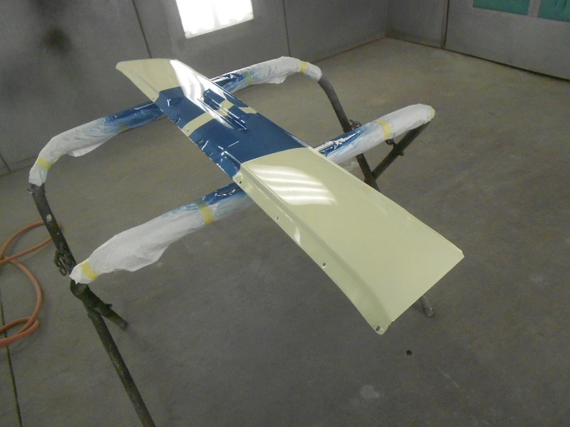

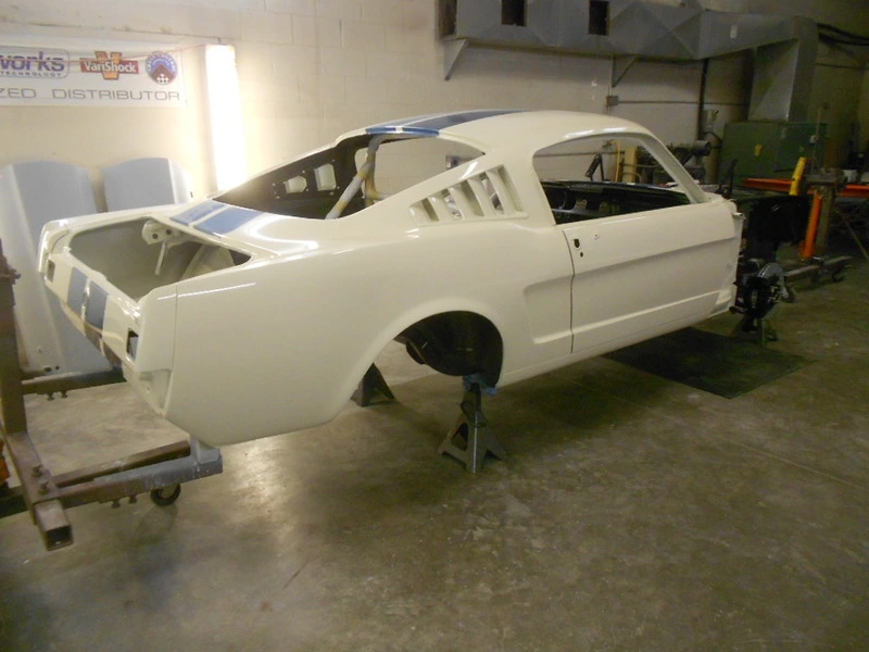

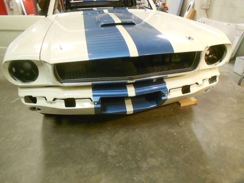

Getting ready to lay out the stripes
Stripes on the hood, grille panel, stone guard and front valance

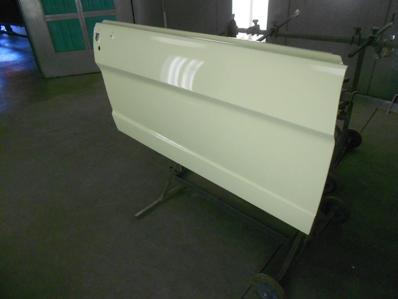

Clear
Everything wet sanded, buffed and lined up
