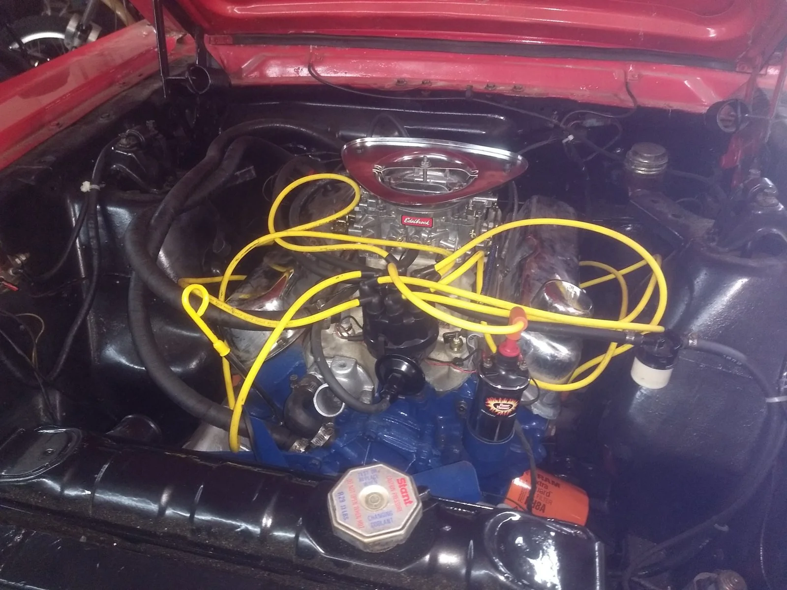

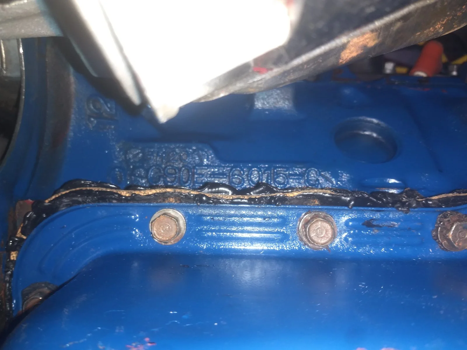

Need some help. Correct forum? Gentleman died of throat cancer and left this mostly restored gem. Everything on it is new from brakes to door handles to dash pad....my problem? Engine is C9OE-6015-C (1969-302), with 65 289 heads on it. Can't figure that one out. He had owned the car since late 80's? Car has zero oil pressure and not sure what to do. Was told engine was just built, shows all new gaskets on pan areas. Starts, doesn't rattle but oil light stays on. Shut her down and removed valve covers, no oil reaching rockers as drill spins oil pump shaft very fast in correct direction. Removed oil pressure sending unit and repeated experiment, not one drop of the full crankcase oil exits the sending unit hole. Did someone forget to put the oil strainer on the pump? The galley plugs? I'm at a loss on what should be my next step on the classic Mustang. Any suggestions from this forum would be greatly appreciated. Tks in advance.

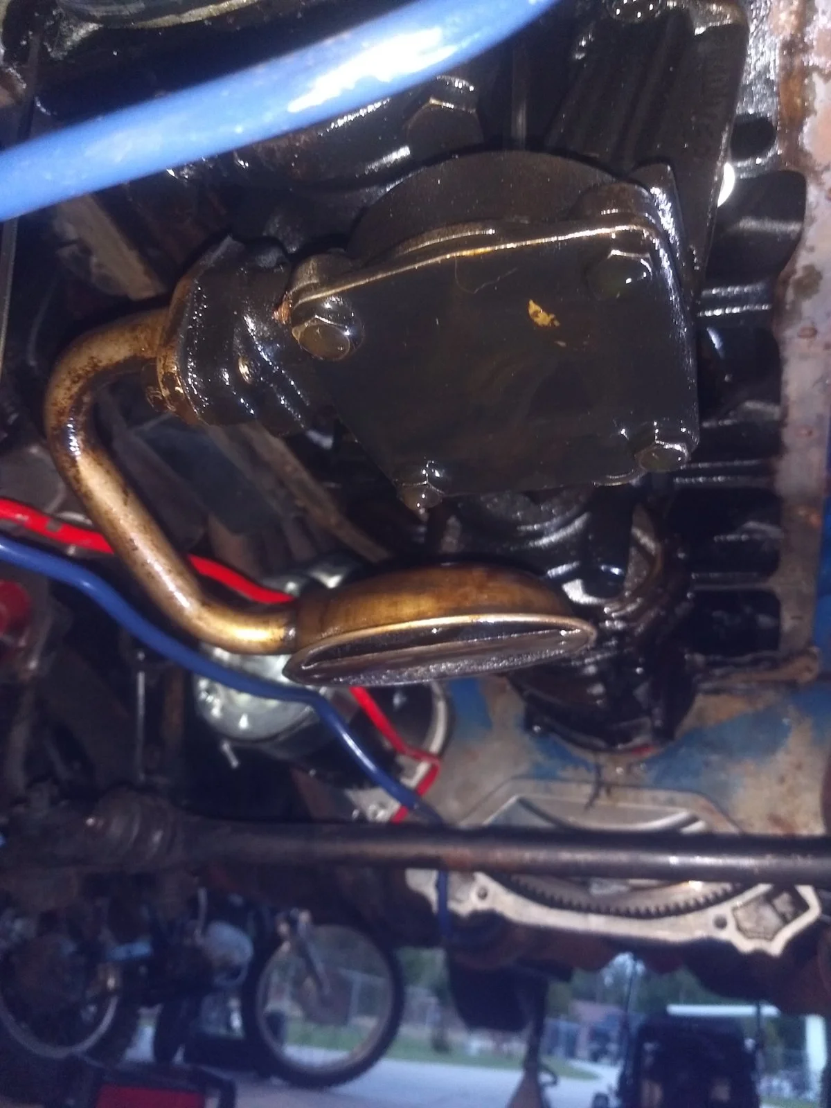

Oil pump screen in my opinion was on funny angle...not square in the bottom of the oil pan. When I removed it I placed it in the oil and spun her counter clockwise and thought I should have seen oil shooting out of pump. None. Did I do this right?

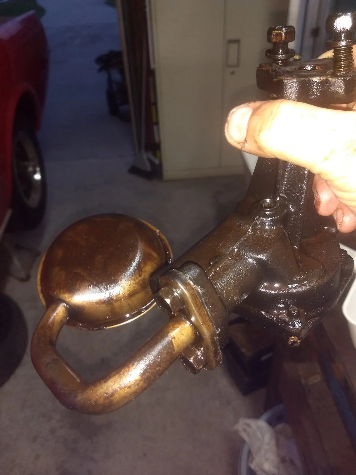

Pulled pan...pump screen does not seem to sit in pan right. Not parralel to bottom of pan. Pitched up and back at funny angle. Removed it, placed/submerged in 6 qts of oil...spun pump ccwise and no oil came out if pump. Never did try to spin her clockwise. If she pumps oil from strainer out the mount hole when spinning clockwise then surely would be wrong pump, right? Or if now oil is pumped ccwise then defective pump?
Notice I'm holding this pump with pump flange parralel to the ground. When I do treat the level ground as if it were the level bottom of the block...the strainer is pitched up funny. I really don't think this is correct pump. Can't wait to spin it clockwise tomorrow.
If you are spinning the pump in the direction the dist rotates and its not putting out oil, get a new pickup and pump. Theyre cheap get a good one

Is your oil pan single hump or two. Two hump pans use a longer pickup tube. Your pics look like it's for a single hump. Won't really matter if you've bought the correct pump and strainer for your engine. I used the motorsport chrome-moly shaft as I've broken one before.

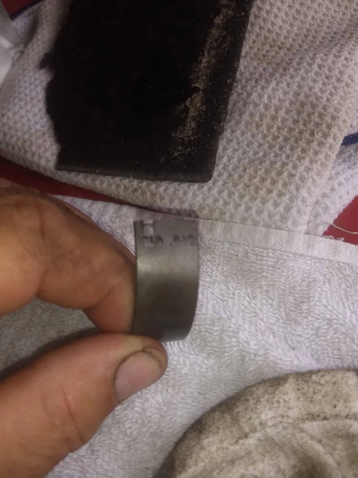

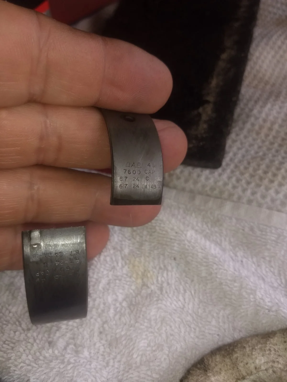

Having a problem here. Everyone has told me that rod bearings and main Bearings without .010, .020 or STD markings are in fact std. I ordered STD bearings and swapped out the mains with new 2pc rear main seal. I have not plastiguaged yet but plan to this week.
Problem? I went out this AM and started w the rods on first two rods. Got bearings in and torqued. Side to side play (along crank journal) seemed normal.
However, when you check play perpendicular to crank journal...wham there's just as much play. Not good.
Took rod cap back off and noticed oil on surface wasn't even squished. Took and looked at first two cylinder's and saw a bearing with no obvious size numbers but one had a .012 marking on it. Dang what to do now?
