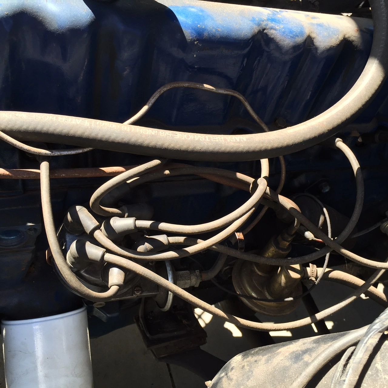

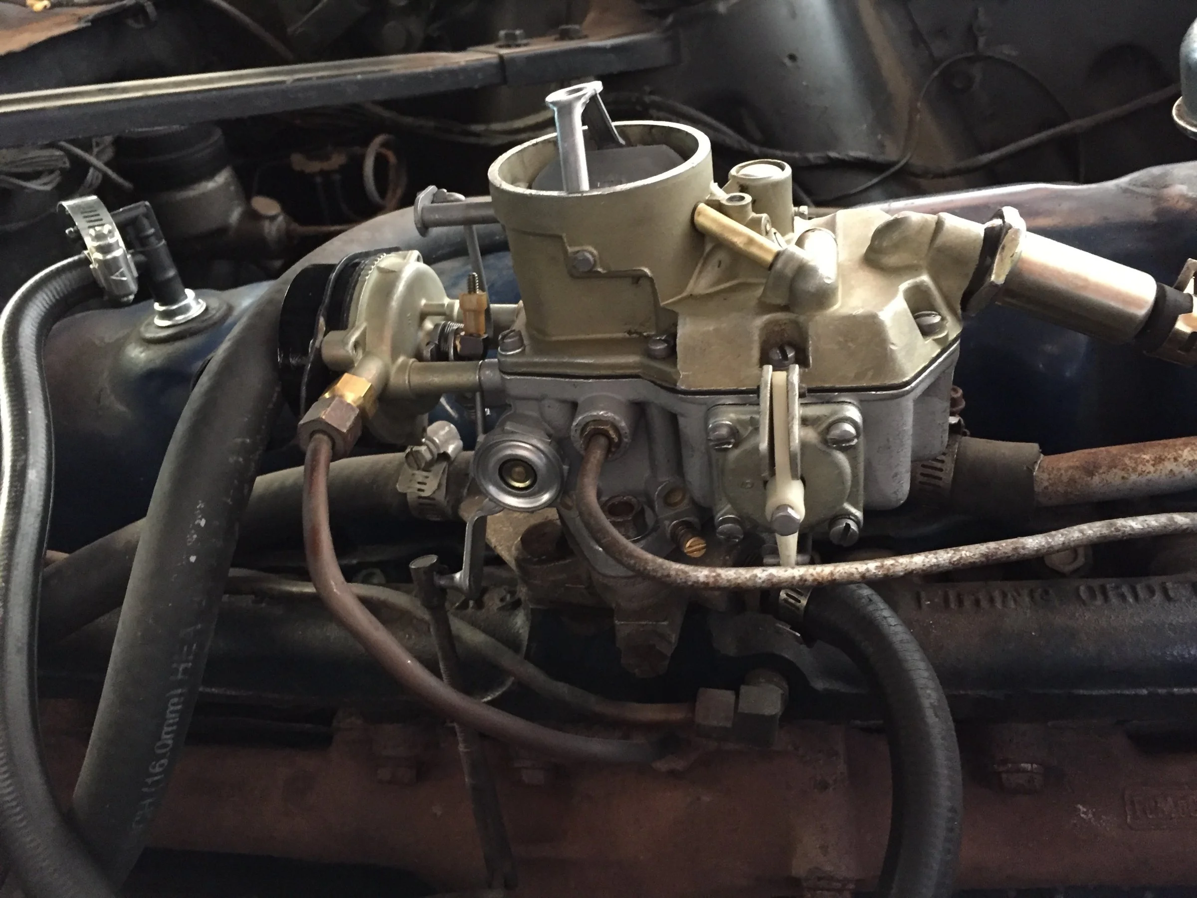

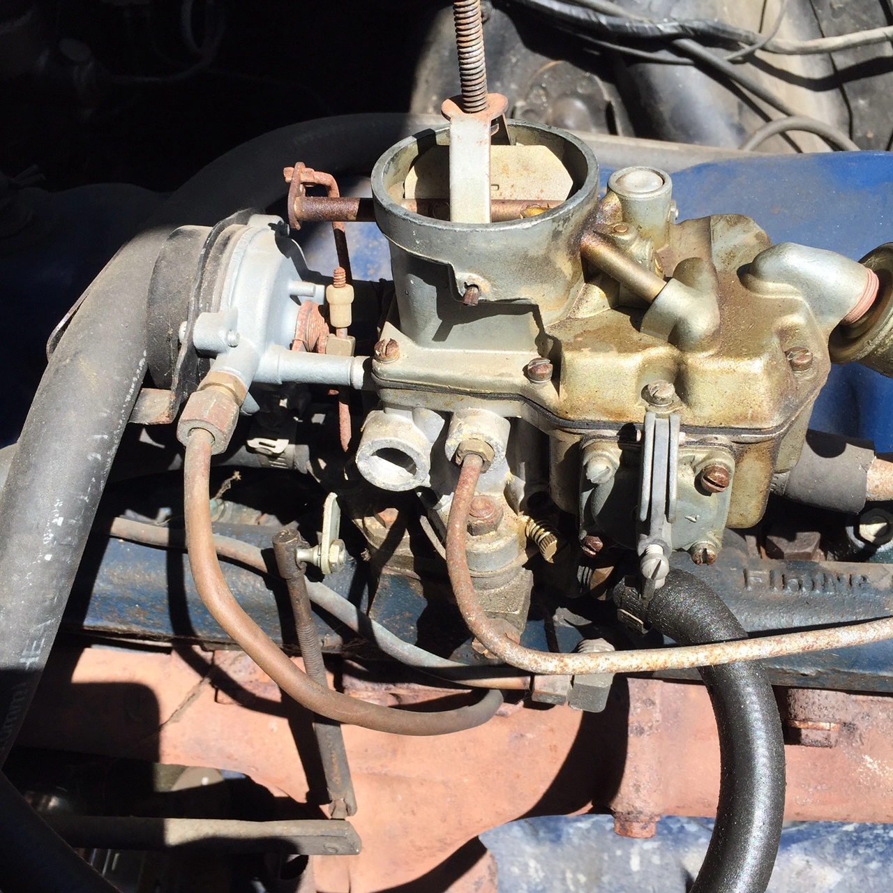

Hoping to get back to this on the weekend. Noticed something different though between the original carb and the "new" rebuilt one. I think it is a SCV? What impact would it have, if any, on my hesitation / stalling issue?
I believe it could be part of your problem if not all. The SCV was meant to work with the old Loadomatic distributors and depending on which dizzy you have you might be mismatching. The SCV works to reroute vacuum when it senses certain manifold vacuum drops. Sudden acceleration = manifold vacuum drop + SCV kicks in and switches to venturie vacuum so you may have found your problem?
Disregaurd what I just posted about the loadomatic cause I could be all wrong about it. It had vacuum only advance but not centrifugal advance. Anyway read the article and do other google searches and you can determine yourself which you have.
You should be able to pop the dist cap and see if you have centrifugal advance as well as they vacuum.
Well it looks like your dizzy has vacuum advance and the loadomatic didn't have any sort of advance installed so id say that you have the wrong carb/dizzy combo.
