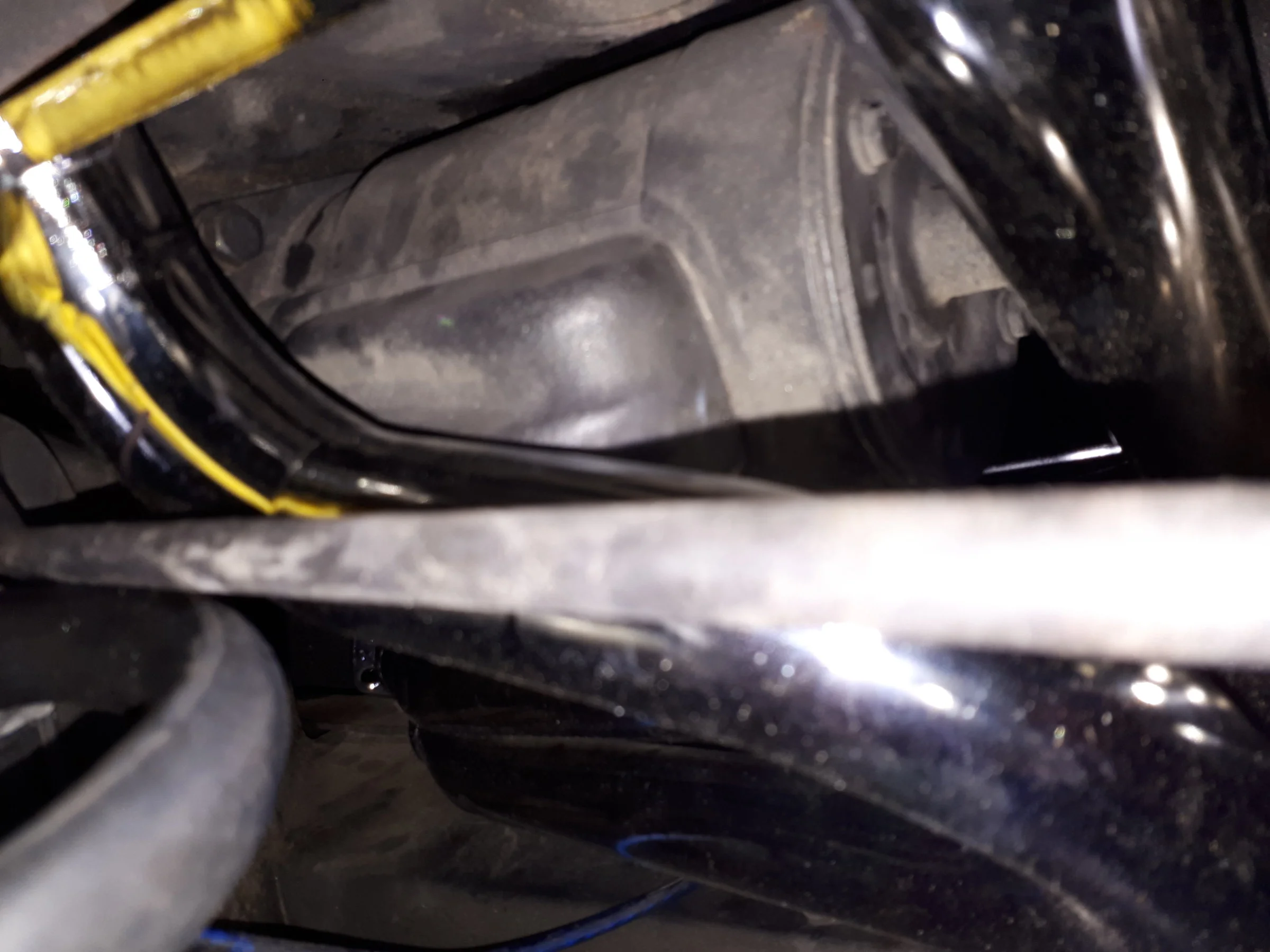

Hey everyone!!!! We just got our Scott drake dual outlet header and are having some clearance issues with it hitting the starter . Have read that you can massage the tube with a Ford BFH, but I'm really not happy about mashing it to fit. Was hoping that someone out there would no of a mini starter that would fit. We have a T-5 transmission and the starter that is in her now is a 2 bolt. The solenoid is mounted on the firewall not on the starter itself. If you need me to give you more information just tell me what you require and I would be happy to get it for you as I will not be sleeping period. Lol. Thanks for your time everyone

i think there is a mini starter that fits, but i cant remember where it comes from. you might ask this question at fordsix.com as someone over there is run into this issue.

Ok cool. Thanks for clarification on the FE abbreviation and the flywheel teeth. I guess here's the big question. My pop's is a old school gear head. I've been pulling wrenches with him since I was 6. He's always been able to "make it work " by whatever means possible. He has mentioned instead of mashing the crap out of the header tube rather use his hydraulic press and put a soft dimple in the tube to clear the starter. Now this would likely work but what about the heat? Would this get the starter? Furthermore purchasing the mini starter if t didn't work I've read that because it is a electric part I cannot return it. Can't get one locally so would be purchased online. I do value your opinion and trust that it would work.. ugh so frustrating. What would u do? Massage the header or just bite the bullet and pay the 438.00 CAD$? Again thank you for responding and for your advice!

massaging the headers is rather normal in just about every install. heck i even had to massage my headers to clear the bolt heads so i could install and tighten down the bolts on my 66 mustang.
the longer you can make the dimple, the better. that way you dont lose airflow at that point, or you can at least minimize the loss. some guys will flatten a long portion of the tube, or more accurately they will oval the pipe. this has the advantage of maintaining the pipe flow area while still gaining the required clearance.
speaking of clearance, as long as you have at least 1/2" of clearance with the starter, you should have no issues since you dont use the starter all that much.
another option to gain clearance with the starter is to heat the pipe up and bend it while hot to gain the necessary clearance. to do this you might have to R&R the header a few times until you get the clearance you need.
as for the starter itself, what you might do is head on down to the local classic car junkyard, and grab a starter off an FE engine, and bolt it to your motor to see if it fits the way you want it to. your investment should be around $10, which you can recoup by rebuilding the old starter and selling it on craigslist.
if you get a mini starter for your motor, get one that you can "clock" or change the position of the solenoid to provide clearance for the header.
I would recommend doing this with the heat wrench. If you can just heat the primary tubes up and bend the header a little bit, that is better than the BFH method. You should also probably buy some heat wrap and wrap the header to protect the starter. You can also build a heat shield for the starter but you might not have clearance for that since you are already having problems with your existing starter.

good call on the heat wrap rusty.
