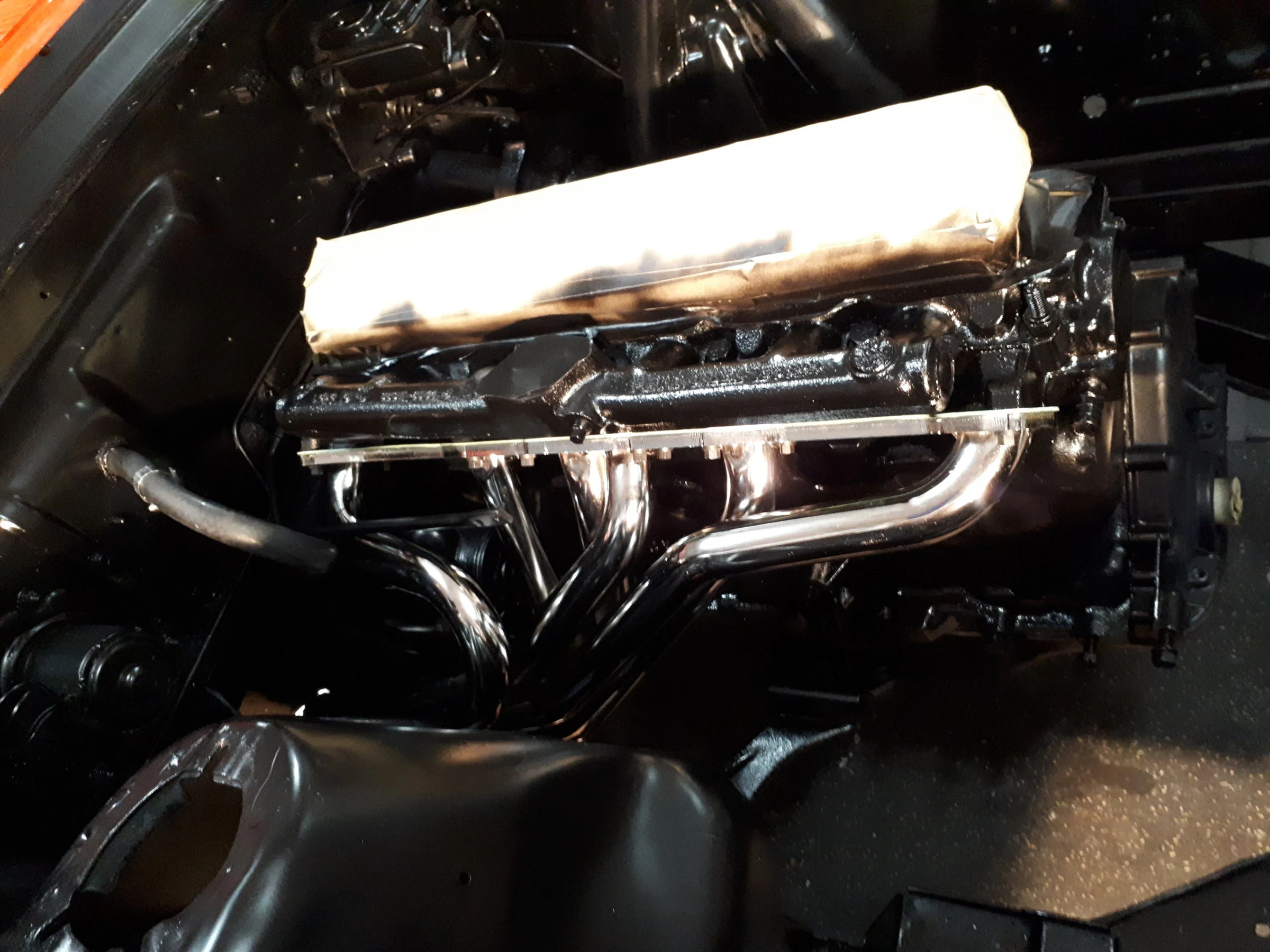

Here are some pics with it installed. Yay!!!

Hey Richard. I got it from CJ pony parts. After flattening the tube a little with my pop's and his hydraulic press it went in no problem . Have just about 1/2 inch clearance from the starter now. And thanks Richard
