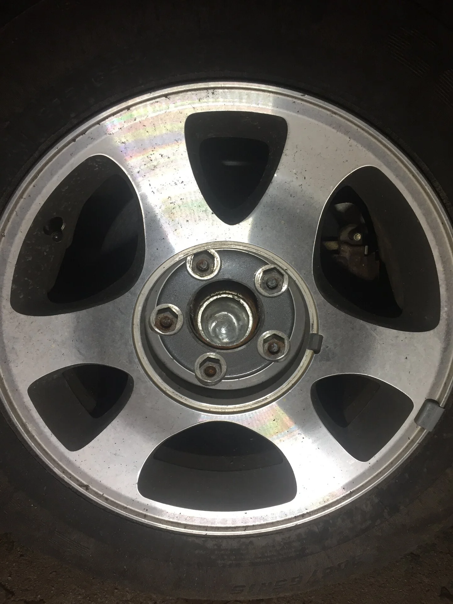

So my new to me 66 i6 coupe has 5 lug on the front and back it still have drums in the back and calipers in the front now previous owner said the guy he bought it from did the swap and did not have any detail on the swap, all i know it has 17inch wheels cause the stock 14inch wouldn't clear the caliper.

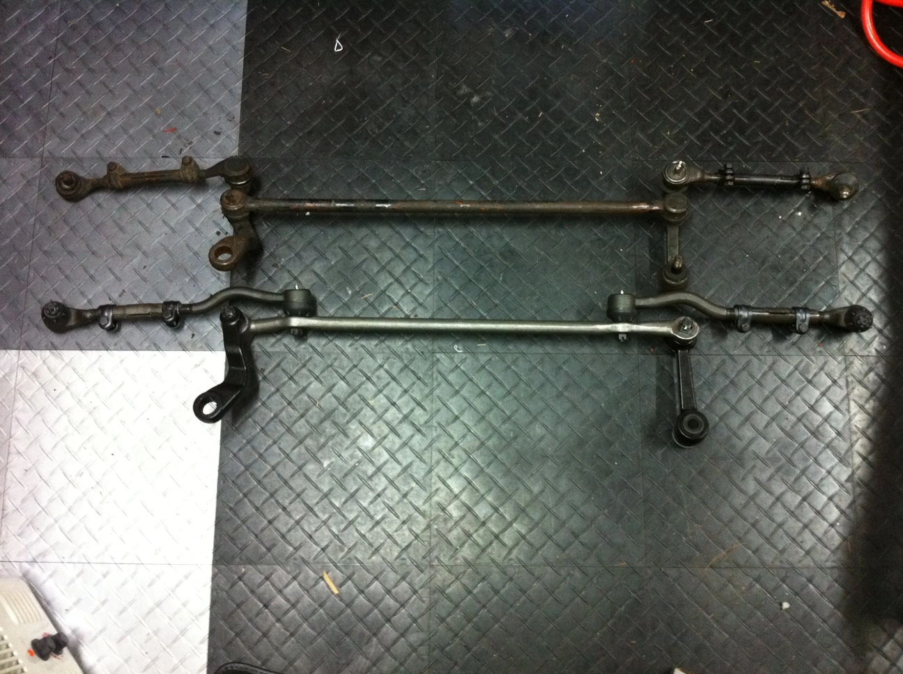

the popular disc brake swap for many years was the granada front disc system. they were cheap, easy to get parts for, and bolted in place of the stock spindles with a change of tie rod ends. the years of parts you would be looking for are 1975-1980 granada/monarch.
my advice would be to take the calipers and rotors down to your favorite parts store, and have them match up the components with what you have. they can start with the part numbers on the components and work from there.
as for the kit you are thinking about, i would buy the tie rod ends separately, and wait on buying them until you have verified the spindles you are using.

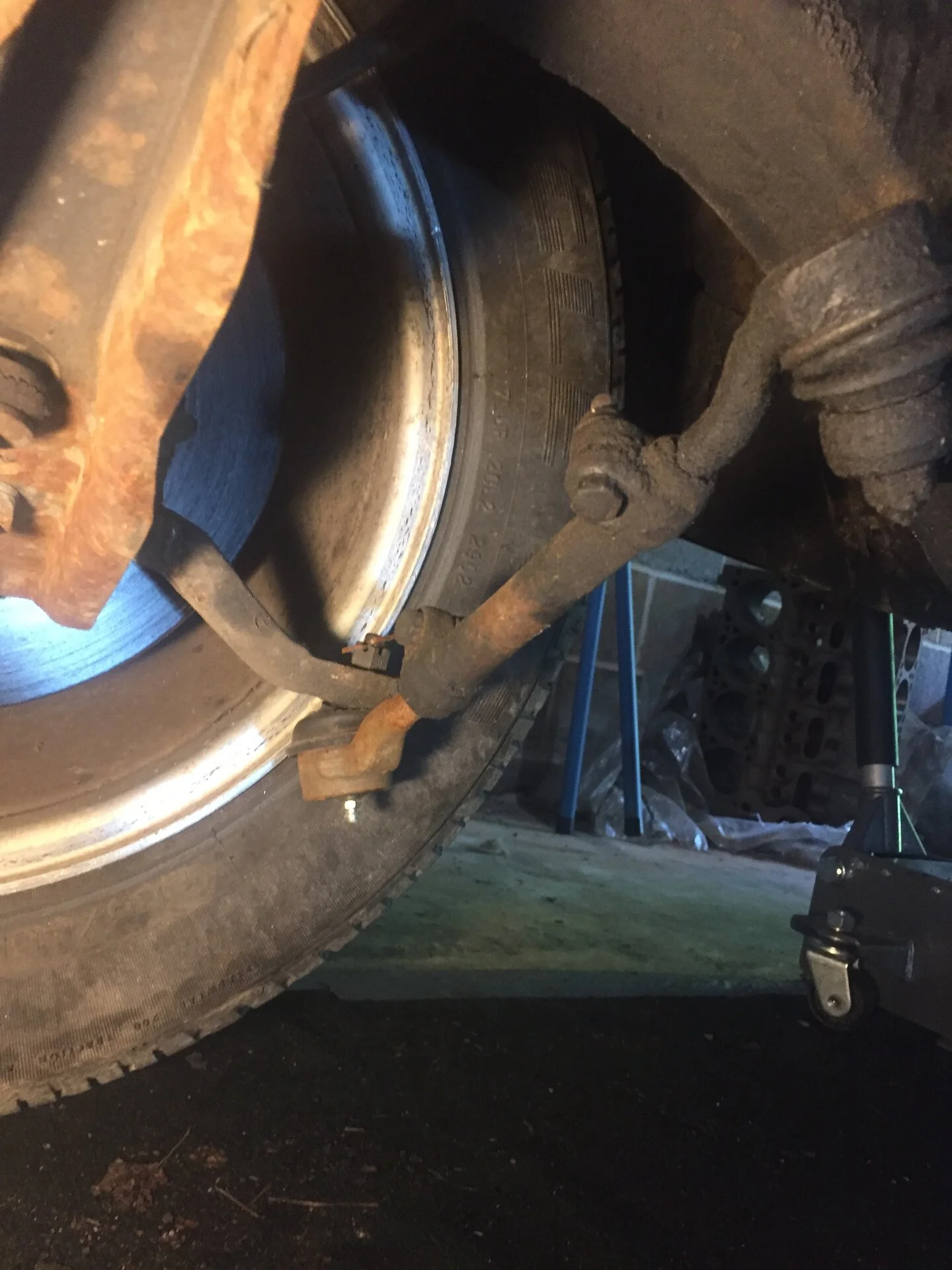

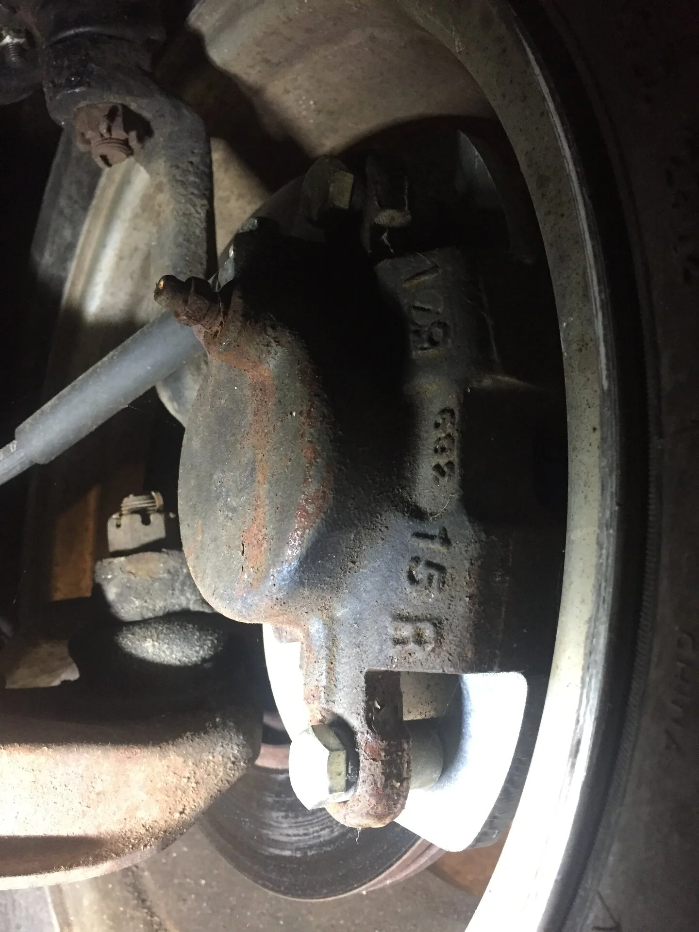

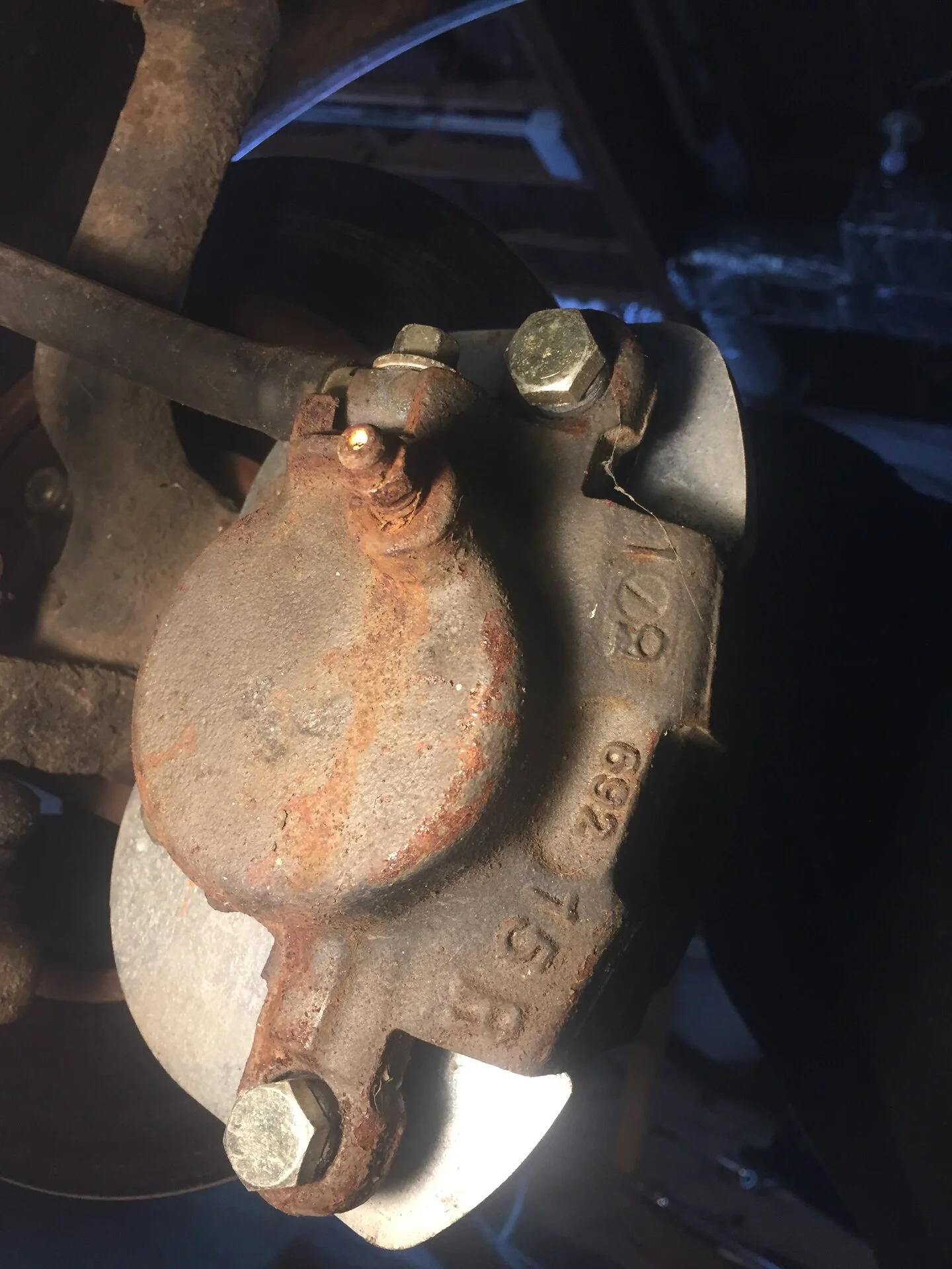

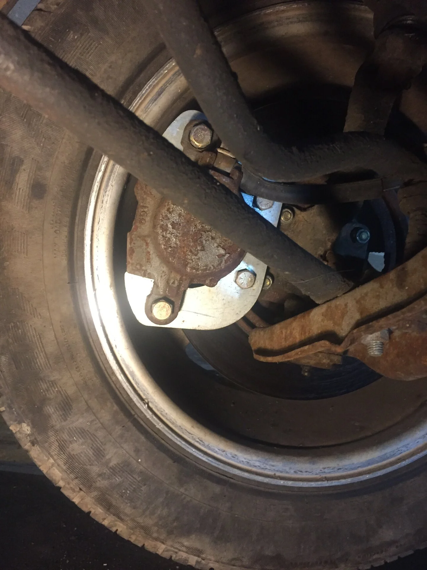

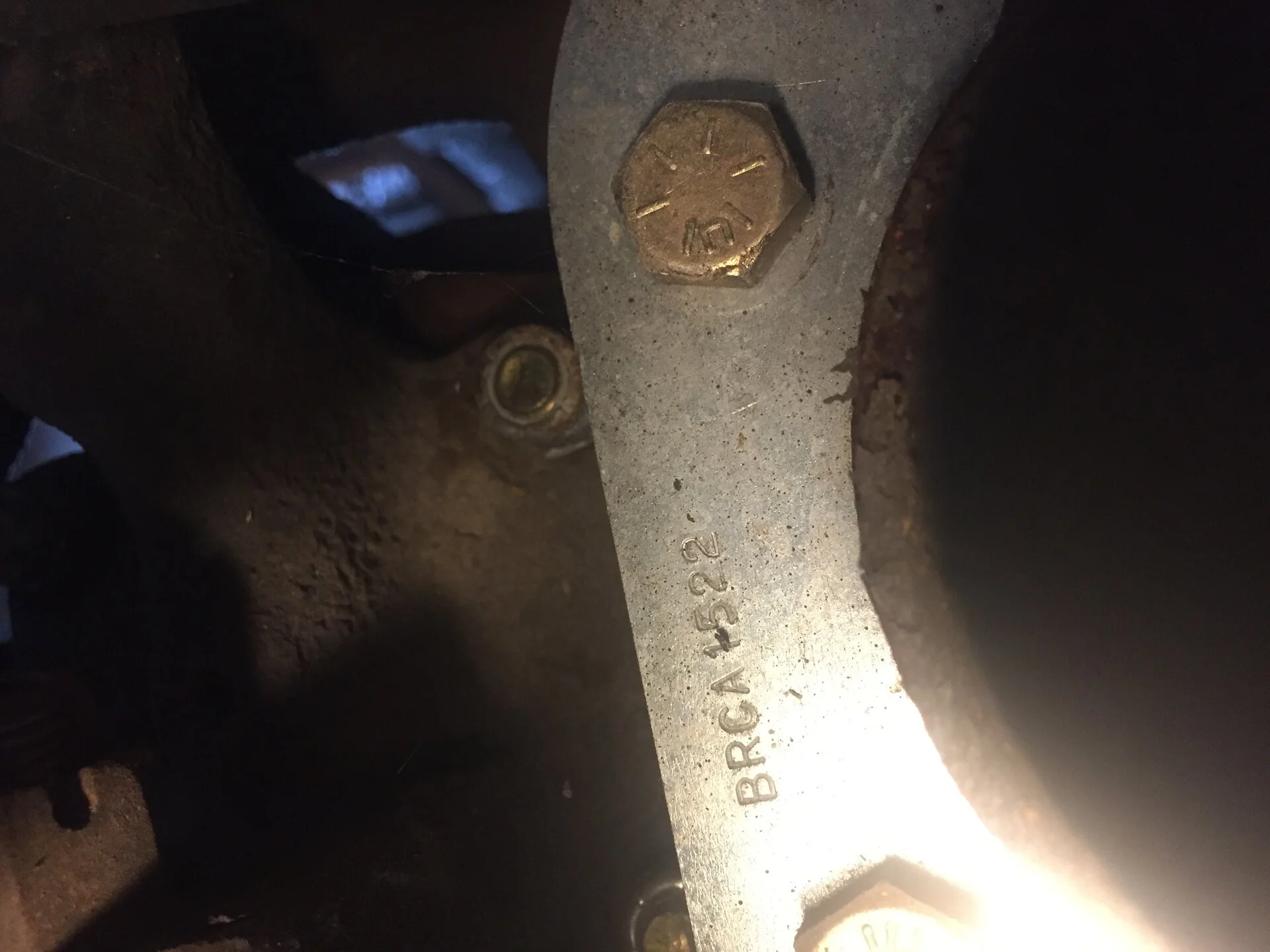

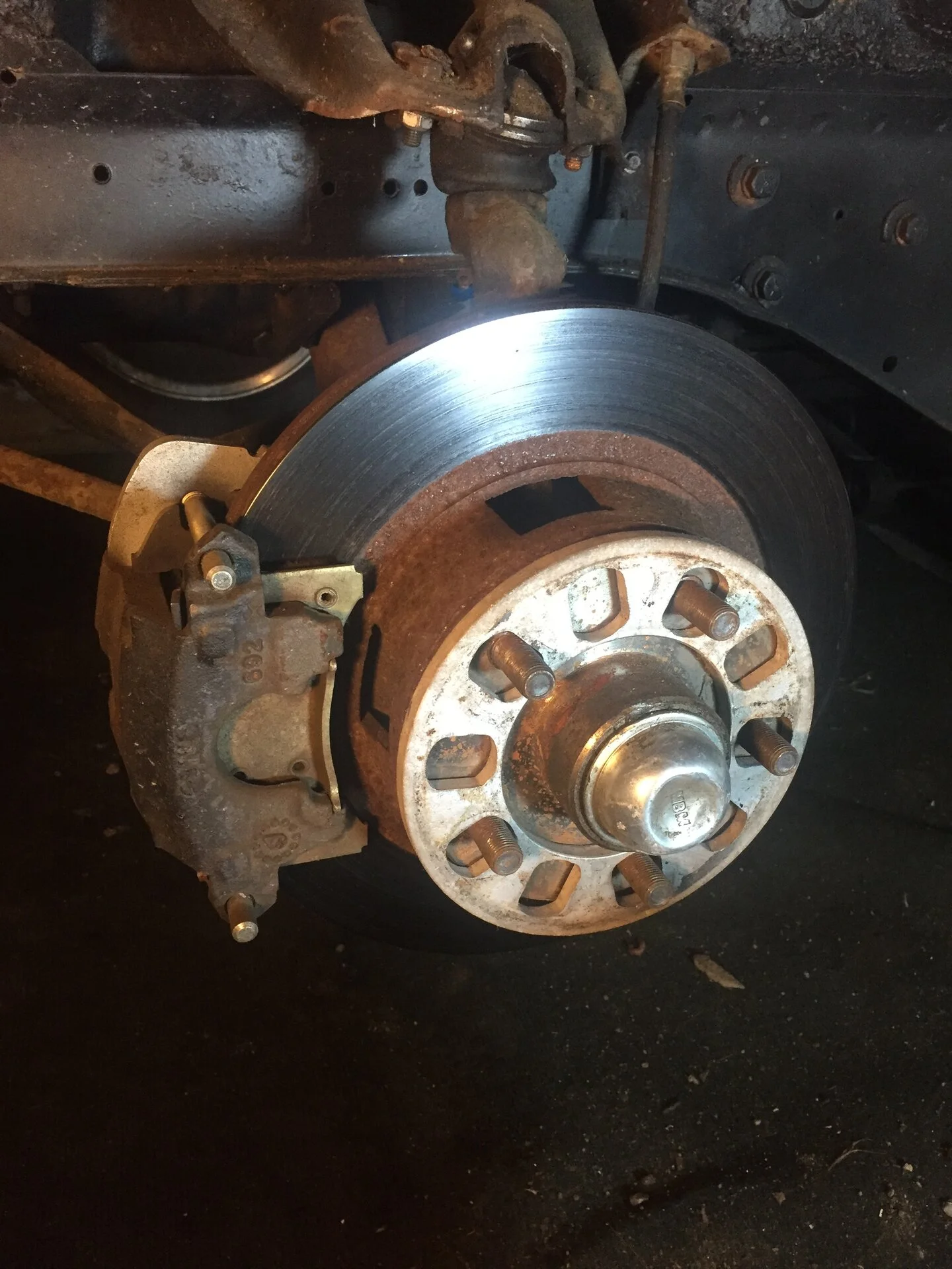

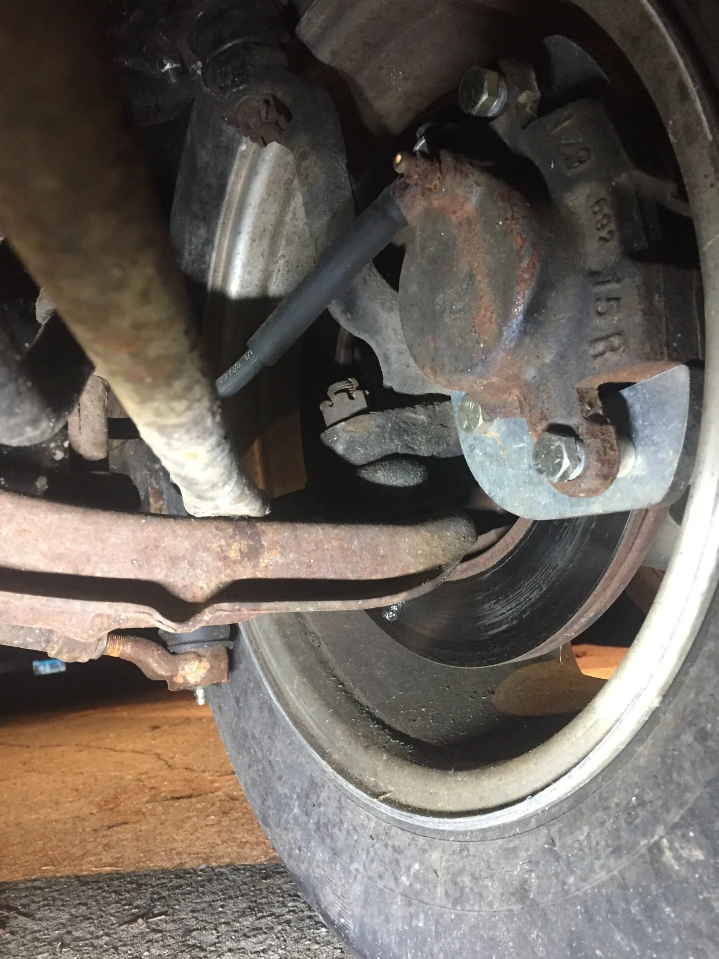

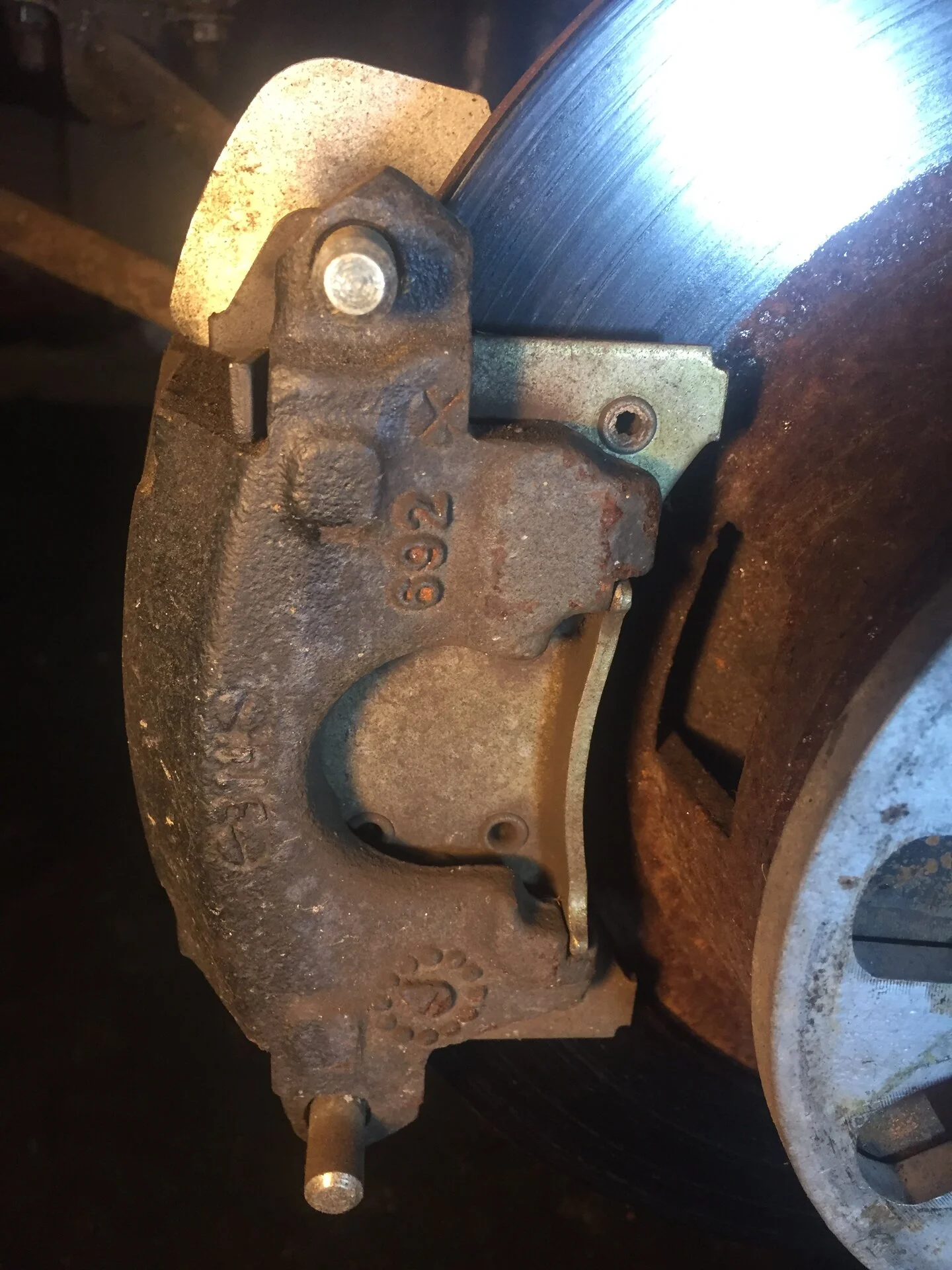

Ok so had some other maintenance to do on other cars but finally got garage space i pulled the mustang in and took the wheel off and this is what is on the car...I know i need to look into a bigger space because on U turn the tire hits the top of the control arm, but does this 5 lug disc brake set up looks like the granada?
UPDATE: i found out the calipers are from a 1979 monte carlo
