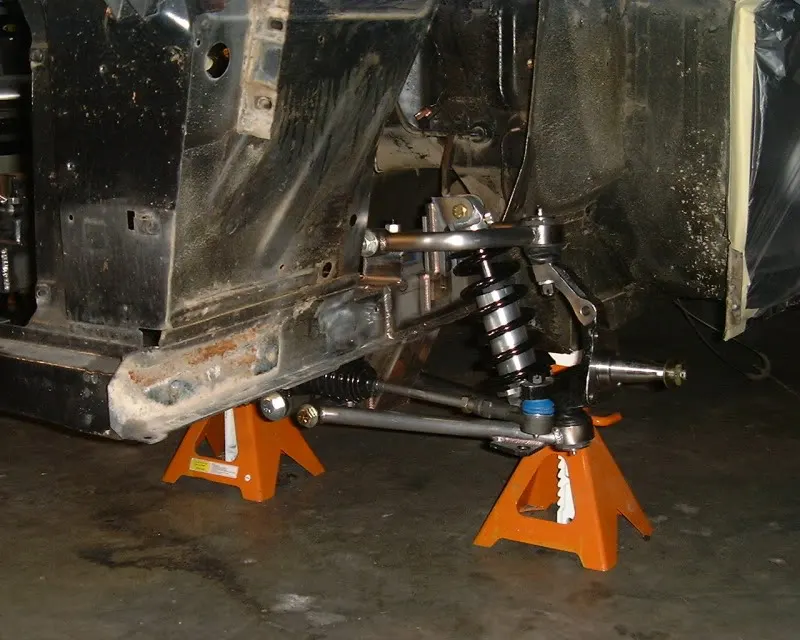

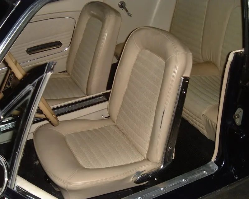

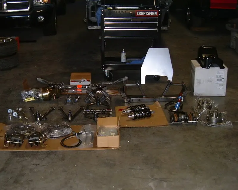

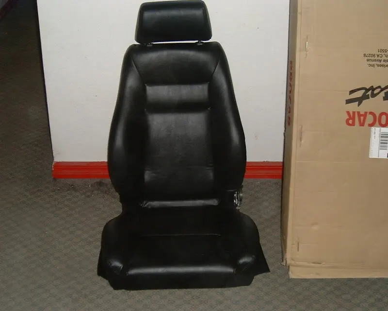

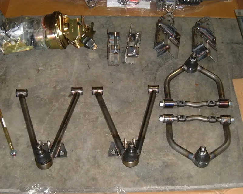

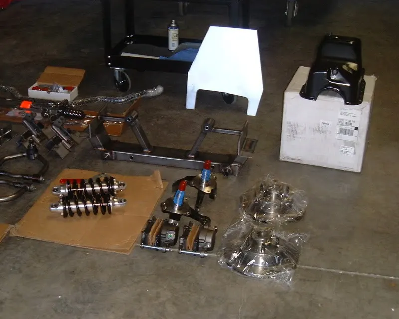

We will be starting a new project this nice 1966 Mustang. No rust repair but we are making it a restomod. We are waiting for the Rod & Custom coilover front suspension and rear disc brake kit to come in also Procar Elite seats.

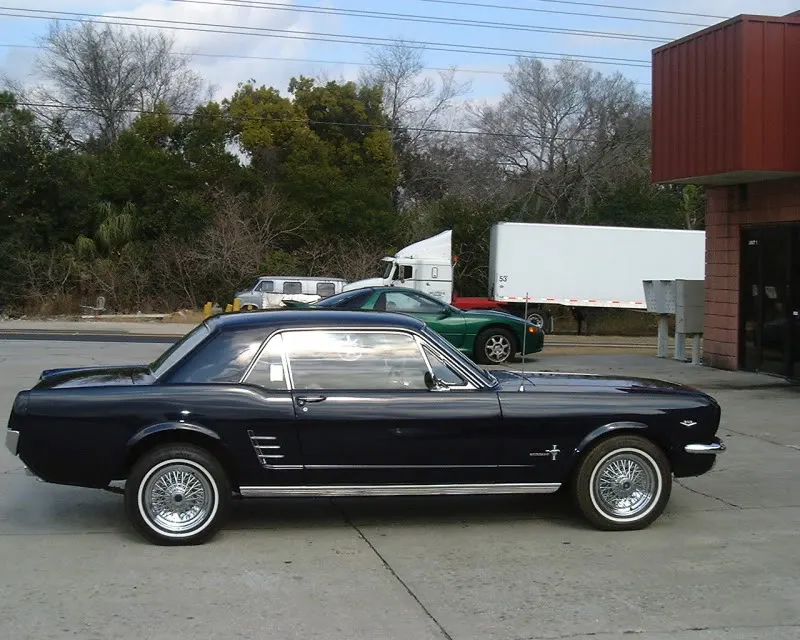

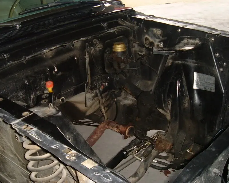

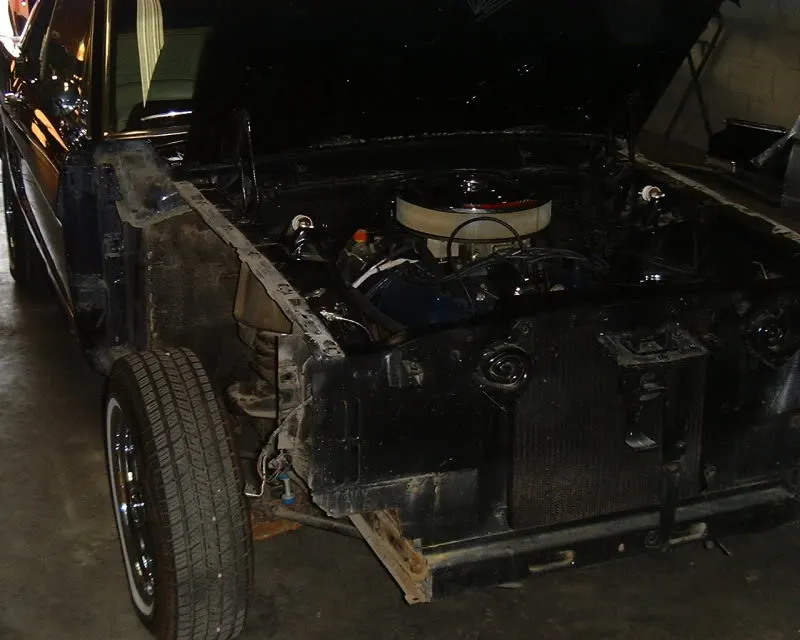

This is what we are starting with

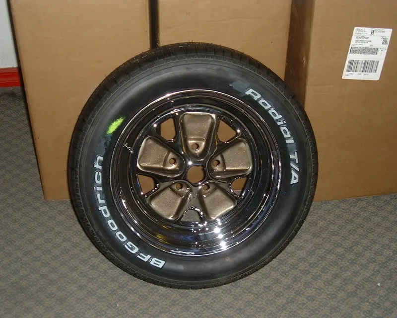

New 15" steel style wheels & BFG tires
Flaming River tilt steering column and wheel
That looks like a nice 66 minus the wheels. Eww. Great choice on the wheels for replacing them. What do you mean by cut it up? I hope you don't cut it up too much.

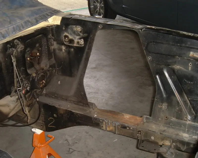

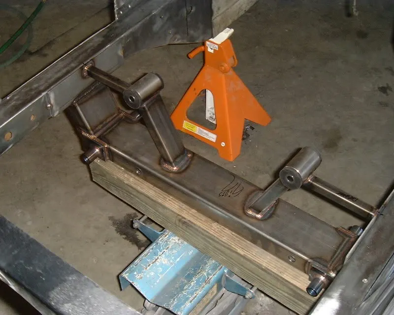

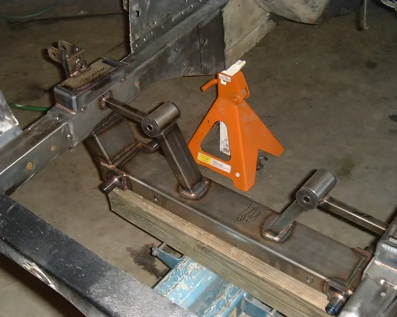

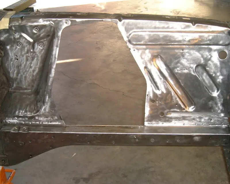

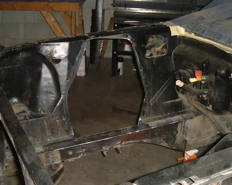

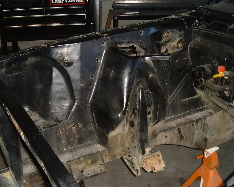

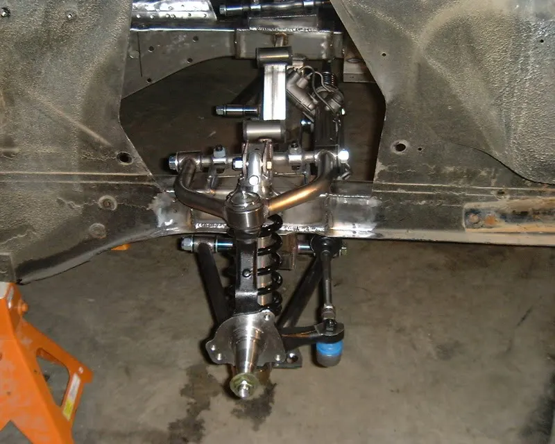

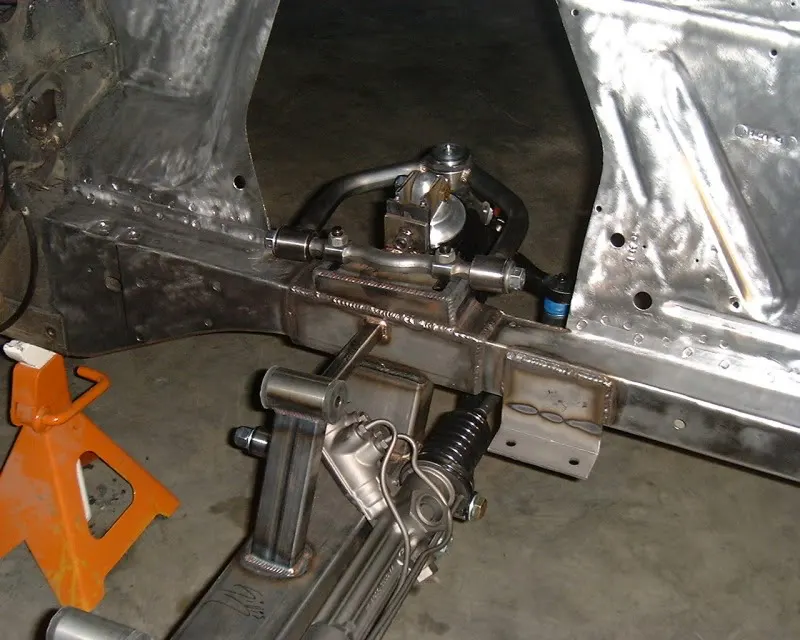

Why are you removing the shock towers? Big block or mod motor?
Why is it a good candidate for a fastback conversion? I would not eve consider doing that, its in too good of shape.

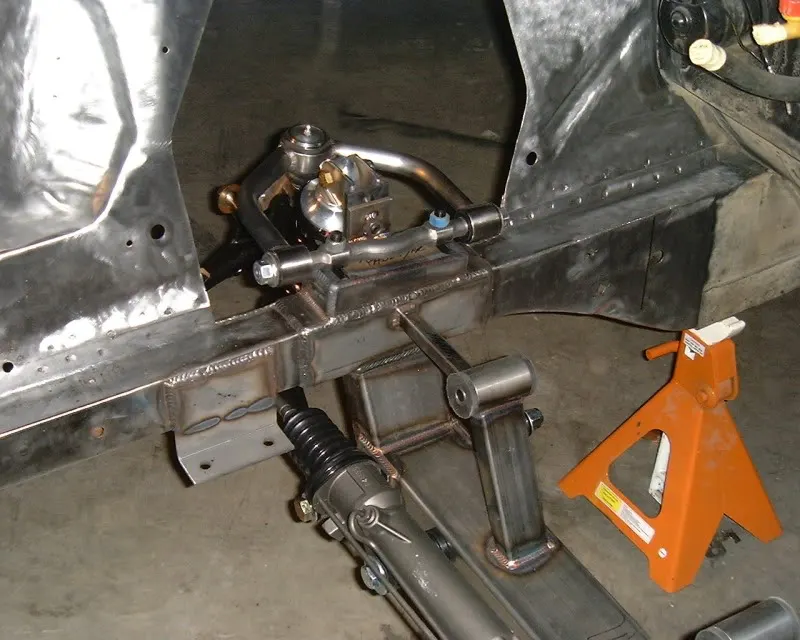

The shock towers are being removed to install the Rod & Custom coilover front suspension with rack and pinon and disc brakes. Engine is a 289. We are not doing anything to the body at this time.

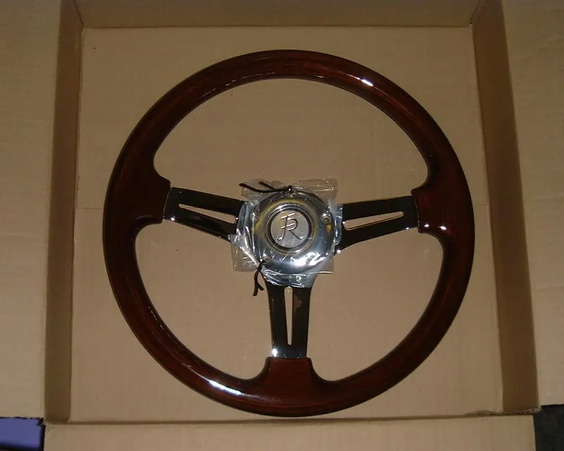

Nice steering wheel!
