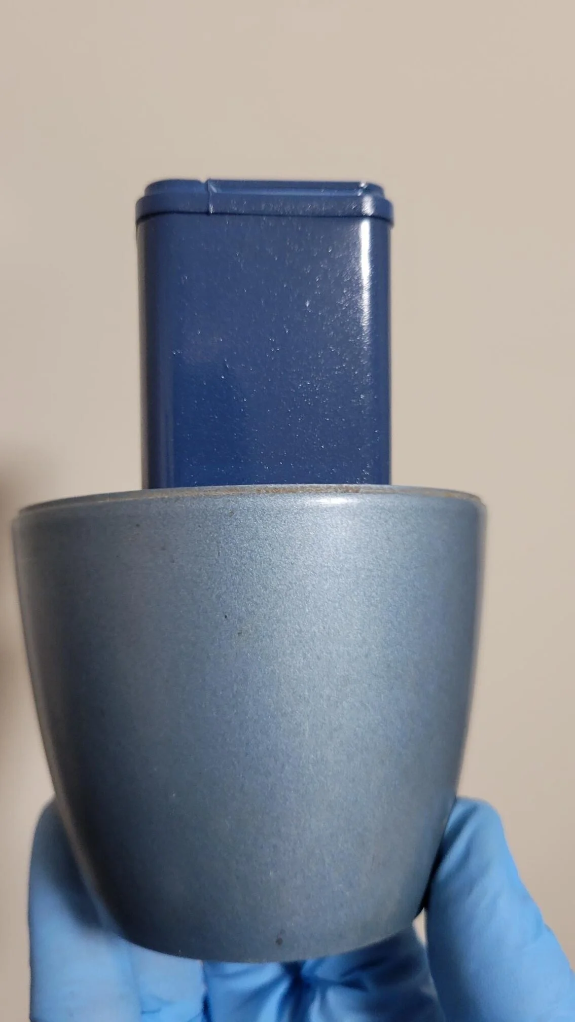

Realmongo - I see you also have an arcadian blue car. Mine is a 1966 with a trim code of 22. I have been trying for a number of weeks to figure out what paint I should use for refreshing the interior paint in my car. I have the steering column off so it would be a good time for that. My problem is that I have seen references to colors, but only descriptive references that I have not been able to translate into a can of paint. I did talk to someone at NPD who directed me to their Seymour lacquer AP-5748. The attached photo shows the color of the steering column bell compared to the AP-5748; even accounting for a little fading, I think it is too dark. I am wondering if you have a recommendation for a specific paint/mix that would more closely match the original metal interior color.

That upper color looks like 1965 interior blue.
