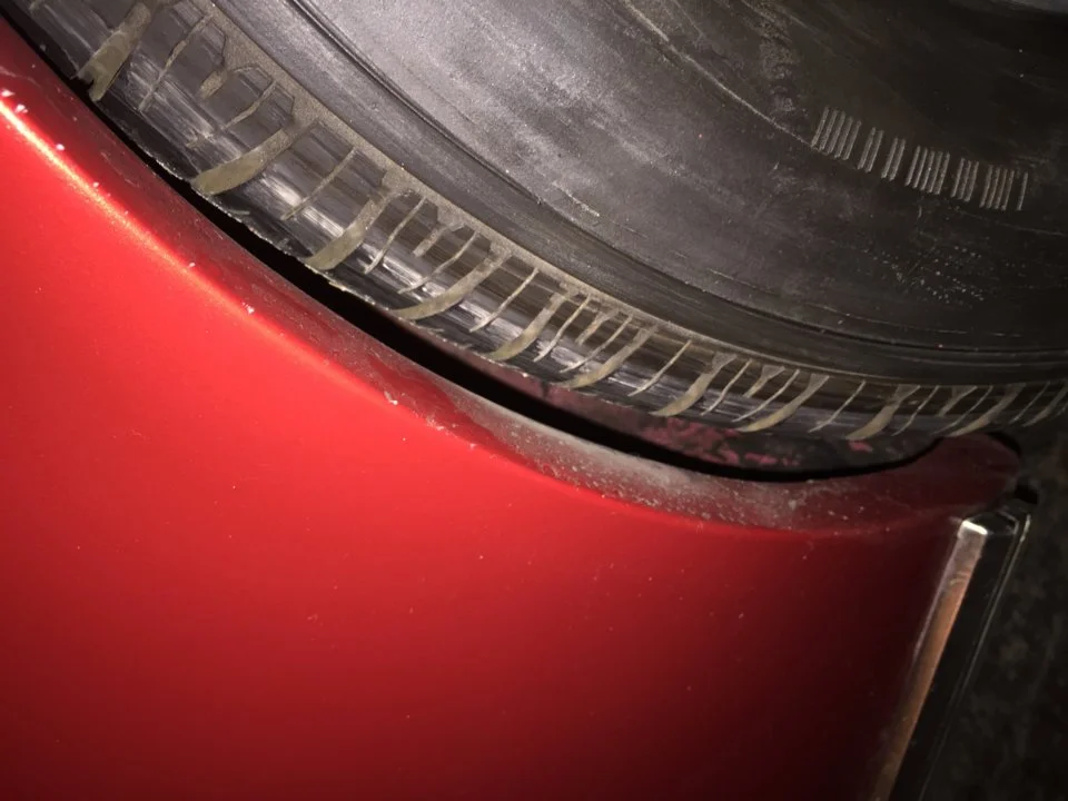

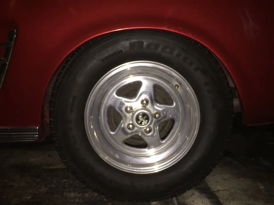

So lets start with i got a great deal on a set of 5 rims with brand new BFg radial t/A's ($600). 205 60 15 in front and 255 60 15 in rear. I just replaced all 4 shocks and front springs ( have not replaced rear leaf springs). Noticed the rear end of the car sits 1 inch lower than the front.
Wanted to know if I replace the leaf springs will these tires fit?
If not what size tire should I replace them with?
Seems like most people run 245 60 15 or smaller
Thanks Justin

I think 235's are the widest depending on the wheel width and backspacing. Leafs will have something to say about it as well. I had 245/60/15's on 8" wheels on my 65 coupe rear and had some rub over bumps. I switched to the 1" extended shackles which raised the rear app. 1/2", this solved my problem. I do have Eaton GT rated leaf's on the rear which lowers it some as well.

255 60 15s are way to wide. 245 60 15 will not clear on a 56-66 with out rolling the wheel lips and working the inner wheel tub .They will clear a 69-70 but they are tight there as well .235s should clear but it will depend on the wheel offset .

yes 255's are just too wide for the early mustangs. i usually recommend going with a 225 or 235 at the largest.

Nice wheels

its not the tires, the wheels are the wrong offset. I have 18X9.5 on the rear with 275/35/18 and don't rub.
