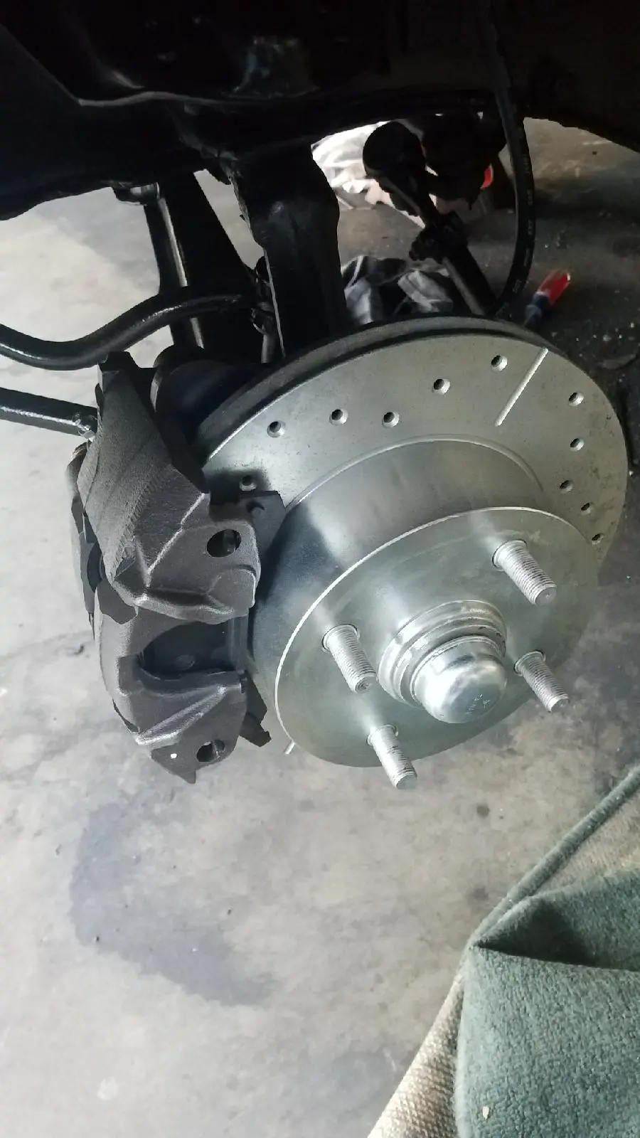

1966 sprint model front dics brake upgrade
I installed this kit from Toms Classics

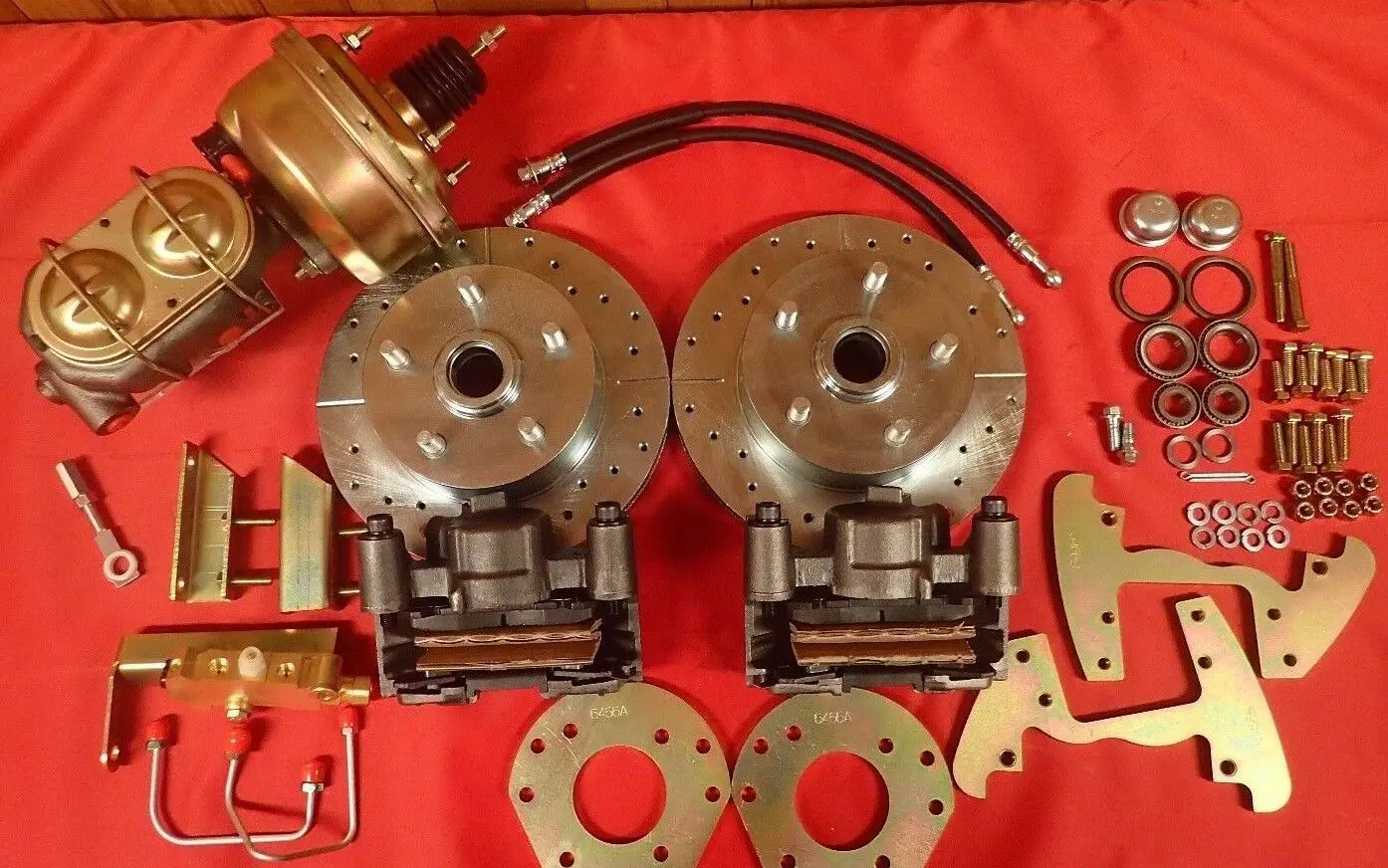

This is the master i have
Kit Includes:
7" Brake Booster with Mounting Brackets and Clevis Rod
Fits Models: 1964-1966 Ford Mustang with Automatic Transmisson
The pedal goes down 2 inches before anything happens it doesnt feel like power brakes at all and to get the car to stop you have to stand on the pedal theres 17lbs of vaccum at idle and theres no air in the lines .
The place i bought the kit from thinks its a bad power booster and they have sent one out just waiting for it to get here.
