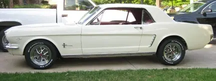

The following pic is of my setup on 15X7s with 225X60X15 BFGs. I get no rub and have lowered, at least, 1" all around.
Thanks Poppy...no rub, that is amazing.
I was just going to do an Opentracker suspension...mid-eye rear leafs...slightly lower than stock.
an additional FYI, I didn't have any rub when I was running the Shelby 1.5" drop in front, as well.
The dia. of this combo is only 25.6". My spare tire is a 205X70X14 BFG combo and is only 25.4".
Hope this helps!

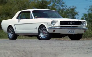

My SS wheels dont rub ever, at 15x7. using BF 225x60x15 However it seems variables in builds causes rubbing on some 7" for some reason. My car is lowered 1.2" 1965 Coupe Front low med.webp
