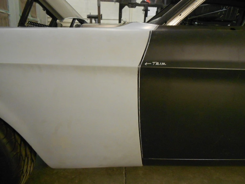

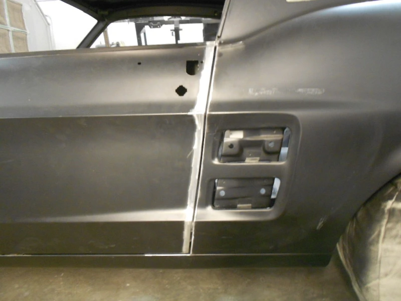

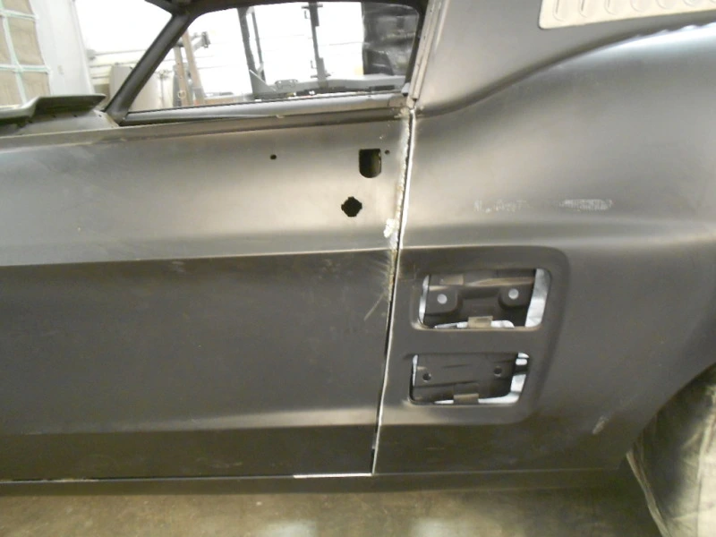

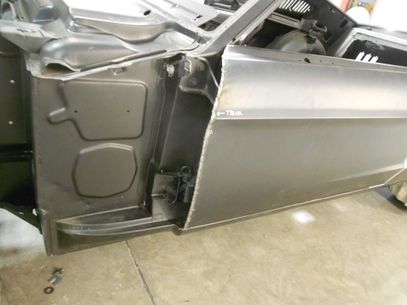

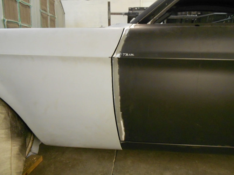

The deck lid fit great but the doors, fenders and hood are another story.

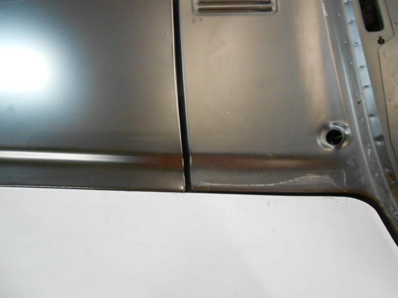

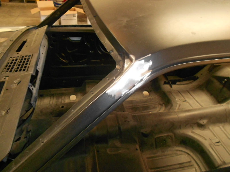

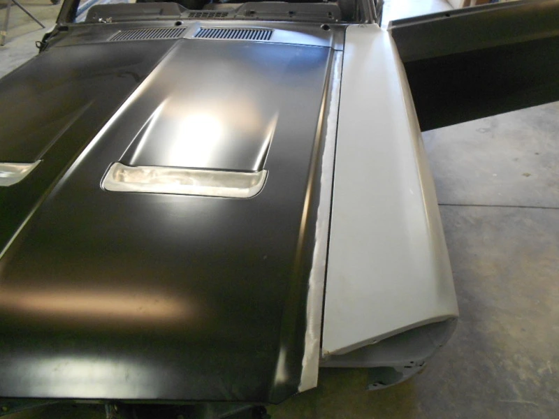

Once the fender apron holes were modified to get the fender back so there was not a large gap at the windshield and front of the hood there was not enough gap at the door.

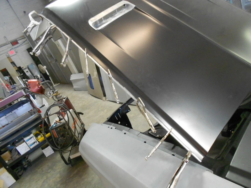

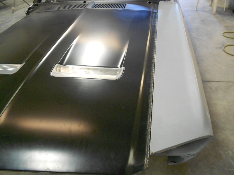

The hood is to wide at the back and will need to be trimmed

Anyway, it looks like the front of that fender could be low causing the door gap to be wonky, is the bottom of the fender sitting right once you get it twisted around right because it looks like its running uphill toward the door?
I am curious if the aprons are at the correct height to support the fender without a bunch of shims under them? If that rad support is low I could see the fender doing that.

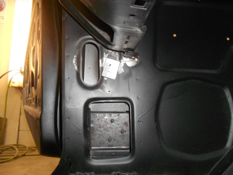

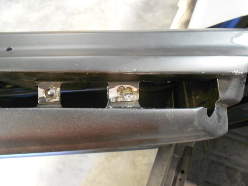

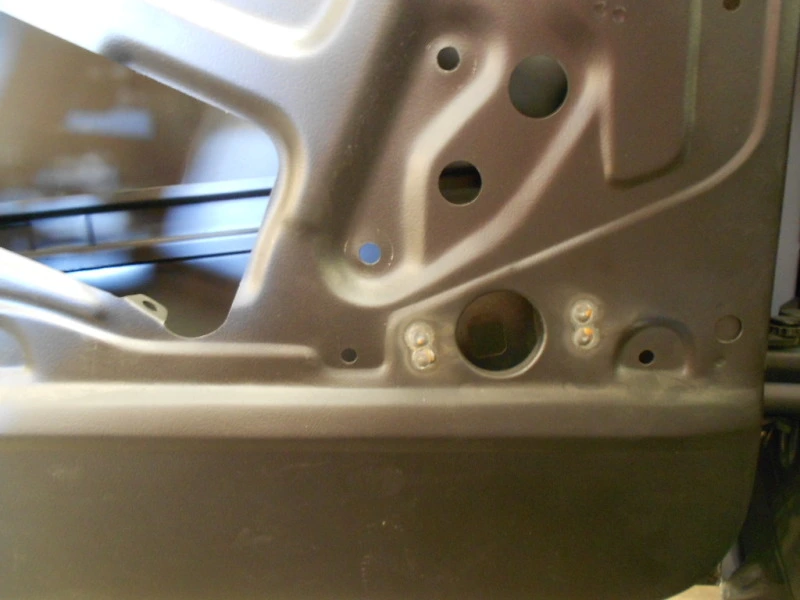

The left vent window would not fit so Brian had to drill out the spot welds and bend the sheetmetal a little to allow the vent window to go in.
The bracket on the inside of the door where the bottom of the vent window attaches was in the wrong place and had to be moved

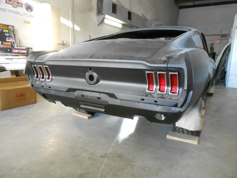

The taillights fit after trimming the rubber seal a little

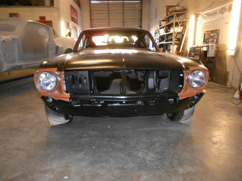

Once the holes on the fenders were elongated the headlight buckets fit

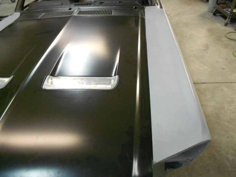

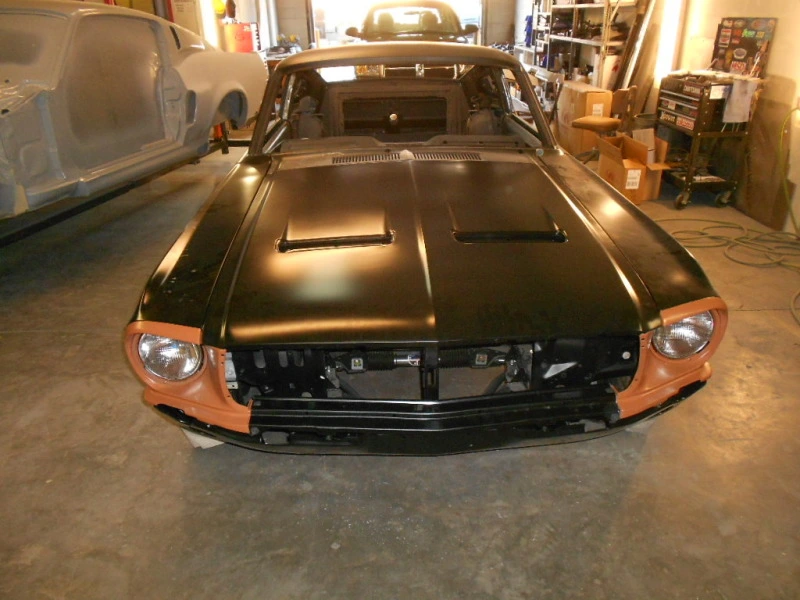

The amazing thing was after all the work on the door gaps the edge of the hood lined up with both headlight buckets from CJ Pony Parts. The Dynacorn headlight buckets have been on back order for over a month and I was told probably another two months before they would be available so we got them from CJ's. They are a little ripply and will require some blocking but they fit.

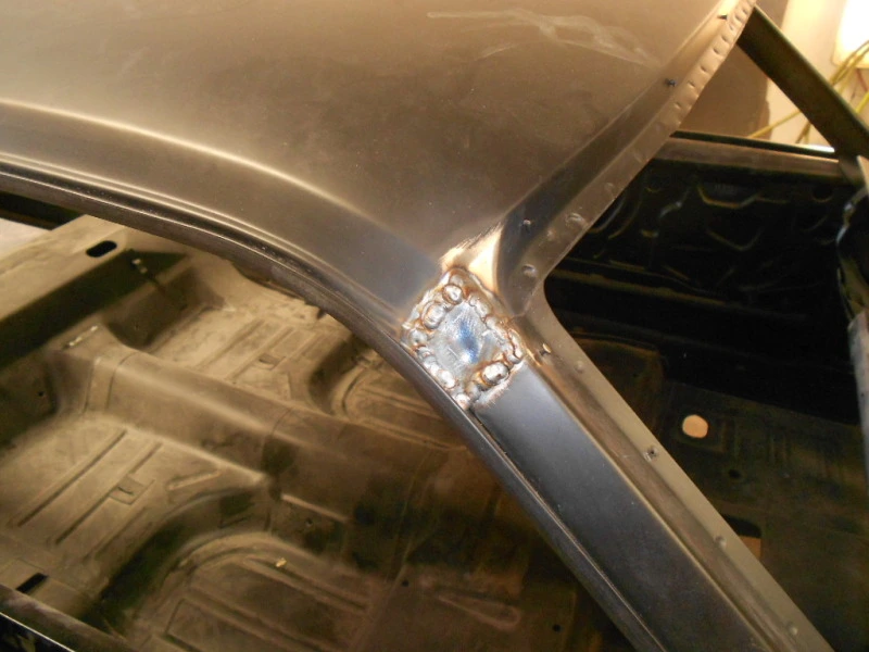

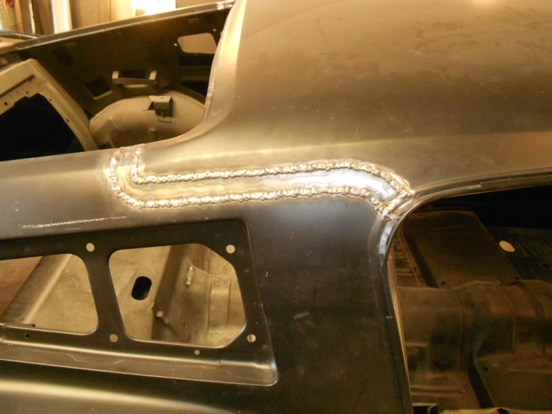

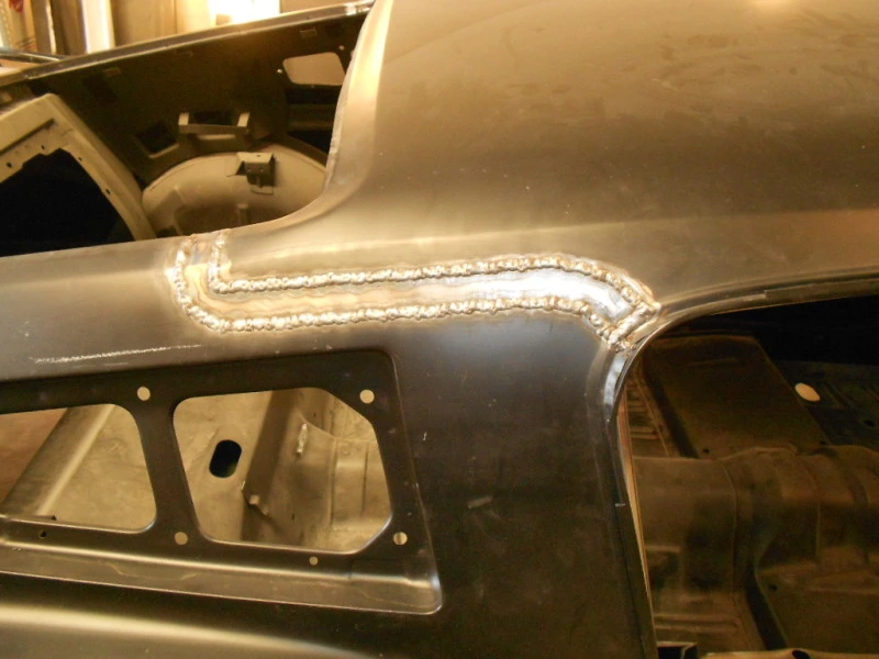

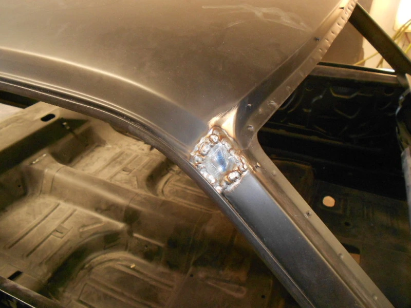

i always weld them to all the way around ,just for added strength. makes it a pain if you ever need to replace it but thats ok.
the cradle welded in is probably beter any way .more ridgid
Just a quick comment here. The above statement is incorrect. Our instruction sheets explicitly state that the brackets are to be welded with 1" long stitch welds spaced 1" apart.
I'm not calling you out, your first fastback conversions have been awesome, but I needed to comment on that for anyone who might read it in the future.
not a problem thats what we are here for , to learn :nice:
Awesome! :SN:
The reason we don't recommend welding all the way around is because the factory subframe rails can get overheated and become brittle. Stitch welding provides more than enough of a bond and spreads the stresses more evenly.

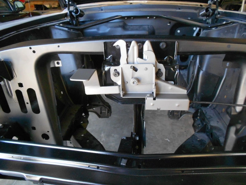

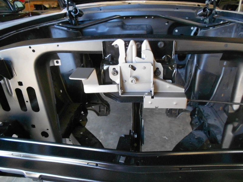

We have been working on a couple of things I can't show at this time. A modified lower front valance and a future story in Modified Mustangs & Fords magazine showing a period correct looking hood latch with an under the dash hood release.
But I can show this
This is what Brian has been fabricating. It is an under the dash hood release. The hood required a lot of fabrication along with this latch that came off of another Ford. To find out all the details you will have to read the build story in an upcoming issue of Modified Mustangs & Fords magazine.
