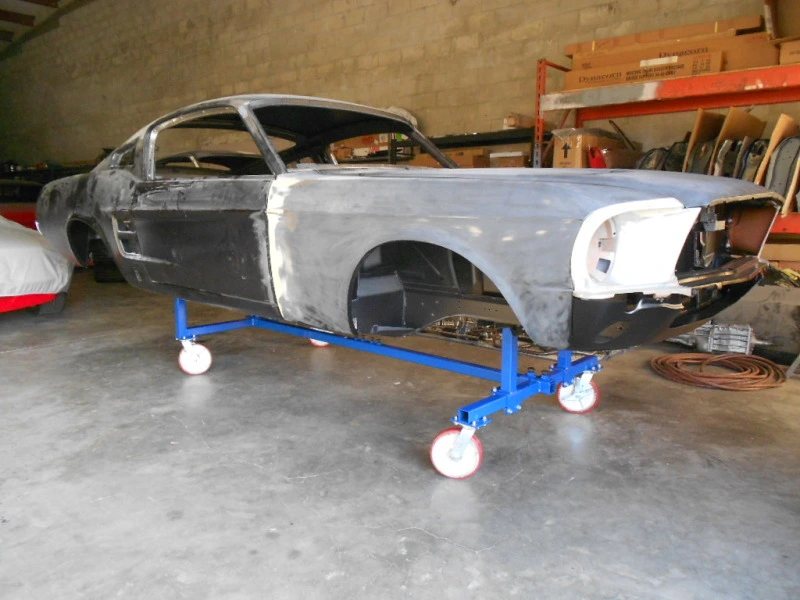

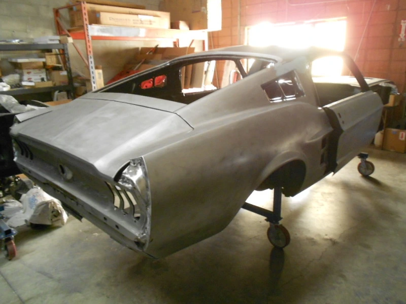

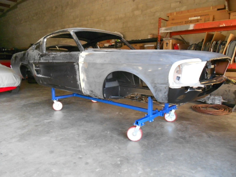

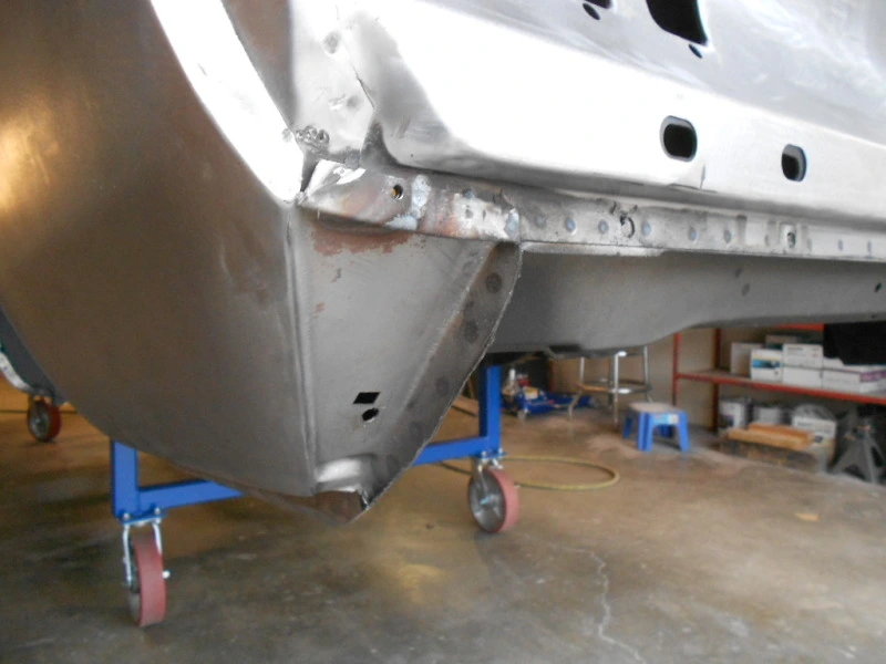

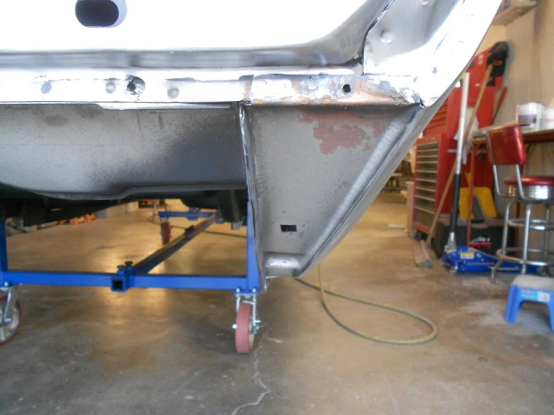

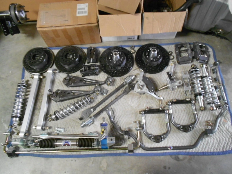

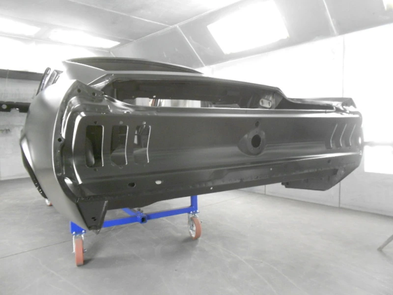

We removed all the suspension now it goes on a cart to prime and finish all the the bodywork

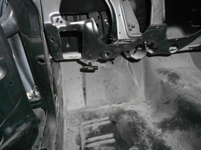

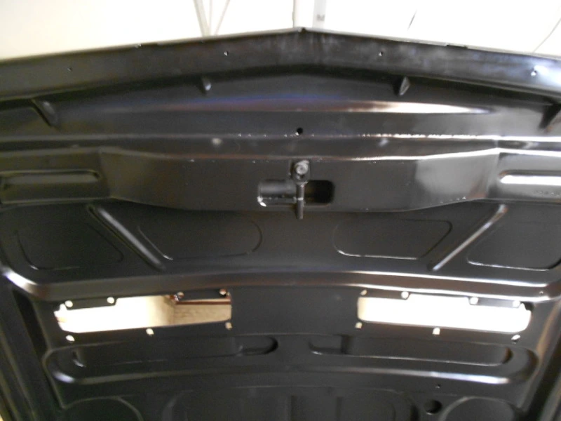

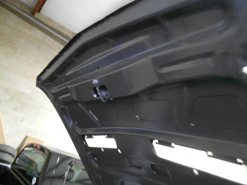

Read all about the under dash hood release install in an upcoming issue of Modified Mustangs & Fords magazine.

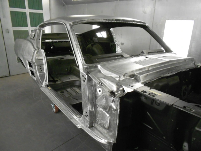

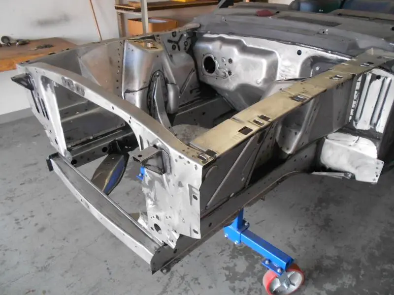

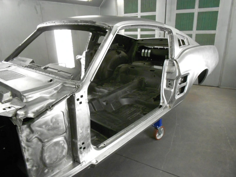

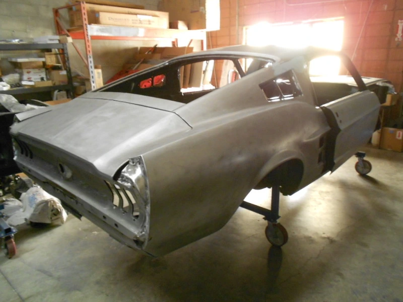

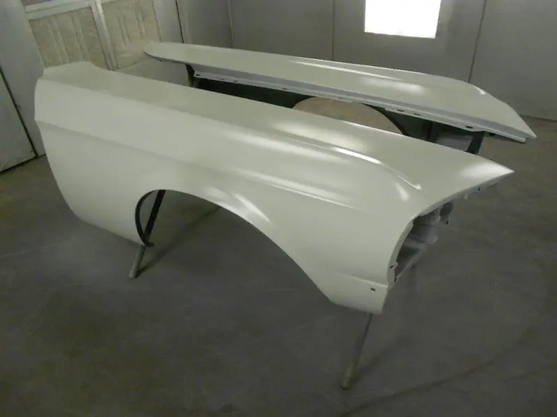

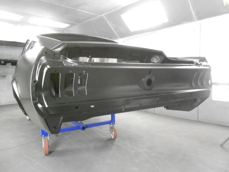

We have been working on getting the fenders, headlight buckets and doors to line up

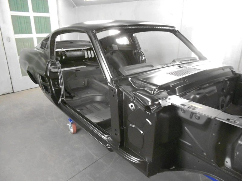

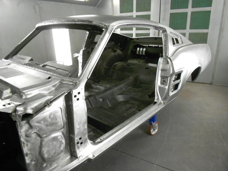

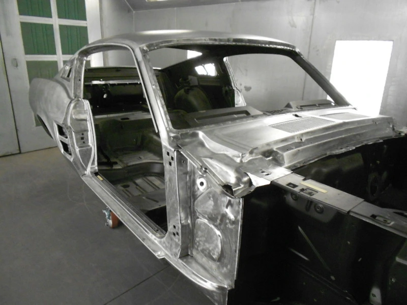

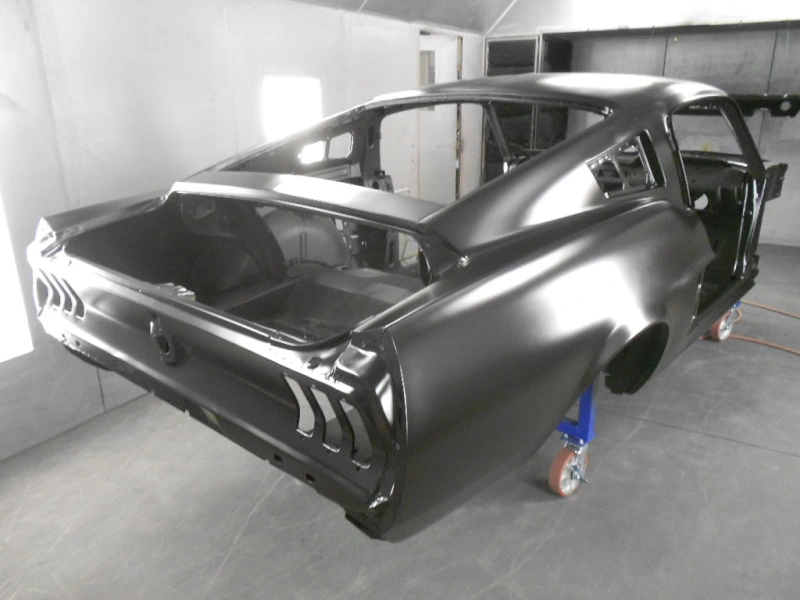

The body was sanded down to bare metal and the next step is spray 2 coats of SPI black epoxy

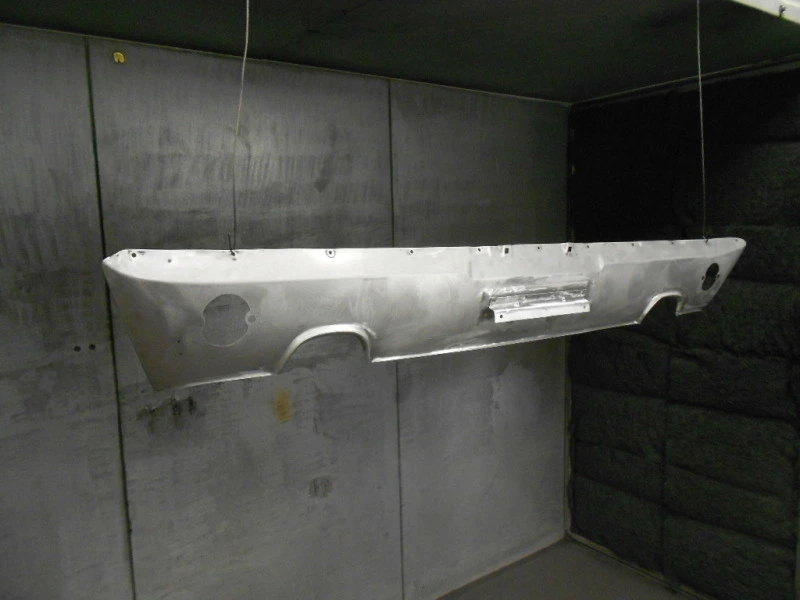

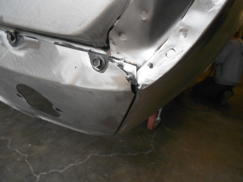

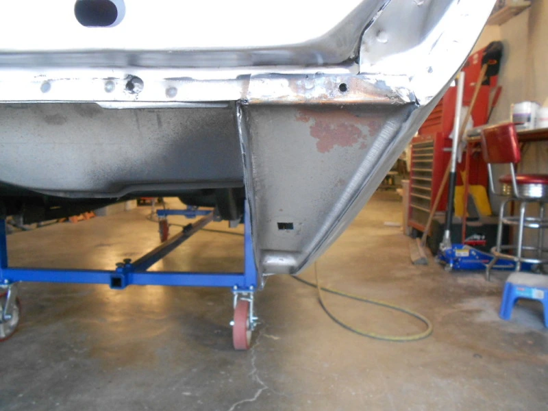

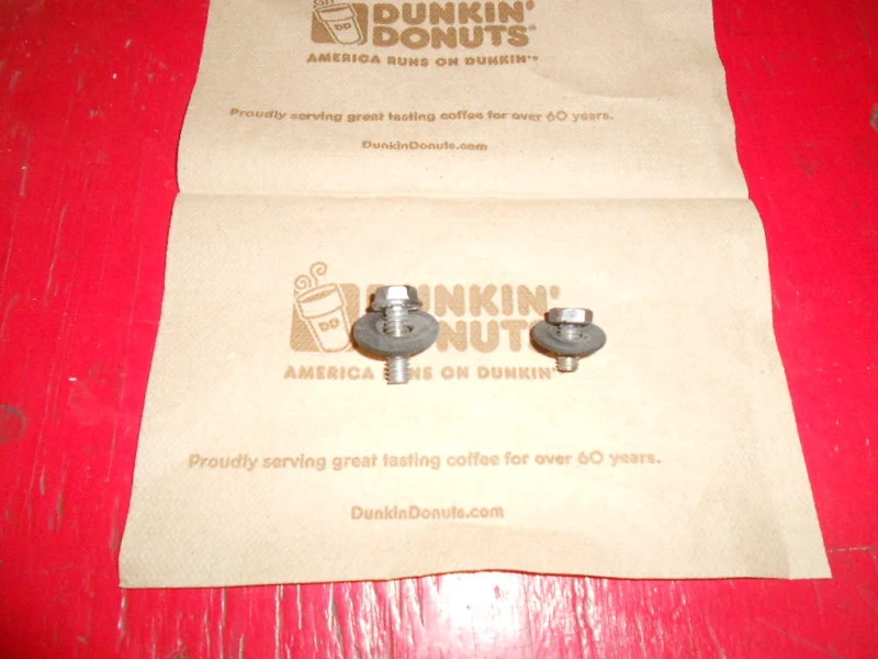

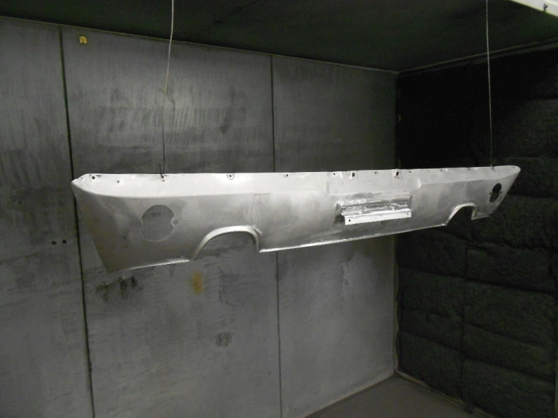

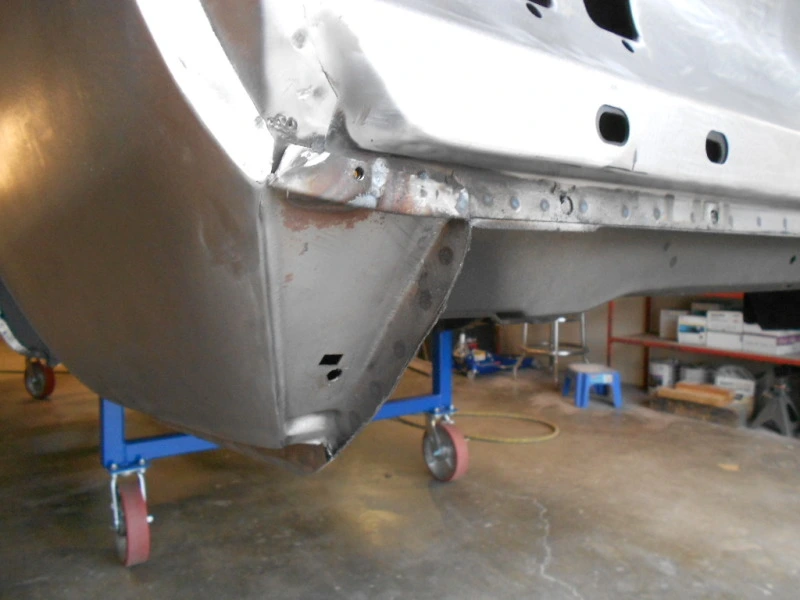

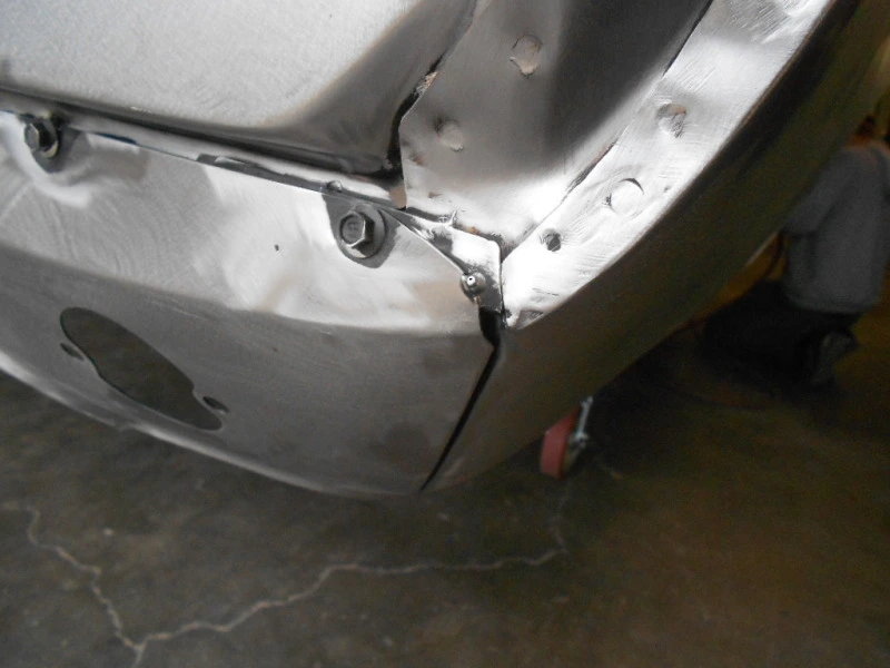

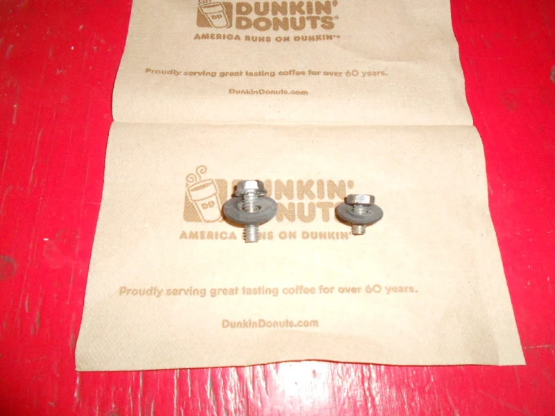

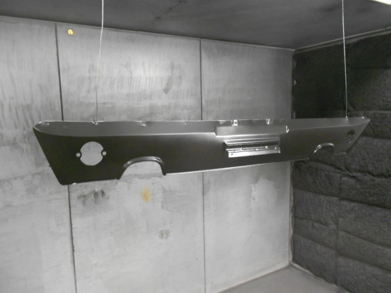

The rear valance had a tack weld and also bolts.
Instead of studs on the valance Dynacorn used 2 different size bolts and washers from inside the trunk and attached to clips on the valance
We wanted to take off the rear valance to see what was behind it and just as I thought bare metal and surface rust

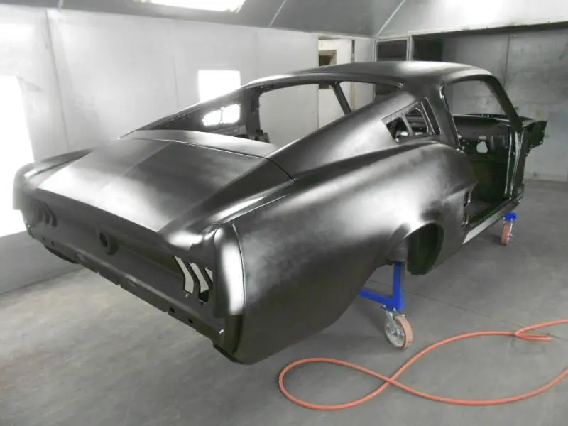

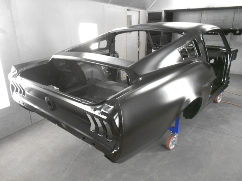

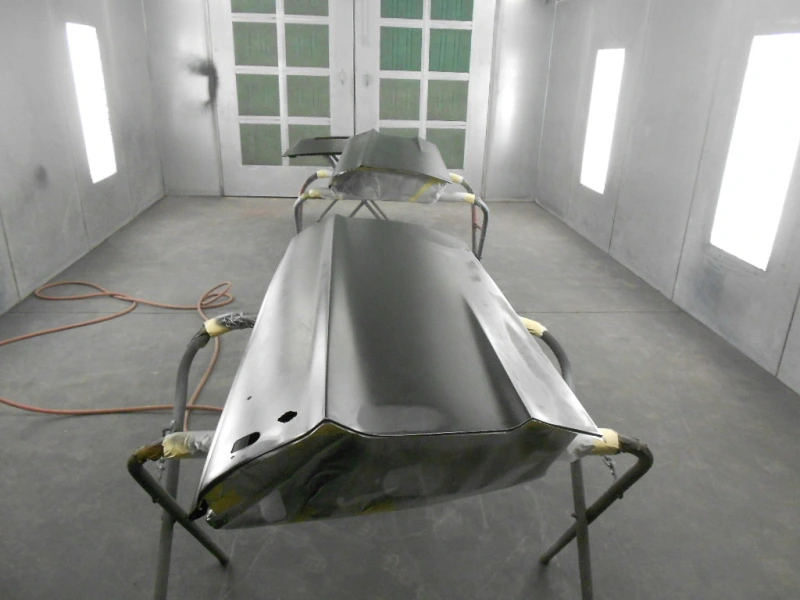

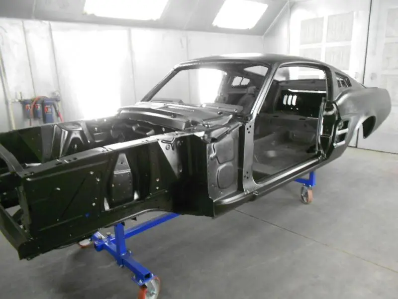

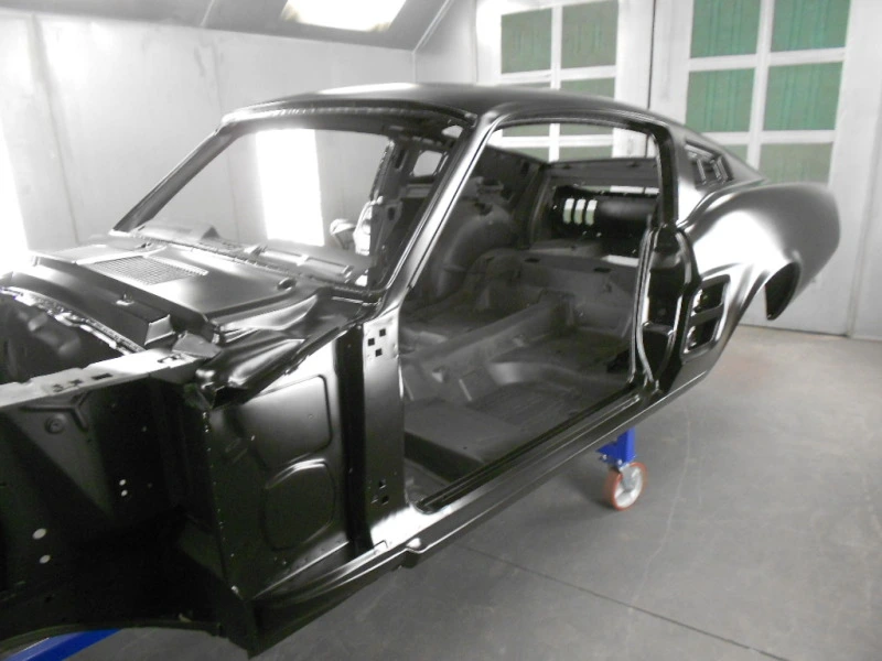

We now have a new helper in the shop and he was busy sanding down to bare metal

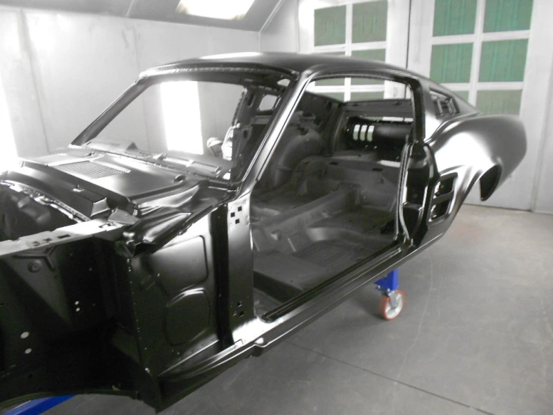

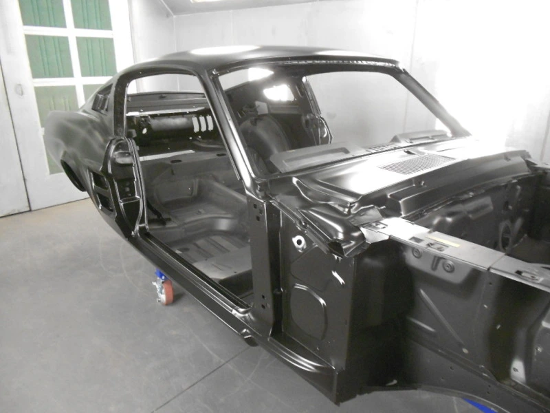

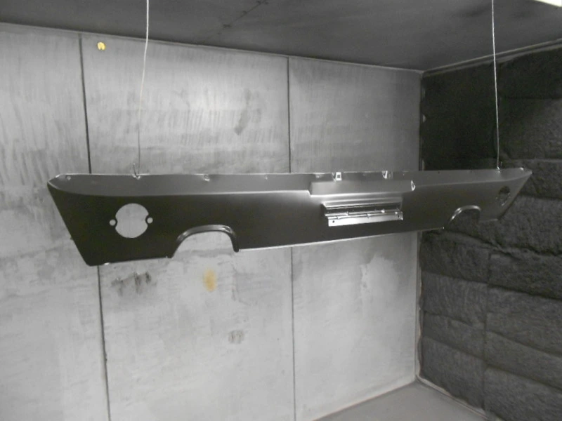

I sprayed two coats of SPI black epoxy yesterday

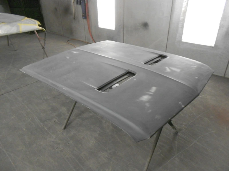

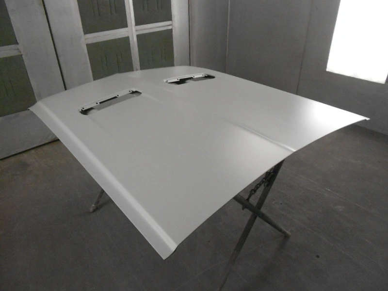

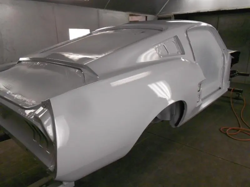

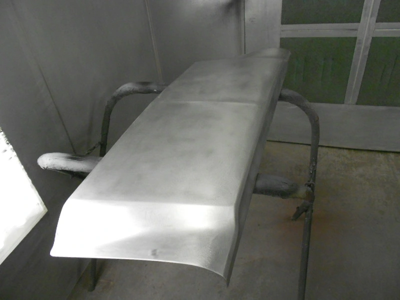

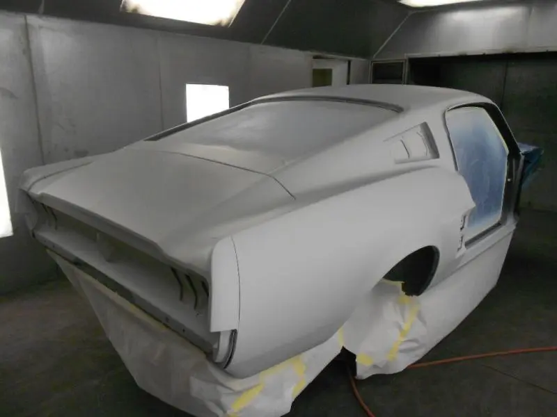

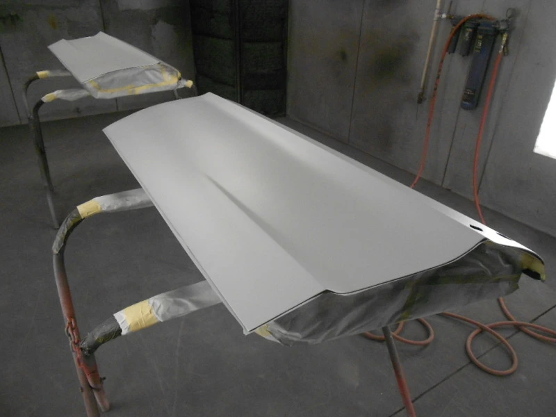

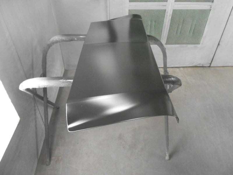

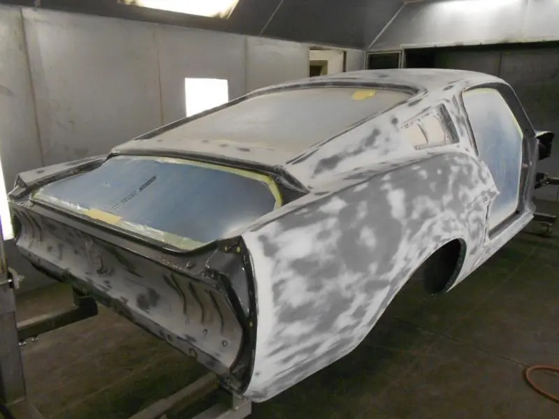

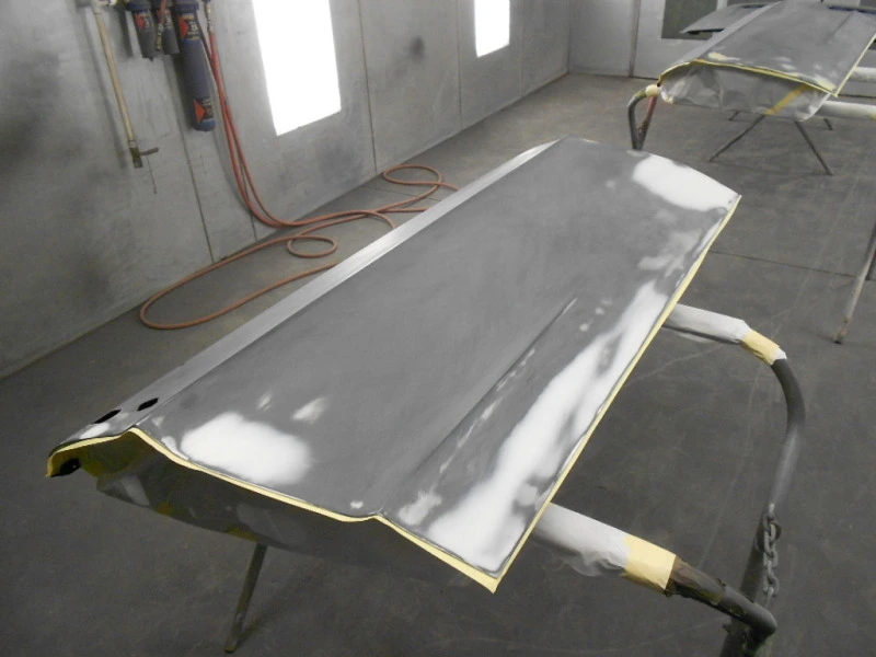

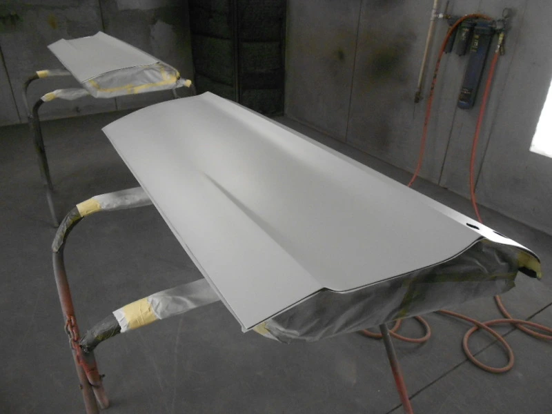

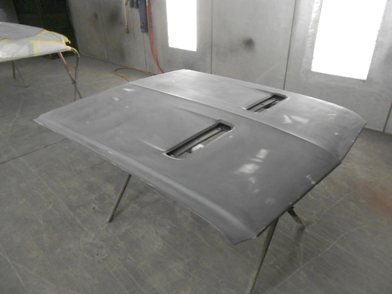

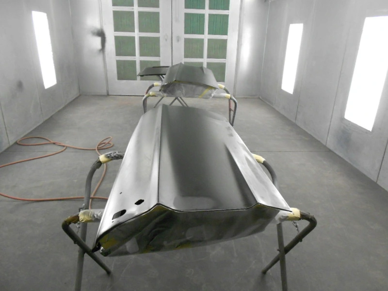

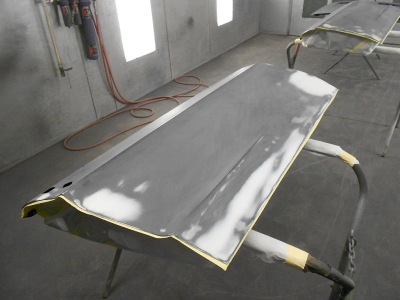

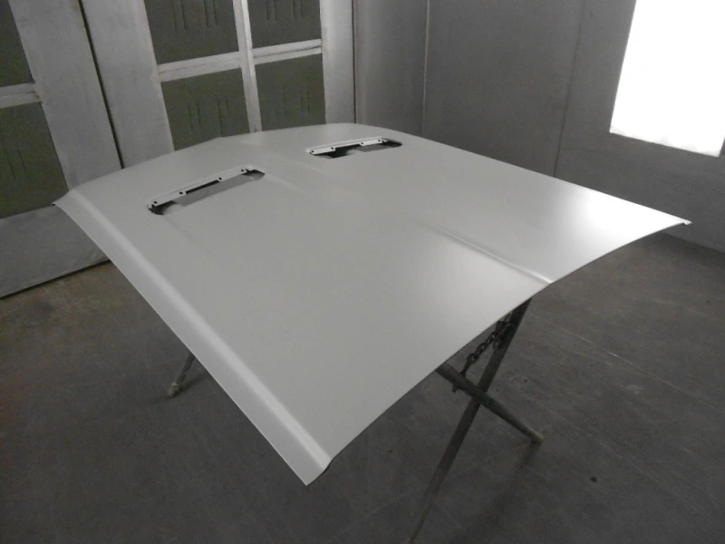

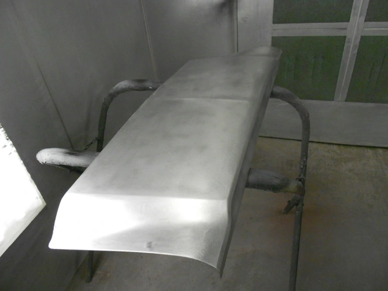

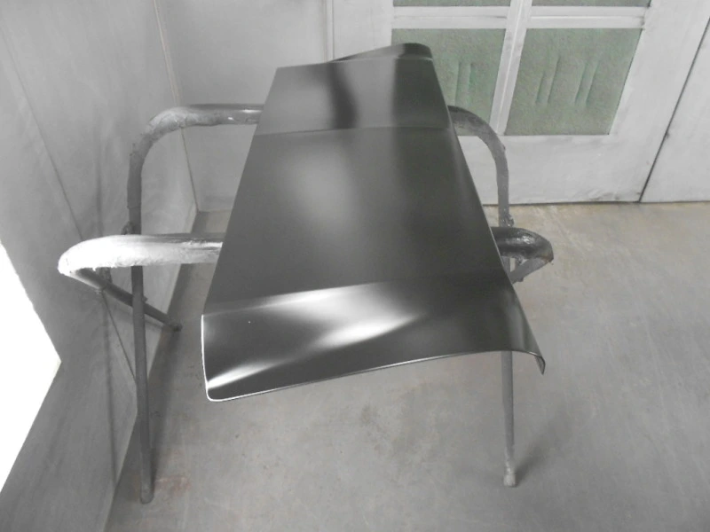

Block sanded the hood and doors
Sprayed one coat of SPI black epoxy to seal than sprayed 2 coats of Slick Sand Polyester primer

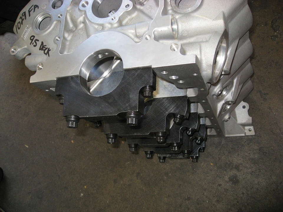

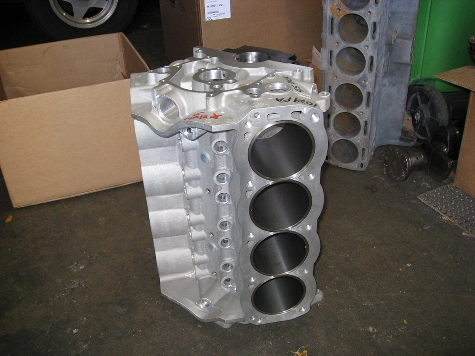

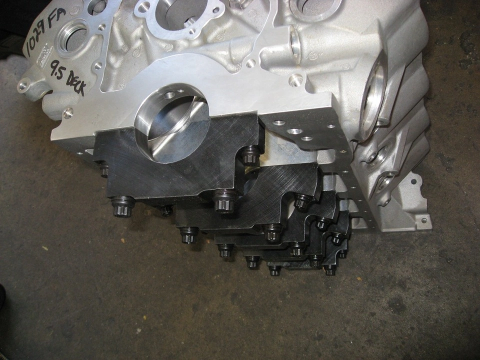

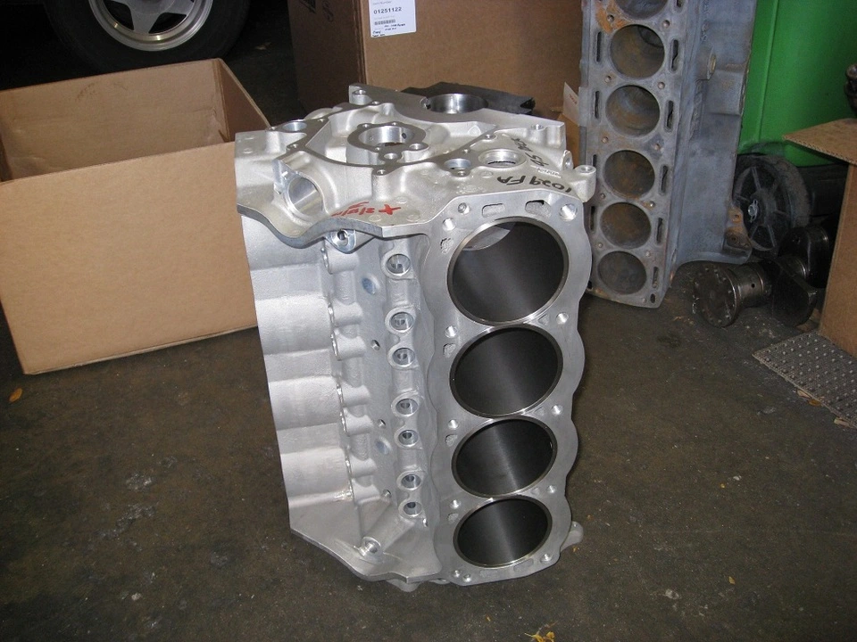

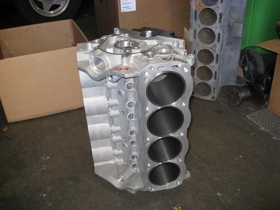

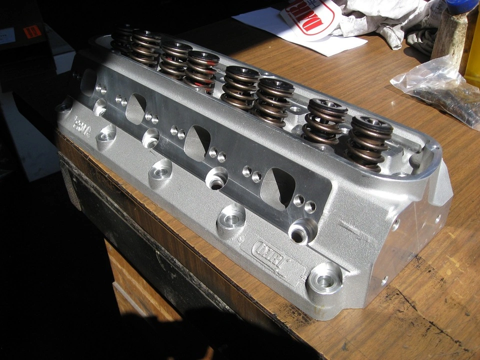

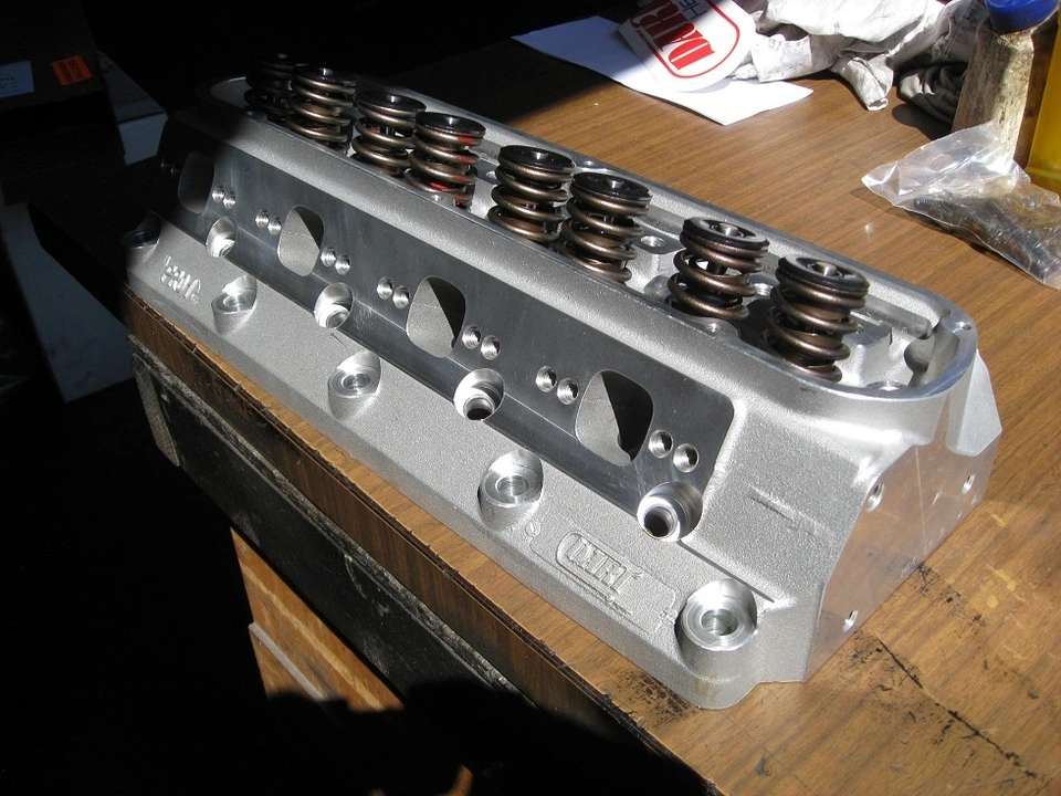

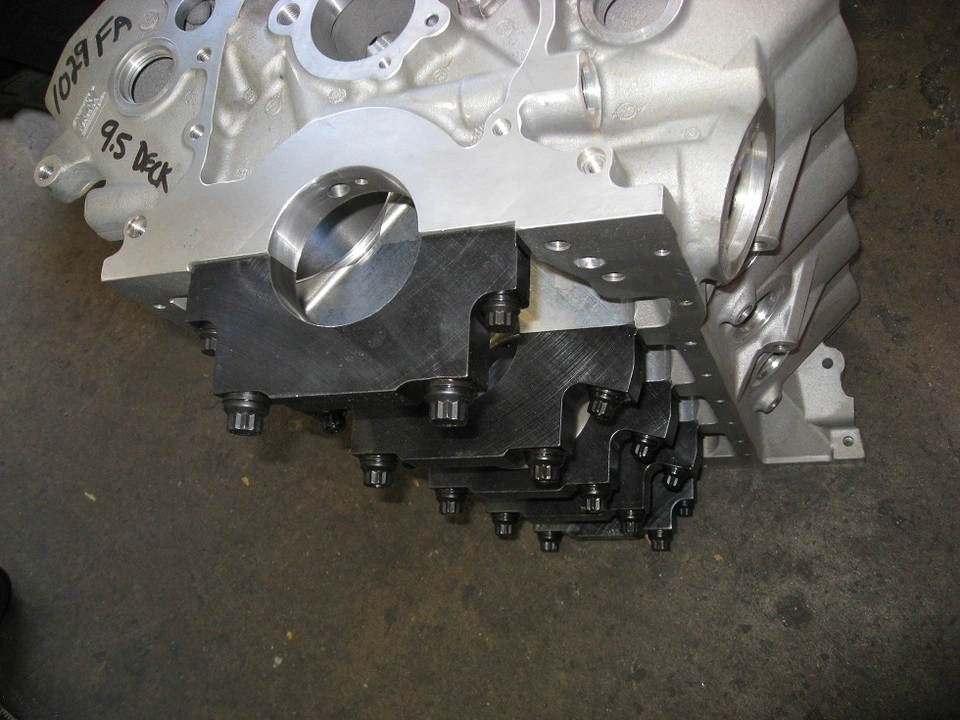

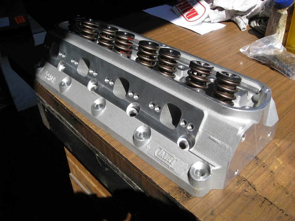

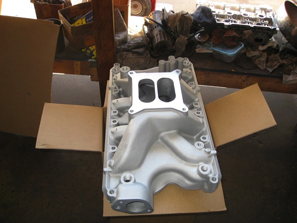

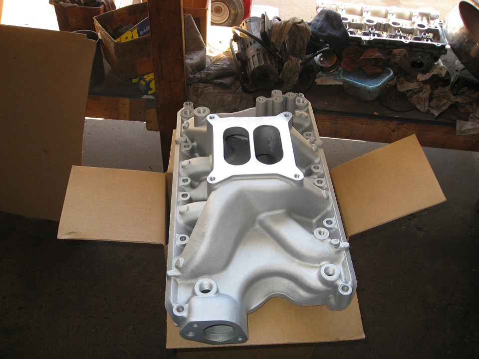

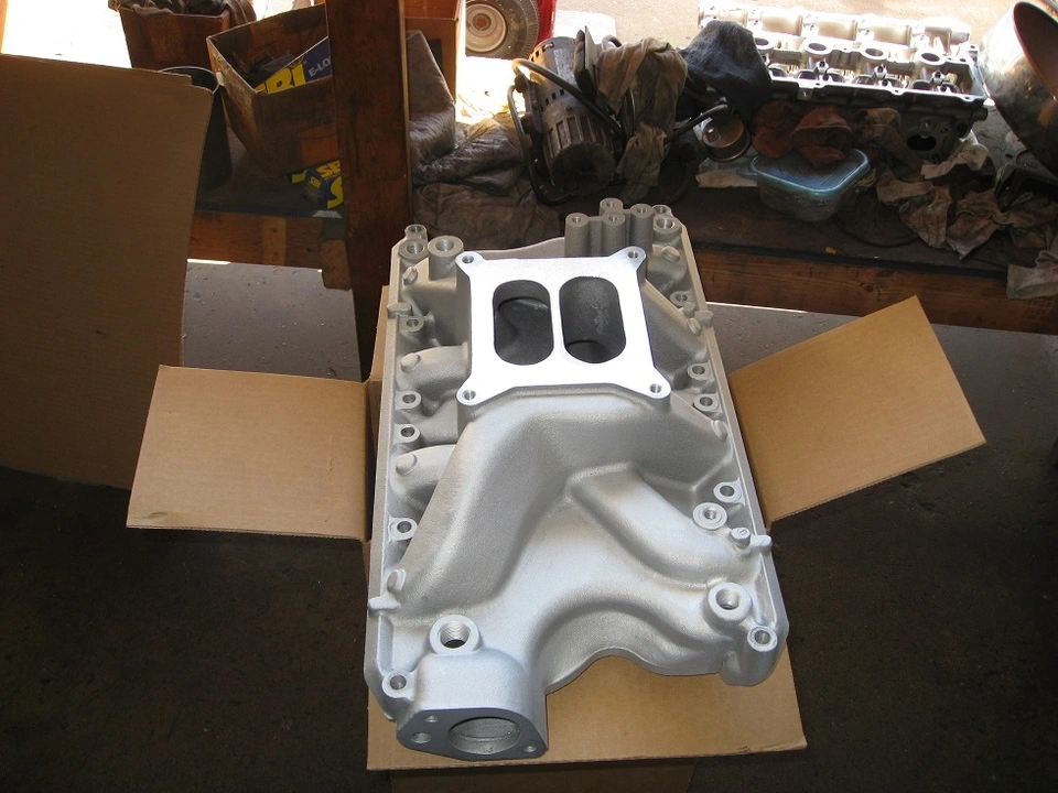

The shipment from Dart came and now our engine builder Mike at Competition Motorsports in Sarasota Fl will be busy.

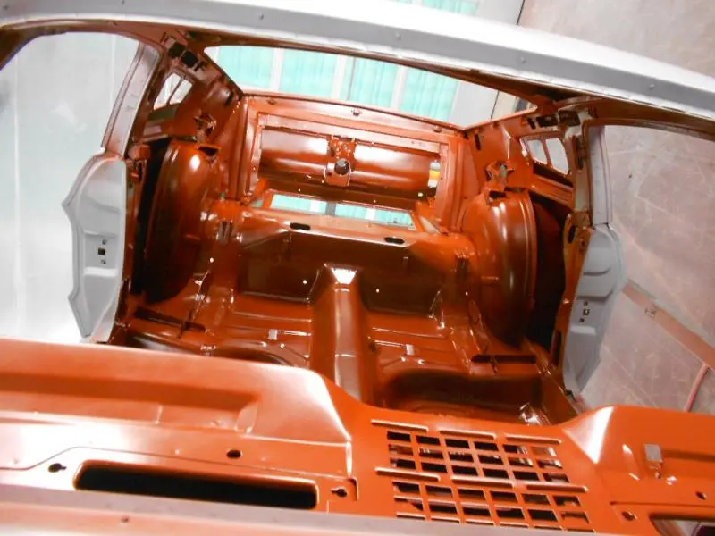

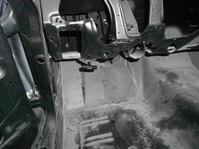

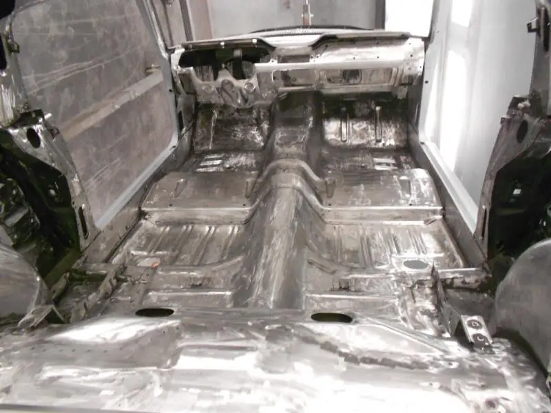

The owner sanded the interior and undercarriage himself.
This is how he looked after sanding

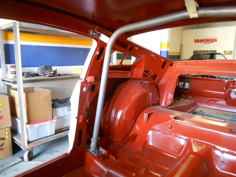

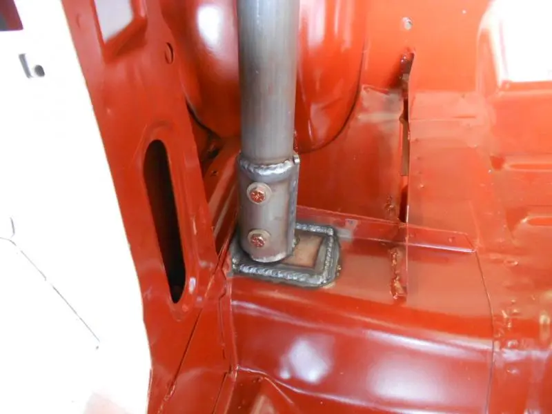

Sprayed a couple coats of SPI red oxide

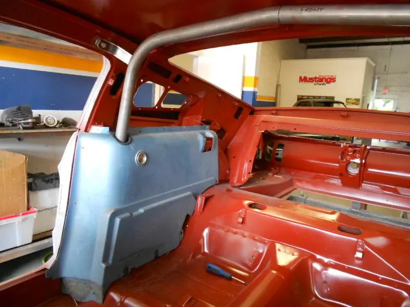

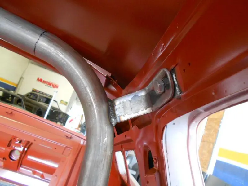

Fitting the roll bar
Fitting the trim panels

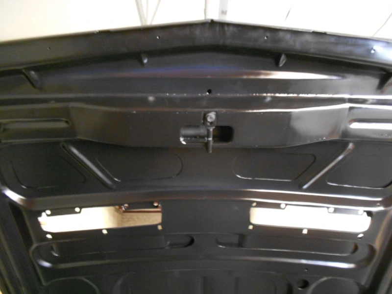

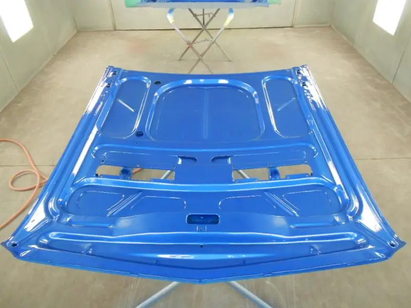

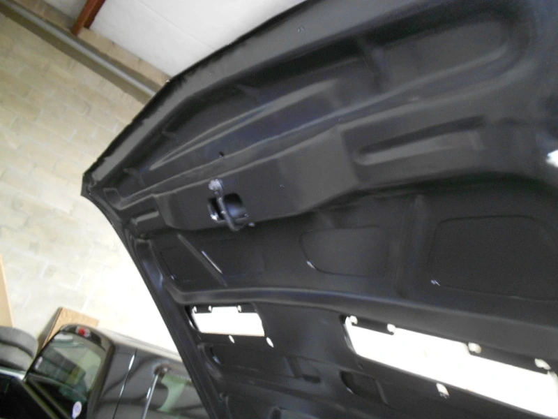

Sprayed the bottom of the deck lid and hood Acapulco blue
