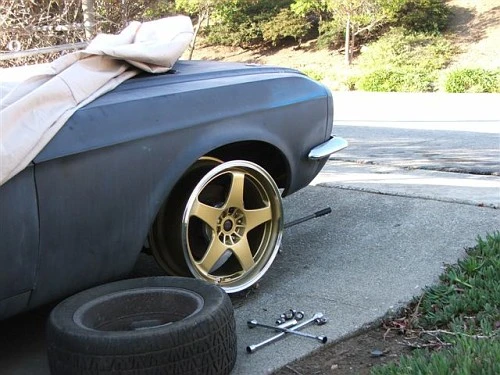

This week's experiment, 1996 Cobra wheels, 17x8 and 1" adapter, 245/45-17. Not a bad look. I bought these for my Mark VII because at $400 it was cheaper than buying new tires for the crappy rims that were on there.
With the factory's +24mm offset and a 1" (24.5mm) adapter it roughly gives me a 0 offset which means the mount flange is centered in the rim. On an 8.5" wheel that's ~4.25" (+/- .5mm) backspace, because 4.25 is half of 8.5. An 8" wheel is actually 8.5" wide from edge to edge because of the bead support. The popular 15x7 Torque-thrust with 3.75" backspace is zero offset, because 3.75" is half of 7.5", the actual width of the rim. Confused yet? If you are, I'd suggest studying the relationships between offsets and backspacing or you'll have a hard time choosing the right wheels as many manufacturers go by offset instead of backspacing. Anyway...

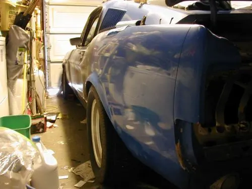

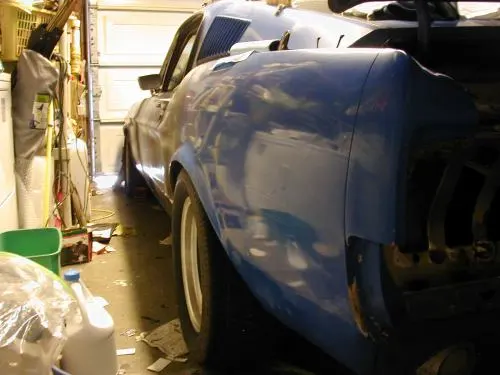

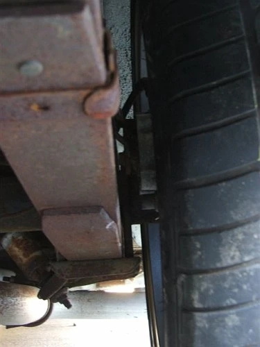

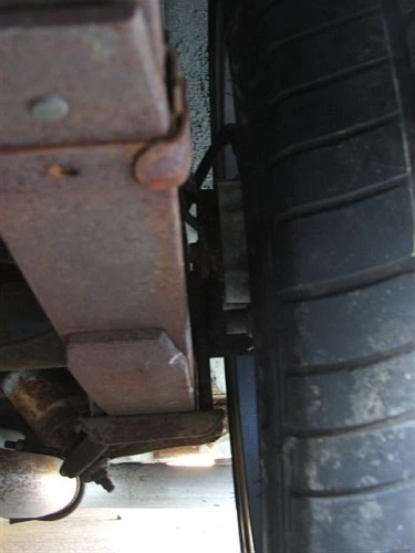

At least one inch from the ball joint:
Oops. Barely a quarter turn of the steering wheel and I can't even fit a piece of paper in there. Bouncing on the bumper produces a nice squeak between fender and tire.
According to the tire size calculator a 235/40-17 is only .5" taller than my current combo so I will try those next from a used tire store nearby. The 245/45s are almost 2 inches taller than my 225/50-15s. An adapter that's about .25" less would probably work out fine with the 245s. I can probably have these machined down at the local machine shop for not much $$, but I'm thinking the stock studs might be too long for a .75" spacer and contact the back of some wheels. The Cobra wheels have deep pockets between the lugs so they aren't a problem.

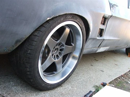

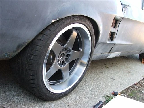

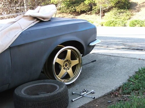

Anyway.. 18x7.5 235/40 front and 18x9.5 275 35 rear with used Dunlop run-flats for testing.
Lots of room in the back, could've went wider i.e. 285 but this is safe:
I should've measured the wheel, which I will soon enough, but it claims +35mm offset. Looking at this calculator, a 9.5" wide wheel with +35mm offset should put the outside at about the same distance as a 7" wheel with 0 offset, which is what my Torq Thrusts were. When I put the 9.5" wheel on it was way inside the fender and I ended up using the 1" adapter. So either I'm thinking wrong, the calculator is wrong, or the wheel specs are wrong.:shrug: I spent many toilet hours doing the math on a piece of paper, plus the online calculator, so I'm still confused why I needed the 1" adapter.
The calculator worked for the front wheels, though, and they ended up right where I expected them to be. From 7" 0 offset to 7.5" +12 (38mm minus the adapter's 26mm). Next size up was 8.5 but I wanted to play it safe.

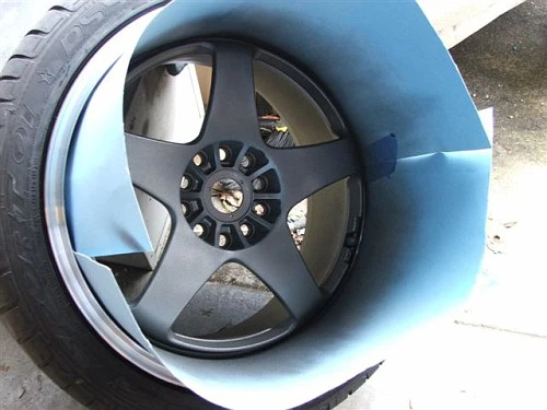

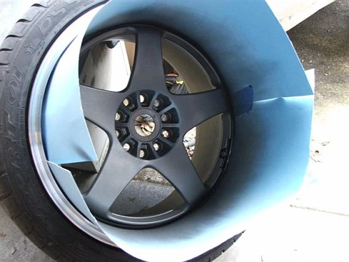

Yes they came in gold so I painted them with Duplicolor wheel paint. I didn't buy gunmetal wheels since I have to make center caps anyway and I will color match them.
I have some spare late model center caps with the Mustang logo on it, and I'll probably laser cut them at work down to the right diameter. We'll see.

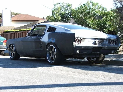

Oh yeah, I drove it around a few blocks and nothing rubs during turns. Haven't hit any dips or bumps at speed yet.

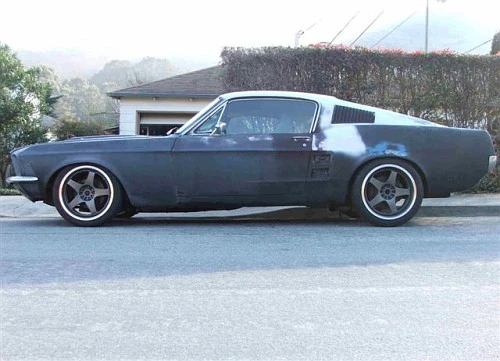

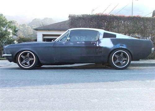

Mind taking a shot directly from the side so we can have some people play with photoshop swapping different wheels on/off? :D

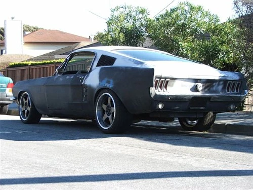

Here's an old picture with the 7" wheel and 245/50 tires. I guess my math was right after all. The 18s just tucked in too far since the combo doesn't have that tire bulge to take up the space. Just another thing to consider when going up in width.
For the rear ideally you would run a 9.5" wide rim with +10 offset (35mm minus 1"), not a standard size, hence the adapter. The only other ways around it are buying a wheel everyone already else has which are mostly 8", change the rear axle width, or have a set of wheels custom made.
I previously didn't like 18s on a '67, but those look really good.
I think it works because they are the same height as the stock 215/70-14 tires. Anything taller is what would make it look strange. I'll get you a side picture if I find time to get it out onto the street today.

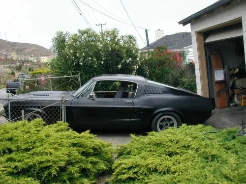

Here you go Bullitt or anyone else that wants to Photoshop their own 18s. Maybe even those 30s that Reen posted which should go well with my Foose-inspired paint.
Just for kicks.. The good old days, when I went "Pro touring" in ~1993, before the trend fully kicked in. Those 50-series 15s are definitely too short.
