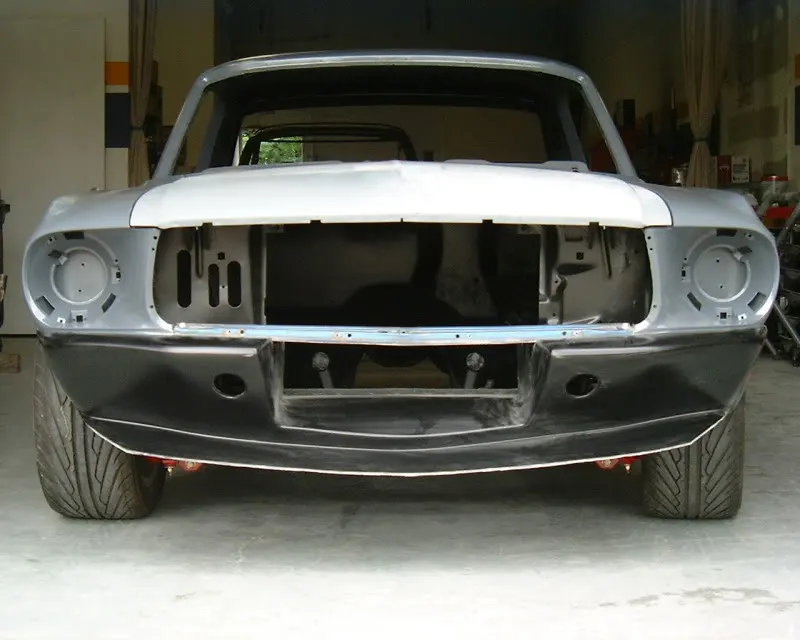

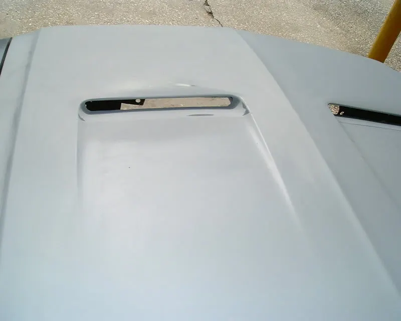

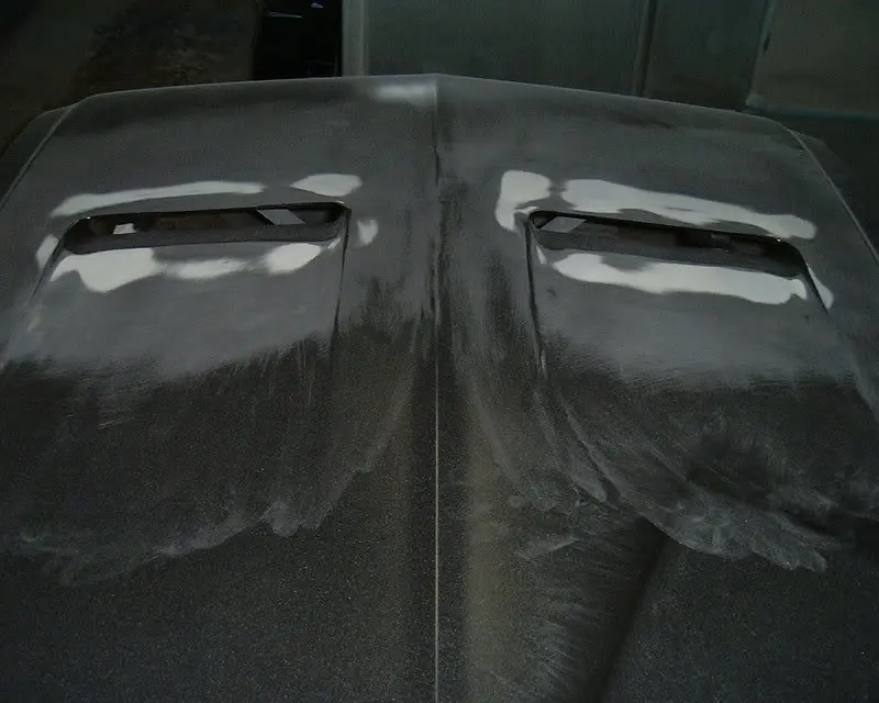

I also did away with the turn signals in the hood. I bonded them on and blended them into the hood.
Reactions: GOvert and Bow1258

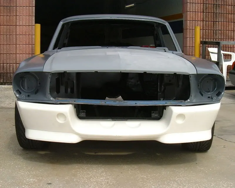

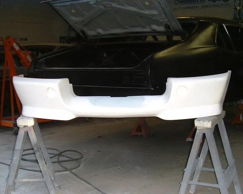

I have not done a lot on my project. I did work on the fiberglass bumper getting it to fit close to the body.

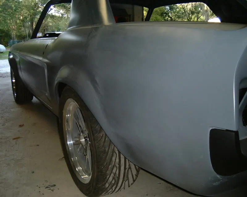

This weekend we narrowed the 1963 Galaxie 9" two inches to match the width of a Mustang. There wasn't enough clearance.

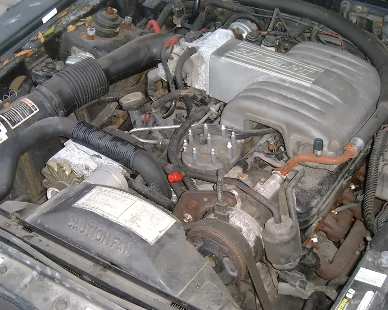

It's the new year I'm tried of not having a Mustang that I can drive so it is time to get this car running. I have gone round and round on engines and I do like FE's but I want something that I can drive and not have to stop for gas all the time. I have a 88 Mark VII that I bought new and was wrecked and has been sitting for over 3 years so we have decided to use the engine and trans in the Mustang. It needs a little cleaning.

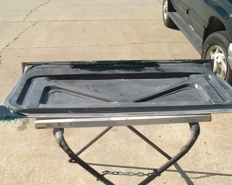

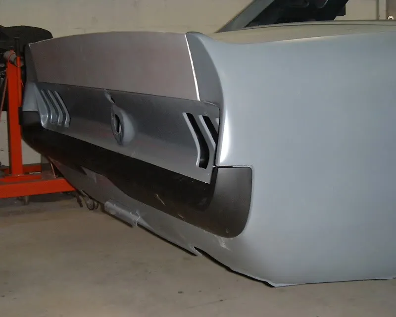

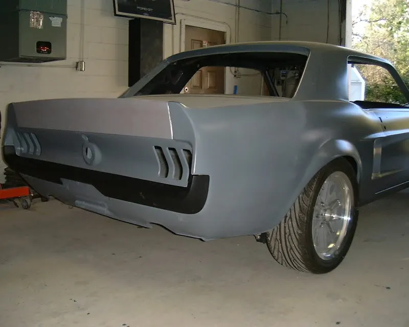

Today I started reshaping the deck lid. The front corners stick up to high and the left side is really bad. I sanded both sides but had to add material to the bottom of the left side. Also the bottom of the deck lid did not match the taillight panel in the middle so I added material to the inside and than sanded the outside. It also did not line up with the end caps at the bottom so I sanded both sides to match the end caps
