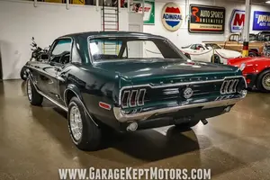

The car will be used for a street/cruiser and only on weekends/the odd evening. I don’t plan on doing any long journeys in it. I would like a good amount of low end power.
My ability to work on the car is limited, i’ve restored a few classic bikes before but no cars. My budget will be healthy, but I don’t want to throw so much at the car that i’ll never see it back.
I’m still torn between keeping it as stock as possible and not. At least visually i’d like to keep it looking pretty original.
I’d like to aim for 250-275BHP.
I’m hoping that the parts I have so far may bump it up to say 200 by today standards? And maybe heads and cam in future would bump it up closer to 240-250?

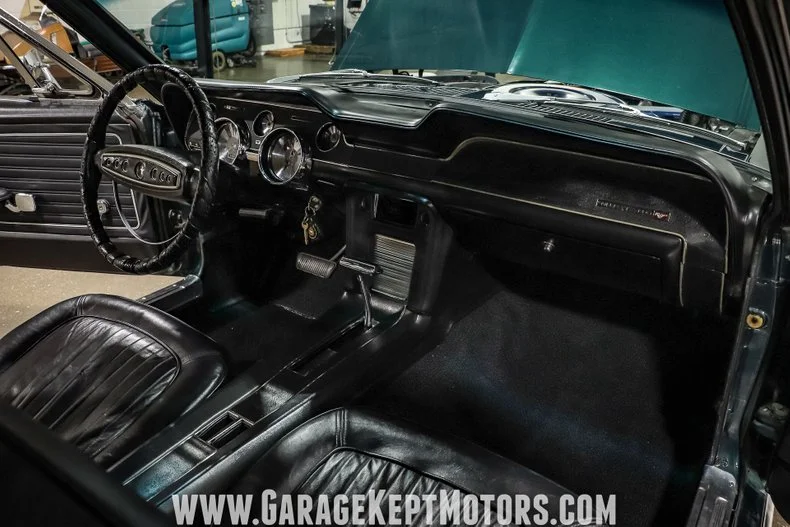

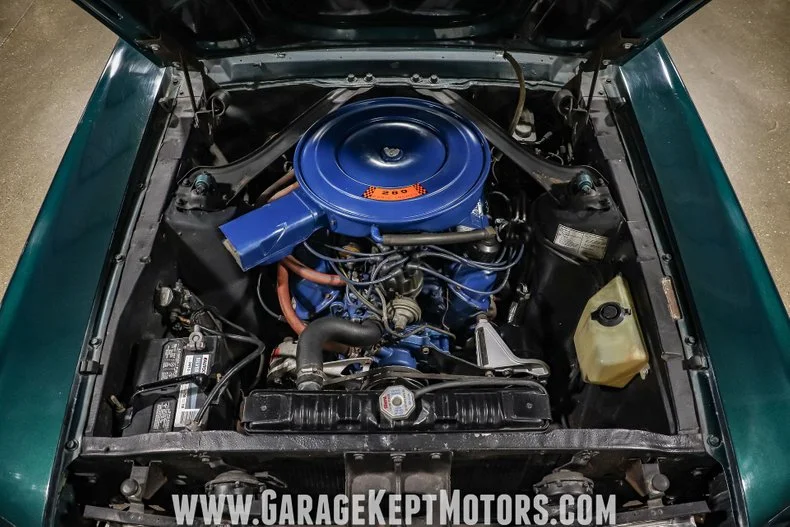

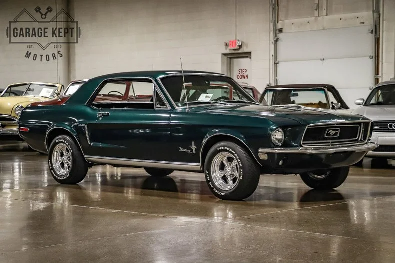

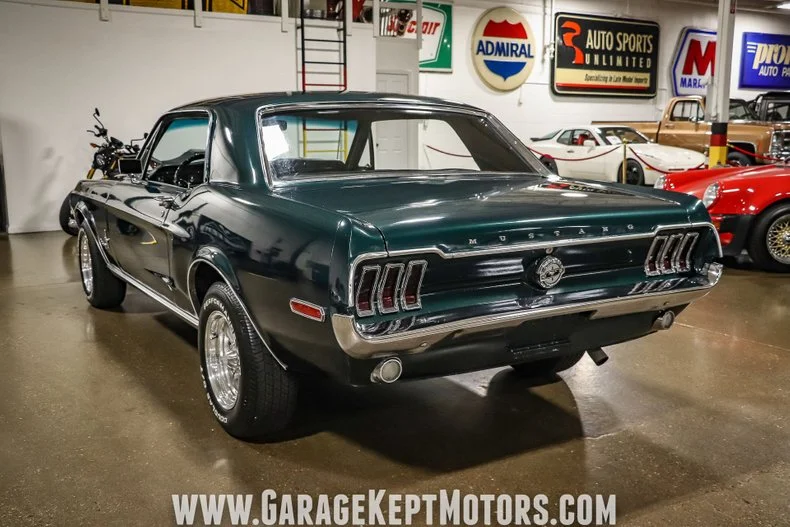

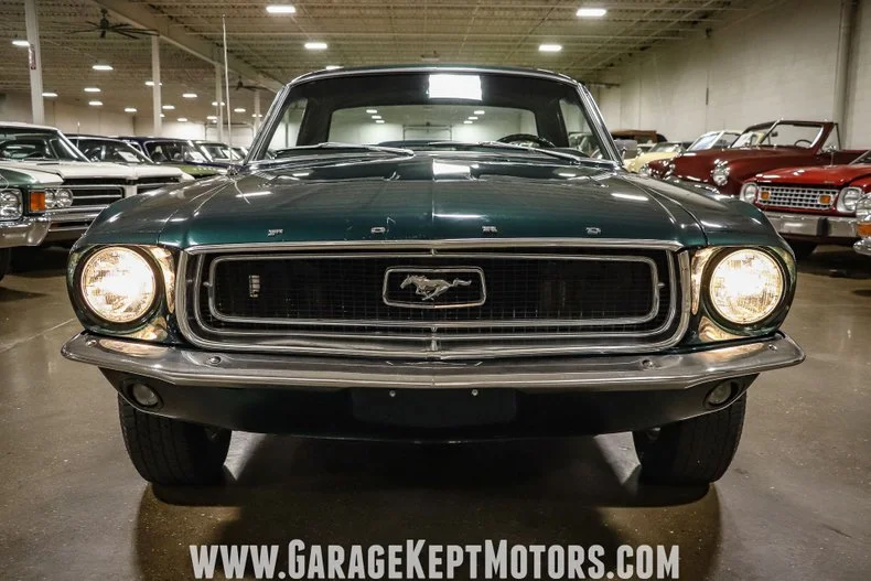

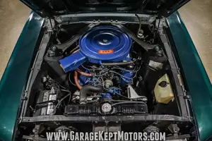

I’ll attach a couple of photos below.
I might think about a new radiator ...
a good thought might be to just own and enjoy your "new" car for a time and just get a feel of owning and driving (and maintaining) a classic
I echo the suspension and brake advice, but the most important advice is to take your time and think about the many, many options
available ...
and that is a very nice '68 indeed ... enjoy it as is - proudly!
