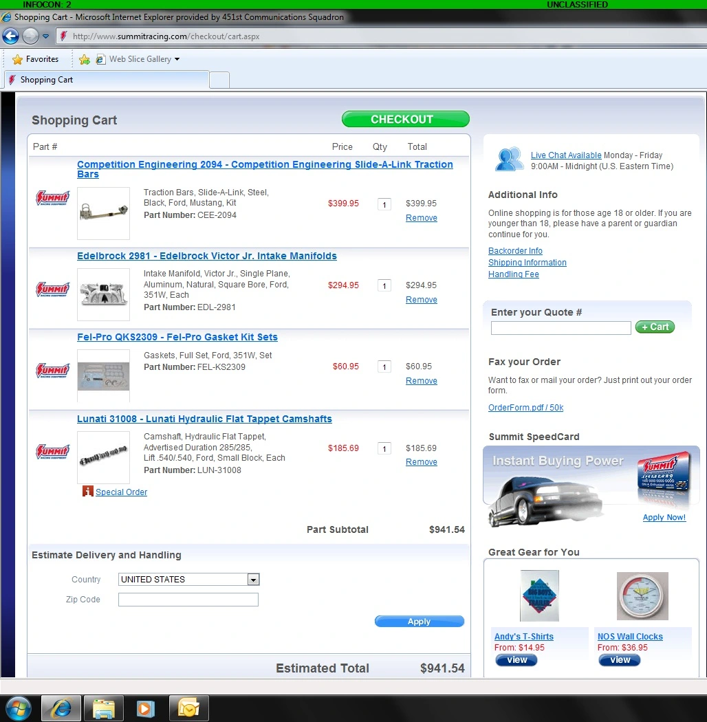

Apreciate the help. I have to do a little confidence building to get back into the swing of things. Check the attached. This is what I am thinking I might get for my set up. I already have a good block with factory rotating assembly, Kieth Black Hyp flat tops and World Windsor Sr. 2.02/1.60 cast iron heads (new springs installed), Holly 750 w/vac seconds.
