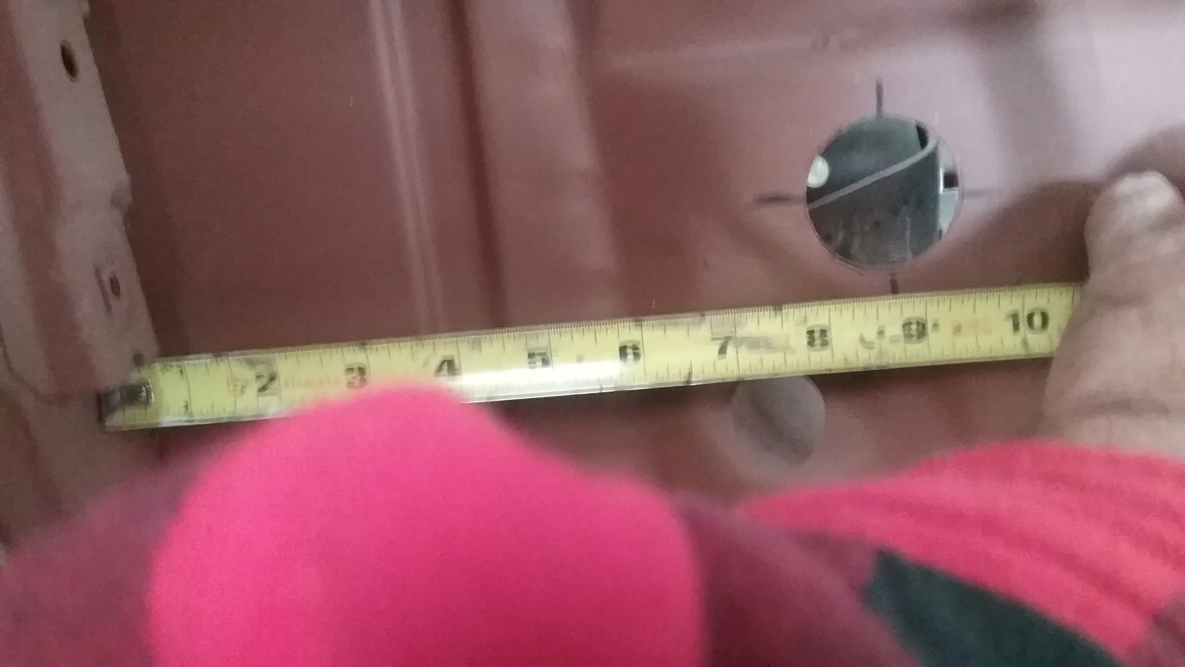

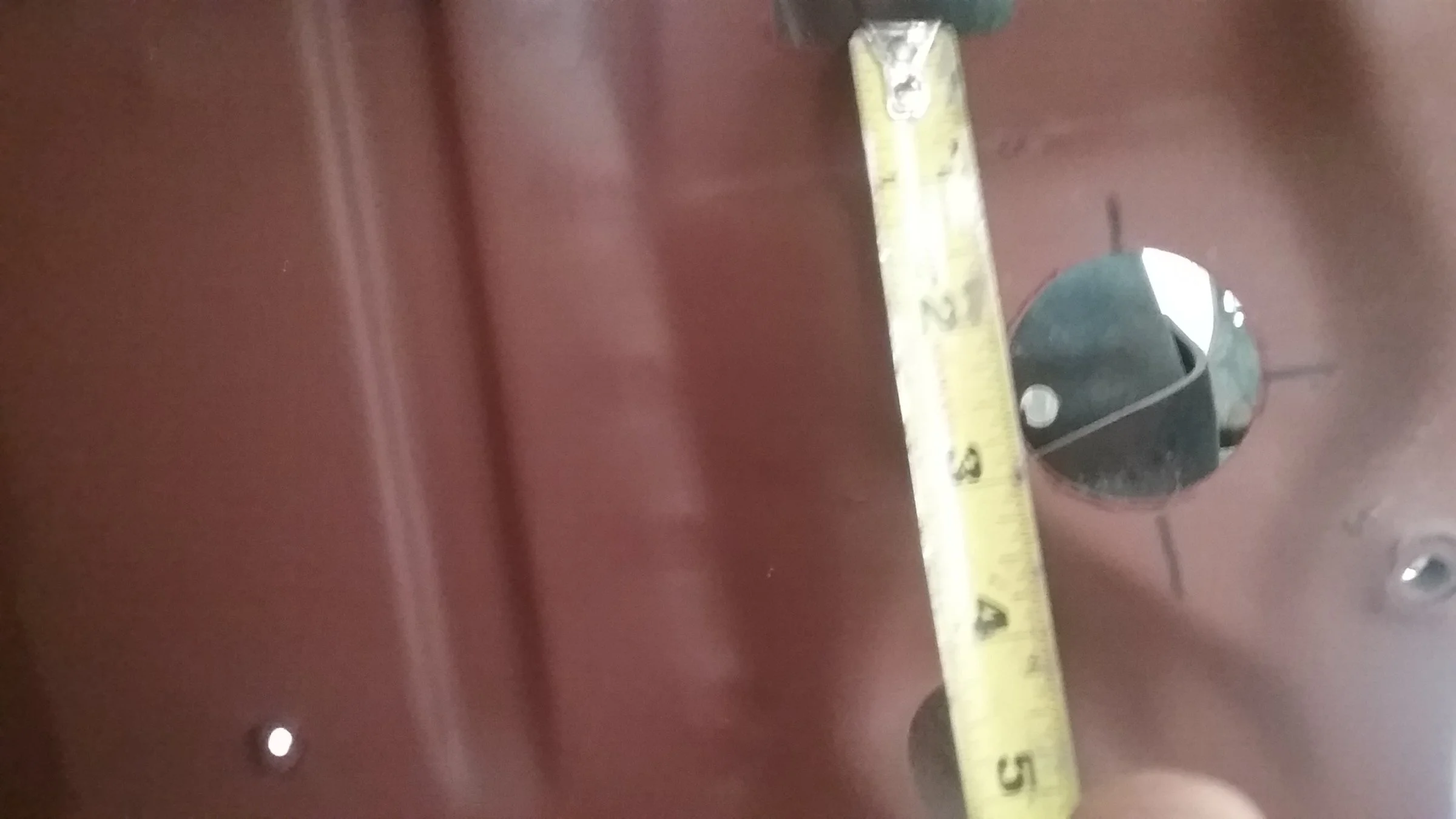

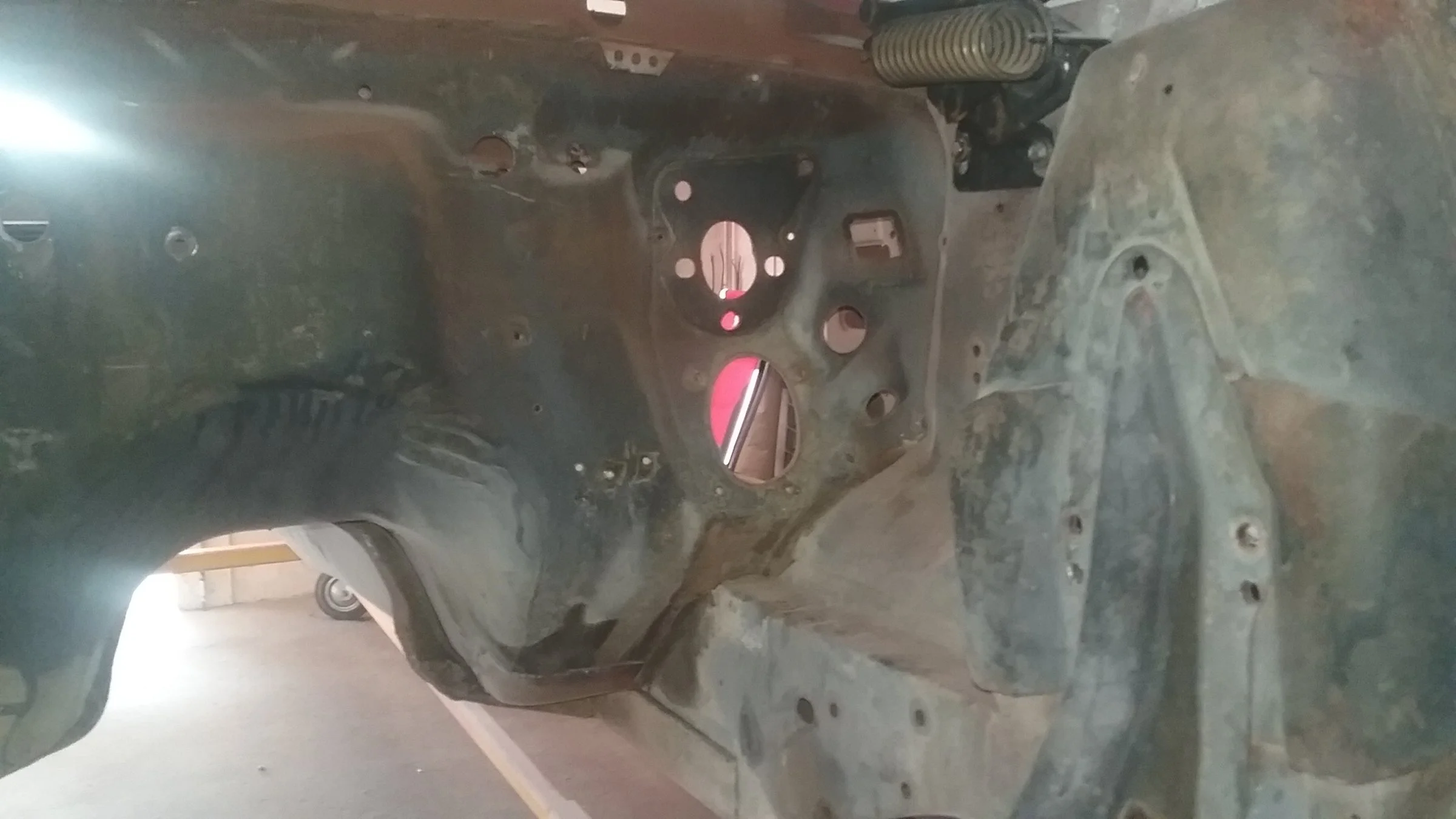

I have a 69 Mach 1 that another person put new firewall in and threw away the old 1 and they also pulled the dash and everything else out and now I am trying to put the puzzle together. I was wondering if anyone had a pic of a factory firewall or other that I could see of where the clutch linkage comes out of the firewall at because this 1 is a 351W 4 speed car. Thanks for your help.
This is my 69 CJ ,the clutch rod hole is the one beside the column opening .
1 5/8 .the lower hole is the speedo.
Hi sorry to bother you again but my brother wanted me to ask you if we could get a measurement of the hole location like down from wiring harness hole and maybe over from steering column hole or something. If possible whenever you can. If not I understand and I really do appreciate your help thank you for what you already did.
