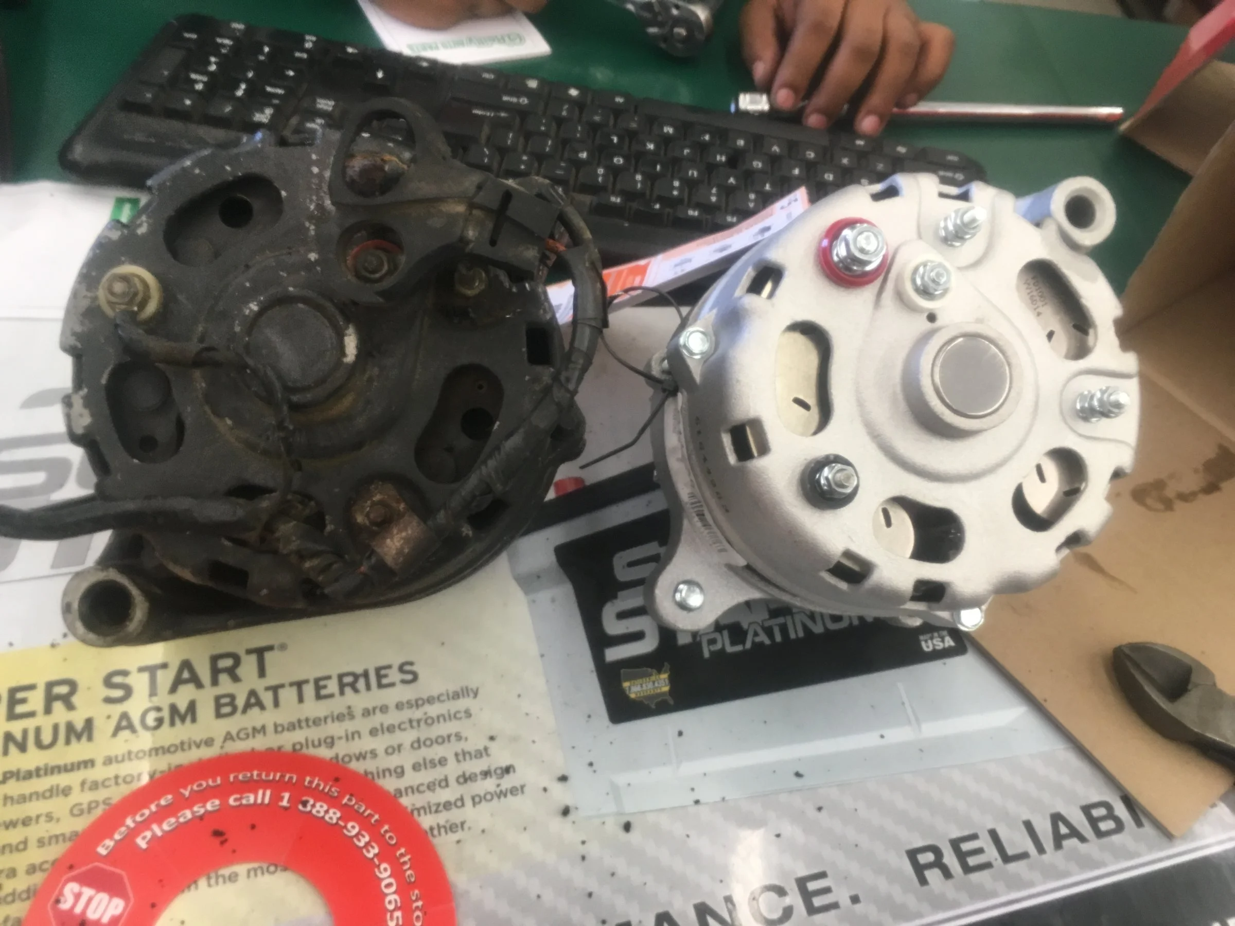

Hi everyone. Having issues with my 69 mustang coupe. 302. Replaced battery,regulator,starter selinoid,and alternator. She runs great except I'm noticing the lights are dimming and flickering when rev it. Also the battery is being drained completely. Having to jump it and my battery charger started to spark. Any suggestions

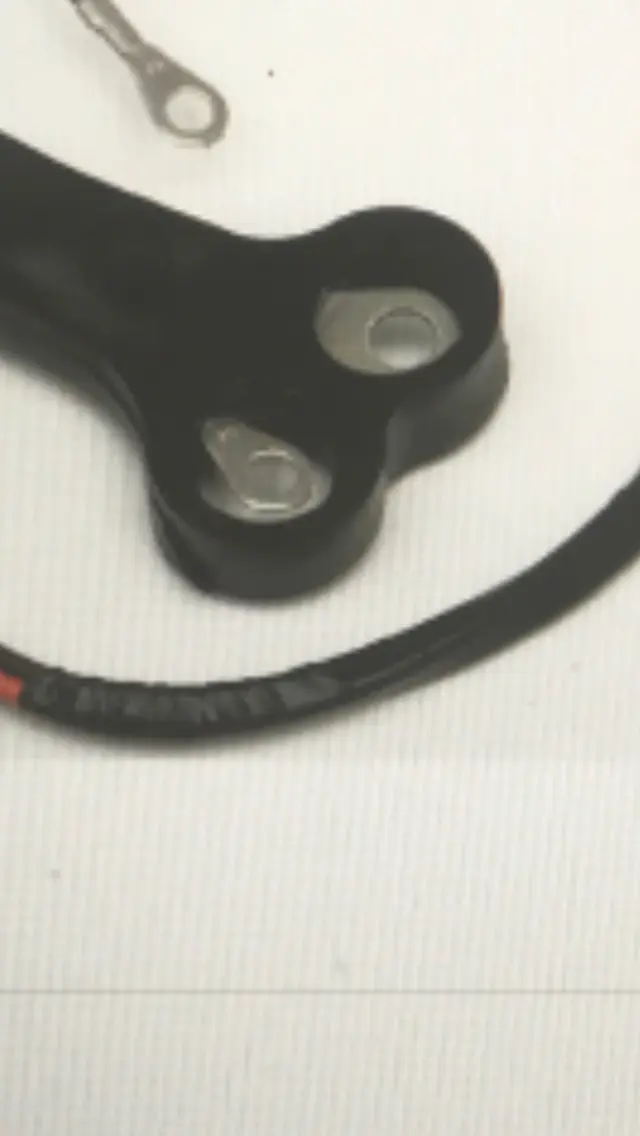

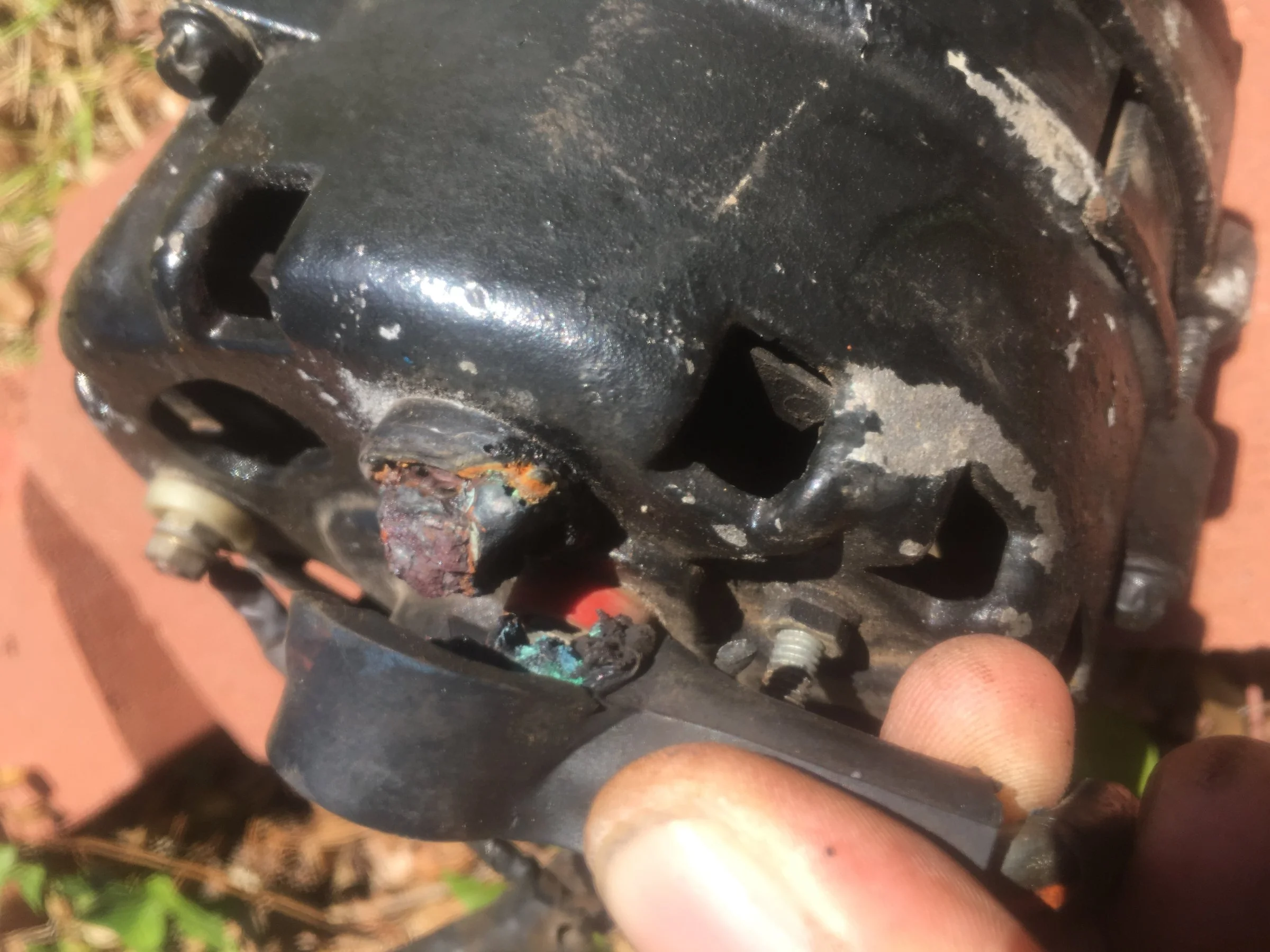

On the alternator, does the t bone/ rubber part have anything to do with my problem??? I pulled the old alternator off and found one connector corroted to where it wasn't even touching. When I replaced the new alternator, I just tied down to the posts, without the rubber piece.please feel free to contact me 346 316-0627 Andrew.
That rubber is there to keep the two separated so they don't short against each other or something else. Make sure the terminals aren't touching each other or the casing. If at any time they shorted out while the battery was connected you may have damaged the alternator or voltage regulator.
