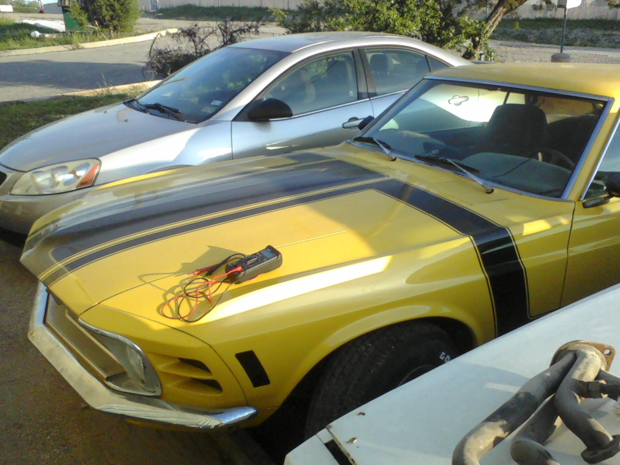

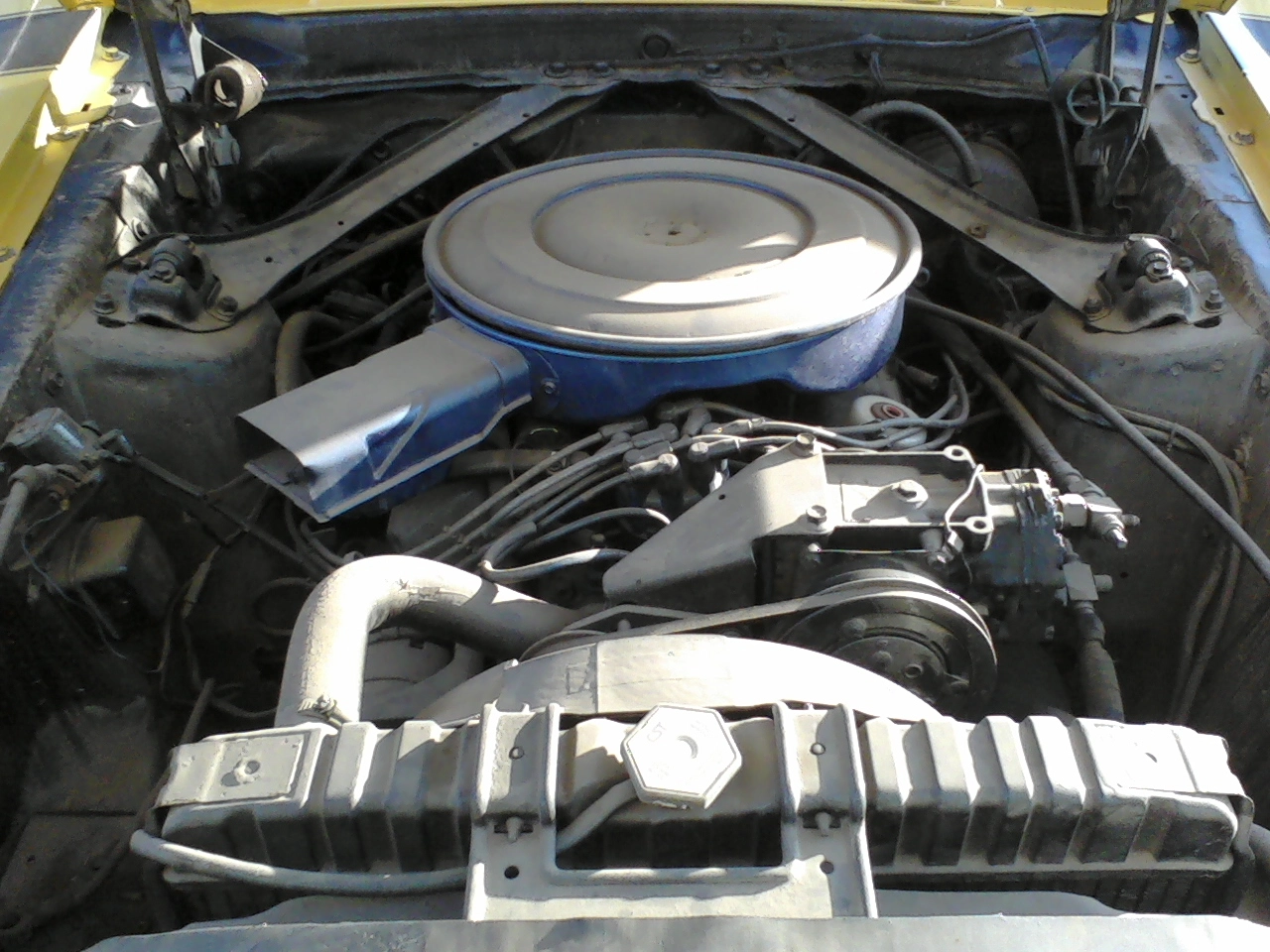

and here's some picture of it so atleast the paintjob can get some love(minus the rust on some of the rust on chrome pieces). Oh and in the body pic you can see the driver side fender light was stolen and the volt meter on the body before I found out the battery was stolen too.
And to the very bottom right corner on that other car hood is my old header to my 95' GT.

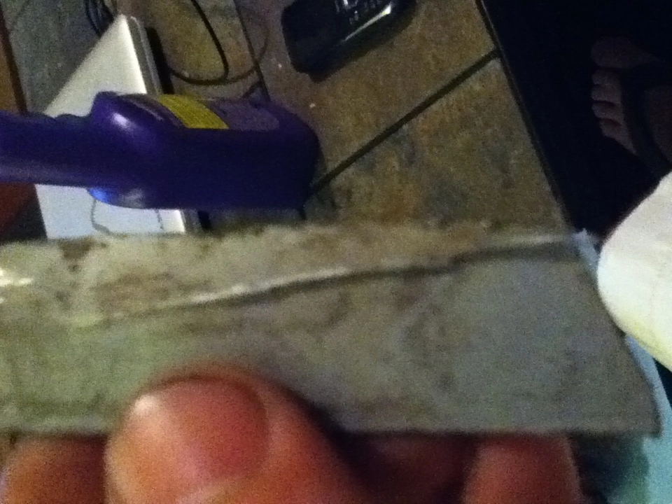

This wasn't post worthy till while cleaning it a piece of metal fell out of it. I doubt this should've been in there but, hey, you never know:p

if you just have an origional oil pan it will only take 5 quarts to fill ,check the dip stick tube it may not be all the way in the timing cover or you may have the wrong stick do not over fill ,the radiator drain is at the bottom of the radiator on the drivers side lower tank ,your pics are to fuzzy to make out for the piece of metal,but look inside the intake throat to make sure that nothing is in there

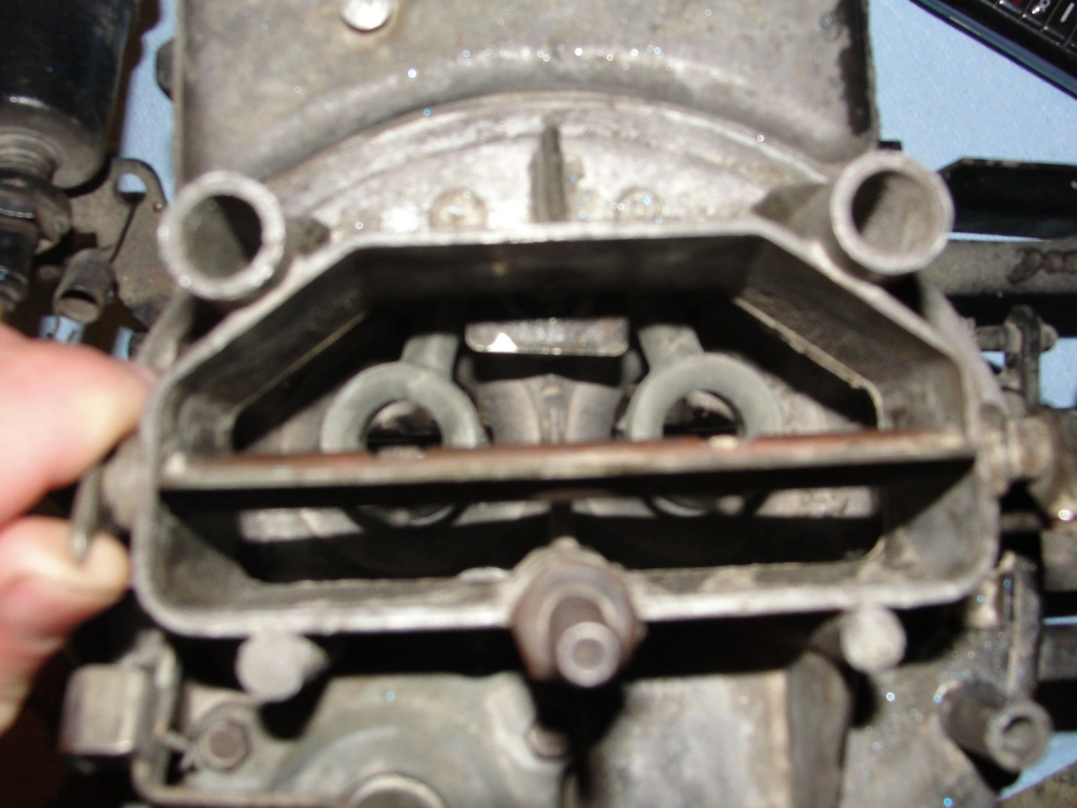

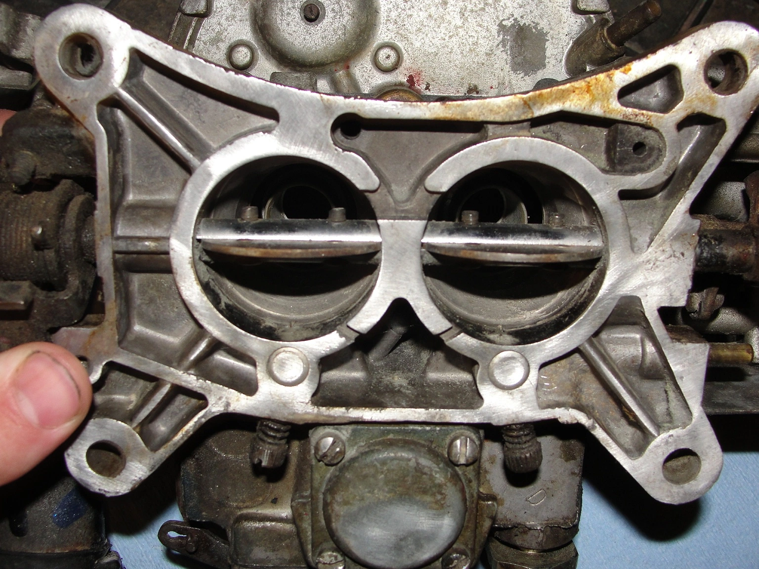

Here is a shot of the choke and lower intake connection
Ordered the missing gasket for it today also.

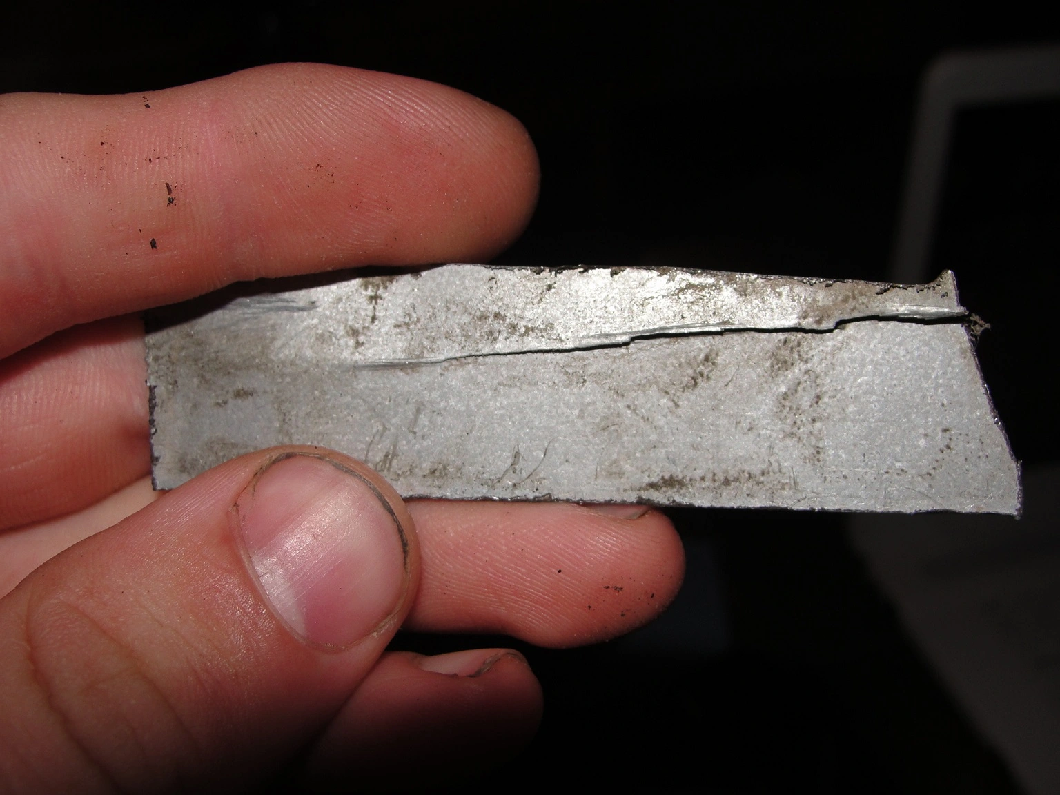

And then here is a much higher quality picture of the piece of metal that's a little less than a centimeter thick.

yeah the piece of metal does not belong there, the carborator is the factory type
2 venturi or 2 v autolite or motorcraft ,you should rebuild it while you have it off
it is a very simple carborator to rebuild, a kit is easy to get and has instructions inside.
