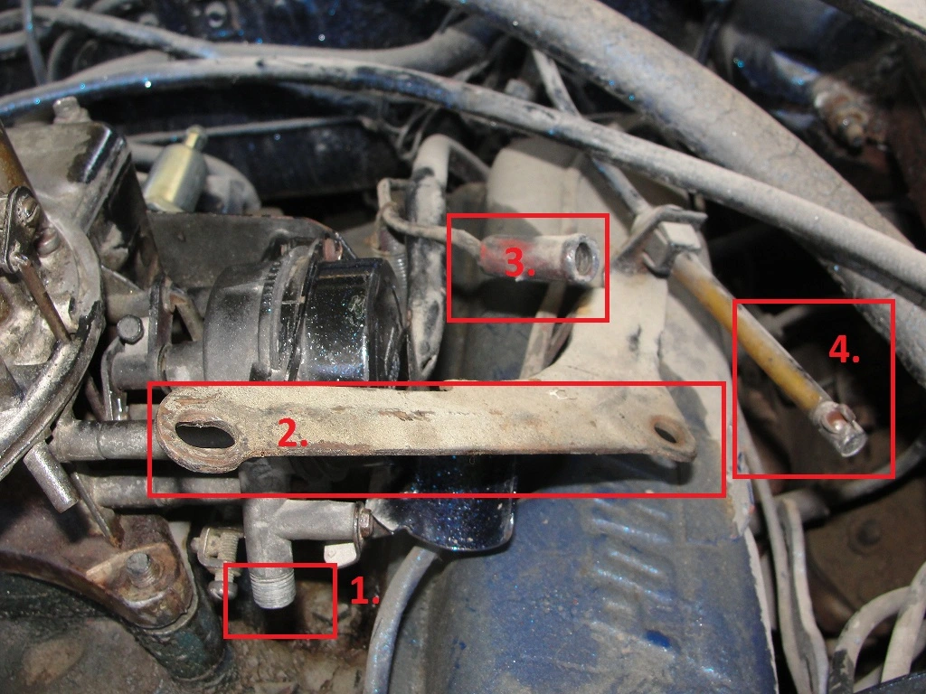

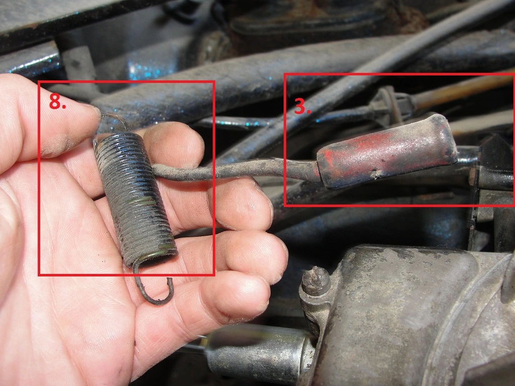

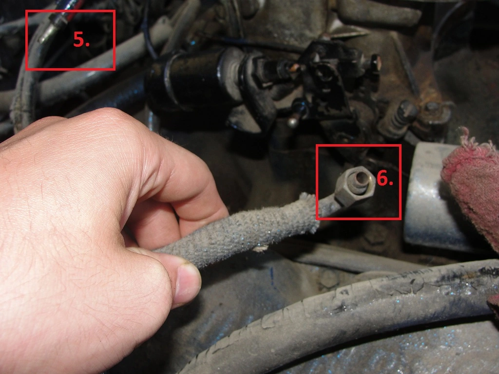

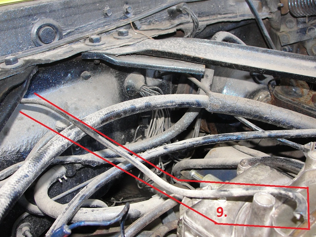

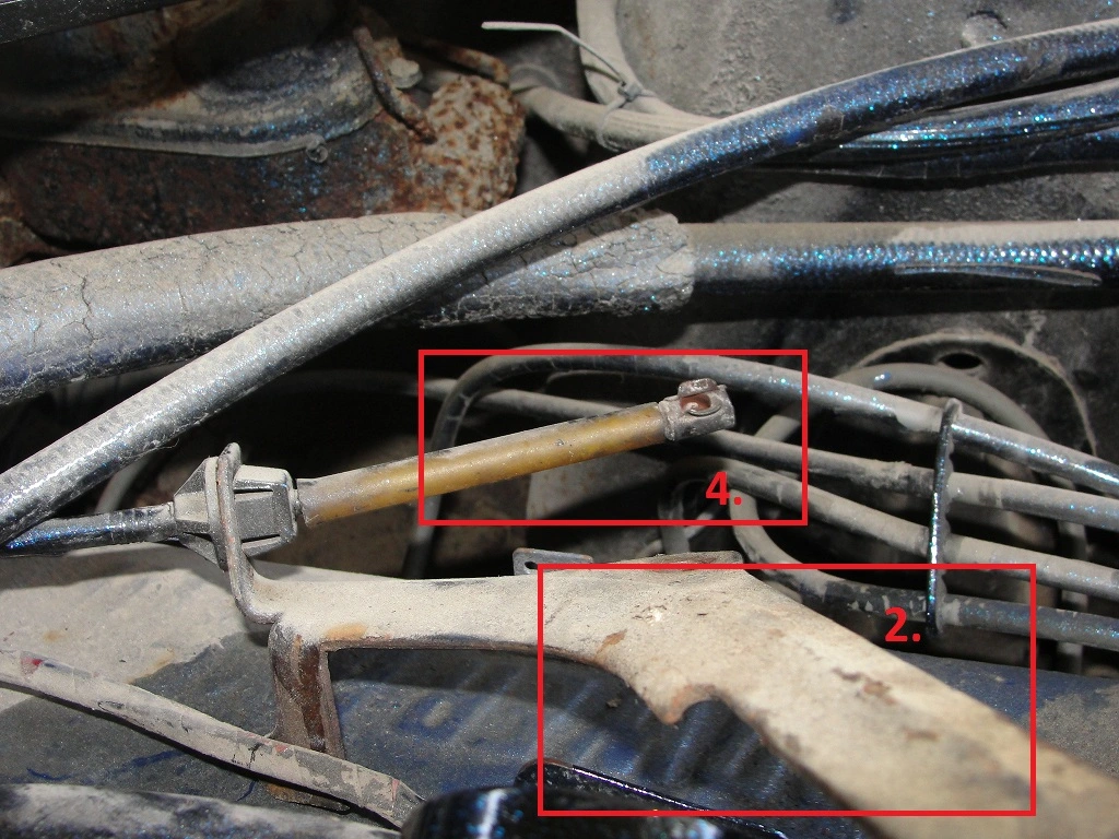

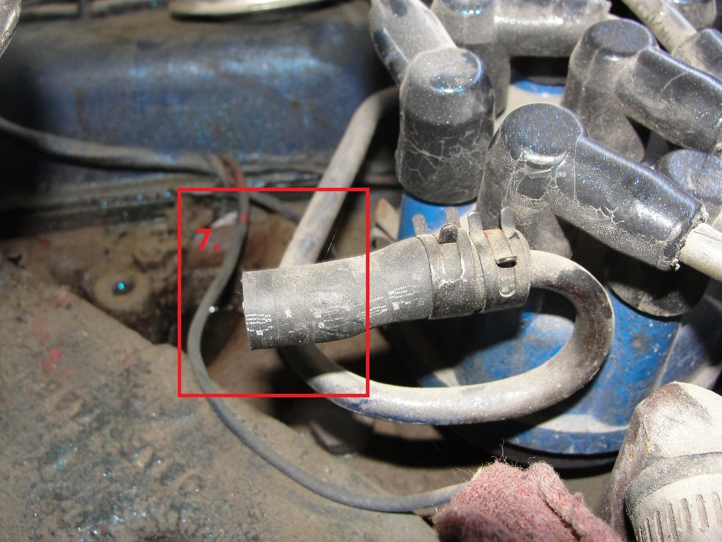

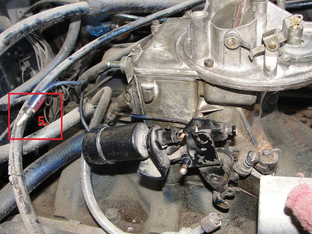

Okay guys, I've set the carb on there. Now this part I really do need some help with, I've set up a system of pictures consisting of numbers one through nine for connectors that I took pictures of. I need help matching them. Think of it like a game:D
a terribly confusing game for a nub like me.
It's a lot of photos, but I'd really appreciate the help, or even a guide or write up of this. Some way for me to go on with hooking it up to the car. and again where should I funnel the gas into so I dont have to wait for the pump to get the gas from the tank(which might be bad old gas).

lets try this one pic. at a time
pic number one #1- choke tube ,comes from passenger side exhaust manifold ,may be broke off at the manifold as usual. dont worry its not.
pic. number one #2 -throtle lincage mount ,back two studs of carborator cable to the left side.
pic number 1 #3 -apears to be the fuel line?
pic number 1 #4- throtle lincage drivers side, pushes on the ball on carborator
more when i view the other pics
pic 5 #8 throtle spring, hooks on loop at the bottom of the carborator lincage to the bracket #2
pic5 #3 if its a wire it it must be the other end of anti diesel solenoid
ps choke tube is not broke off it is #6
getting a little confused going to take a minuet
pic 7 vacume hose not sure wich one it is but the carborator is on backwards
fuel filter to the front of car
check your gass tank to see if it has a drain plug at the bottom i would drain out the old gass ,be carefull dont get it in your eyes , to fill the carborator bowl i would remove the top of carborator and fill the bowl that way its the easiest way then bolt top back on, hook up your fuel line first
This will take some time to figure out, but I can't begin to express how much I appreciate you doing this, most people skim over with their knowledge because I'm not familiar and require so many questions. For me that's a full days work hooking it up, but really, thank you.

Carb being backwards, woops. -__-
