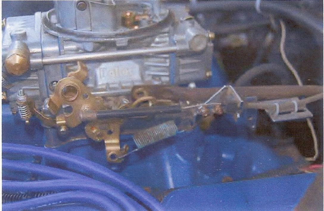

the bracket bolts on the back two studs with the square hole on the drivers side the throtle cable pushes through the square hole and snaps in place then the end of the cable has a clip with a hole that pops over a small ball on the carborator lincage ,it just pushes on. unless the ball has been unbolted from the carborator lincage. if it has you can get one from any parts store, i will see if i can come up with a pic.
i found a pic may be a little grainy,its a 4v instead of a 2v but its the same hook up

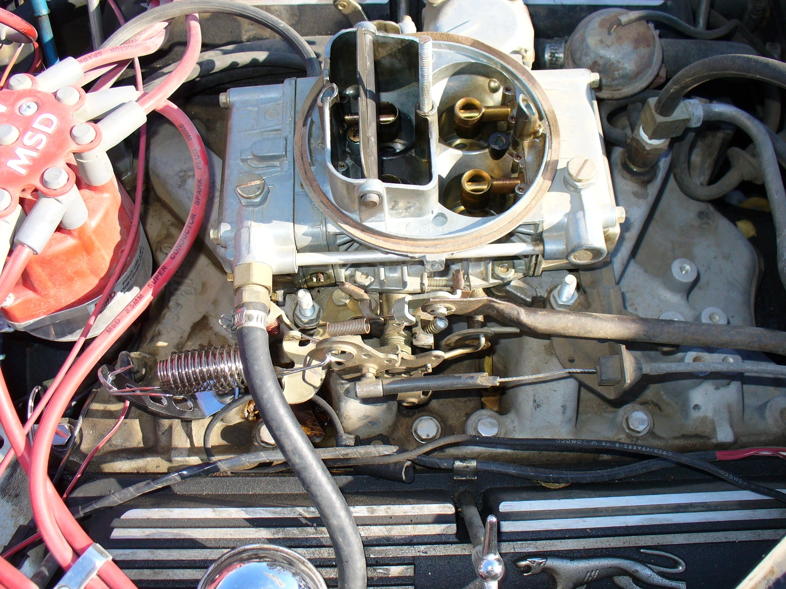

I googled and googled for hours and the only pictures of that 'bracket' i was referring to that is connected to the (what I believe is) throttle linkage (when I pull it tight it lifts the pedal) are these two.
http://shop.justparts.com/ComparePrice/9/12/10/125/18/10/41/500358297/11/Air Intake and Fuel Delivery/12/Carburetors?KeyWords=1969 1970 Boss 302 Mustang Carburetor Bracket&BackToUrl=http://shop.justparts.com/Category/9/12/10/125/11/Air+Intake+and+Fuel+Delivery/12/Carburetors?f_Facet76=Ford&f_Facet77=Mustang&fq_MinPrice=%5B40+TO+60%5D
http://shop.justparts.com/ComparePrice/9/12/10/125/18/10/41/500495522/11/Air Intake and Fuel Delivery/12/Carburetors?KeyWords=1969 1970 Mustang 4v Carburetor Throttle Cable Bracket 302 351 390 & 1969 428cj&BackToUrl=http://shop.justparts.com/Category/9/12/10/125/11/Air+Intake+and+Fuel+Delivery/12/Carburetors?f_Facet76=Ford&f_Facet77=Mustang&fq_MinPrice=%5B40+TO+60%5D
Both on the same website. They look similar in that they both are L shaped like mine and deal with the throttle, or gas pedal. Still have no idea how it bolts up to the intake or carb or where ever it goes. Anyone else running an auto lite Carb? 2100 or 2150?
The throttle cable does mount in the same spot as the Holley Carb you posted horse sence, but it doesn't show any kind of bracket like mine. It's separate from the automatic kick down.
"This attaches to the rear two carburetor to intake manifold studs and properly holds the throttle cable in position" in the add this is the only info it really has on how it mounts. I just cant seem to figure it out.
