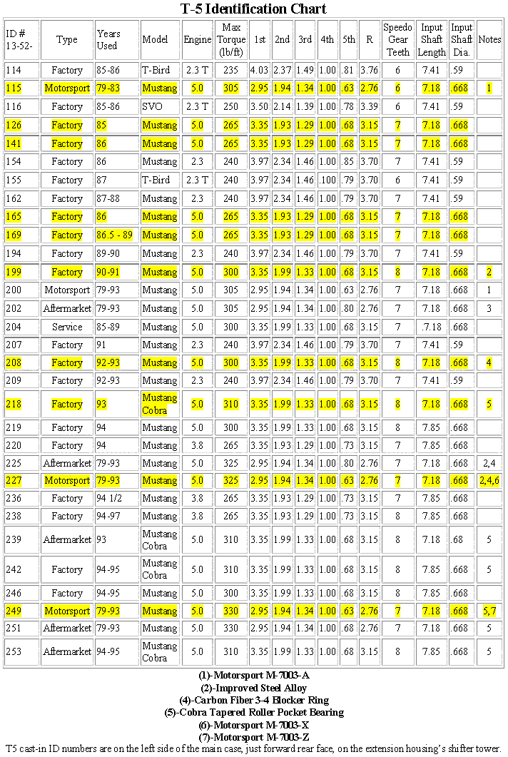

Hi Ben,
You technically can use that transmission, but it is not rated to hold as much torque as the Foxbody Mustang T-5 . Here is a chart with the ID numbers to help you see the differences between them.

Question is the roller you have access to a GT or a V6 - it won't be both? If GT, use bellhousing and trans, you will not need to change input shaft/bearing retainer and it will work behind your 302. You will want a flywheel for your '73 - 28 oz, 157 tooth. The 94 flywheel will not work without rebalancing the engine.
If the roller is a V6 you can use the trans, its power capacity and gearing is the same as 89 and older V8 Mustang T5s. The V6 bellhousing will bolt up to your V8, but requires a 164 tooth flywheel for the starter to work properly.
