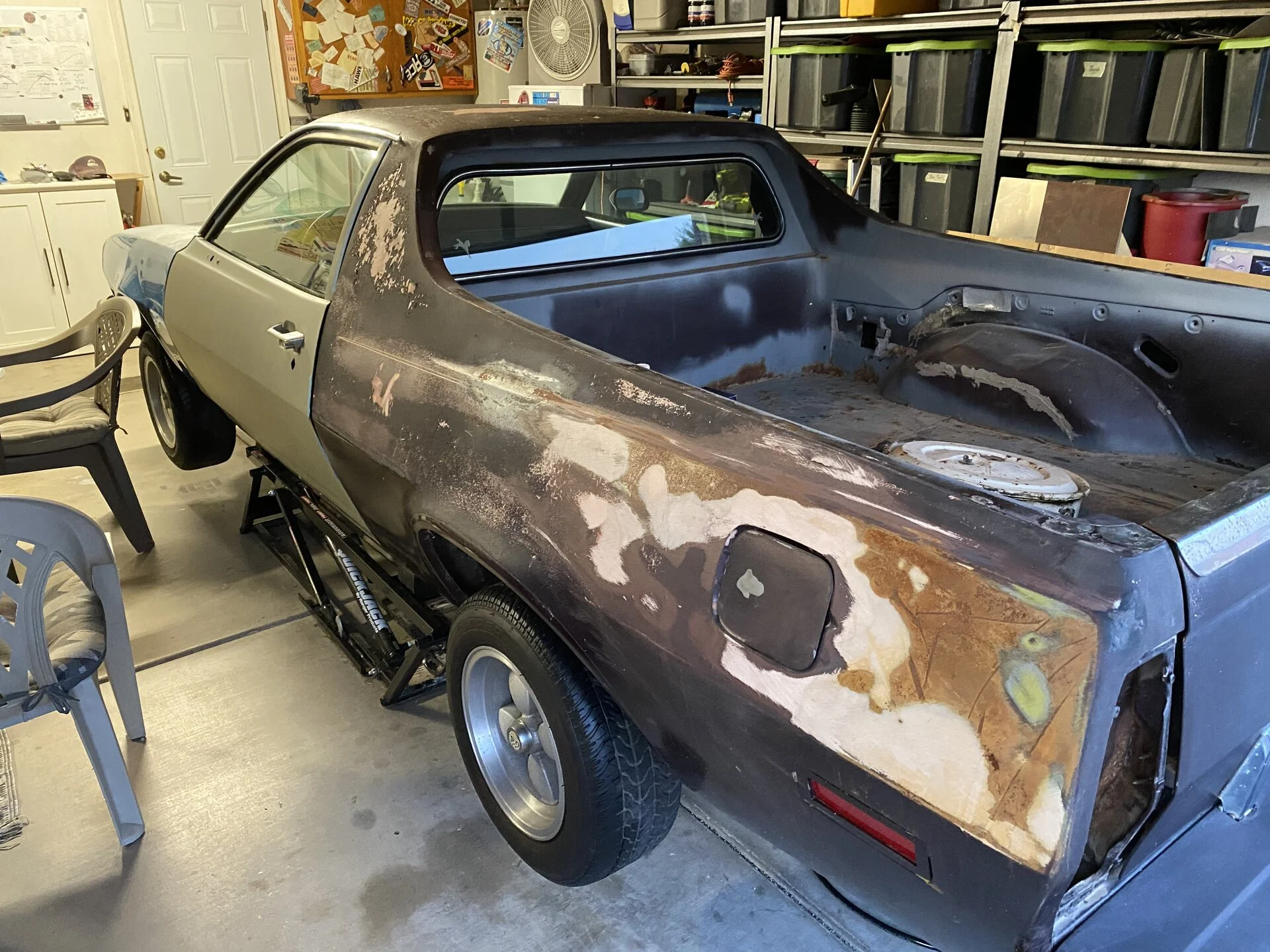

I'm restoring a custom "mini Ranchero" that my grandfather made in 1981. I'm trying to determine if a 5 lug nut Bobcat/Mustang II axel will fit a 74 Pinto. Assistance is greatly appreciated.

what engine / trans mission in it? (v6 air cleaner in bed?)
Maybe it needs smaller bumpers and a Mutt2 hoodscoop, love the headlight extensions
We want more pics / info please,

Love the Mini Pint-Up.
