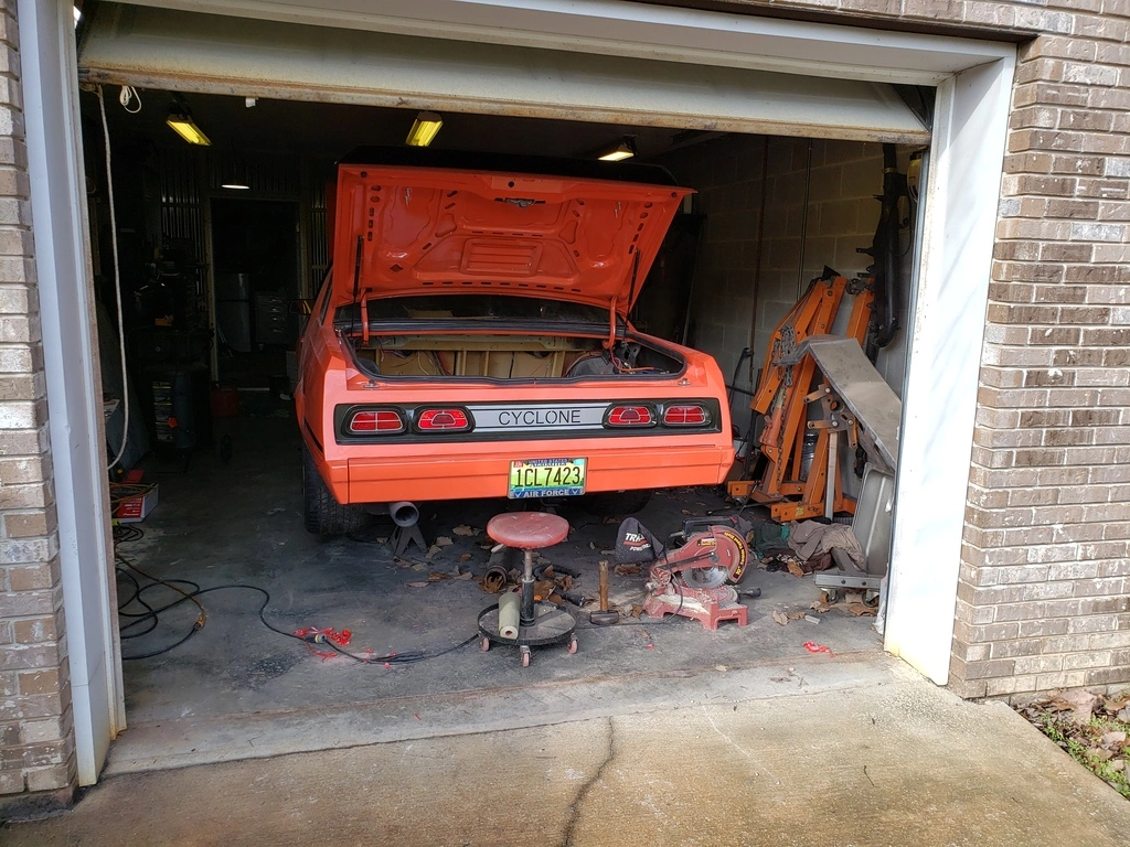

It's slotted to show up at 11:00 AM on a pallet. While I'm waiting, I finish the cyclone center section...I'll just say that I think it still needs something now that that is done.

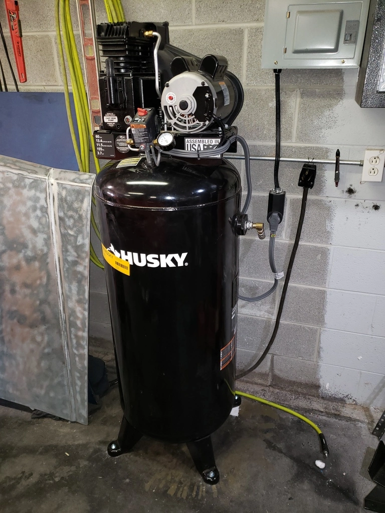

When the delivery guy gets there, he drops the thing in front of my garage door, has me sign his iPad, and off he goes..Now I have to get this thing off of that pallet, and into the garage by myself. The spec says that it weighs 255 pounds. I realize that that means dead lift, but it is a vertical compressor with its motor, and compressor on top..I expect that it will be very heavy once it starts to tip over onto its side. I go get a moving blanket fold it several times over and lay the thing on the ground.. I unbolt the compressor, and lay it over on its side, on top of the moving blanket.
There was a brief moment that I doubt that I'll ever get the thing back upright again by myself,..but this is me were talking about..and I'm much stronger than I look.
It's bolted in place and wired with a dryer cord so that I can just unplug my welder, and plug this thing in instead. I made a little hooky-doo to hold the plug when the welder ( or compressor) isn't the thing currently plugged in. I gotta get some sort of regulator plumbed in, as well as a filter dryer and a manifold type of airline system with drops and water traps..but that isn't gonna be necessary until I actually start to consider pointing a paint gun at things.

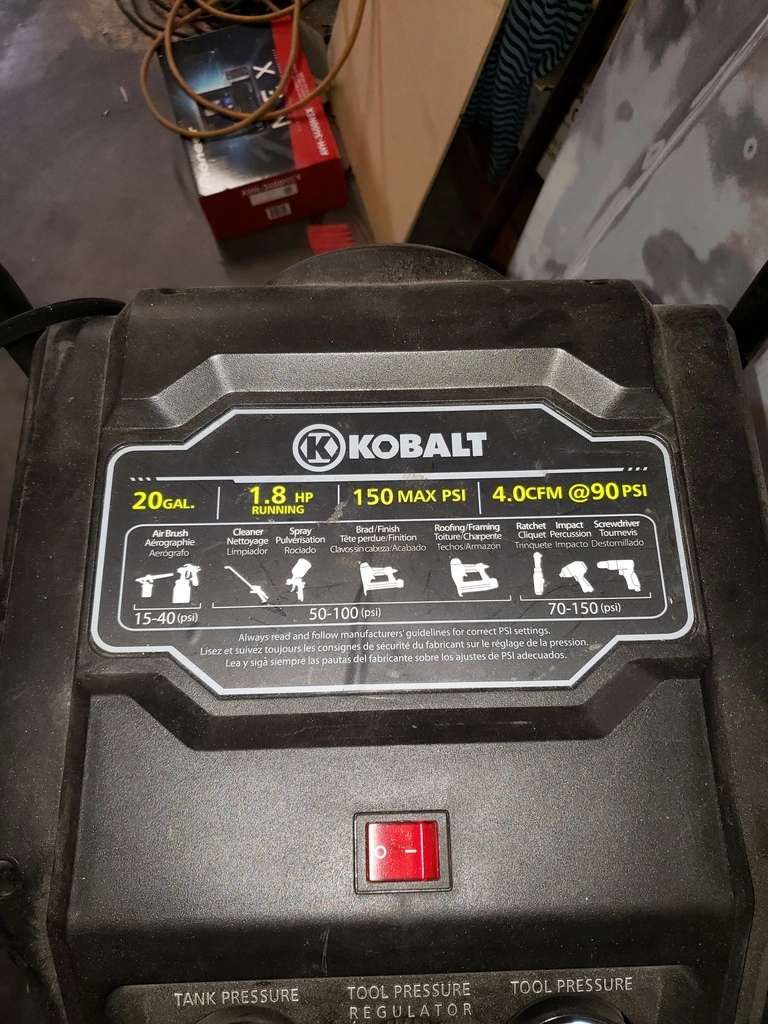

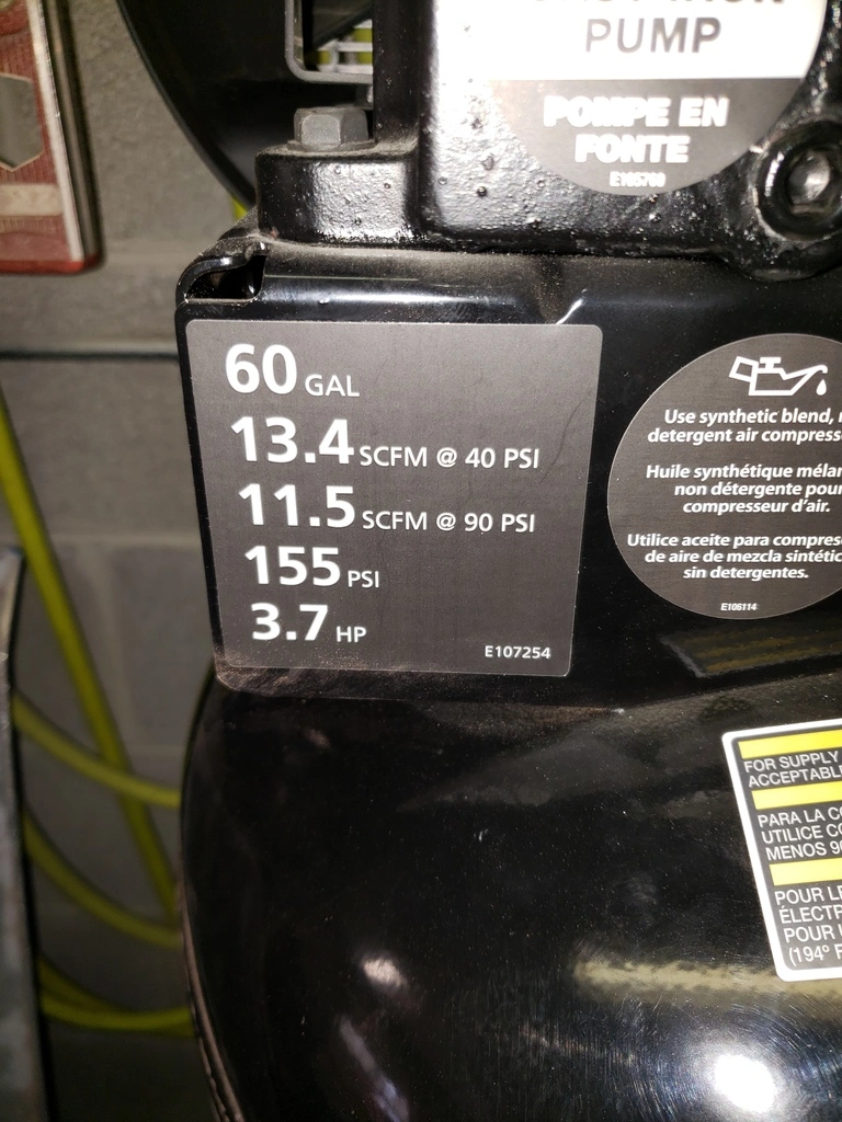

It is the fix for what ailed me though,....the little compressor pales by comparison:
Just shy of 3 times better across the board..3 times better capacity, 3 times more airflow...about 1/2 as noisy.
