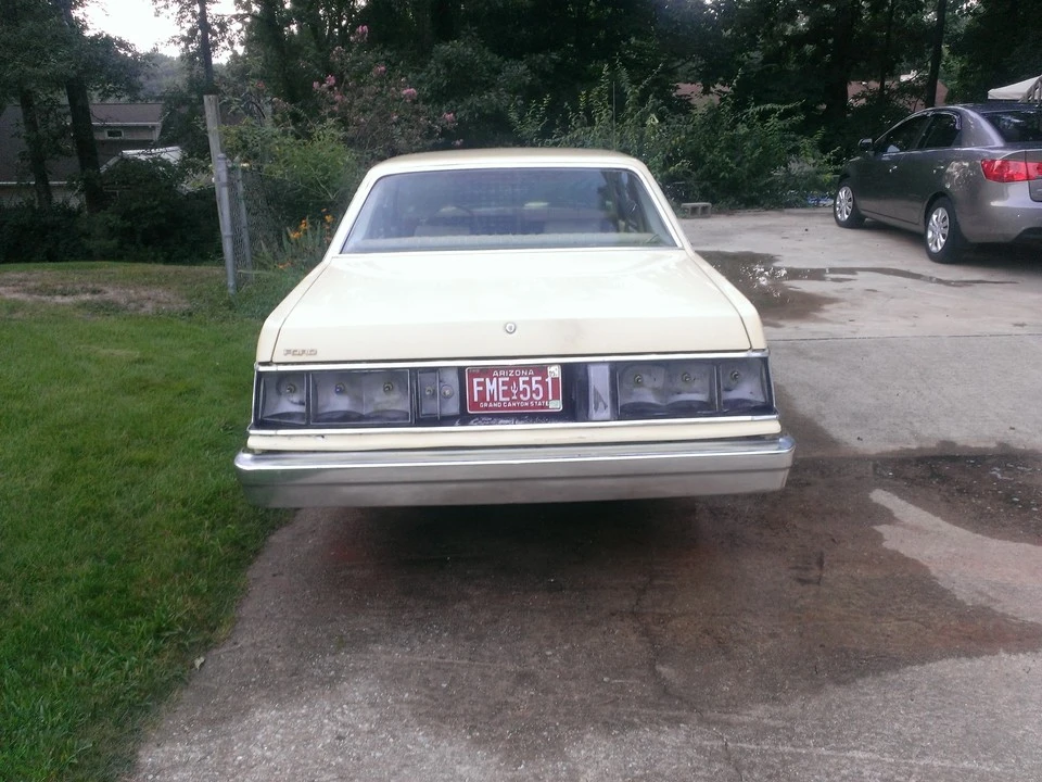

When I get it,..it looks like this:
The only thing remaining was the one broken, cloudy, raggedy assed back up lens,...and the AZ license plate last registered in 2007.

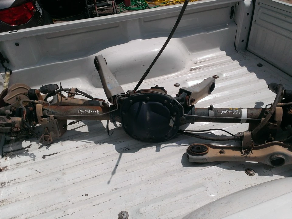

30 minutes later I got a complete 3.73 geared 8.8 out of a 95 GT w/great rotors, calipers,... and e brake cables for the cash price of 300.00.

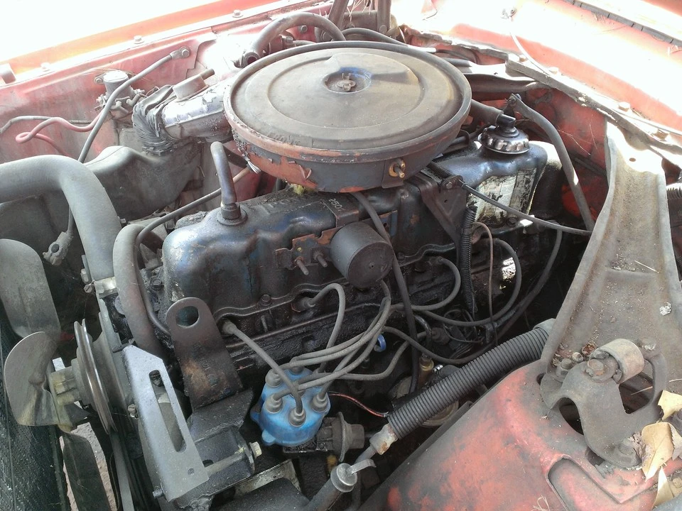

My future ugly little banger:
I rubbed the grease off for you,...top line confirms the C.I.
This should leave you with no doubt that this engine is truly a high performance piece,...just check out the exotic factory ram air setup.:lol:
