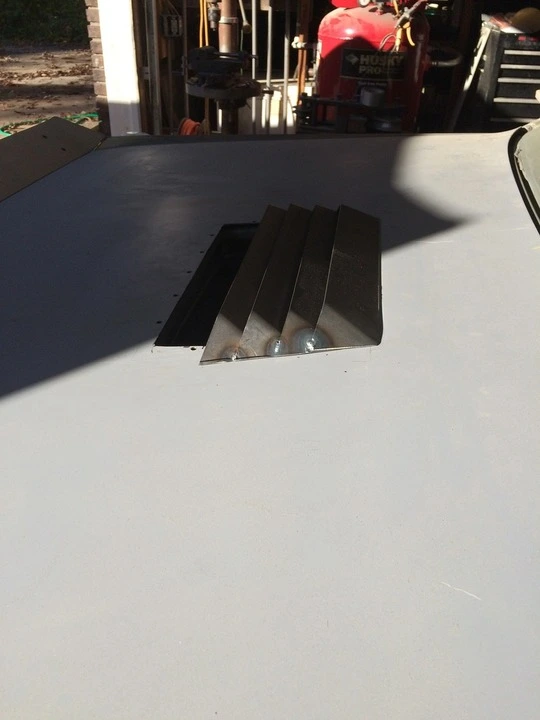

Witness the beginnings of the Gila Fin.

I ran out of steel before I could make the final 3 courses, but I believe that this will be the better solution than the grille that was there before. This means that I'll have to weld those 15 holes shut, and glue the sealing flange to the under side of the trunk (cant weld it, it has to seal in order to maintain it's water tight status)
I think I'll use something other than epoxy, something like windshield urethane sealant instead to hold it on the back side. If I can get a couple of nuts to hold the flange to the bottom side of the trunk deck, I may weld a couple of studs into the holes that used to have bolts going through there. I don't think I can, but I'll see.
Should have the G fin finished tomorrow, first I gotta go downtown and buy another 5.00 piece of steel.
