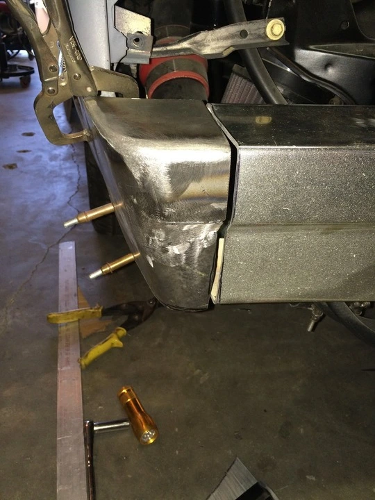

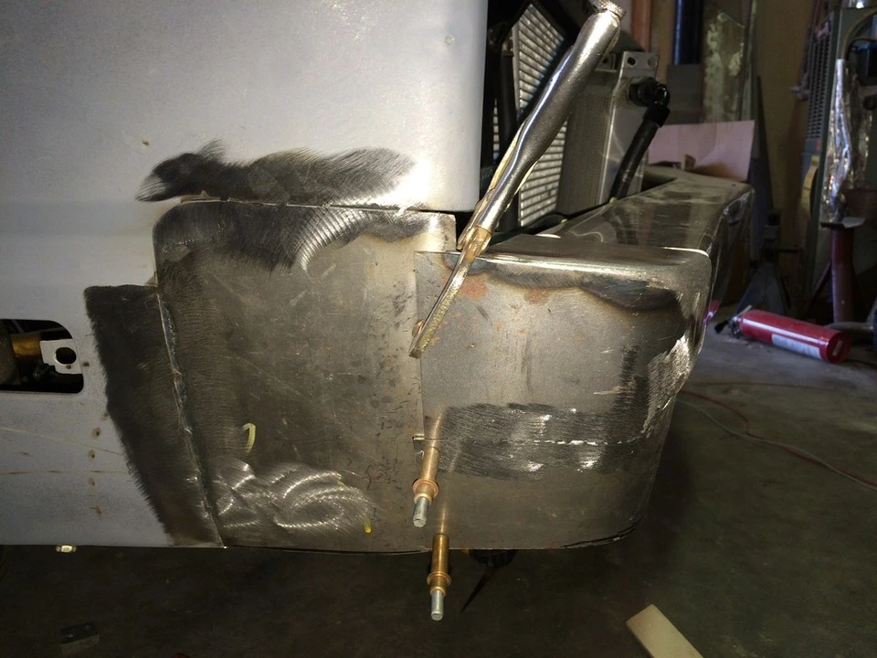

What I managed to get done before Thing #2 took a crap was get the other bumper extension pretty much complete. As with everything I do where there are two, the second piece is always easier, or better, of took less time, or required less work. This was the case w/ this side as well.
The driver side extension is made up of 6 separate pieces of steel, the passenger side was half that. The driver side took 8 hours, this side took 4.
I still have to cut the piece of steel where the overlap is, and butt weld the extension in place, but it's getting there.

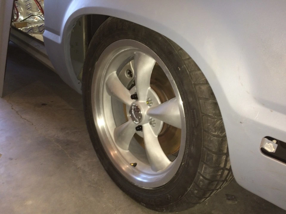

Also, since the fenders are on, I took the opportunity to check for interference when turning.
The tire hits the fender at full lock. The clearance that is there is laughable because any dip in the road w/ the tires turned will result in a hard scrub. The front end has gotta come up an inch.
Had I not bitten off so much other custom fab crap with this car, I'd consider going back to the drawing board, and bulge the fenders, and quarters Ala Capri, Then throw on some big assed 295's up front, and maybe a 335 or bigger rear.
But,.....ain't gonna happen. I have more than enough on my plate if I ever hope to get done in time for spring '16.
