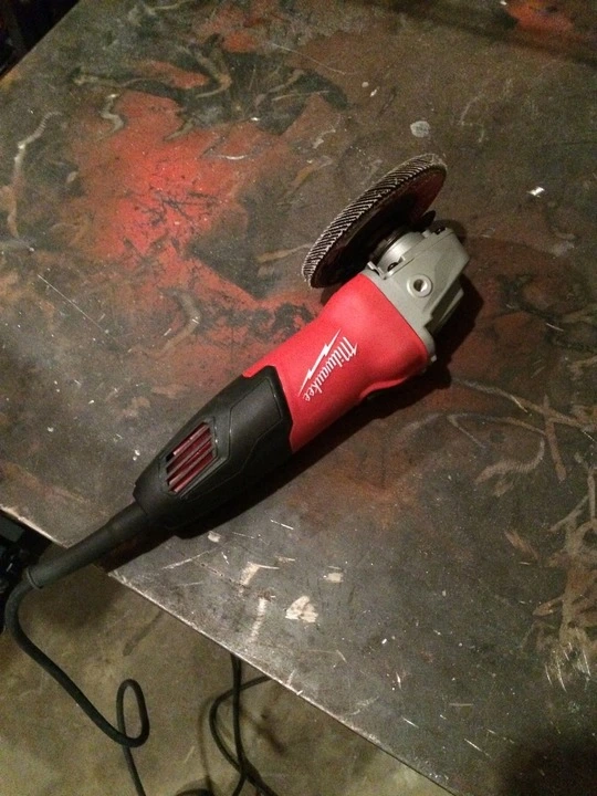

On the previous reply I said that my grinders had both died. I use two 4.5" angle grinders, and keep one for cutting, and one for grinding. Before they did die however, I told the wife that I needed two new ones, and that they were cheap enough that one of the kids could buy me one for Christmas. Since I had to have one at least one however, I went to Sears and bought one of theirs so I could make due.
Come Christmas,...turns out that the Senior Airman that is #1 son decided that I needed a really good one. So he buys me a Milwaukee 7 amp rated piece.
I'm back to being a grindin' fool.

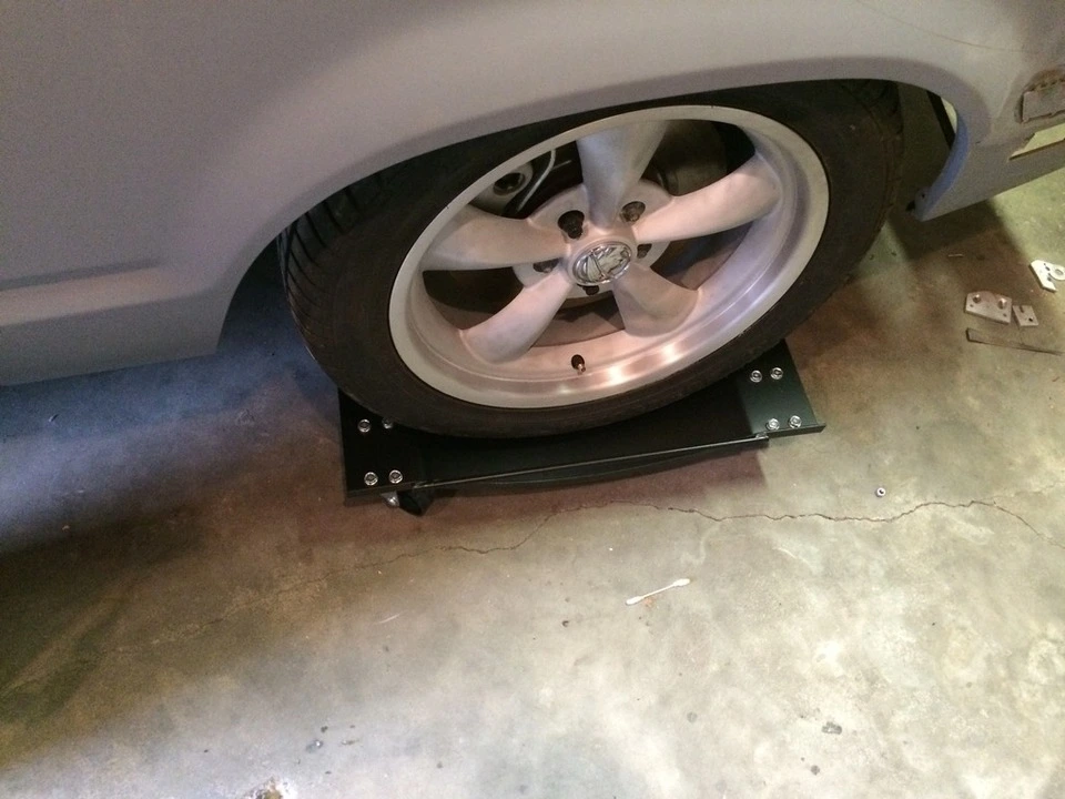

The wife buys me these HF rolly things for under the tires:

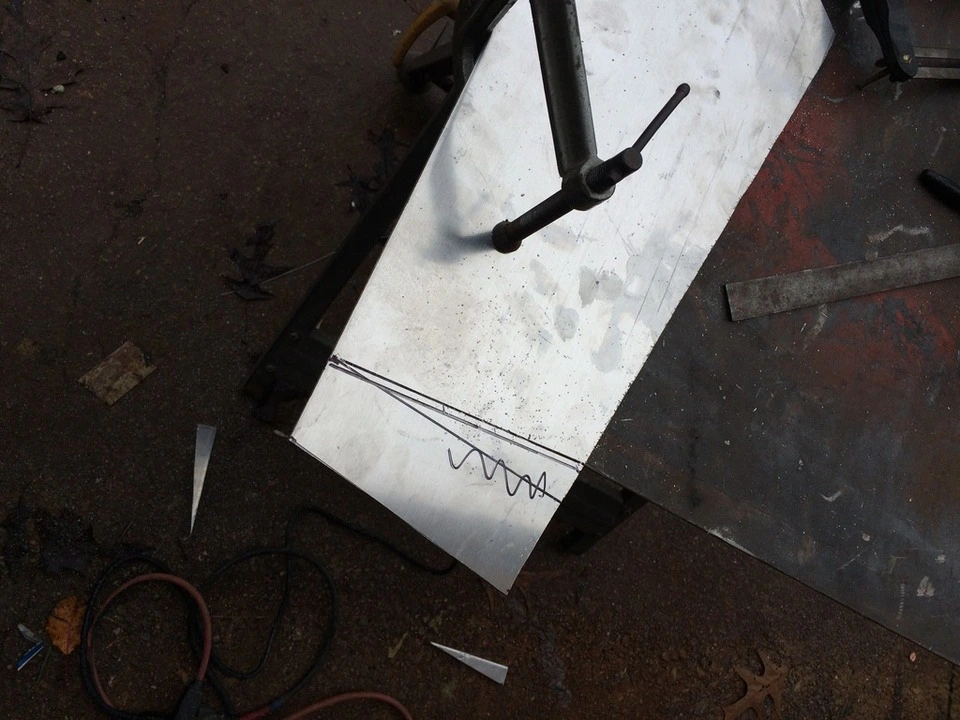

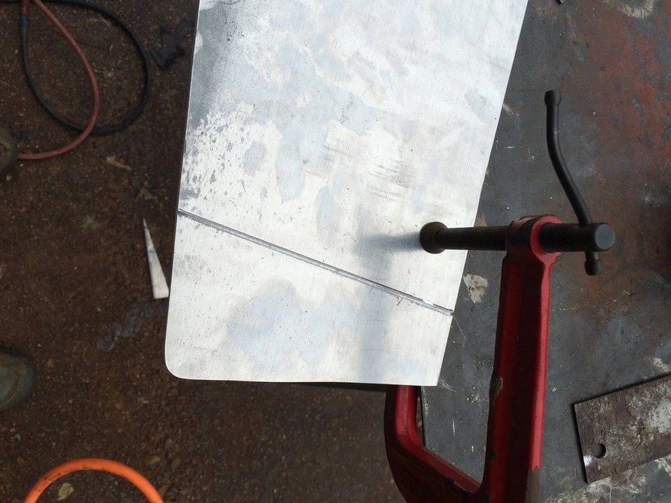

I'm making the thing out of two separate pieces. The shroud that holds the oil, and transmission cooler being the centerpiece between the two sides. I scribed the lines, marked the angles, and cut the pieces out w/ a hand held band saw.
At the end of each side the thing angles up to almost 90 degrees to follow the down angle of the fender. This is 3003 alloy aluminum, the same stuff I used on the trunk that makes up the G tail in back. It's bendable. Unlike 6061 alloy which is way more rigid, this stuff wont crack when subjected to the stress of getting bent.
Nonetheless, it was still 1/4" thick. It's not like I'm gonna bend the thing over my knee or anything. So I flipped the thing over and cut a relief into the back side so I was only trying to bend 1/8" instead
After that, it bends by hand in a vise.

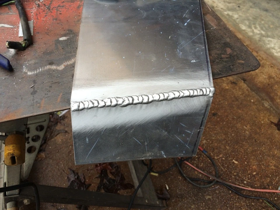

Once at the angle I wanted it to be, I broke out the spool gun and converted the welder over to weld aluminum.
Considering that this was the first time I've ever used a spool gun, (and ever attempted to weld aluminum) it was easy in retrospect. The feed was a little too fast, but I pulsed the thing anyway, the plan is to grind that weld smooth anyway.
It's gonna take some serious staring at the thing to decide how I want to mount it, but there will definitely be at least a couple of clevises on the outermost part, The inside edge will bolt to the lower radiator saddle, and there'll be a tab welded onto each side of the cooling shroud to support the thing. I want it to be almost parallel to the road surface when it's mounted.
but since it isn't this is where we stop.

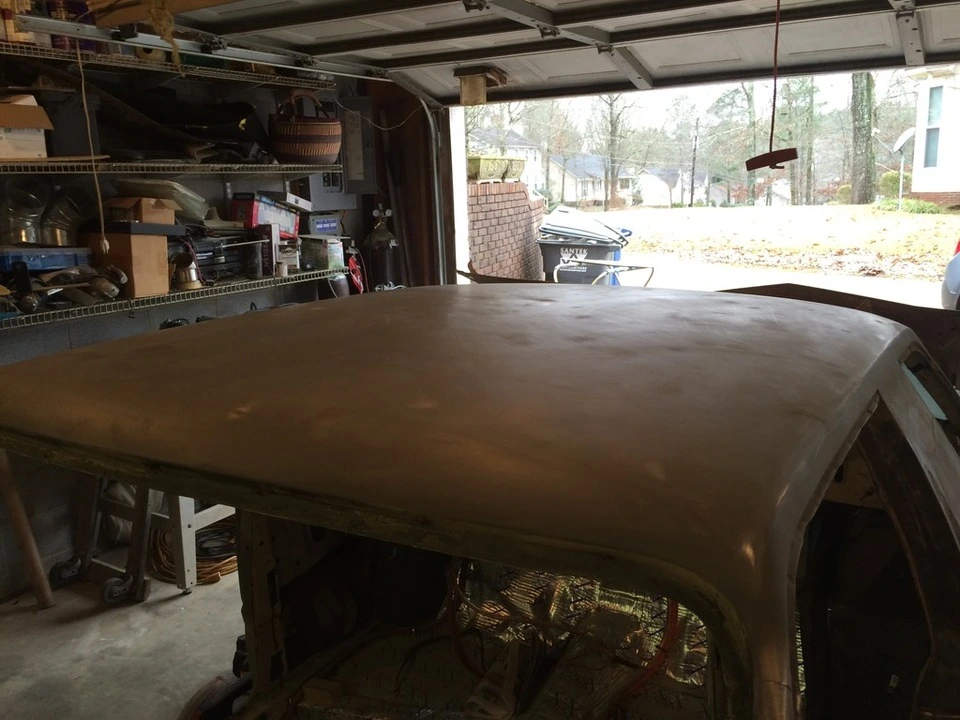

I did manage to get the holes plugged and sanded down on the roof. I rattle canned some etching primer on the roof until today, This is what I got after a round with the long board
I'm just gonna assume that you can see all the low spots in the pic.
Hail damage. Not bad, but enough to show that the thing has been exposed to it before. I was focusing on getting the 15 or so holes that the roof trim used to go through fixed, that I ignored the rest thinking it was all good.
:nono: No said the finger. Not good at all.
You cant feel these low spots. This is one case where I'm unsure if the proper solution to fix this will be the subsequent layers of high build primer that have yet to be applied.

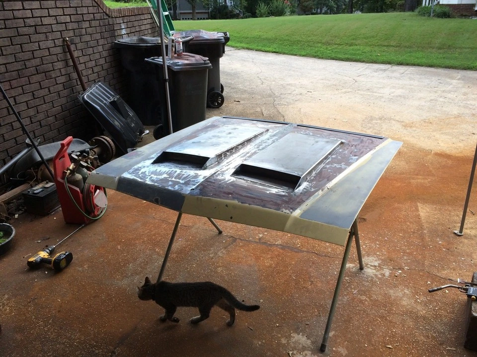

After I get the front spoiler thing fixed, I've got the passenger side G gill to finish, and get spot primed. the last point of contention is the internal doubt concerning the hood scoops.

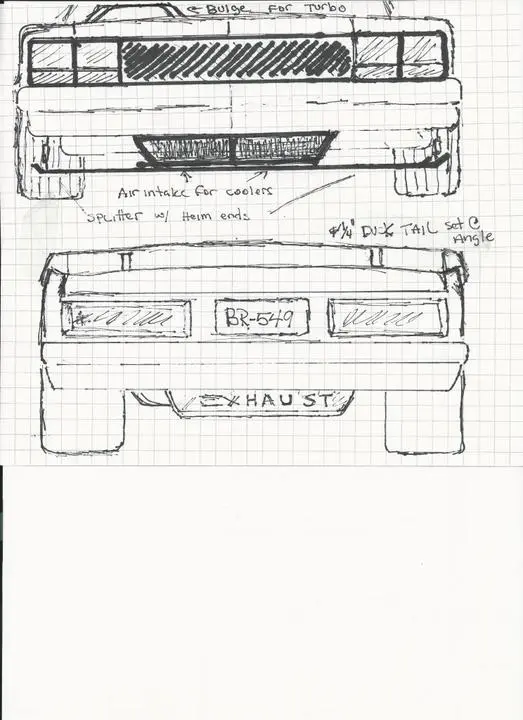

The original hand sketch had a single blister on that side of the hood where the fitting on the turbo sticks through the hood. I have the material build that blister. This time it'll be better than the cake pan that was my first attempt at it.
I just don't know. I kinda like the twin scoop thing, but one way or the other, I have to cut a hole in the hood for that fitting to poke through. One way, the engine/turbo will be exposed to water and air (unless I close the hood scoop),....and I'm thinking what would be the point of a hood scoop that doesn't do anything? The other way (with the blister) there is no false scoop sitting there, just a big assed bump. leaving somebody to wonder why it is, and what is under there.
The scoops are made, the blister is not. There are 12 holes drilled in the hood that the scoops would've bolted through if I use them, but even that is looking like I'm gonna weld those scoops for the sake of making them permanent so they wont move around and mess up the paint later.
If I have to have a problem with the scoops,..its how thin the front edges are,....they're are almost a knife edge.
One way of the other I'm welding something to that hood.
I really like the blister idea. Not a run of the mill rivet on tear drop or square cake pan, but something blister like. Reminds me of the BMW M hoods where they rise for engine clearance. That, and I know you are a gluten for punishment, so go ahead and pull those scoops off. Fake scoops will just earn you a lot of grief, and I dont think you need that water on your engine or turbo system every time you wash the car.
I like the twin scoops. Is there a way to baffle them, that way they are functional but no water will reach the engine? what is the purpose of them being open if they do not feed air to anything. That said I say run the scoops, even if they are fake it's the look your after no?
No,...the blister is the original concept. The original blister ended up looking like a cake pan, and promptly got scrapped. The next version (tomorrow) will be the determining factor.
Well, now that you mention it, that is what I set out to do today. Right after I mounted the two halves of the splitter. Doing that revealed just how off the other bumper extension was on the other side, so I ended up re building that instead.
Maybe,....but you should know that if I put the scoops on there permanently, they won't be " fake".

The 6061 and 3003 both will bend about the same. The problem is that they both require a 3/4"-7/8 bend radius, and judging from the picture you took, that would not have been what you desired.
See Aluminum Minimum Bend Radii | Cumberland Diversified Metals
I can't say exactly what the bend radius is, but I can say that it's at about 70 degrees.

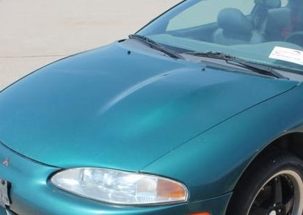

@madmike1157 I know you probably already looked at one but would a "blister/bulge" like the ones on the older model Mitsubishi Eclipse completely conflict with the lines of your car? Just a thought.
Too roundy.
Those always looked like someone closed the hood on a semi truck tire
If it was me were talking about, that would be the reason the bulge was there

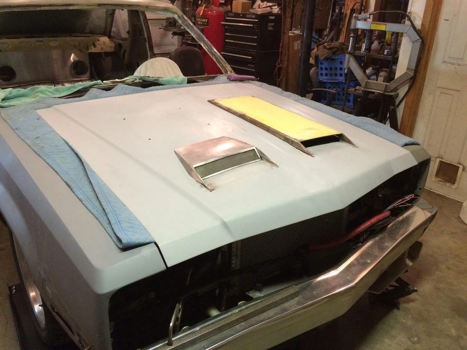

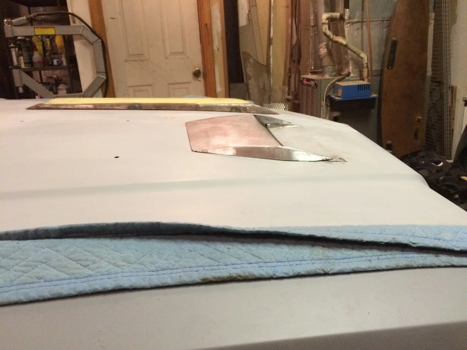

An ephaniny is a rare thing. Something that comes along once in a blue moon and smacks you up side the head like something out of a Madea movie. Today I decided to deal with the hood scoop dilemma vs the bulge.
The scoops are complete. Not really feeling all warm and fuzzy about the scoops that I've built, I decided to give myself an option before committing to a permanent solution.
I stated before that I was gonna build a bulge to give myself a "either or option" before ultimately deciding which way to go. Today,...I think I solved that problem without even trying. Kinda like an old Mike Tyson fight...over before the round one bell rings.
I made a bulge,.....that is a scoop.
Well,...look
A bulge that is a scoop.
Obviously, only one side built compared to the old school version up against it. To me,...no contest. The new scoop, inspiration coming from a Buick GS,...is'nt really Buick, but is at the same time... Kinda a Mike-Buick mutation... AKA
Muick
