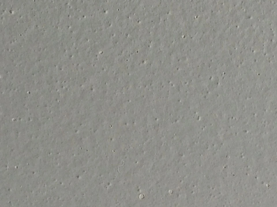

I got water droplets everywhere.

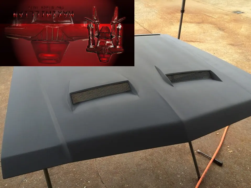

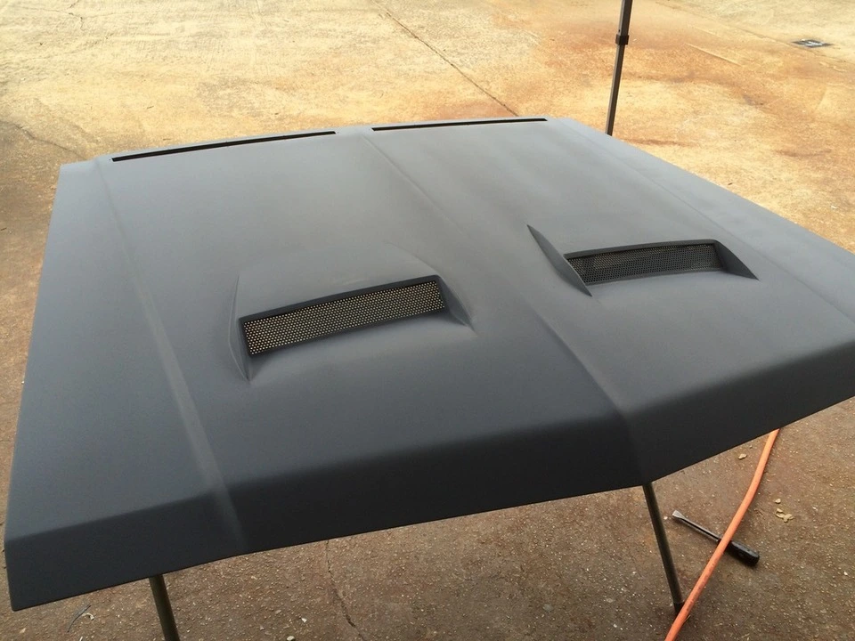

I did all this out under my makeshift, redneck spray booth. The same one I used for the dash bars, the same one that I used for the green wheels. The only difference I could cite today, is that it's overcast. I couldn't see the water in the primer until I went back and looked afterwards.
*PsshhT "Uhh Mission Control,...this is LEM......have LZ in sight,....touch down in 3,...2,....1,... Mission Control, we are on the moon.

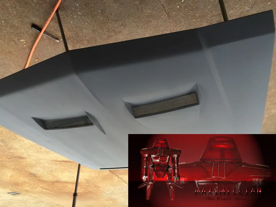

Literally,...if you didn't know you were looking at Mike's hood,...It could just as well be the moon.
As expected,...primer reveals what your eyes and hands cannot.
There's still a bunch of work to do.
The center rib is still kinda wonky,..and the front legs of the scoops are kinda weird. Ones thicker than the other, and a couple of the lines are a little screwy.
But it is flat,.......So I got that going for me......Which is nice.

Get one of those little orange ball water seperarators that you put on the inlet of the gun. I have to spray primer on my engine bay this weekend and will be using them as well.
Hell man, you're in Alabama! Do you even have an idea what a low humidity day is? I suffered there in the summer a couple years in the eighties. Temp. was only 91, but the humidity was about the same number. GAWD! It was hot.

Spent time looking at the photo, the only thing that would drive me nuts would be the center body line between the scoops. Kind of flattens out there. In spite of you CTing me about my quote of analness, I'm thinking you might be the same, if not more, just no CT to go with it.
Not meant to be insulting at all, but I would probably block with 180 and form that line as best as I could first. See what you can make the primer do.
Then decide if a second priming would take care of the problem or not.
It's not ugly or bad. I see it pretty easily because that's what I have been doing every day for a long stinking time.
If you are intending to use this as a quasi guide coat, block with 180. you will be able to form things. With 320 you just take out the small waves that everyone has.
