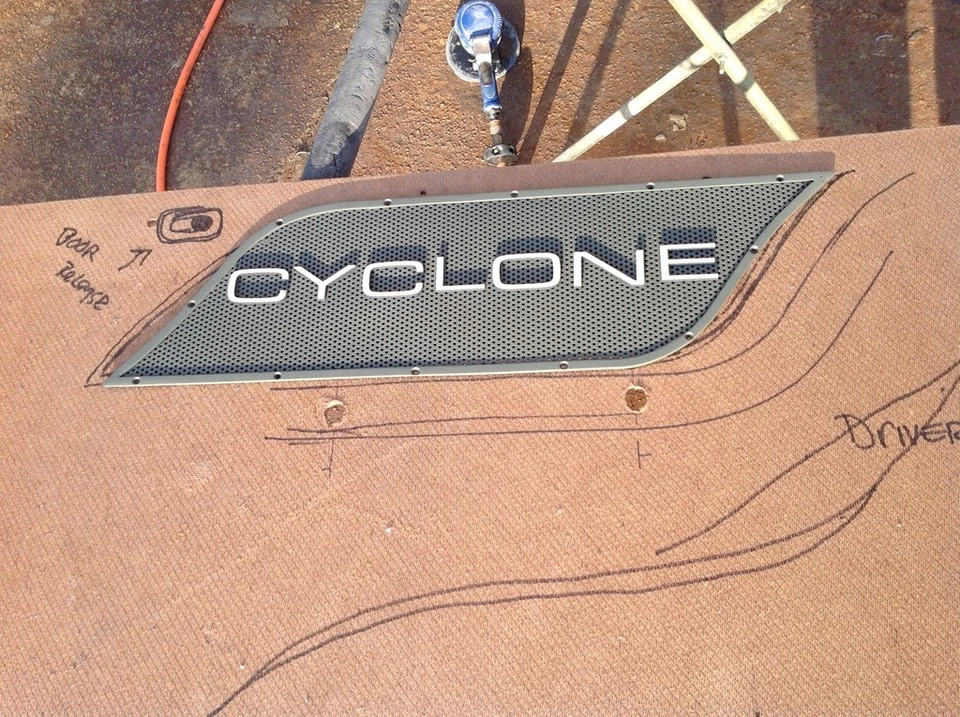

The first part of that involved building the center detail piece.
Pretty cool huh?
The letters are plastic. In this pic, you're seeing the protective paper covering them. When I get them permanently installed, Those letters will be brushed aluminum finish. The mesh backer, will be the same copper that is everywhere in the interior. The frame will be black. This piece will sit slightly recessed in that same antiqued leather that is on the dash. The large "pod" that will be in the front will be covered in black vinyl. It will have the speaker, and I'm thinkin the pwr window motor. (aftermarket) Of course, the door bar will be the same satin black that the dash bars are.
Building the stupid little thing ain't easy. That little frame is cold rolled steel, 1/4 x 1/8". It has to be bent by hand to follow the contour of the mesh, which follows the curve of the door bar. Getting it perfect involves little small bends made on a "bend, and check, bend and check" regimen. It takes forever, but,...eventually it sees things my way.

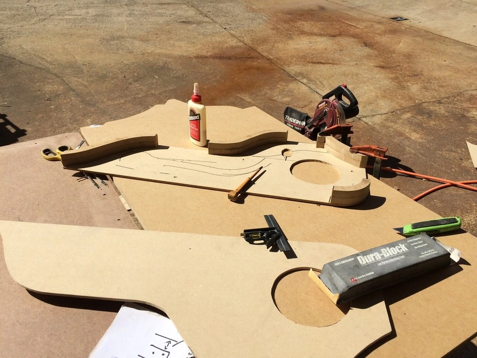

Keeping in line with yesterday's update, The entire day was spent standing in the sun being Hans the Woodcrafter.
The front lower thingy that the speaker will live in (whatever that's supposed to be called) is what Hans built.

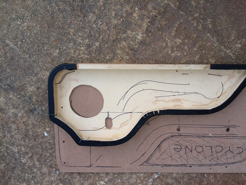

That started with me making two identical boards out of 1/4 MDF ( if you can actually call anything I make two of "identical")
One was the backer, and the other was the fronter.
The problem arose when I needed something to make the in-betweener.
See, the front has to stand 1.5" off the back. I needed something I could cut easily that would be, or add up to the distance.
What I needed was a piece of 3/4" MDF.
Did I have it? Course not.
Despite me saying that I ran all over the town yesterday so that I'd have everything I needed to make this stuff today, I clearly was lapse in my thinking. Nothing else to do but go to HD.
While I was at it, I needed a can of satin black spray paint for the grille insert that I made yesterday,....it never ends.

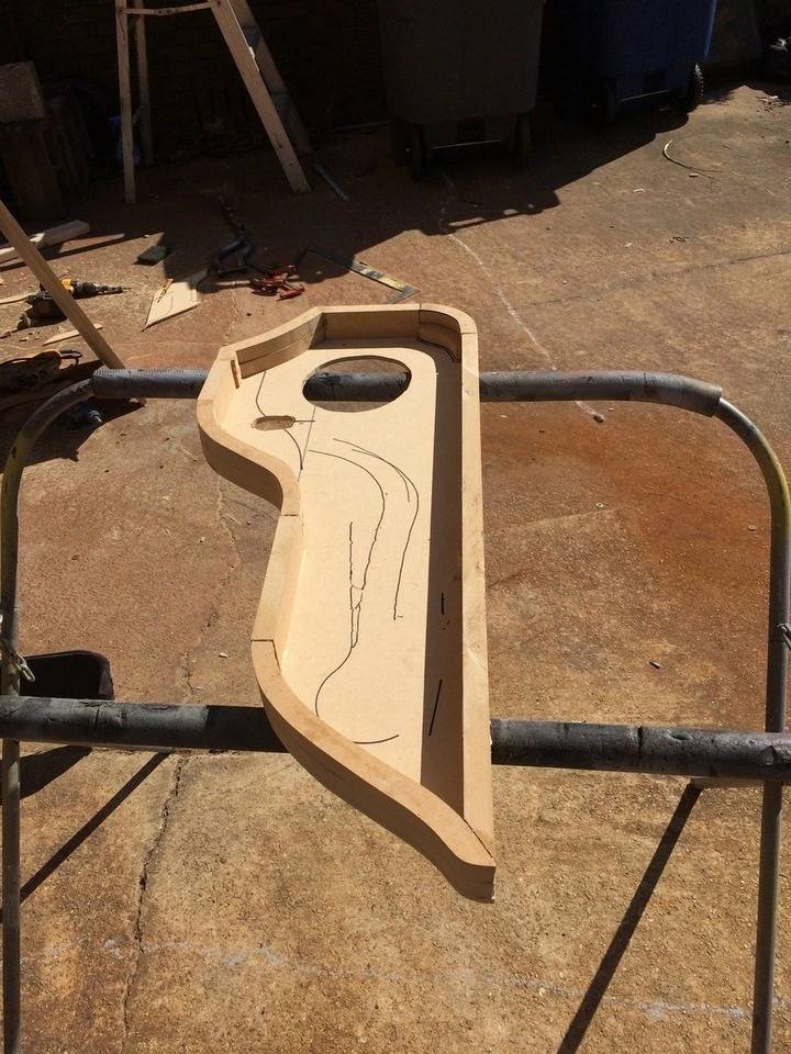

I return, and get to it. There are 4 compound curves that had to be accommodated. I had to cut two pieces for each curve, and glue them together. After they set up for awhile, I moved them to the backer, and glued and stapled them in place.
After that, I simply ripped a 1.50 wide straight section out of the MDF, and connected the curves.
It took some sanding to get the two glued pieces and the backer board in harmony with each other, and for awhile I was actually considering just painting the whole thing, but then what was I gonna do with the 20.00 worth of black vinyl I bought yesterday?

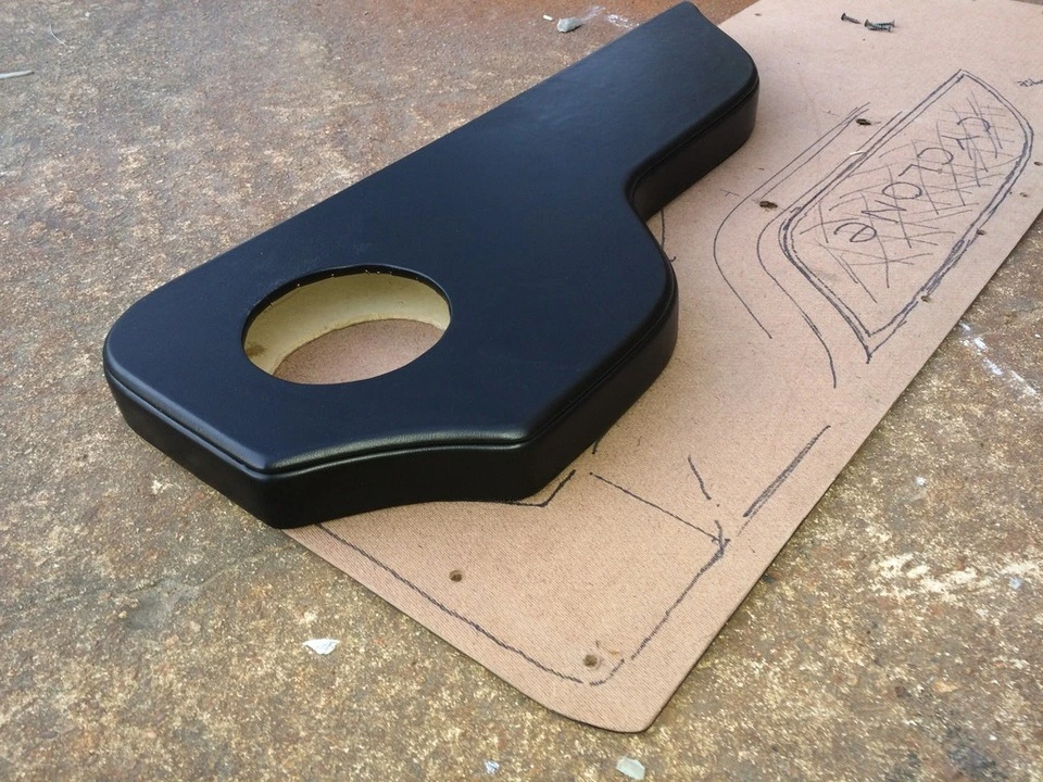

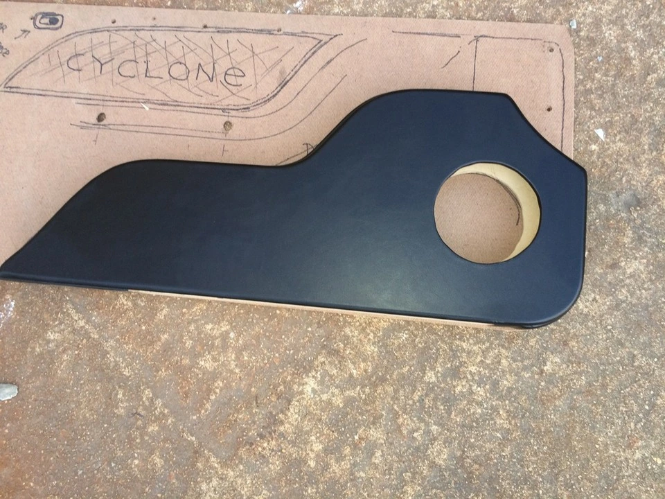

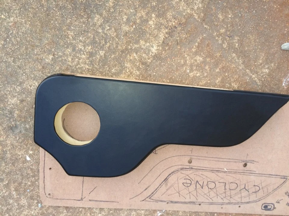

I decided to cover it.
For a minute the thing actually looked like some sort of wacko looking stringed instrument w/o the strings, but that all changed after It got covered.
So you're looking at this big assed thing, and thinking..."Why did he have to make that dumb thing for anyway/"
and to that I'd say:
"In time junior,......there is always a moral to my stories...."

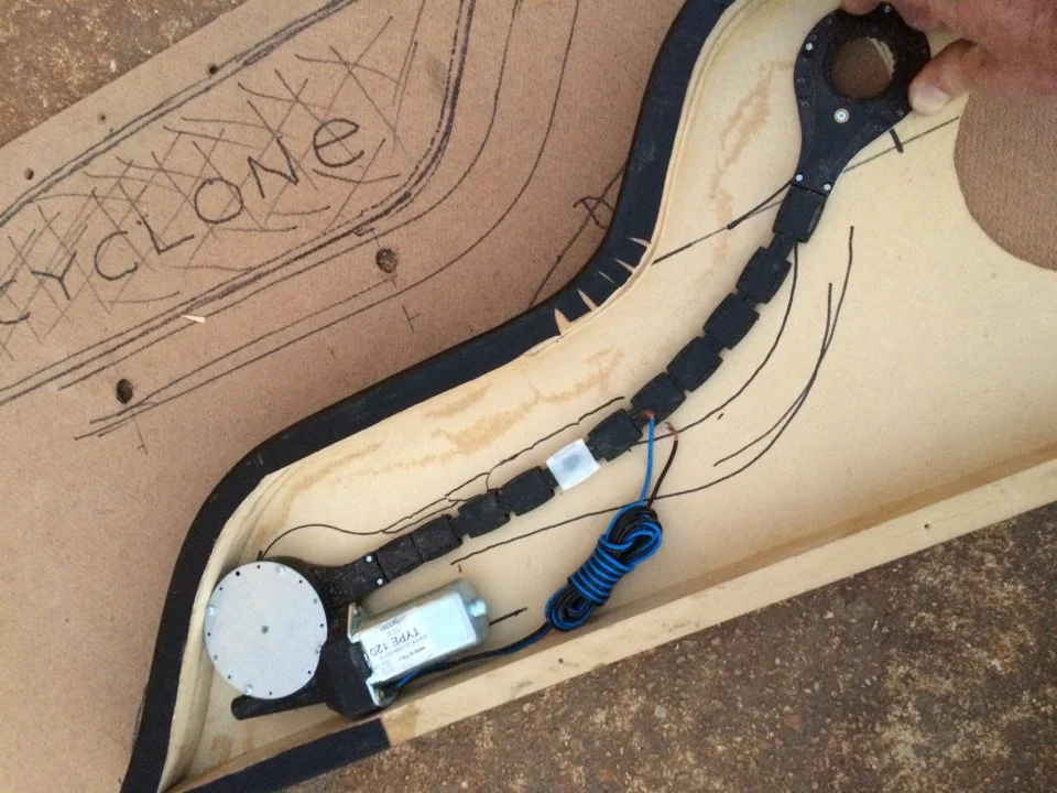

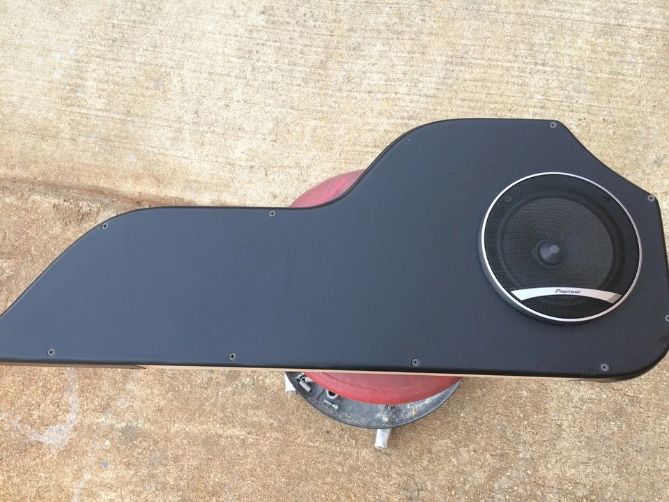

For one thing the component speaker that goes in the hole is too deep for the door, but primarily because of this thing:
This goofy assed solution is how you make a manual window, a power window when you cant simply change the regulator over from one of the buttload of Mustang parts houses out there. Despite the fact that Fairmont is a fox, it shares little when it comes to stuff in the door. Bottom line,...I'd have to find some fairmont that had pwr windows ( needle) and some JY that had that car in it (haystack), and then I could convert.
I'd be using unknown, crotchedy stuff that may, or may not decide to take a dump on me at some unfortunate instance.
I'm having none of that. Now that I have this "access box", the repair/replacement of this system is only a matter of a few screws......my door panel can remain on the car.
It Genius!.....but then again,......it's my job.

I'm planning on making that box a separate part of the door panel. In other words, I'm cutting the outline of the box out of the door panel, and screwing that box directly to the door. The remaining door panel will butt up against it. The reason for that is because I don't want to have to remove the door panel should I need to access this thing.
(Can you get a feel for the lack of confidence that I have in the French made pwr window gizmo?)
It really doesn't matter actually. In the end, It's the difference between an 1/8" +/-. The top cover is removable regardless. It won't matter one hair on a rat's ass if it's on top of the panel, or the panel butts against it. I'm just thinking out loud here.

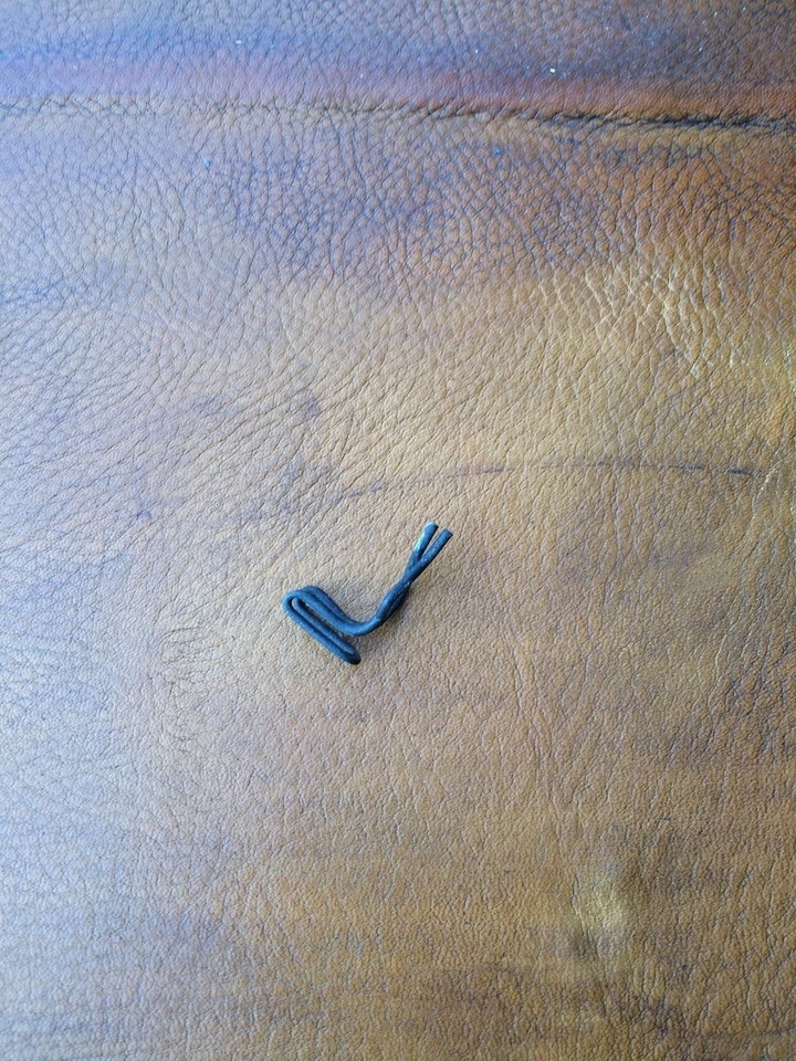

I take the new clips, and see if they'll slide onto the panel. They do, but they're mega tight. I slide one in the hole on the panel that would be dead center over the hole in the door.
Won't work. The clip is offset, The hole that used to line up, now locates the clip 1/2" away.
I drill new holes 1/2" away from the old holes.
I slide the clip on, fidget and fuss around with getting all 15 or so aligned, and do a trial fit. It'll work
Ironic situation #2. I didn't want to have to drill the panel to use the correct factory clips.....now I have, and they're not even the right ones.:doh::doh:

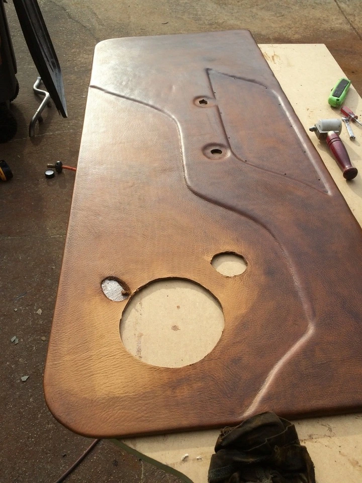

So, I get to cutting and glueing.
** The big hole, and the one above it are intentional....the other one was there in the hide. Poor old Elsie must've got jabbed in the ass.
I added a layer of 1/8" foam to allow me to create recesses. The recesses in the panel will accommodate the center trim piece, and the speaker box, while adding some dimension to the thing.

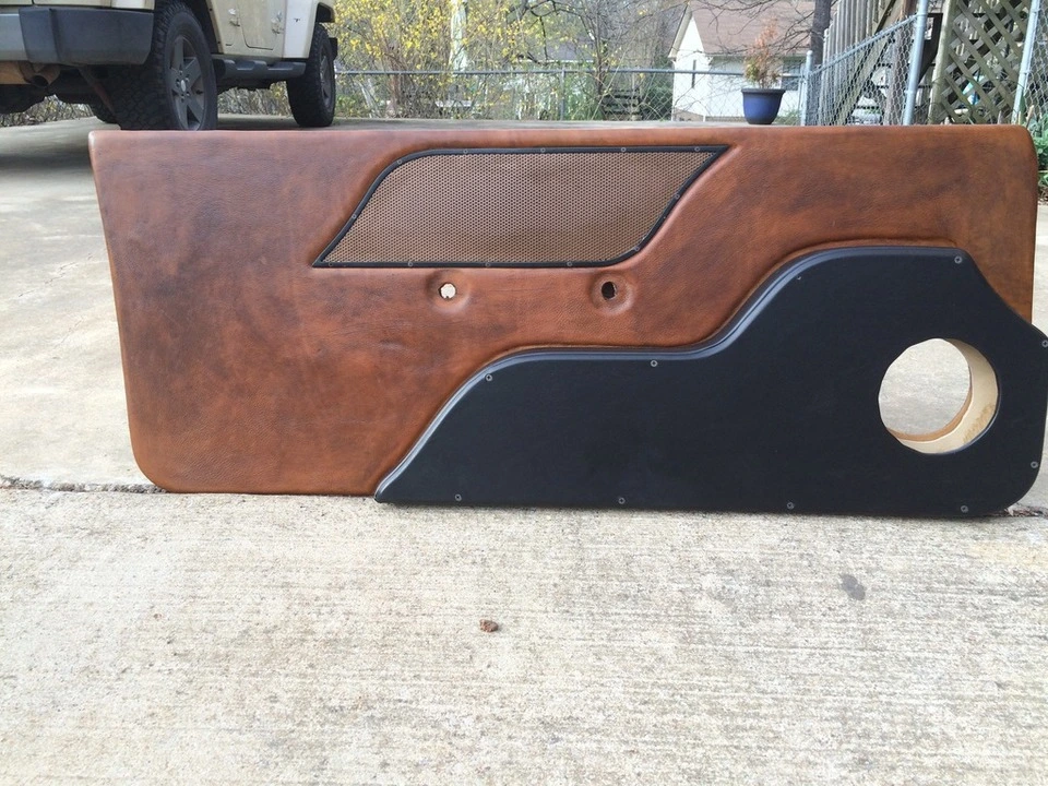

And that looks like this:
* You're seeing the stain all over the grille mesh. I took this pic before I washed all of that stuff off.
So,...I got it basically finished. all that remains is to slide the clips into place, and that one will be done.
The clip is visible. There is a huge bulge apparent where the thing is attached to the door. I can't use them.

Set backs aside, that door panel, at least for me is one of the best parts I've seen to the build. This car may very well be your opus. Keep fighting the good fight sir. You are an inspiration. Seriously.

As usual, I go down to the garage all set to go to work. Today's focus was gonna be on getting the door panel itself upholstered. First I wanted to make sure that the panel clips I bought 50 of on Monday were gonna work. I bought different ones than are typically found on a Fox door panel,...Since this is a home made unit, I didn't want to cut all of the little hour glasses into the door panel to allow the stock ones to slip in. (Because that junk always breaks) The ones I got twist in through one hole instead.
They didn't fit. The panel was too thick, and it was bowing the head of the fastener. I figured that you'd be able to see that distortion under the upholstery.
So I put the boxes in my Ranger, and close up the garage. Somewhere between the Ranger and closing the garage door, I decide to take the Wrangler instead. I get the two boxes out of the Ranger, and head for town.
When I get to the upholstery shop, I look for the panel fasteners.
No where to be found.
Must've left the damn things sitting somewhere back at the house.
I go into the shop, dude tells me that there is a 20% restocking fee on all returns. (means I'm gonna lose 4 bucks) Oh well,...15 dollars is better than nothing. I don't have them with me anyway, but I need different ones that'll work.
I buy these things called auveco clips.....old school panel fasteners made out of steel.
They only come in a box of 100. I need maybe 30.
$20 bucks. I buy them. (What am I gonna do, I need the stupid things?) I head back for home.
When I get back home, I start looking for the other clips. I look all over.
Where the hell did I leave those clips? I check every inch of the house, and both trucks......nothing.
I think..." Did I put those things on the roof of the Jeep?" and walk out to the street....
There they are. Scattered and smashed all over the street. Not a single one managed to escape getting ran over.
Now I ain't getting back Jack.:nonono:
I trudge back to the garage with a handful of bent assed plastic junk. I throw it in the trash.
Ironic circumstance #1.:doh:
I remove them all so I can upholster the panel. I'm concerned now because there is a little less than 3/8" left between the holes,...a sure fire guarantee that one of those small spaces will tear, or break, the very first time I try and remove the panel.
If I have to remove the thing, I'll just have to be mega careful that's all.
Ironic situation #3. Even after ALL of that,....I am still gonna have to screw the panel to the door. And now I gotta return the new stuff, and lose another 4 bucks and one hour tommorrow.:doh::doh::doh:
I'm just gonna run panel screws through the thing at the very back. I think the door bar will do a good job of holding it in place in the middle, and the speaker box will hold the bottom half,...If I need a screw or two beyond that,.....what the hell.
That said,..the goal for tomorrow is to get the door bar finished, and prepped for paint. I still need to make a small arm rest pad and integrate it into the bar, and bend the backer pieces and trim pieces that will sandwich the mesh at the fork on the bar......In other words,...a full day. For today, I'm done.
But like I always do,.....I get almost everything thrown back into the garage, and start doing something else. I look at the speaker box, and think "What's stopping me from permanently mounting the woofer in the hole?"
Nothing.
So I do it.
NOW I'm done.
That means all tolled,...the custom door panel takes a full week to build including the door bar. My days of being able to dick off in the middle of the week end officially on Saturday. From there, I'll have a job, and have to actually...........go to work. It's an auto dealership, open Monday-Saturday. I'll have to work every Saturday.
