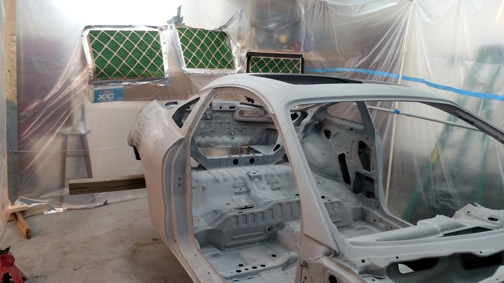

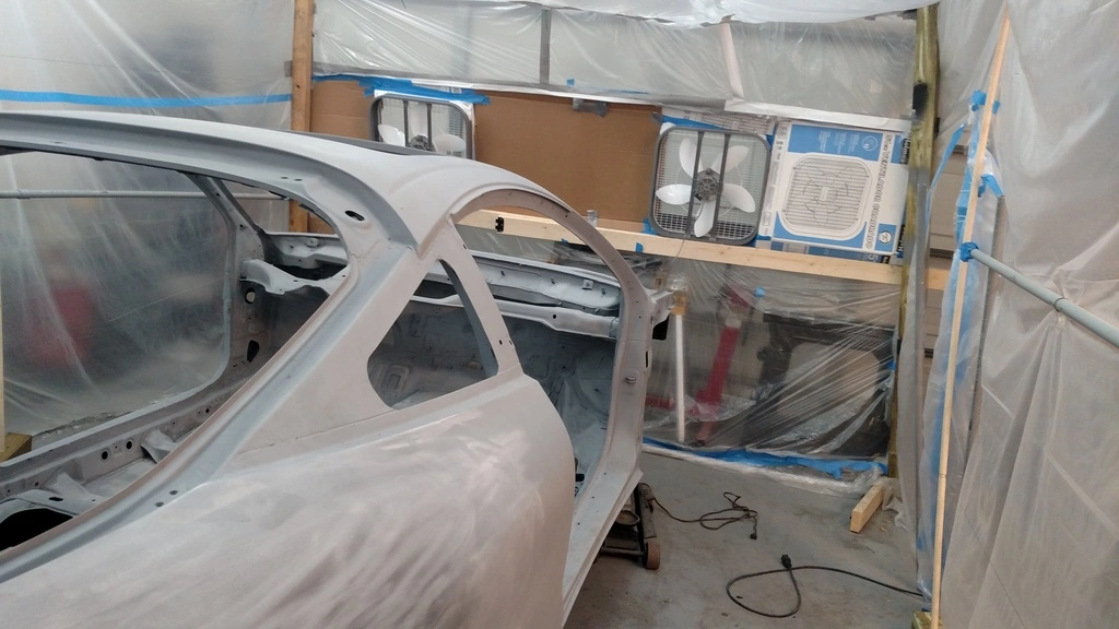

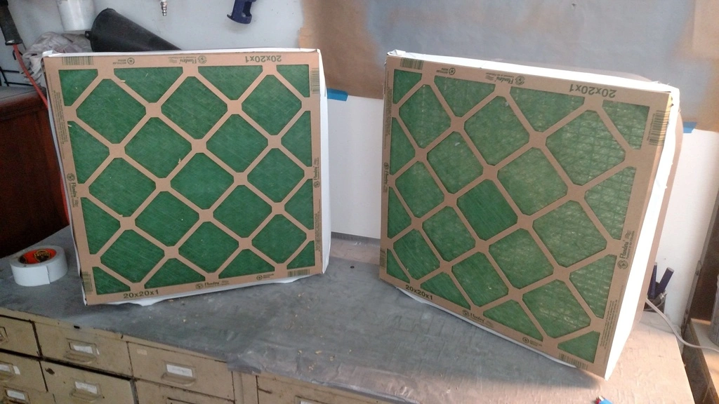

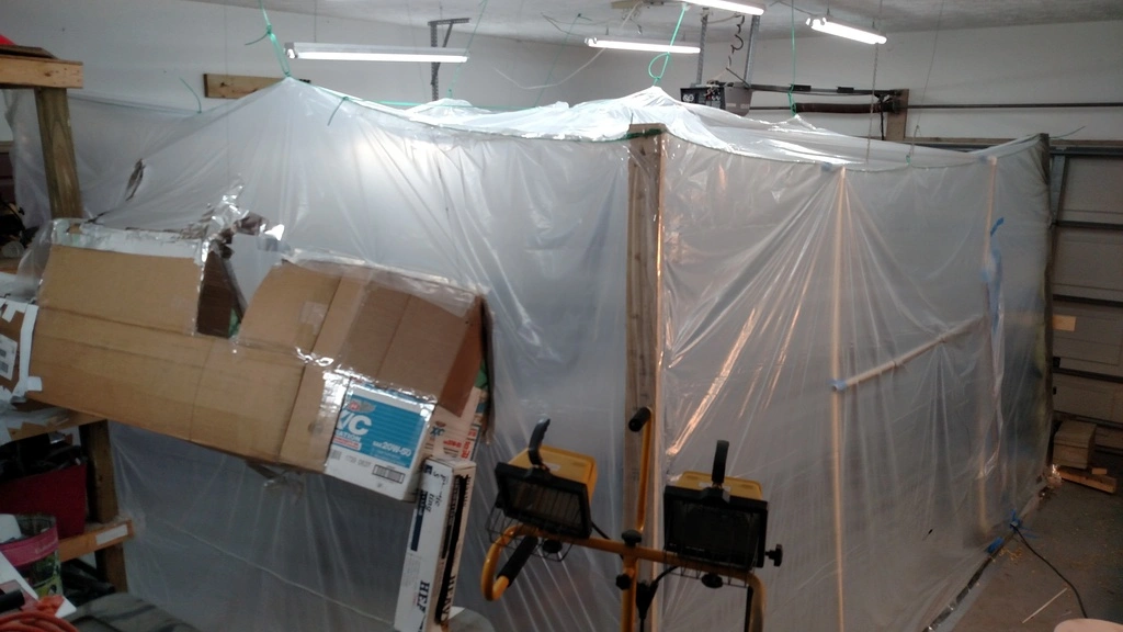

You could build you a booth like this (stole fro HPjunkies). If it looks stupid but works, it ain't stupid.

Now who around here has done something like that???
Reactions: stangboy, a91what, Davedacarpainter and 2 others

I did one like that with all PVC but I put my fans outside the booth sucking air out. Here's another thread that will kinda show it in the background of a guy who did his at home. The thread is FULL of awesomeness as well.
