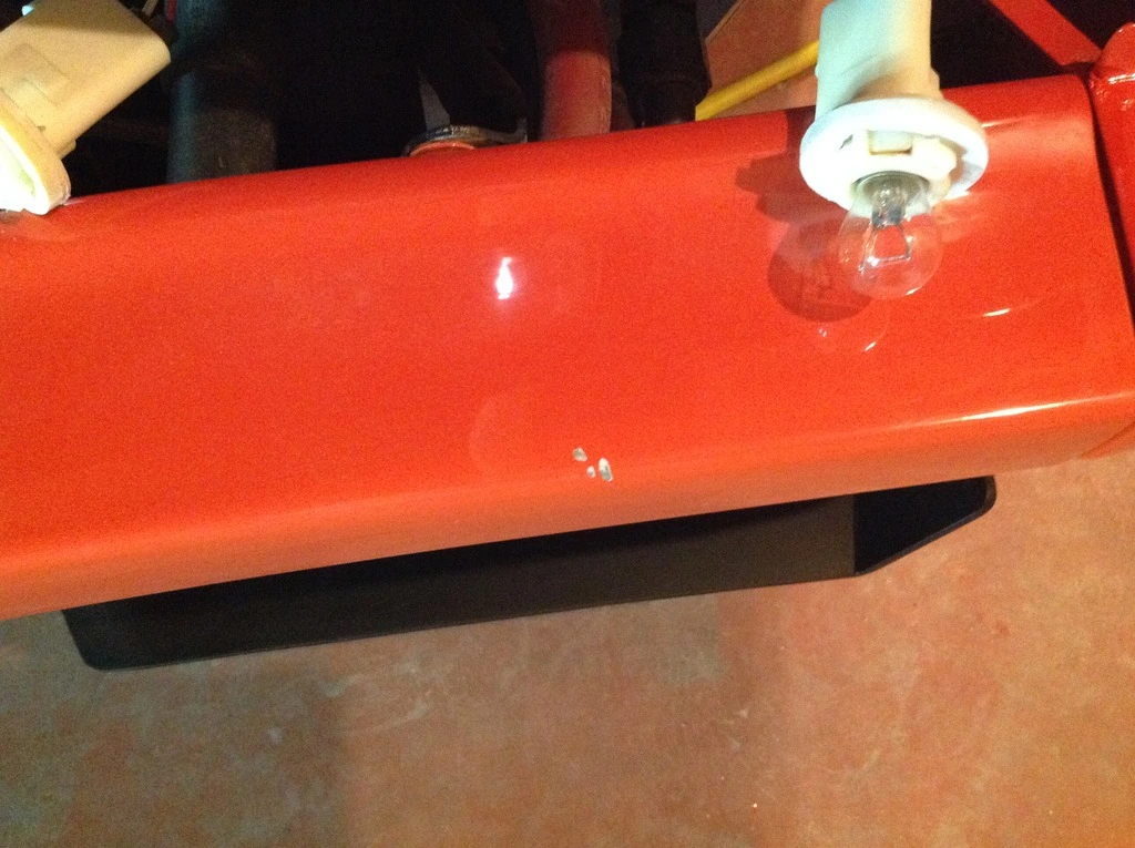

Paint chip count: 3

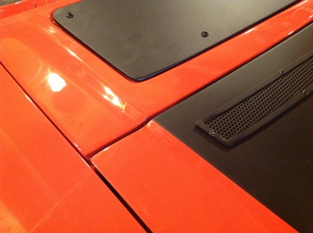

I'm back home at noon,..and start at it. I install the hood, create paint chip #1,

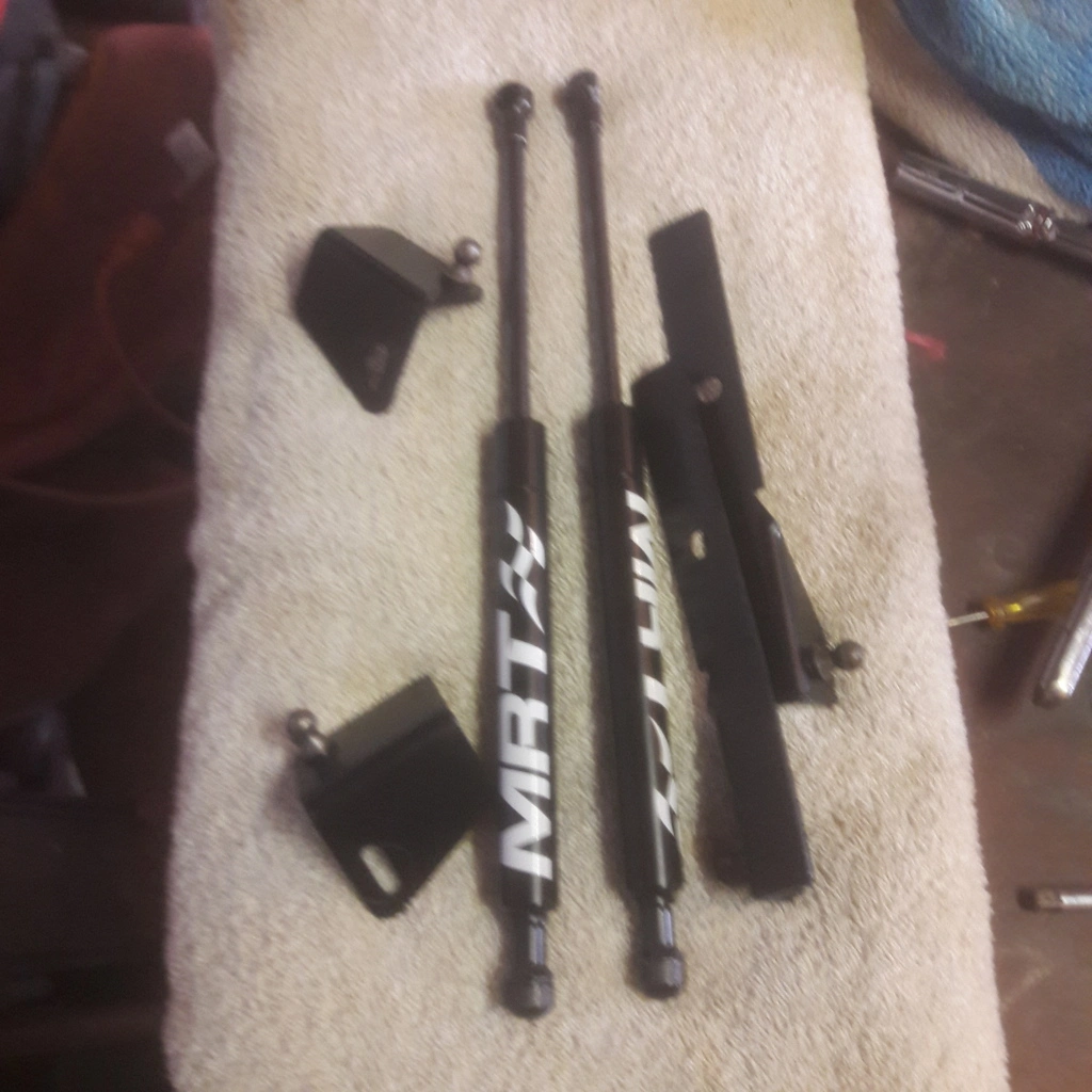

Then try to install the MRT hood lift strut kit that I've had new in a box for several months now.
Just as soon as that piece of crap system is installed, it comes back off. Partially because the loss of reinforcement in the Monster's hood, but mostly because of how badly this system puhes the hood out of alignment, that system (compared to redline) isn't worth the powder to blow it to hell.
I now have for sale a barely used MRT hood lift strut kit for a fox mustang,........cheap.
Guess I'll just have to rely on a regular ole prop rod instead.

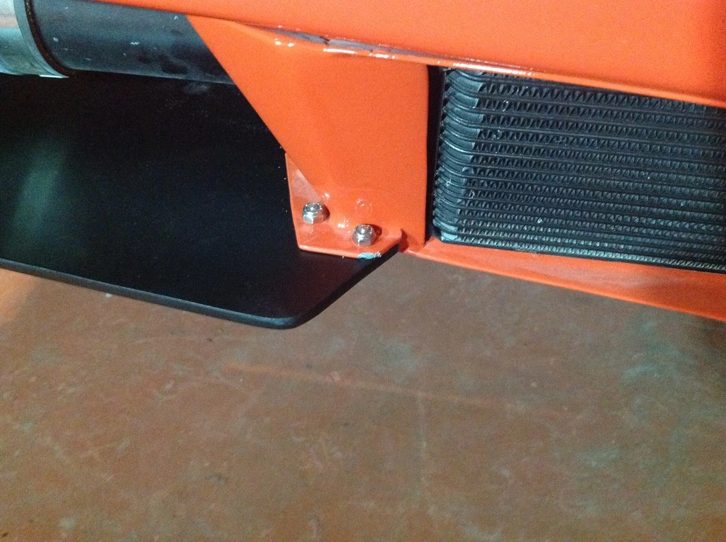

I move on to the splitter.
Stuff was on the car when I built this thing, and taking that stuff back off, naturally has caused some mis-alignment Trying to get the 10 bolts and screws that hold the splitter in place caused me to have to move it around too much,...and thus created paint chip #3.

Chips are small Mike. You should be able to make them almost disappear with the left over single stage. Touch them up, give them a few days to harden, then lightly color sand and buff. Don't think you'll make them go completely away, but it would take a concerted effort to see them.Today I had the full day to myself to work on the Monster..

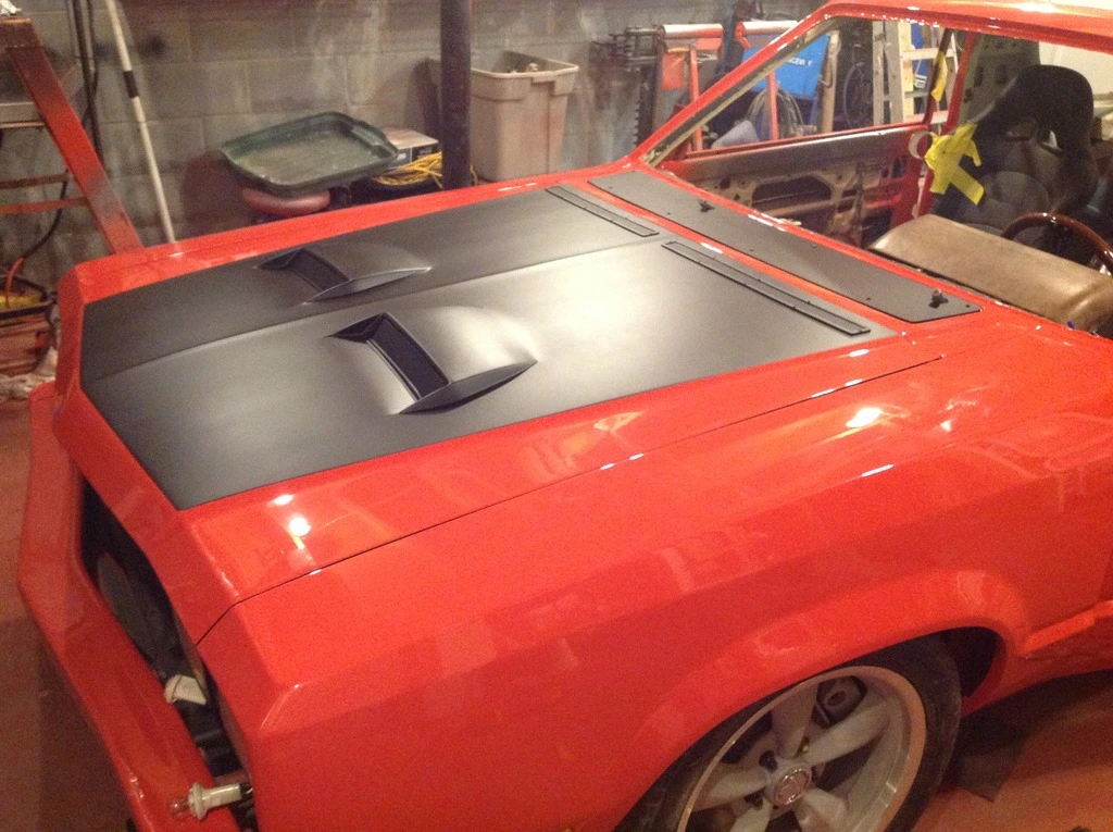

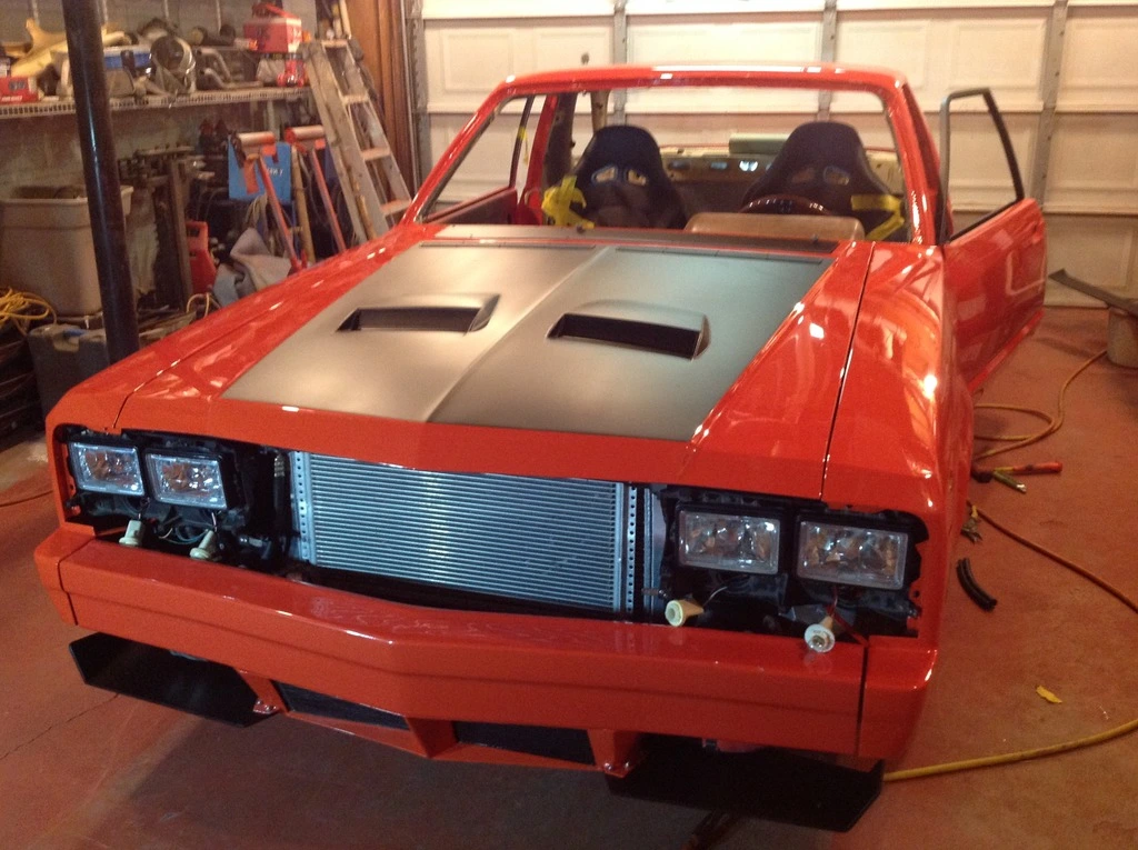

You nailed it on the color scheme. Absolutely phenomenal combination.
The Monster is Beautiful Mike . You have out done yourself
what a beautiful car i love everything you've done with this car .i can't wait to see this car done kind of reminds me of a ford version of the grand national.this car is worthy of a magazine feature
Looks awesome mike !
Looks Awesome!!!
Sucks about the chips but absolutely love the color combo. Car is just awesome.
It's really nice to see the monster with the panels on. It'll be beautiful there buddy. Good job.
After looking at those pictures (of the car at least) I think it's a good thing I don't live close to you. I'd be wasting away my weekends with you and the monster!
You know, when you first mentioned the idea of leaving it orange, I thought you'd got lazy and didn't want to paint it black. Now that I've seen it, I kind of like it myself. I say leave it.So then the request for reader comments section today is to ask about the cowl paint. The original plan was to carry the satin black all the way back to the windshield. But considering that I am doing the thing at the front of the hood to keep the orange contrast against the black balanced,...do you guys like the current paint with the black cowl piece, or do you think I should take the black all the way back?
