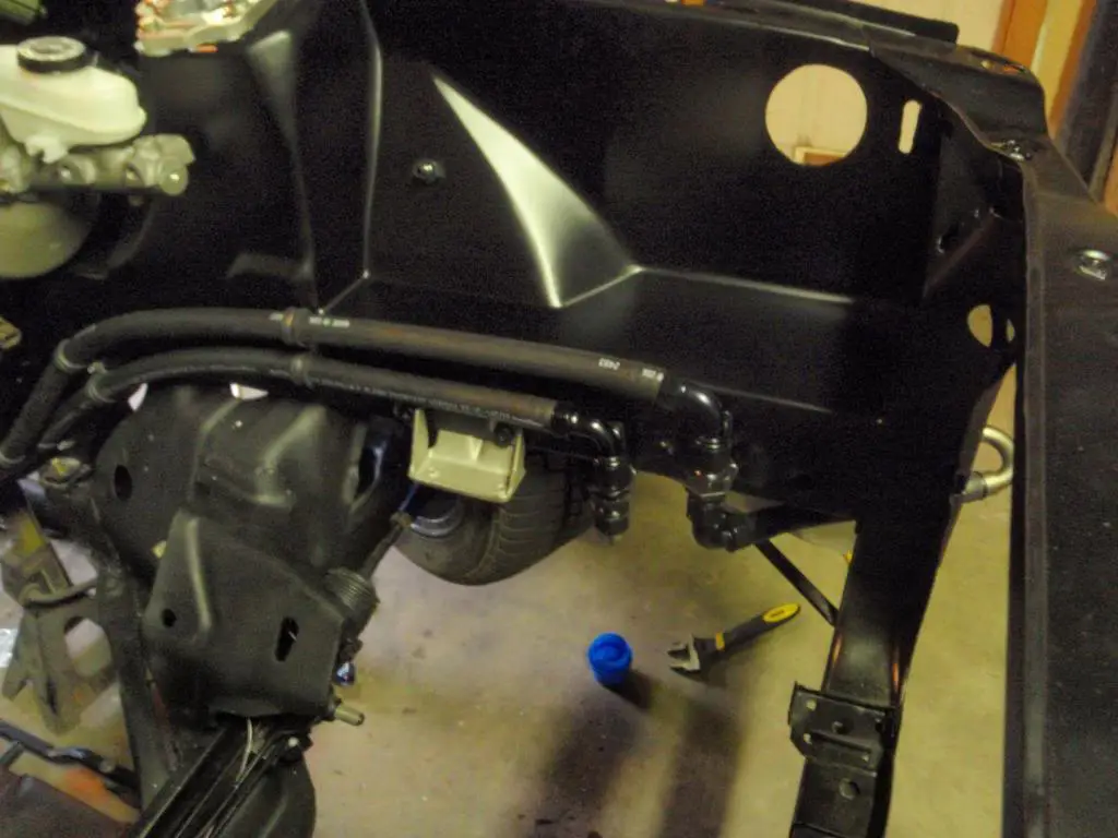

Up along the frame rails in the engine compartment, under the intake manifold, trapped between the powersteering reservoir and a bunch of other sht are the bulkhead fittings for the hoses that feed the intercooler. One of those things leaked when I first plumbed them. At the time I said to myself:
"Remember to deal with that before you put the engine in there, cause if you don't.............ooohhh,...that's gonna be a sonofabtch to deal with afterwards."
I didn't remember.
That'd be these two damn hoses, and I think the problem child is the rear one. At the time of this pic,.I had already cranked the pss out of the connection trying to make it tight enough to stop leaking. Probably gonna give me a stroke.
