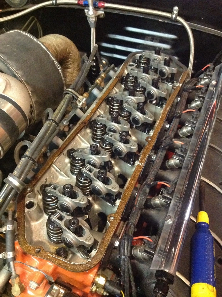

Of course not......( Don't be ridiculous)You don't have an IAC?
I have a stupid Fast Idle Valve. ( Or Fidle valve)
It's just a GM dual tank solenoid that is triggered by one of my outputs to open at cold start-up t let more air into the engine until it gets to 140. After that, It's only the set screw on the throttle body that adjusts how much air this engine breathes.
