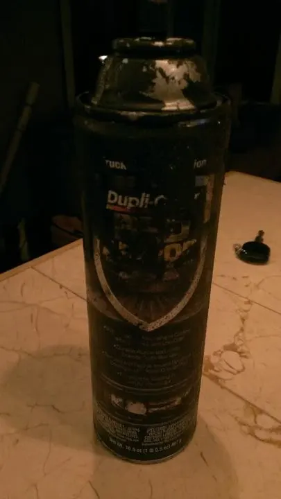

Now every other time I've bought the rattle can bedliner product, it's always been the same RustOleum stuff. Today, I bought two cans of the sorriest, biggest piles of steaming dog s hit ever packaged and branded as paint.
Duplicolor makes a water based product in a 16.5 oz can that was "on sale" at Advance for 2 for 20.00. At the time I didn't know it was water based and it didn't matter anyway.They call it "bed Armour"
They need to change that.
They need to call it can of water based dog sh it that spits, spatters runs, and glops black sh it everywhere but where you want it.
If it was just one defective can, I coulda lived w/ that, but both of these things started sputtering almost immediately. I figured it was by design, and that they wanted the texture to be coarse, but after 10 seconds of spraying, there was a huge build up of paint dripping off the can and nozzle. I could feel little droplets hitting my face as I sprayed this crap despite my best attempt to stay out from under the spray . The floor under the car?....Black. My clothes? Black. when the cans were empty, and I drug my ass out from underneath, I went inside to see what I looked like.

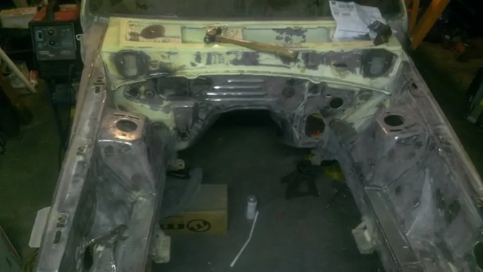

Now that all this crap had to dry,...I moved back to the engine compartment to finish weld the remaining holes,.....(and I mean EVERY remaining hole) that was left to weld closed.
A/C? gone. Heater? gone. Clutch cable? gone. Speedo cable? gone. Evap drain? gone. Wire grommet holes for main harness? gone. Holes to mount A/C evap?. gone.
Gone, gone,gone.
I even went as far as starting to remove the pesky pinch seam that ran across the firewall,...(and actually cut two inches out) but after looking at what kind of mess that would be,....I welded that b itch right back in place.
So now, I'm grinding. Then I'm smearing on body putty, and eventually,...the engine compartment will assume it's final color. Satin Black.

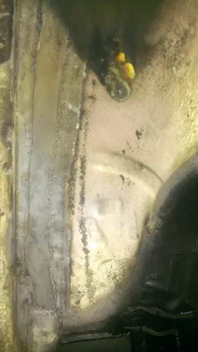

I got absolutely anal when it came time to button up the wheel tubs. Not only is there two welds on top of the wheel tub (one on both sides of the filler strip) but there are two additional welds on the bottom (inside the wheel tub)
Now why I did that I'm not exactly sure. Part of me was saying that it guaranteed that no crud could ever get in between an open unsealed edge regardless of what seam sealer and undercoating would be applied over top. At the top of the pic, you can see where I had a little towering inferno moment when I rosette welded the trunk hinge mount tabs back on the tub. (another thing I did today).
All I know is that it took me more than a minute to get "unlocked" after balling myself up inside that tub, looking straight up while I stitch welded two rows of seams that were made up of one side galvanized, the other side mild steel.
I know the weld seems to wander,..but that is the way the sawzall finished the cut. Take out the filler in the middle and both welds kinda follow the same path.
