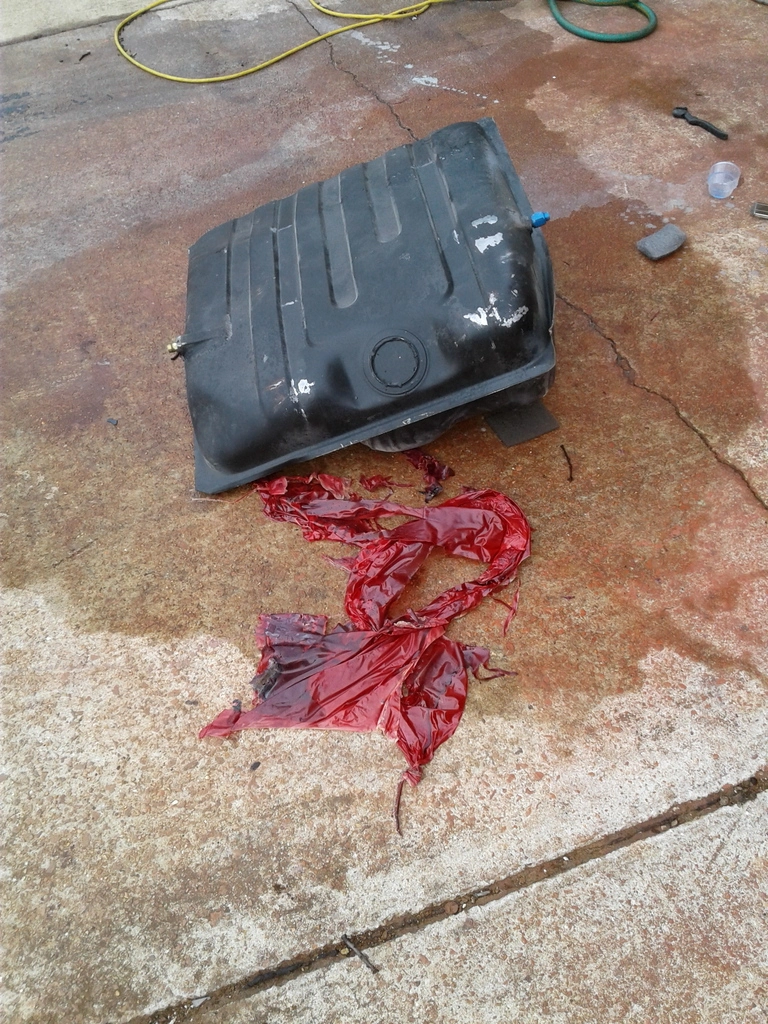

This week, one of my classics plugged up the fuel filters so bad the accelerator pumps would not dribble when I went to start it. Then it did it again after one drive of 10 miles or less. There was black, fine powder, probably from a hose or a recent fuel pump not liking modern fuel. Lots of fun.
What a jug phck that was....:nonono:
$113.00 tow charge this time.
I get the car home and jacked back up. Remove the new 180 degree AN fitting and I got dripping gas again.
Dismantling the whole mess puts me back exactly where I was this morning.......looking at a red umbilical cord hanging out of my tank.
I have this snake camera that I used to use in walls to look into them to see if I was gonna phck something up before drilling. Today I wanted to see if I could see how much of that red sht was potentially clogging the drain outlet. What I saw was.......enlightening.
It looked like I was a gasoline tank scuba diver,...and the "ocean" had red sea weed floating all over the place.
The red kote that I used to seal the tank had came off the walls, and was floating around.
I had to drain,and drop the tank. Then I had to cut it open.
I cut a large rectangular section out of the very top of the tank so that I could see inside this btch.
The red stuff was everywhere. I was able to literally peel it off of the tank walls like some sort of metal protection film that you'd peel off of a fresh piece of stainless....only way easier.
I guess that I applied that stuff over an oily surface, and it didn't stick.
It was getting sucked into the outlet and the drain was creating a vortex. This junk would twist itself up into a rope that would plug the outlet almost solid. This time that's what it did, the pump ran potentially dry for who knows how long...
My tank gave birth,..and this was the placenta..
I purged the thing of all of that red. Then, through that hole I washed the tank as best I could,...effectively cutting the pss outta my arms on the raggedy assed edges left over from the cut.
So then,......The top piece........................The one I cut?.......
I had to put that back together and create a cap so that I could put the tank back together...and that my friends is another one of those pictures that you'll never see....
suffice it to say that since it was on the very top of the tank, and would only see sloshing gas,....it got riveted back on,..and sealed w/ "The right stuff"....
As of now,..it's sitting in the garage curing....I'll re-install it after I flush the thing with a gallon or two of the 7 gallons of gas that I drained out of the tank.......Hopefully the pump isn't dead.

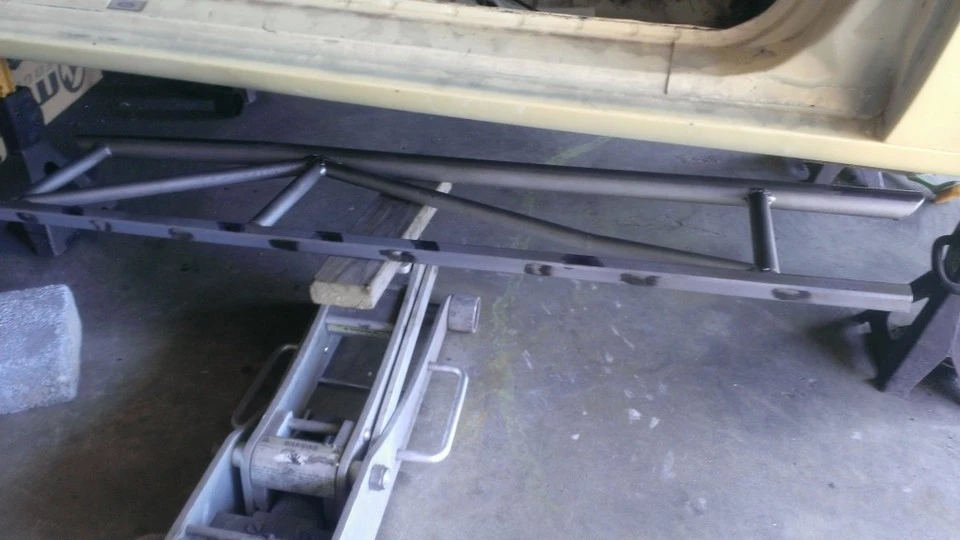

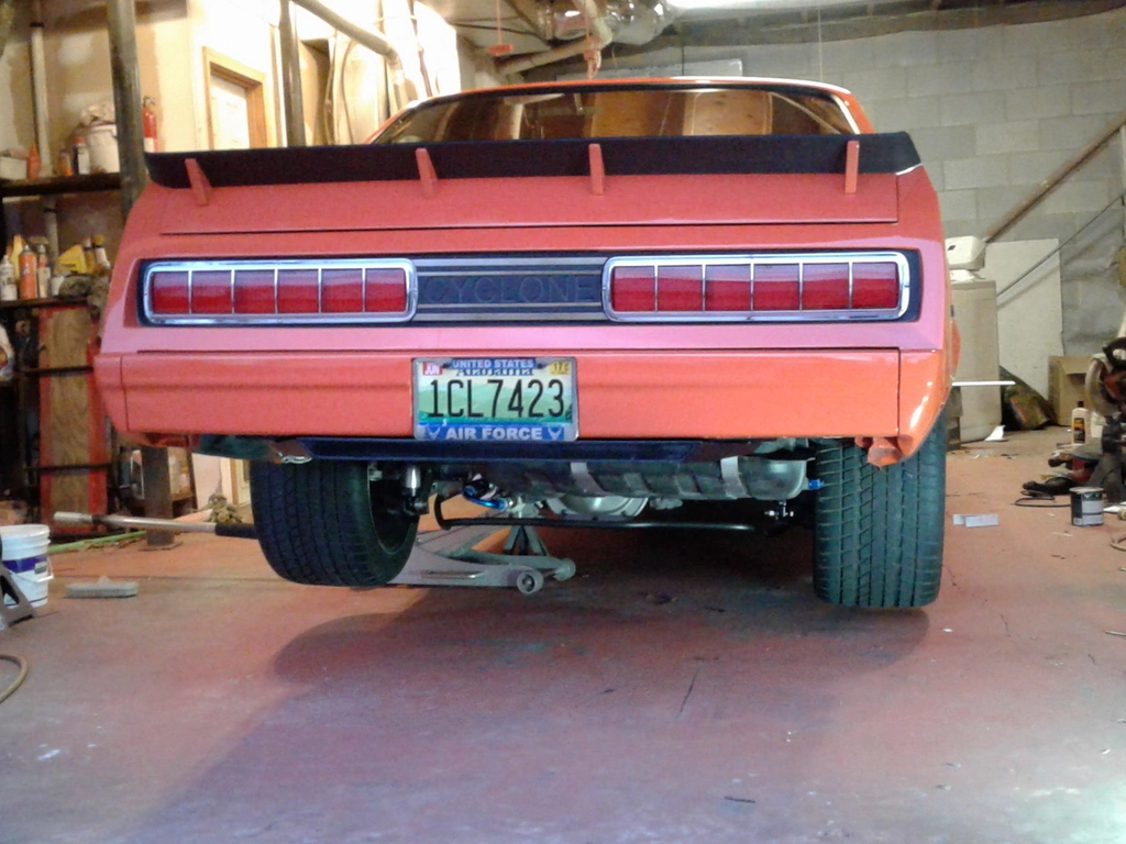

And,...........even though it's only a picture of a car jacked up in the air.......
The jack is on the driver side.....nothing is under the passenger side of the car.
Not bad for a car w/o a roll cage don't ya think?
This is why.
