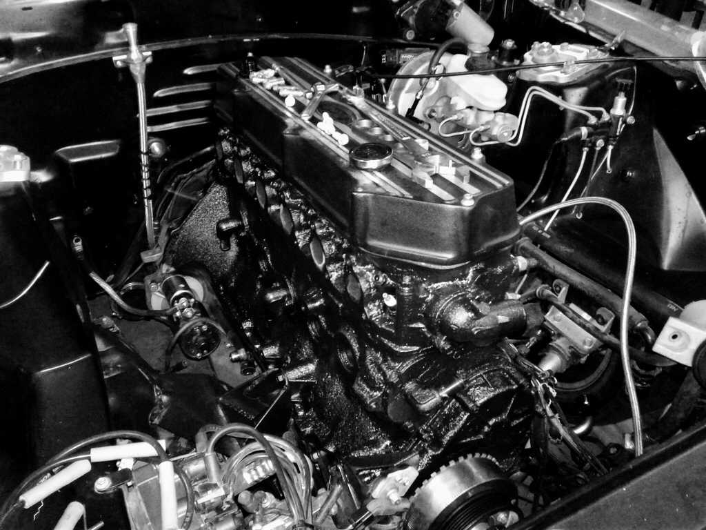

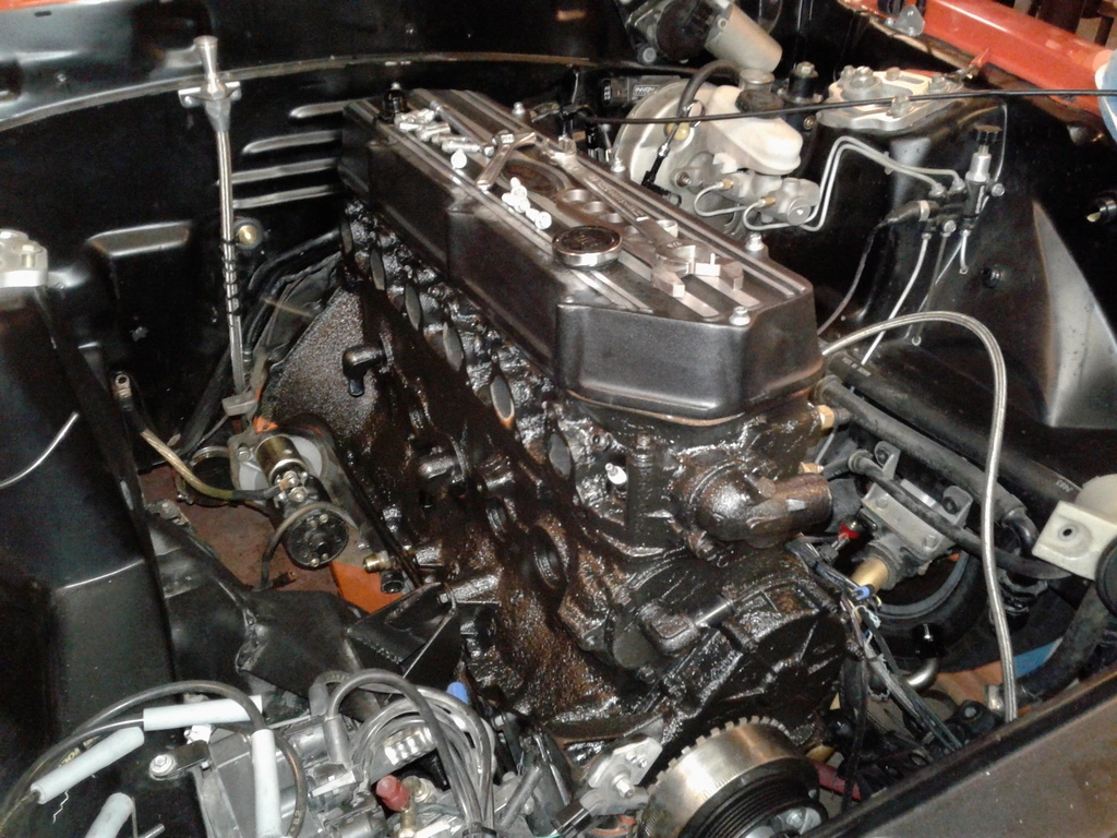

I told you what I was doing....I'm changing the engine color....I'm detailing the engine bay (What I can of it w/ an engine bolted in place anyway).
Lets see what a pic looks like shall we?
What can be seen when the engine is back together is now engine enamel wrinkle black. I'm gonna have one piece of the cold side powder coated to give it some durability, and clean up everything else. There is still dust from the body work all over the lower half of the engine bay, and several small details that need attention. I am undecided about having Medusa High heat coated, as the paint that is on there is holding up...but......like I said,....I'm undecided.
I still gotta remove the side cover and re-seal that. Now that the intake is off,..I'll probably give it a fresh coat of the same paint that's on it..(It's the same wrinkle paint that's now on the engine)
I'm in pretty deep in the fittings for the water lines so that kinda forces me to use the existing rubber hoses. Other wise I'd up grade the exposed front hoses to braided.. but I may just balance out the money spent, and coat the cold pipe, and add two braided hoses to the front instaead of high heat coating Medusa, and call the engine "detailed"

Wrinkle black looks like years of sludge in the picture. Hopefully that's just the picture, I'm sure the finished product will look nice as always.
Nope,...looks like years of sludge in person,....it wrinkled like mad.
The problem was I loaded the paint on thick. It went on wet and stayed glossy for hours. I thought it was somehow "defective". so I sprayed more on hoping it would wrinkle.
When it dried over time though...........prunesville.
I know w/ heat the wrinkles tighten up to a fairly aggressive texture,..(The intake was painted that way, and it did the same thing) so we'll see.
What it does is force me to add some bling to contrast against that background,..means that I'm buying some expensive assed -10 180 fittings and hoses.

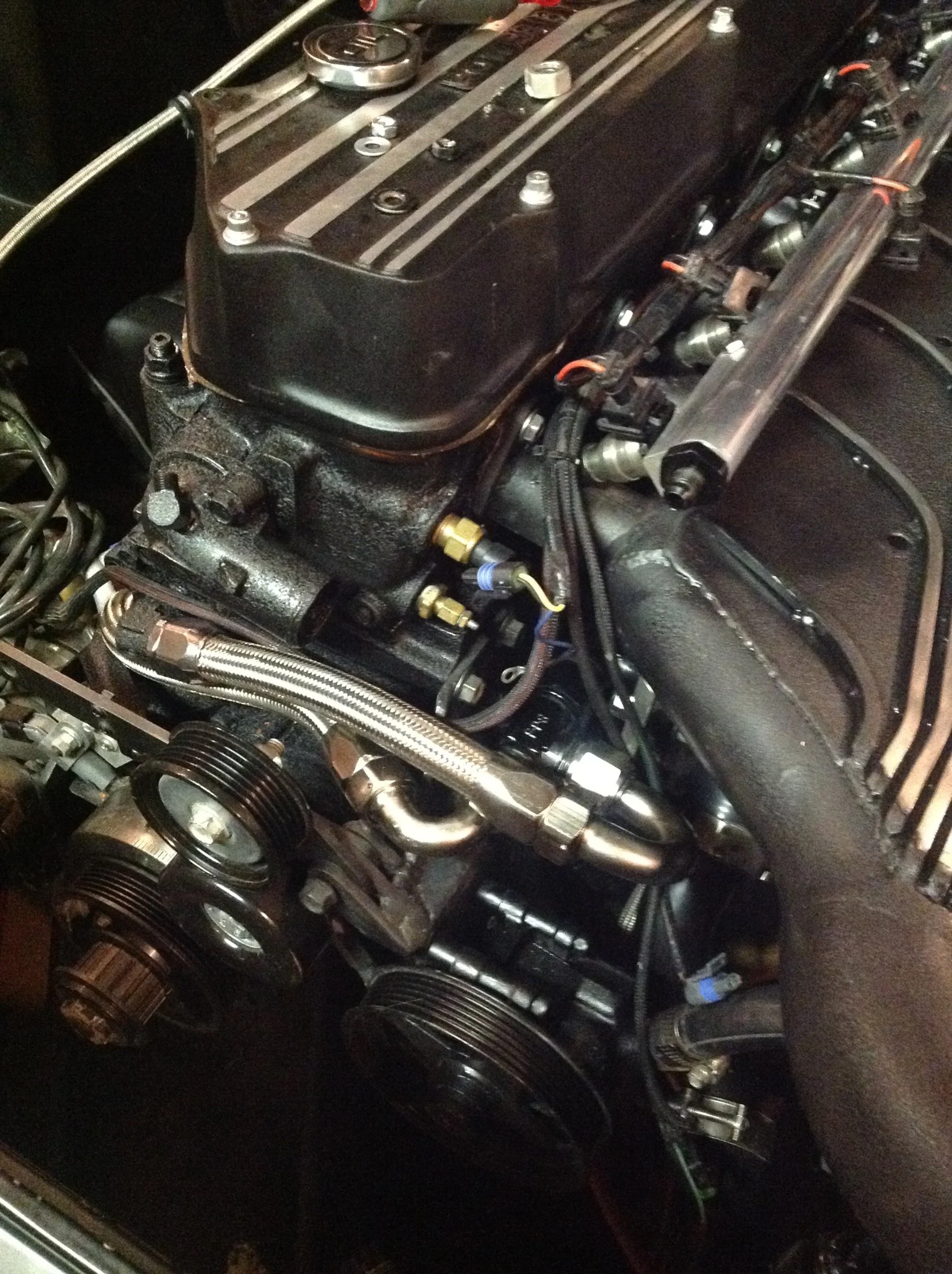

Ok then. Just committed to 100.00 worth of hoses and shiny fittings to bling up the front of the engine..
Only one problem.....I can't get those hose barbs out to replace them w/ threaded AN 90 degree fittings.
That means that on one end of both of the hoses,.....................I'll have to use those hokey worm gear clamps that look like a hose end.
I've never used a braided hose like this before,...I've never tried to slip it over a hose barb. When you look at the ID of the hose, and the OD of the barb, there is a difference of .100 that has to stretch over the barb...will braided hose stretch that much?
Making the decision to fix oil leaks has turned into a multiple hundred dollar venture.
Firstly, the braided hose that I'm using as an upgrade over the standard hoses was a 100.00 investment. Getting braided hose to go over a pipe nipple is do able, but barely. As a visual upgrade though I think it's an improvement.
The fake nut that covers the hose clamp is imperceptible, you cannot tell that it's not a hose end screwed into a fitting, so it's all good.
The black wrinkle paint is also gonna mostly disappear, so again,..bacon saved. In the end I think it'll be an improvement over the orange engine. The side plate is resealed, the gaskets for it, and the intake are completely made from RTV,...hopefully this works.
