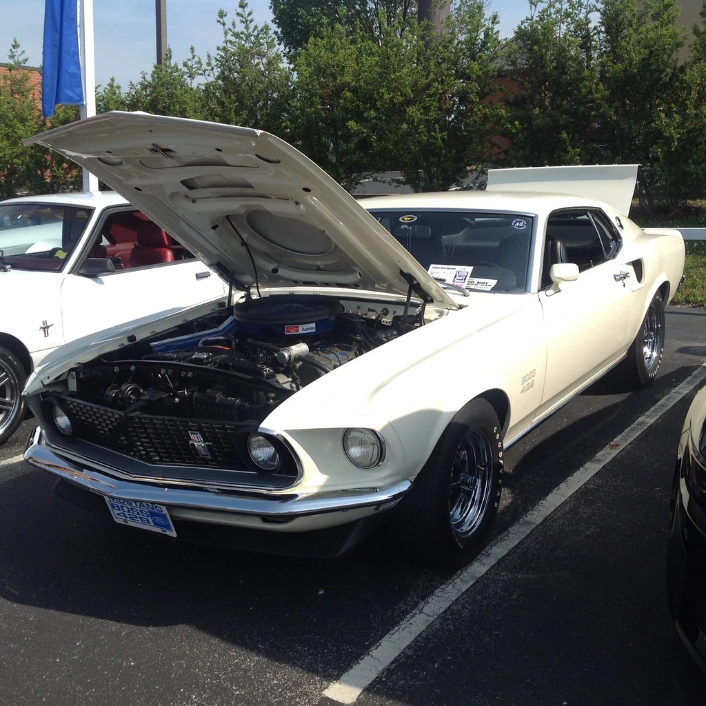

A 75k resto of a once drag raced 69 Boss 429 that was now show room perfect...check.

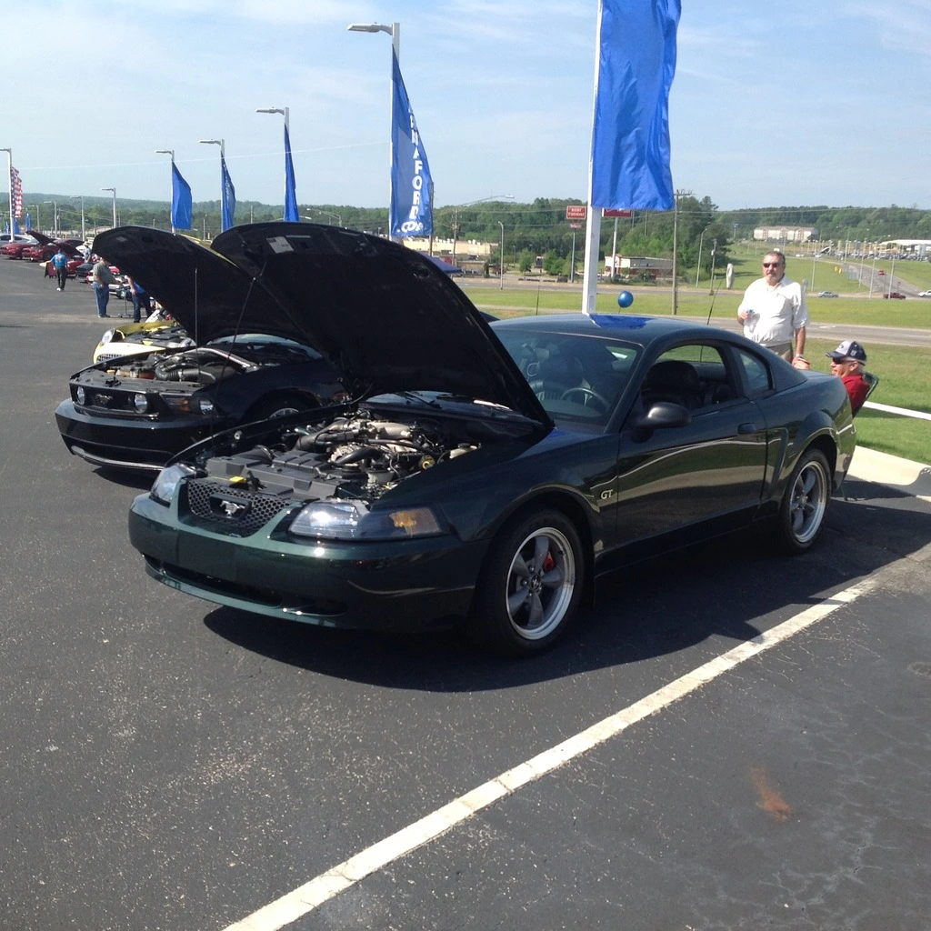

A very clean Bullitt.

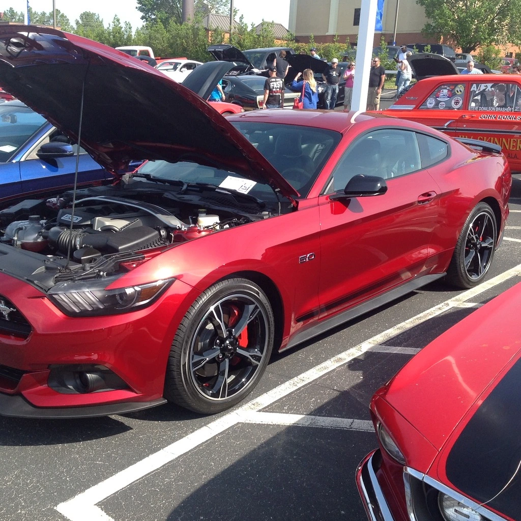

When it came time to choose one of the sea of S-197's,...it was another Ho- Hum choice for me,..and the S-550 got picked purely for it's color (I like red) It was one of many of those belly buttons, including a brand new GT350......I'm just not gonna pick a car like that because the guy has the money to be able to buy it, then choose it as the "best in class" purely for that reason.

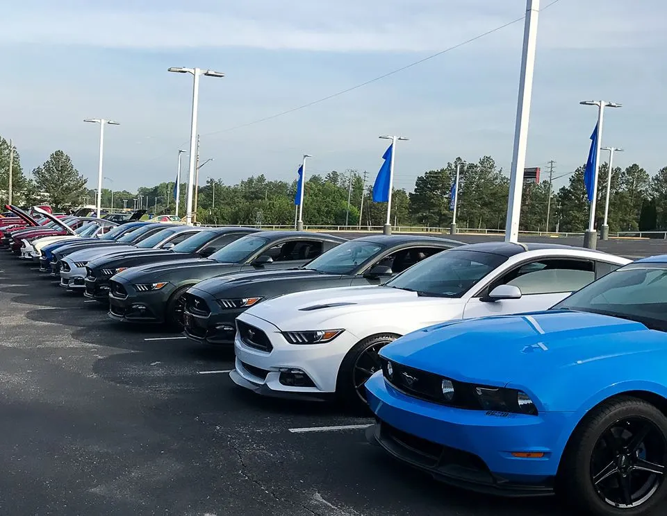

(I took this pic from the local Mustang club's FB page recounting the day)....This was an "awesome turnout" pic taken by a member while all of those drivers were in line to register.
