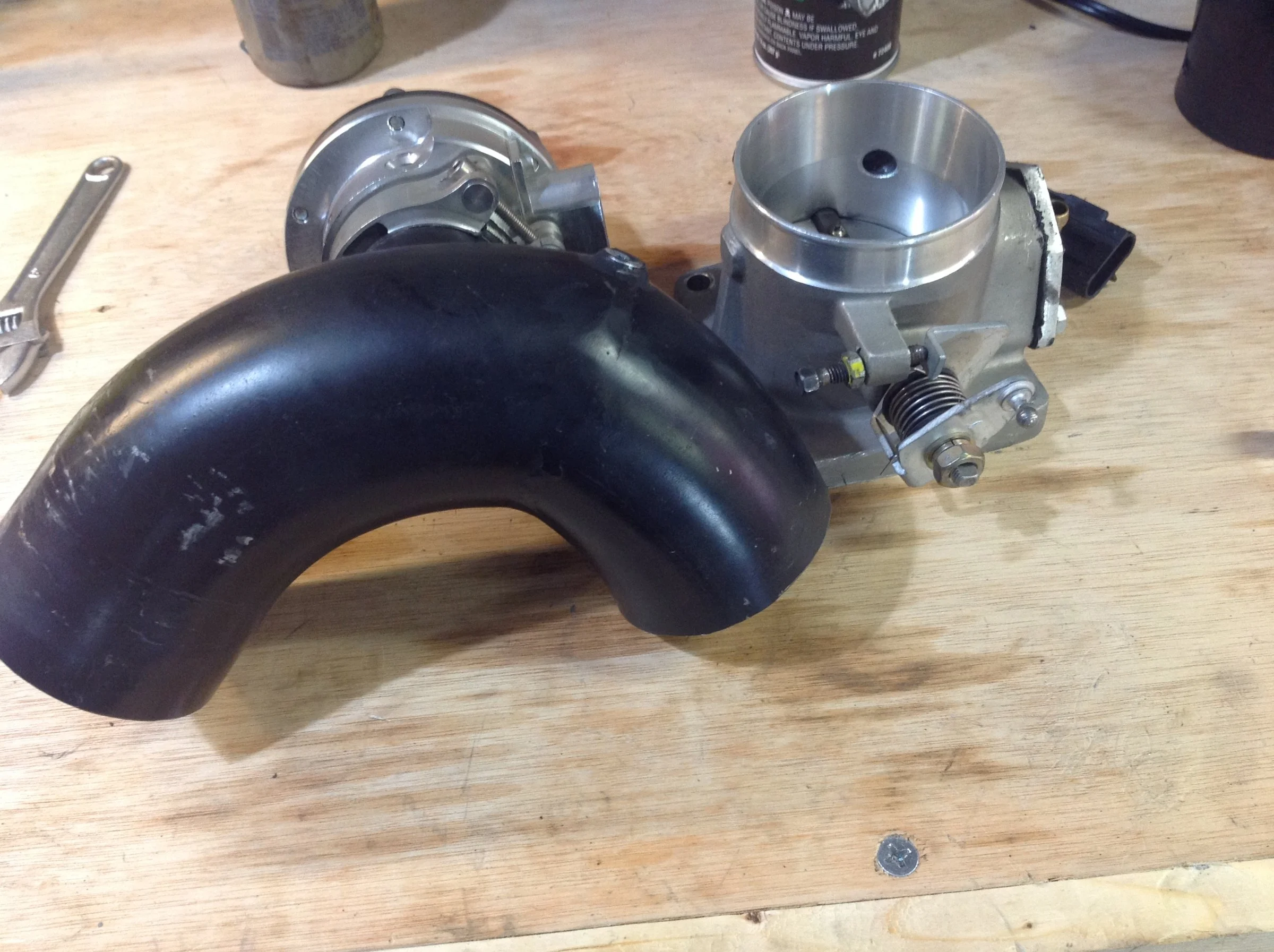

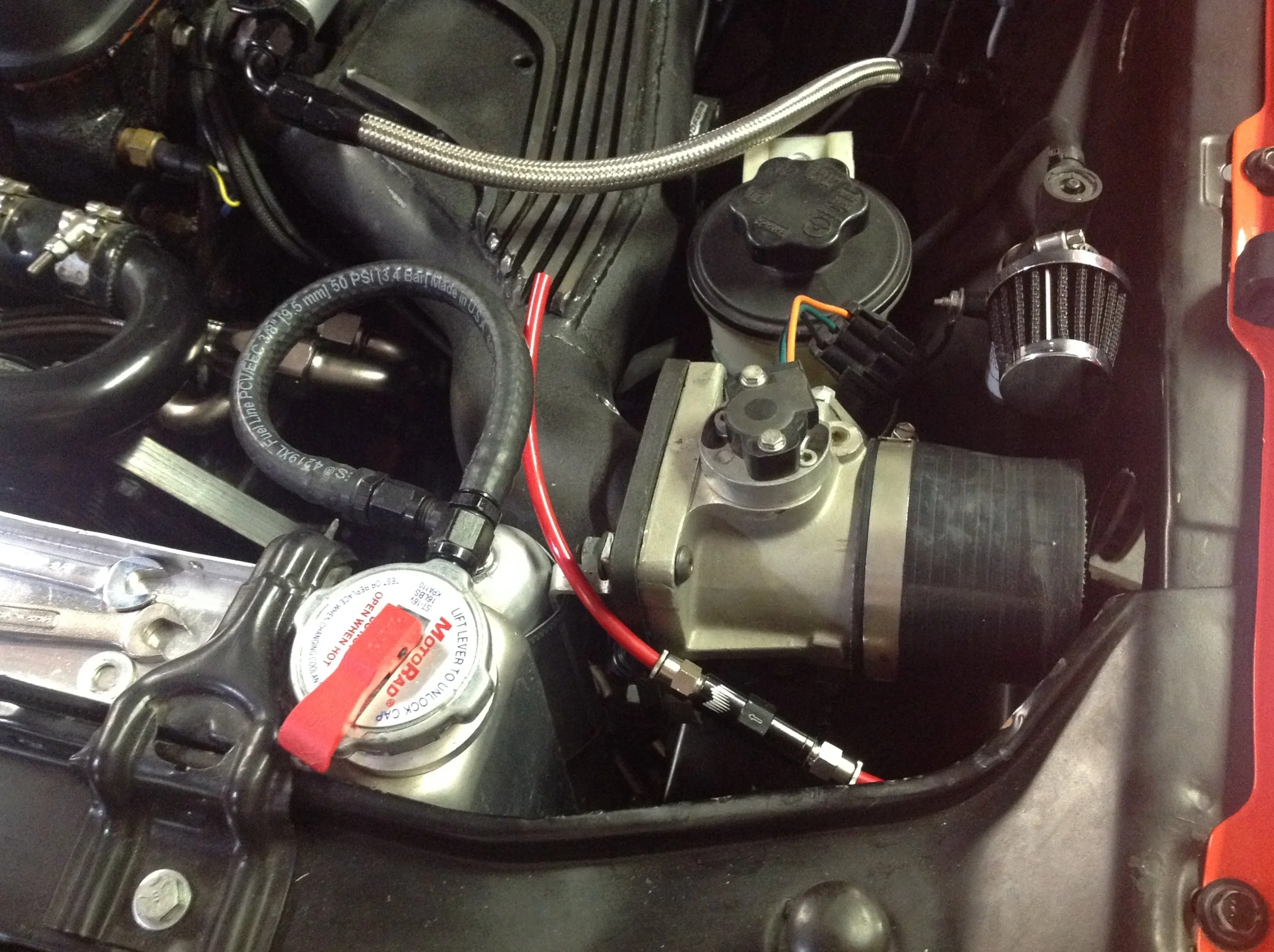

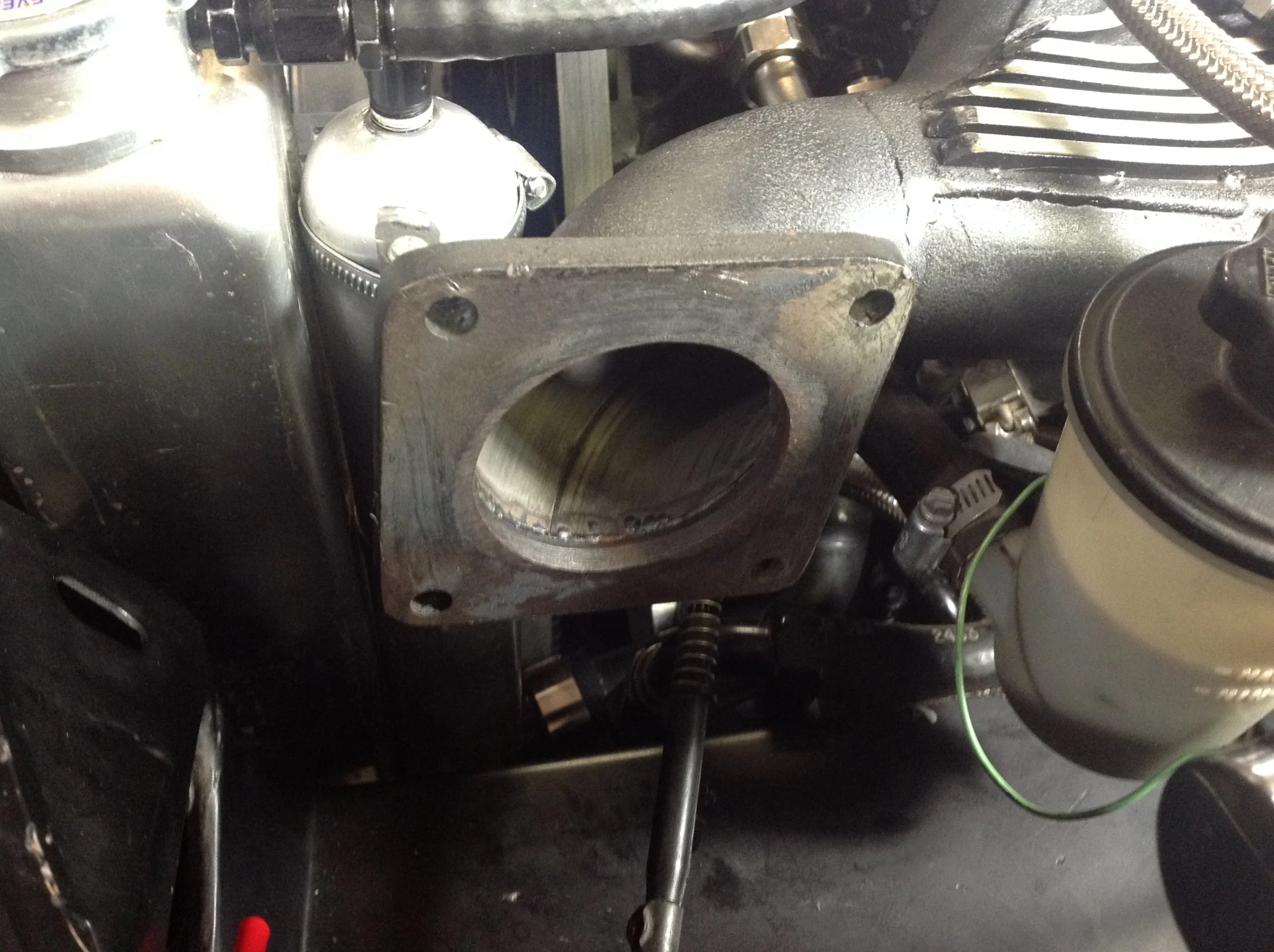

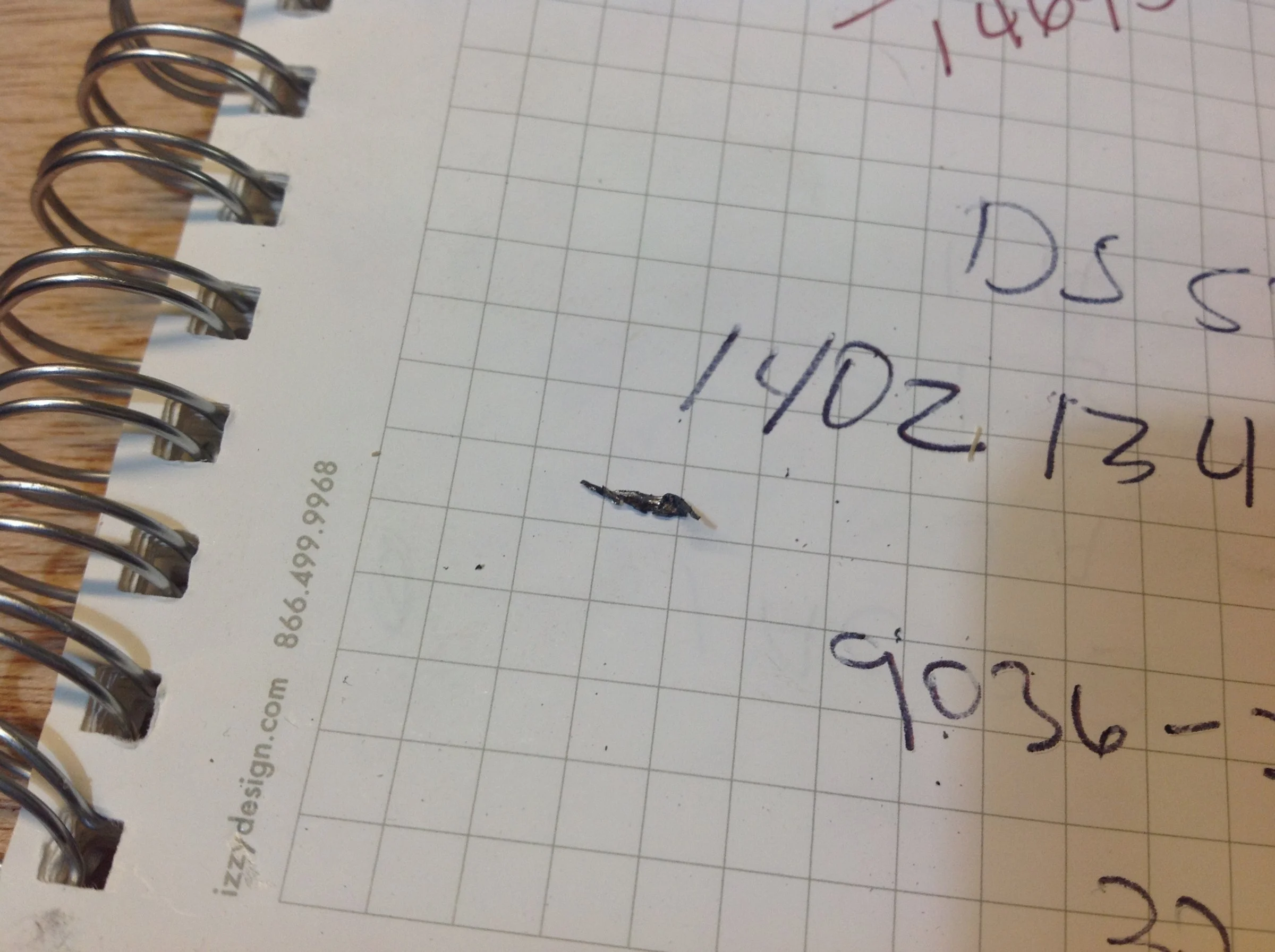

I took the throttle body off to see if there were metal shavings in the throat of the intake manifold.
There wasn't anything visible....until I removed the injection nozzle.
Then this chunk of sht fell from the threads.
I'm thinking that woulda been a bad thing...almost surely likely to get jammed between the intake, or exhaust valve seats...so,...justification for tearing that apart.

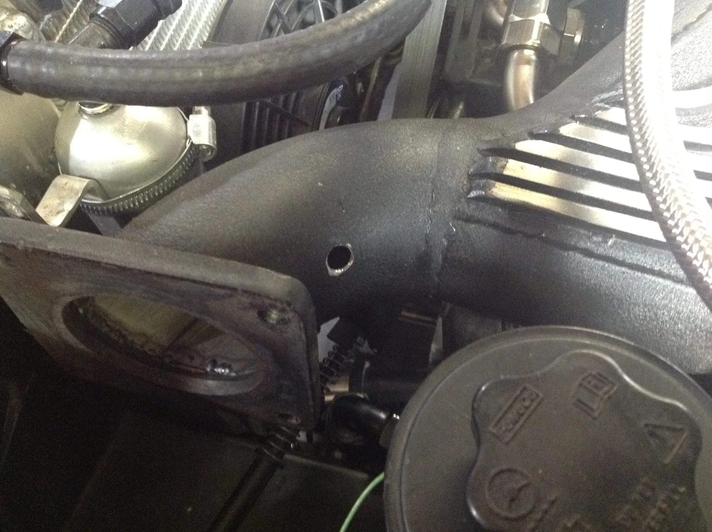

There's barely any material there to thread the nozzle into, but it is threaded nonetheless.
The pipe plug is plugging the hole that used to have a pipe nipple when I was trying to run a PCV system. After bailing on that failed plan, I couldn't reach the fitting to plug the damn thing properly, so up until today there was a plugged hose just stuffed up under there..In the end there was more than one reason to remove this assembly.
Pay no attention to the foot trying to photobomb my shot....

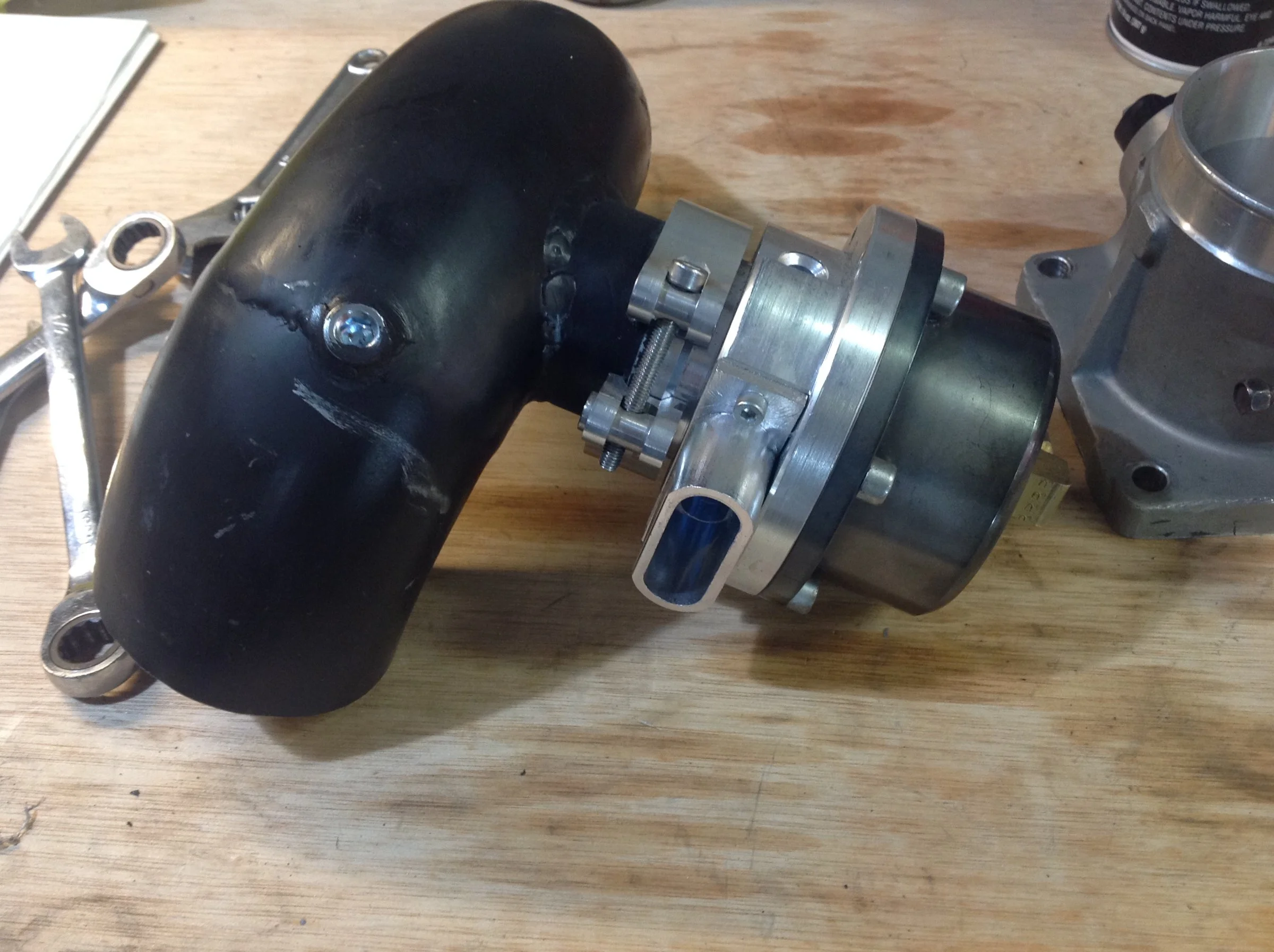

I'm pretty convinced that I'm gonna remove this thing now...I will only have make a section of 3" tubing equivalent to a simple 90, excepting that if I do this, I'll probably weld the elbow that has the BOV onto that 90, and make it one solid piece. I have a plan for the recirculating system that will in effect be tied to the AC switch. The two radiators in the rear will be used to augment the existing cooling system when the AC compressor kicks on. I'll use a electronically controlled heater control valve that will open, and start circulating engine system water as soon as the AC system is turned on., so I won't lose anything in my original design intent.

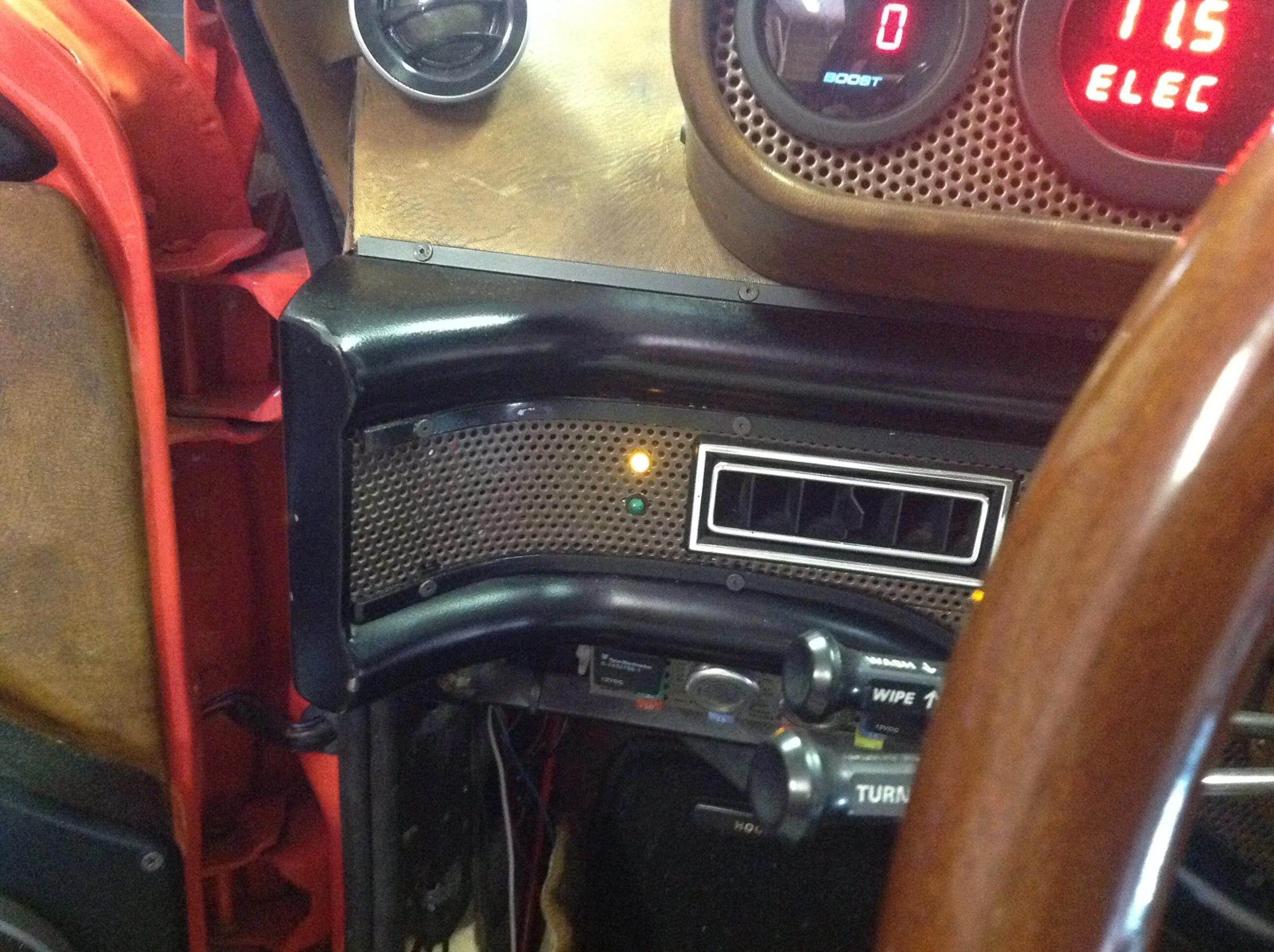

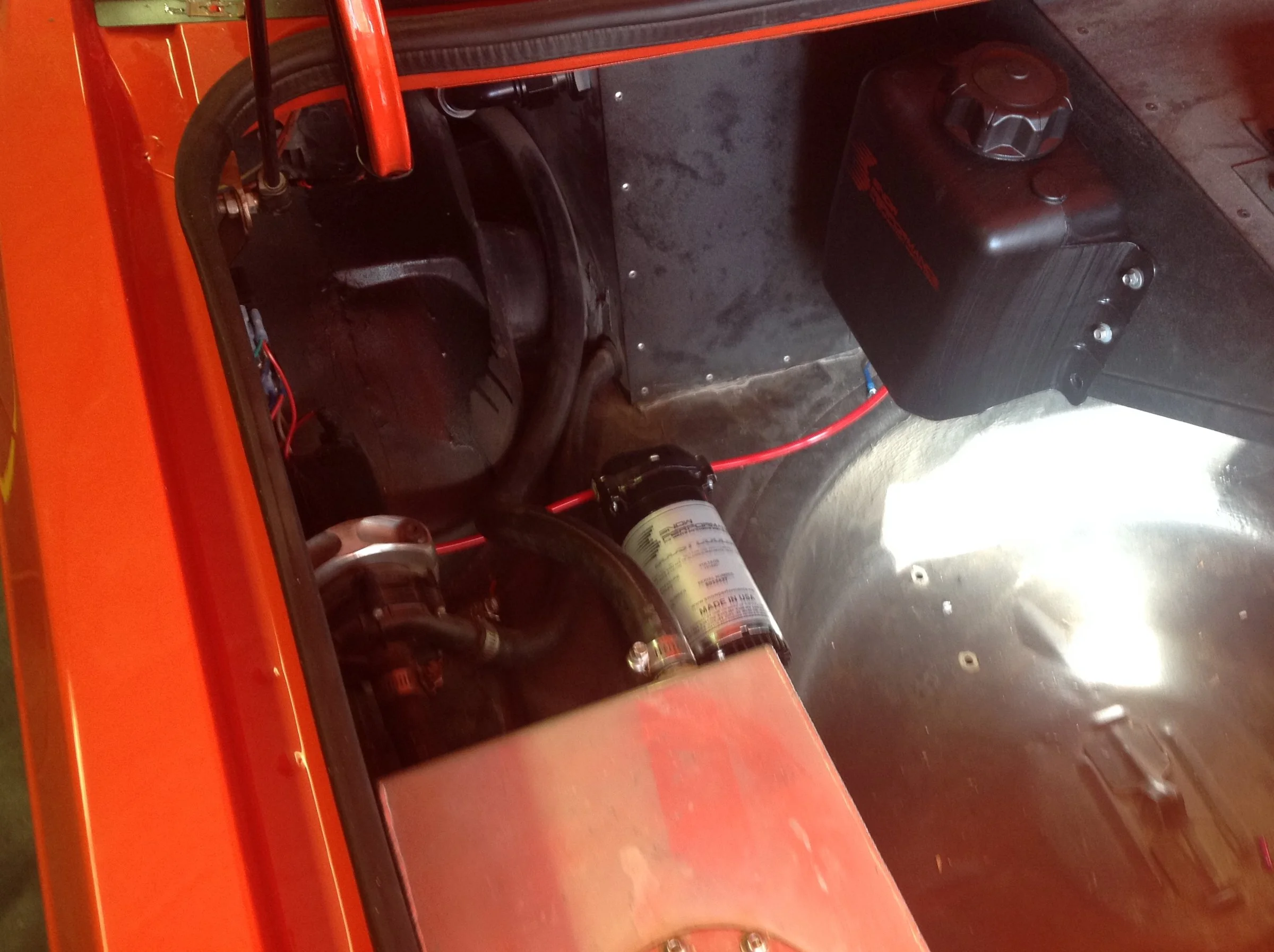

I spent the rest of the morning wiring the system...

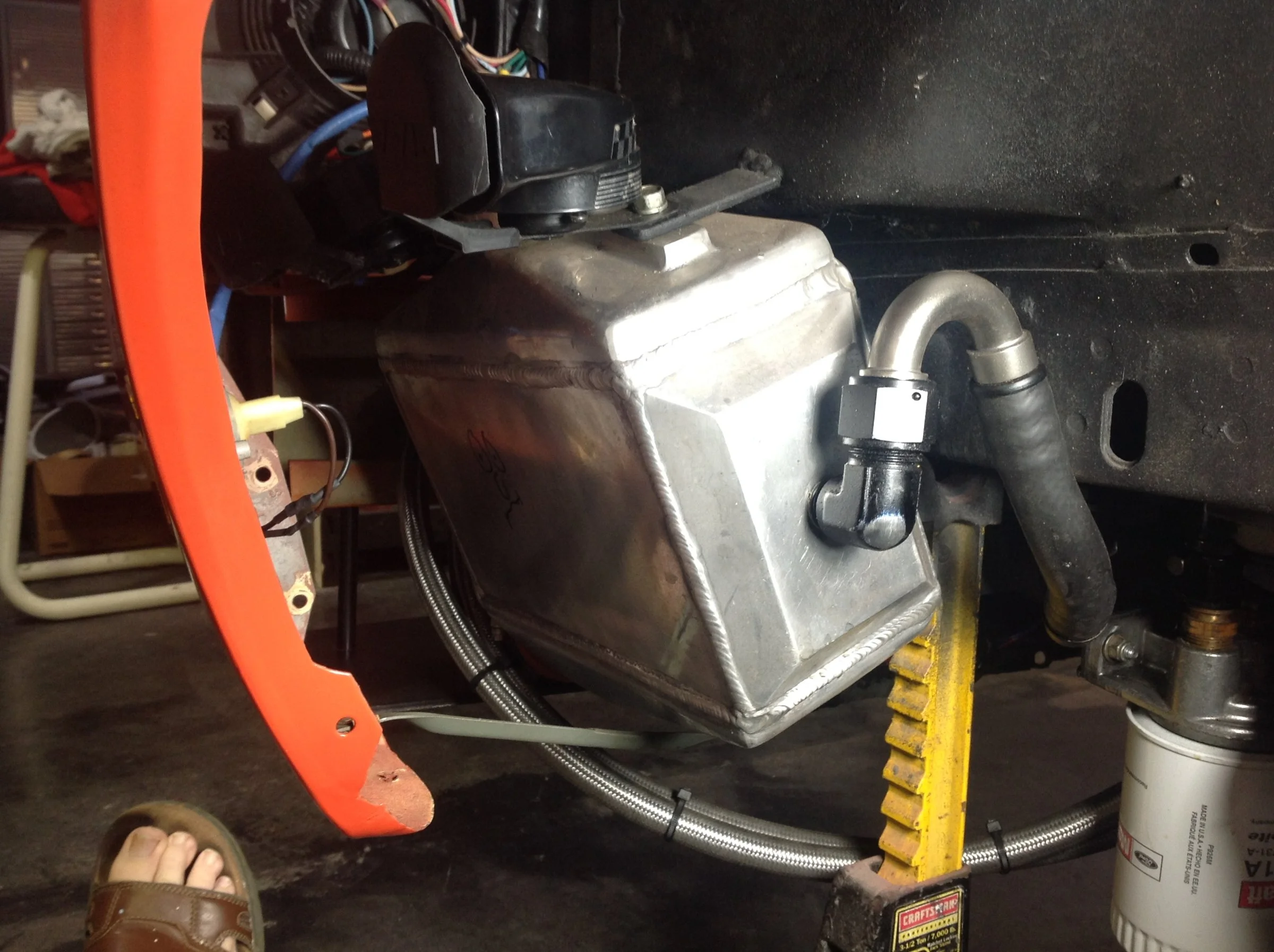

The trunk is just gonna have to get the same treatment that I did for the red car,..and I'm gonna build a box around this mess, and on the side where the battery is, and upholster it. But that'll be low on the totem pole for planned monster mods.
Not a light I wanna see when my foot is on the floor.
Ran out of time before the wife started "reminding" me that it was 12:30, and Thankgiving day..the only thing remaining is to hook up the trigger wire to the relay board, and run some water through the system to be sure the nozzle properly atomizes the incoming mixture, and put the rest of the thing back together. That is IF I don't decide to eliminate the intercooler.

Impressive progress on a holiday morning mike. :-)
What would be the bennifit of removing the intercooler?

Impressive progress on a holiday morning mike. :)

It serves no purpose now. The water meth will require such an aggressive tune to the "unsafe zone" that I'll never be able to run without it once I go down that path. And water meth will cool better than any intercooler, even if I ice down my reservoir. ( you are after all spraying water in the engine). That thing weighs about 20 pounds dry, and maybe 30 once it's full of water. Intercoolers are slight restrictions to airflow with some better and some worse,...an A2W intercooler is supposed to show the smallest boost drop for whatever reason,...but there'd be none if it was a straight pipe.
