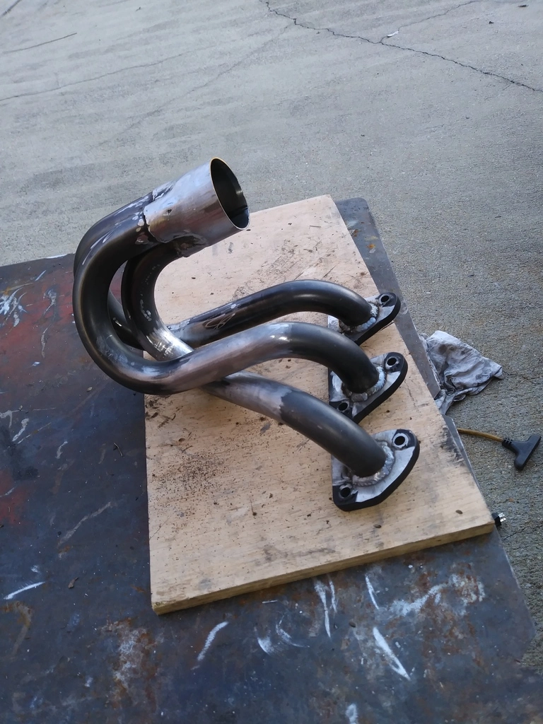

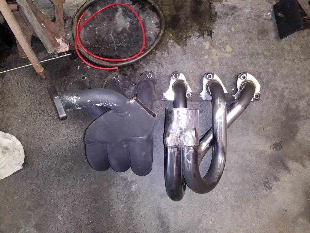

This will be funny.....
Not in a funny ha-ha way, but funny in "it figures" kind of way.
Medusa weighs about 25 pounds. Attaching her to the head has always been a giant pan in the ass. She is the reason the paint on my strut tower is all phckd up.
I decided to cut Medusa up because of that,...thinking that I could build a much lighter version that at the very least would accomplish the same end result, at a fraction of that weight now that the engine is N/A.
Today, I have 5 combo bends to work with....(Why I only ordered 5 combo bends for 6 ports is beyond me,..but I pushed forward nonetheless.)
I set out to do that....
I started by grinding off all of the old thick wall tubing weld residue on the three front ports that I'd already cut away a couple of days prior.
I was gonna build a meandering bundle of snakes so that I could have a "long tube" header in a "shorty" amount of space.....That lasted as long as it took to determine that I'd need another 5-6 combo bends, and would put the "bundle" too close to the back of the alternator for comfort.
So,....I decide to build the header in two sets of three,....with the center tubes (3 & 4) being made longer to try and even up the two longer spanning tubes, (1 & 2).
I thought that I was doing this when I built Medusa, but after measuring things,..found that I was far from equal length.
Regardless,...the turbo combo didn't care,......it ran great.
So then,...I've got a plan....I'm not gonna build a menagerie,....I'm gonna try to make them as close to equal as possible, and I'm gonna be able to save all of that weight that Medusa used to displace.
This is what the front 3 ended up looking like:
I plan to put a V band flange on the mini collector,..It'll blend into a 2 into 1 merge pipe that'll tie into the existing down pipe.
This took the better part of the day to build....The center tube is longer and lower, the #2 tube is higher, and the #1 tube is higher still...trying to equalize the length of all three of them this way.
Are you ready for the funny part?....
I doubt that It'll make any difference..
Set up next to what is left of Medusa,...I'll bet that I coulda just cut enough away to allow me to attach a bend to the collector, and been done with it...It'd be 18 pounds heavier,...but it probably wouldn't have made one....single...horsepower, or one,..single foot pound of torque less than the new version.
Ha-ha.

WOW! Looking at the bottom pic, I would say your fab skills are just getting better and better. Medusa was cool as , but that thing on the right is downright purty.
Thanks.
I'm hell on wheels with a Mig and an angle grinder....It took only a few minutes to weld the tubes together, then it took 5 times that to grind, file, sand, and smooth the welds down to what you see in the pics.
Un altered I can weld the piss outta something, I won't lie...The tube to header flange is a testimony to that. But even as smooth as I can make a mig weld, it's still too big of a bead to leave alone on a tube.
