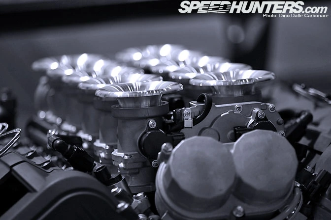

Look at any motorbike engine, and the ITB's are Mikuni and Kehin replacements. So thats all you are doing. Get a copy of Tunning For Speed, Phil irving.

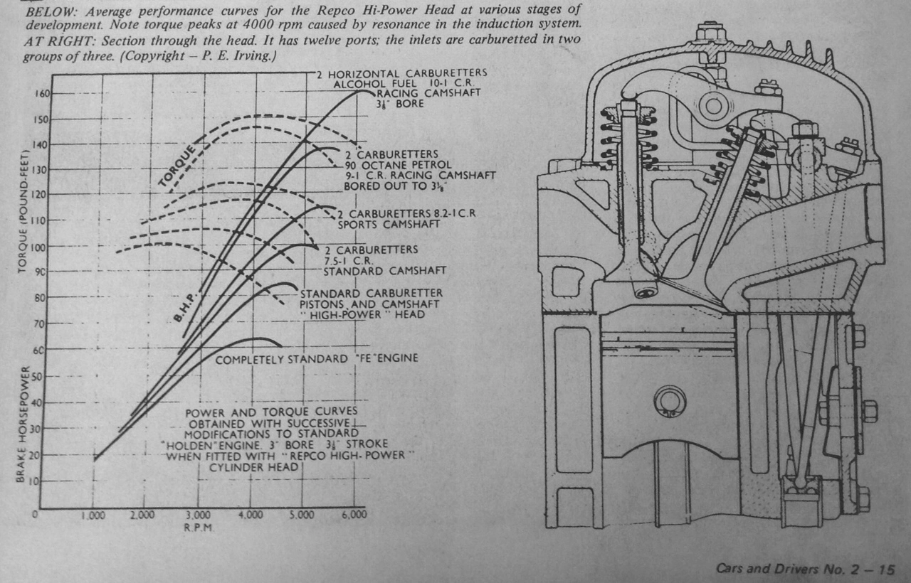

The only thing with canted valve in line six cylinder engines is you might loose mid range torque somewhere, like Phil E Irving did when he did some dyno work on his High Power head back in the late 50's. The solution in that case is to contain fuel stand off and you do that by adding or subtracting total intake runner volume from the head to the air inlet. But that is rare.

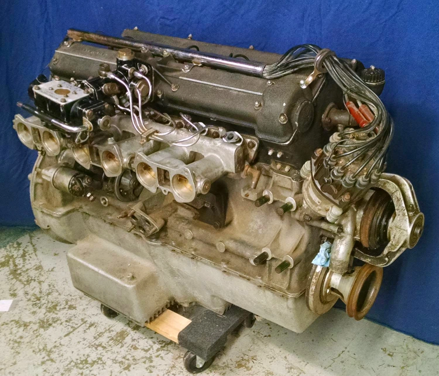

1. Maserati GTi 3500 (early versions had Weber DCOE42's, then went Lucas Mechanical Injection

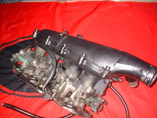

2. Triumph 2.5 PI / TR6, Lucas Mechanical Injection
View: https://www.youtube.com/watch?time_continue=22&v=89C9U54mvvA

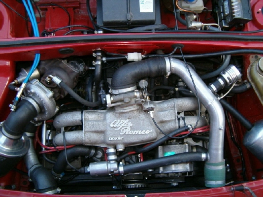

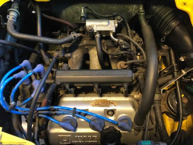

Alfa 33 1.7 16V isn't ITB, but looks like it.

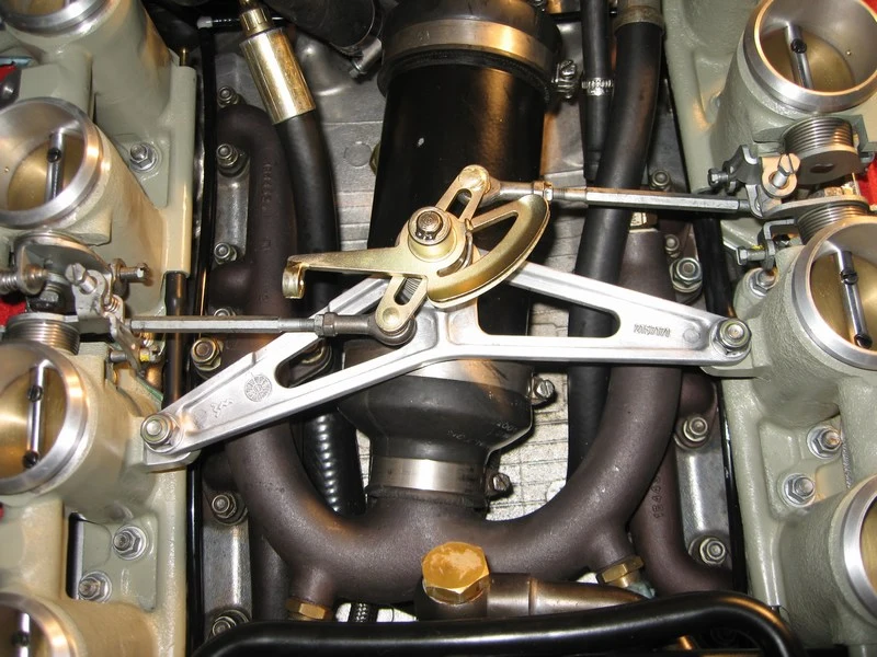

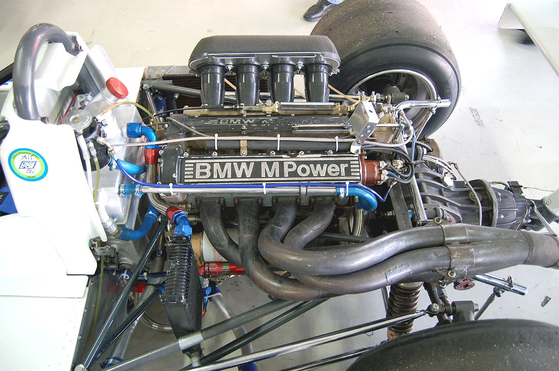

3. "Nearly" All M Power Engines (BMW CSL Group 2, F1 BT52, M1, BMW M88/S38, McLaren F1 with BMW V12)

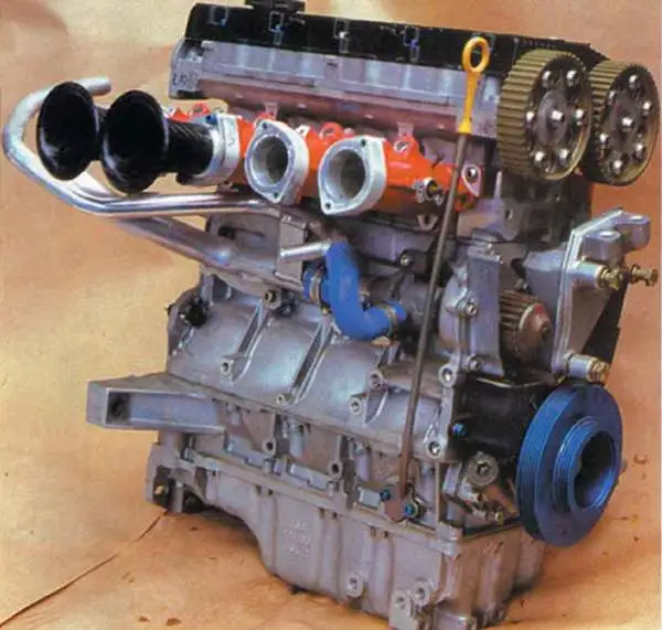

4. Rover / MG based K series Lotus 1.8 liter (Lotus Elise,Exige)

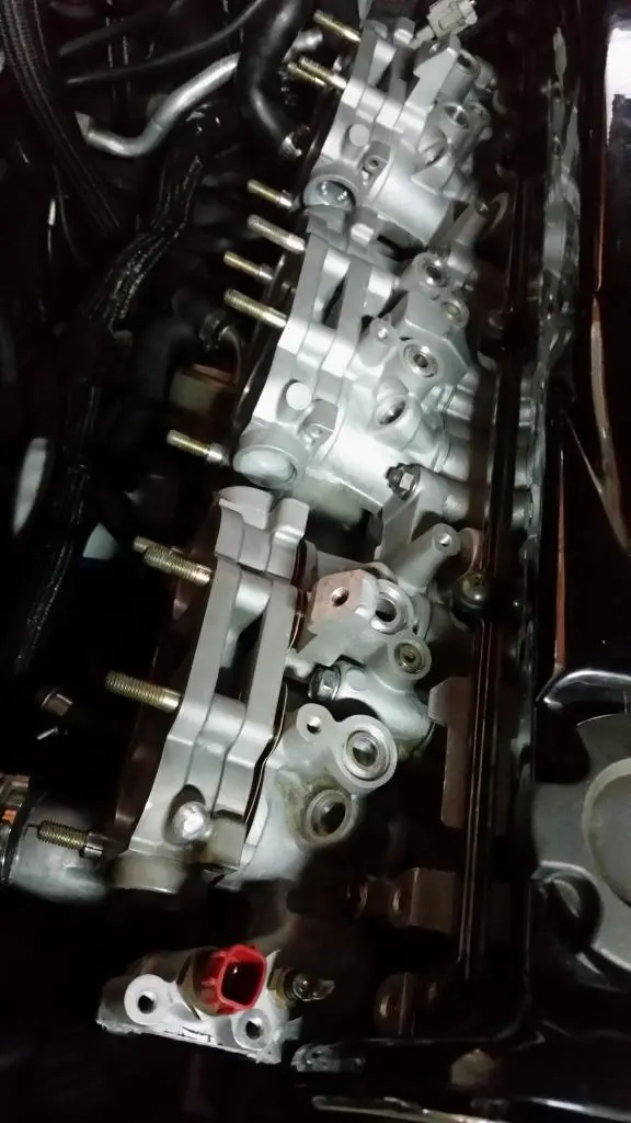

5. Nissan Pulsar GTI-R SR20DET Red Top
6. Some Nissan Skyline's ( GTR RB26DETT)
7. Ferrari F355 F129B/F129C

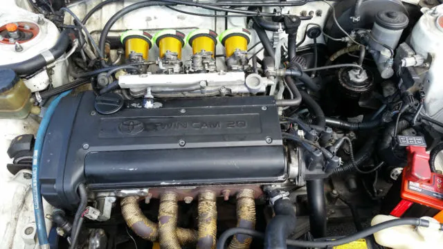

8. Toyota AE92 4AGE Blacktop 20V
9. Lexus LFA (Toyota 1LR-GUE V10 made by Yamaha)
10. Honda Beat with that 9,000 rpm screaming inline-3
11. Most 4 cylinder bikes now have ITBs

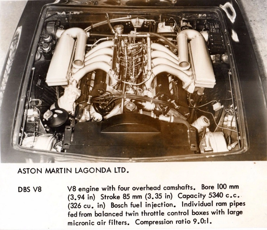

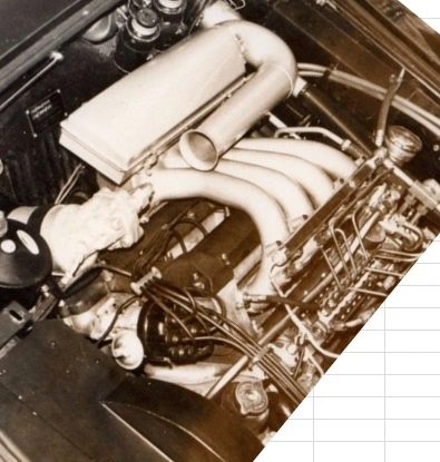

An upper runner could look a lot like the old Aston Martin DBS Bosch EFI system....before they ditched it for Quad DCNF Weber 44's.
but with the BMW ITB's mounted down low on the drivers side, and aGT40 style manifold gulping cool air from the other side
