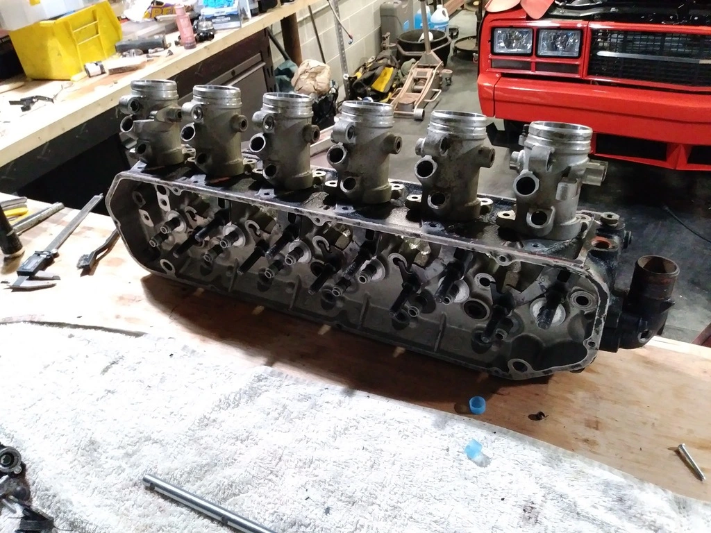

CarMichael Angelo said:
It''s a perfect world.
These are the gutted version of what came to me this afternoon. Main throttle shaft, linkage, throttle blade shafts, all removed. I'm gonna be able to do exactly what I wanted to do. The injector bosses will work, the main throttle shaft isn't hardened, so It can be cut and drilled. The upper hole was for an air injection system probably for EGR, but will become my vacuum ports.
What wont work as well is that there are only 3 bushings between the 6 throttle bodies. One on each end, and one in the middle. When I cut through that shaft to extend it between the throttle bodies, there wont be support between several of the inner units. Obviously wasn't a problem with the factory system,.. and it might not be an issue if I can get the sleeves that will go over the cut shaft to fit tightly enough,...but that'll be one more item that I have to get perfect, or the shaft will wobble.
A wobbly shaft might bind somewhere... and it would be bad to have a wobbly shaft. (I'm leaving myself wide open here)...
The other issue is that I can direct mount the throttle bodies,but how thick does the plate have to be to adequately transition from the 1.3" x 2" oval bottom of the throttle body to the round 1.625" opening at the port entrance....and given that there will be some of the round port on the head "cut off" on the top and bottom, am I better off going back to putting a tube between the head, and the throttle body to aid in that transition?. I really want to keep it simple and clean and just use a single plate.... I wonder if I can make this out of something other than metal?
I got the rod back this afternoon,....Put the piston on it, and stuffed it in the hole...Now the short block is assembled.
I got to figure out the TB dilemma and move forward..I don't really want to give up the integral injector mount boss that are built into the throttle bodies....................Decisions, decisions.

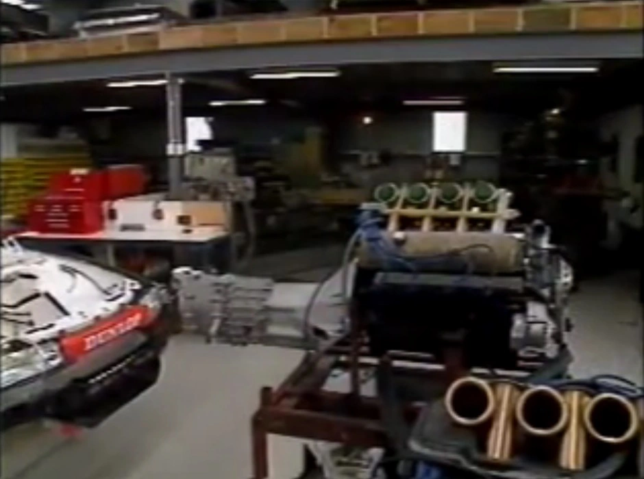

My horsepower idols are bluster free blokes who know the value of development. Jack Braham. Phil Irving. Larry Perkins

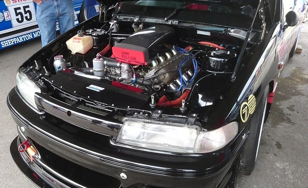

Larry Perkins went slide throttle, and about 550 hp with his 1993 Holden VP AVESCO racers.
View: https://www.youtube.com/watch?v=vk5n2LsH7G8
That was done with small port heads and a 5 liter block running to 7500 rpm, with power at 7000 rpm.

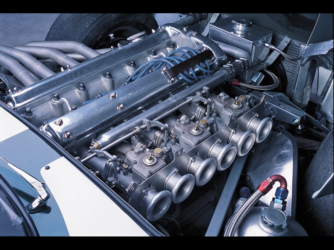

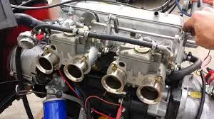

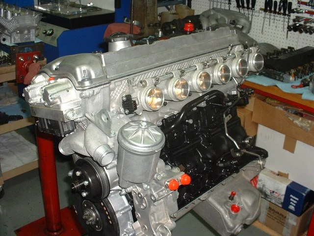

Forgetting all of the side draft webers ever installed:
like these:
or these:
Or the injected ITB versions like these from Ferrari:
or Jag:
or the actual culprits from the actual engine they were on....
This is for you @95BlueStallion ...hopefully you can visualize the concept now that I've posted a before and after pic of the same engine.

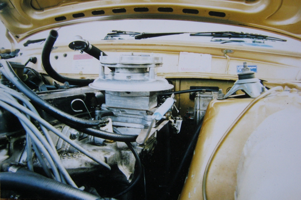

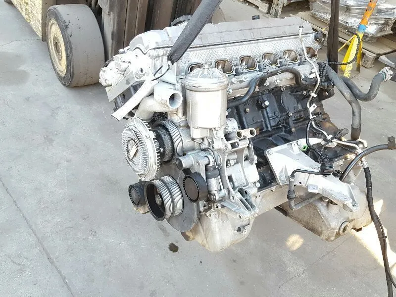

Everything has an Engineering Effect, but not all Effects are significant.
See the crazy mess my 4.1 liter engine was in the two pictures below.
Flitched up like Frankenstien, but it worked great, and made a poor 2-bbl to six intake port intake manifold work better than any other....
My 1984 Falcon used the same X-flow head as CMA's,
and I used 1/2" aluminum "anti reversion" spacer plates to cheap out on a 500 cfm 2-bbl Holley to the stock Weber ADM 34 2V intake manifold.
The intake runners held 35% of the engine volume,
1435 cc's or 87.5 cubic inches on a 250 in line six engine. The runner volumes though, heck, they varied from 12 inches (cylinders 6 and 1) to 3.5 inches (cylinders 3 and 4). Just adding half a dozen aluminum plates with just and extra 10.8 cc's per intake runner, added just 65 cc to the total runner volume, about 36.6%, or 1500 cc's.
It helped idle, mid range, top end, and that was on a log type intake. I also added a half inch spacer to the bottom of the 4412 Holley 2-bbl throttle body with a undevided intake runner, which added another 44 cc's to the intake manifold, for 1544 cc's total. 37.6% of the engines capacity.
Then I added another 4412 Holley adaptor under that, this time 3/4" deep, for another 66 cc. 1610 cc intake runner plenumb volume.39% of the engine.
Then I added a 1-1/4" plate on top of the Holley 2-bbl carb base, and made another 1-1/4" plate, for another 220 cc's.
1830 cc's or 44.6% of my 250 cubic inch engines capacity. All the time it fixed up and improved idle, mid range, and peak power.
Ford's standard EFI runner was about 13 inches long, and 2.3 liters, or 56% of the engine capacity.
The fact is, you can run any thing, and its what happens at the free entry point to the independent runners that governs the power peak and mid range torque.
International FIA Group 1 from 1966 to about 1990 (Group A or early SCAA Trans AM racing) allowed some intake changes, but the engine bay and hood had to remain the same as the stock homolgated 50, 250 or 5000 production cars. In 1987, Holden Australia found the same thing that David Vizard did in 1977 with Independent Runner carbs on Ford SOHC's and A series 1275 Mini and Austin Healy Sprites....a flate plate on top of the intake bell mouths and a metal box to surround them defined the minimum runner volume.
After running a 13" runner Twin Throttle Body engine from 242 to 288 hp on its prodcution Group A engines, it could go to 490 hp on the dyno as an un corked race engine, and 690 hp with a 395 cubic inch stoker under it. The downgraded Chevy LS-1 type intake manifolds still made 248 to 315 hp with even longer runners.
Its all about the Total Combination. You build the Total Combo, then test it untill you get the piece of crap to run. Then you keep optimising it. You don't optimise each individual component, and then end up with a Triumph of Enginnering over Design. "Build it and then he will come" is an invitation to horsepower, not just a Field of Dreams vision.
When Enzo Ferrari was busy making V12 alloy 1.5 and 2 liter engines, everyone else was sure Mr Smith was gonna be plowed under finacially. Hindsight is 20-20. Vision is invisable to some.

Look... (And please, don't take this the wrong way.).....I appreciate both of your thoughts here...But between you flooding me with indirect solutions to a direct potential issue,..and Joe waving the red " You're gonna hate that" flags....I'm now the guy caught in a revolving door.
Here is a fact: I don't wanna keep doing junk over.
#1. If there are negative reversion issues that'll come as a byproduct of attaching the TB's directly to the head, that's fine...but please,..Between the two of you will somebody tell me what they think about how BMW did it on their engine with success. I need to understand how so many examples of direct TB injection, and the scores of Webers carbs placed either directly over or beside the intake port didn't suffer from all of this calamity before I find it out the hard way.
#2. If I have to scrap my cutting board sandwich idea, and go back to a tube between the head then thats fine too, I really kinda wanted to orient them straight up in the first place...but that'll mean using a "j tube" to drop the runners under the row of ITB's and turning the tube 90 degrees into the port from there...in effect..ill have probably 12" of additional runner before the port entrance.
( it'll also mean that I'll have to weld up the injector bungs that'll now be on that plate bolted to the head)
Or...
#3. I can use a 90*, or 45* bend and turn a much shorter version up directly from the port..probably adding 2-3" of runner length.
Ideally it'd be great if I could make the tube transitions adjustable, and use silicone couplers so I could adjust the runners simply by removing or adding rubber. Then I can make stacks that are attached directly to the head, and to a plate attached to the bottom of the ITB's...and simply insert or remove whatever length of tubing is required until I get the engine to do what I want it to.
The problem with that is I don't have that much room between the head and the brake booster to be all that adjustable in reality.
Or....
#4. If the problem can be solved with a common air box placed on top of the row of ITB's mounted directly to the head,..( Cause that's the way it is on the BMW engine) then I can do that too...Solves the " What am I gonna do for an air cleaner"?, and "Do I really want the engine breathing all of this hot under hood air?" issues perfectly.

Won't a common air plenum take away from the aesthetic? In my mind I imagined 6 velocity stacks on the side of the engine, looked bitchin. (I guess those would be hard to filter)
I see alot of stacks come with some kind of replaceable mesh filter. They also sell foam prefilters that attatch over the mesh filter for daily use.
There are these little bug eye screens that sit on little short velocity stacks that is in my wish list on Amazon..
The look you are envisioning is the same look I'm going after....its been the same one I've wanted since I saw my very first set of Webers on a 289..and there are little foam pre filter socks that tie onto these.
And, yes, a plenum box will detract from that look..the ITB's become " tubes" ...I have that already.

Uneducated suggestion
Copy what bmw has and use the 'velocity stack' like pictured.
Damn the reversion.
