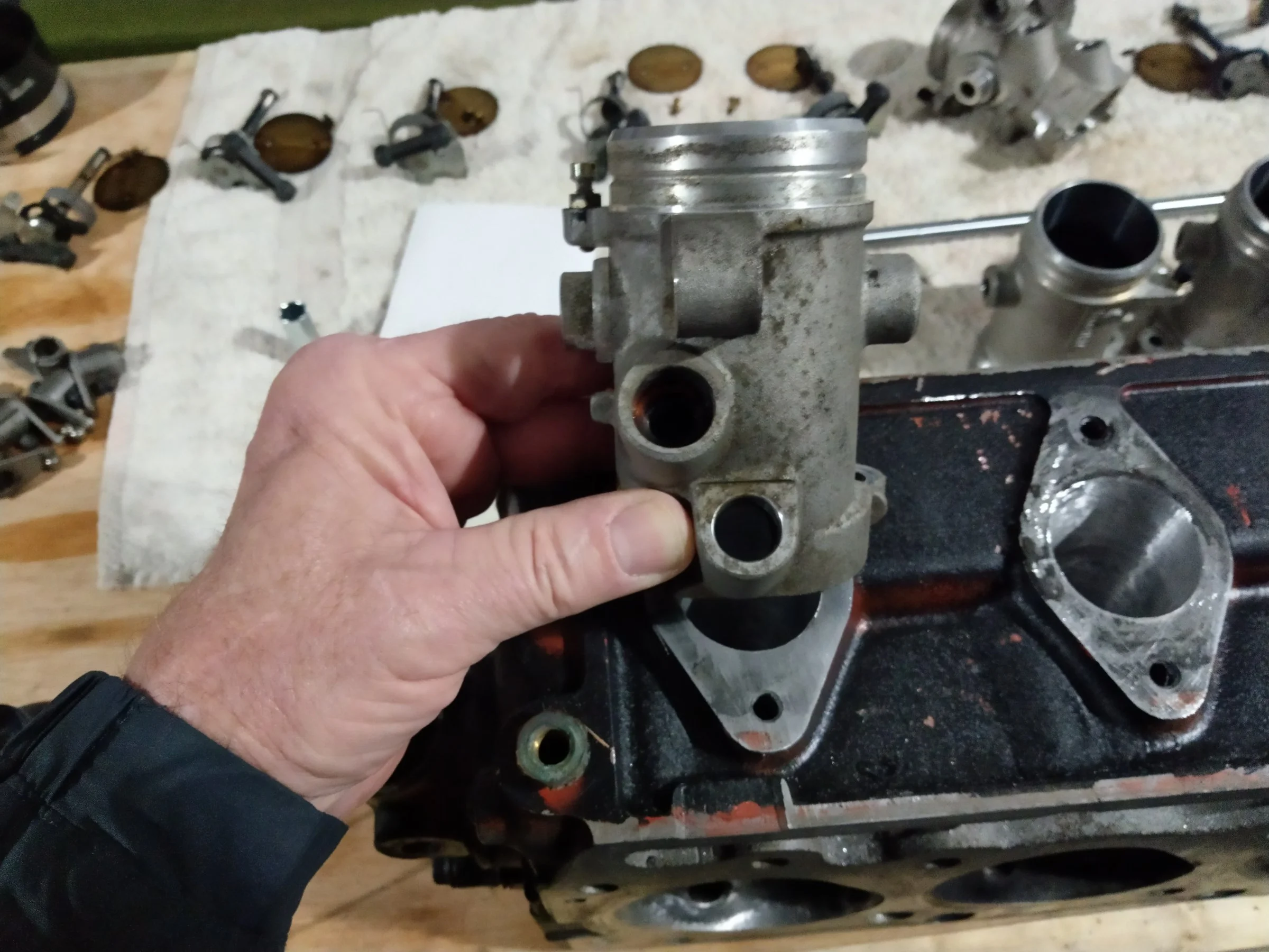

So,...my plan evolves..no longer intending to sandwich a transition plate between the two, I just ordered all of the steel to bend the throttle bodies up at a 60 degree angle....And then I'll flip the throttle bodies over and put the injector under them, as opposed to above.
When you do that look what happens:
The injector will spray dead in the middle of the port...
Sometimes the solution is right in front of my face.

That's going to look real nice, Mike !!! Seems like it'll work out better with the injector spray.
I like it already...
