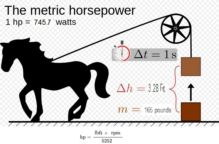

Working out peak torque is actually blQQdy hard, as power and torque are constant only when the wheel in the picture below is spining at 5252 rpm.
So 400 "CMA" Horsepower at 6000 rpm is 350 lb-ft at 6000 rpm.
Normally, peak toque is at peak volumetric efficency, down a factor 1.25 to 2.125 below the peak torque figure.
On a 1980-1982 255 Mustang 4.2 liter V8 or old 1969-1980 Ford 250 4.1, peak power was at 3400 rpm, and peak torque, 1600 rpm.
119 hp and 195 lb-ft or about 99 hp and 185 lb-ft, respectively. The difference between them was a 2-bbl verses 1-bbl carb.
On a Maserati 4200 GT, it has 385 hp at 7000 rpm and 333 lb-ft at 4500 rpm. The difference was 5 valves per cylinder, variable valve timing, resonant EFi intkae, and having a Ferrrari block to underpin it all.
As long as the CarMichael Angelo 250 ITB engine can do 5252 rpm, power in hp and torque in lb-ft, will always be equal at that speed. It is for all engines, all living things. Not every living thing can lift 165 pounds 3.3 feet in a second, so Hp and lb-ft is worked out by proportion.

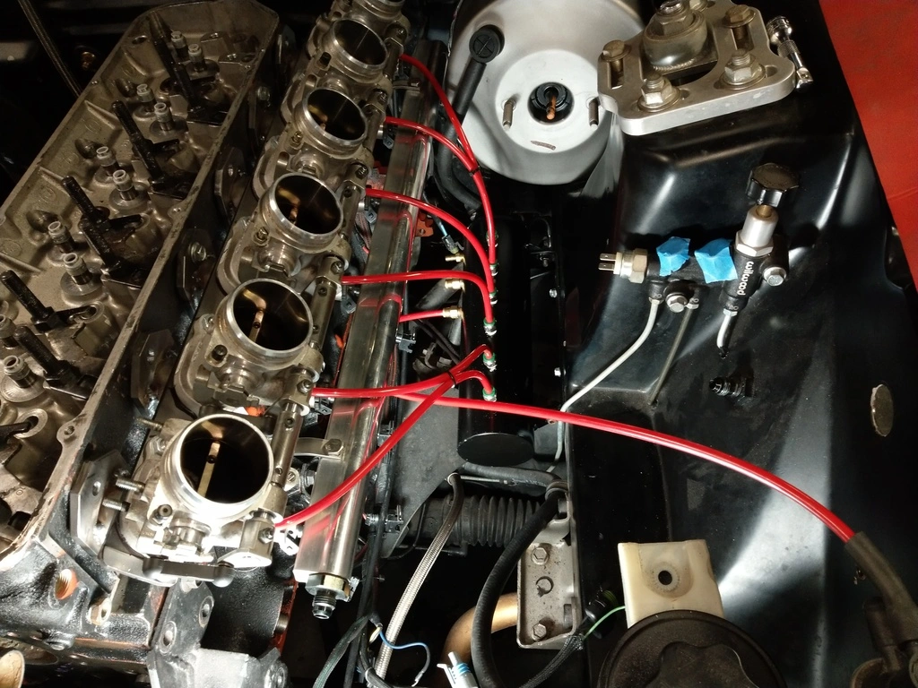

Well,...no more having to imagine.
one more thing to make somebody stop, scratch their head,....and say....."What am I looking at here?"
Now I get to say......
Well, what you're looking at is a US 250 out of a 1978 Maverick, with an Aluminum Crossflow head that I got off of a Falcon from Australia, That has 6 independent throttle bodies off of a 2003 BMW M3, That's attached to a 4 speed automatic trans from a 2003 Mustang that used to be computer controlled, but is no longer, all sitting in a car that used to be a 1978 Fairmont, that I've now cosmetically altered, and re-badged as it's late 60's Mercury cousin. The 7 red veins go to an external artificial lung so that the brakes and transmission will still function properly...
Got all that?
All of the turbo stuff is gone...The last of it went yesterday. Collin bought the water/meth system, but it has been lost in transit, and I'm having to track where it is along the way...The A2W Ic went first. The waste gates went separate from the turbo, and that went yesterday...all in all, I got about half of the original expense back.
I expect that the machine bill will be around 300.00, and that will be to transfer the rods, and resize, and weight match them. The other half of that for a new valve job after I get done hogging out the head.
I'm pretty sure that I'm gonna make a box that will sit on the TB's and feed them from one common 3" filter that I'll stick out the hole in the fender apron where the old throttle body used to get its air from. The 3 steel donuts will be here today that I'm gonna use as transition flares for the ITB's,...and that'll be the next thing that I'll focus on. I already have the idea in my head, and to a certain extent will cover up a lot of the iron lung, but I think I'll like it better than the 6 individual filters, and they'll get ram air from the front now that the intercooler is gone.
See the orange 90 degree coupler? Gone. That whole tube that travels from one side to the other is out of there. So,.when I stick that filter in the left front fender, I'll build a drop mouth to sit right there in that cavity to force frontal air into another box that the filter will sit in.
Vrooom,Vrooom, phcking vrooom.
I'm also gonna fix those ugly assed oil lines this time around too.

A roller cam 114 L/S w/ a 558 intake, and a 530 exhaust lift, and a 230/224 duration @.050 cam really likes an independent runner BMW M3 intake.
Since Mike's got almost 11:1 compression, it will run great.
Roller cammed, Independent Throttle Body in line Ford sixes aren't common, but they certainly come up with the goods.
Since Mikes got the best MegaSquirt engine mappers around to help him, it was an easy step.
An example of how hard it is to map an I6 like his....
Australian Jason Stoodley's automatic EFi Cortina with an iteration of Mikes kind of X flow six
View: https://www.youtube.com/watch?v=1W5y9m_mmpo
View: https://www.youtube.com/watch?v=Ic38oRfyJ_8
View: https://www.youtube.com/watch?v=4kUx_a7KCJs
View: https://www.youtube.com/watch?v=HyZ3i3SVAgY
Its the same thing over and over again. 297 flywheel to as much as 308 rwhp with just 265 cubic inches, 540 thou lift,
View: https://www.youtube.com/watch?v=54idNzU4Fpo
With Weber or Megasquirt EFI.
View: https://www.youtube.com/watch?v=9sWPzbfaIJQ
They later did the O2 Based AutoTune.They had it dialled in to the Ballpark Map with about 10 minutes work.
297 flywheel hp in just 10 minutes, 3 hp more than a stock E49 Six Pack 265.

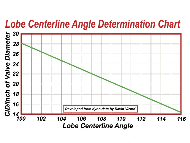

Oh, and stick with the 114. But get advice from Schnedier, and if that's what you want, it'll just hurt the idle, and not give you much extra torque.
Had a great discussion with Buddy Rawls on the horsepower per RPM thng that the Brabham's Buick 215 based F1 engine builder, Aussie Phil Irving used. Kiwi Bob Wallace at Lamborghini had the same philosphy, even with 375 hp at 8000 rpm from just a 239 cube V12.
Buddy said that his cams had dropped down to ratios like 3600 on some engines.
Buddy Rawls on Sep 11, 2011
https://fordsix.com/viewtopic.php?f=5&t=66242&p=508236#p508236
Your factored relationships are essentially an inlet capability versus displaced cylinder pumping volume ( CID and rpm) relationship.
You have established a criteria or fudge factor to address the actual port velocity issue (which is super important to the process), which is critical to the big picture.
One end of your spectrum is very restrictive motors ran at high rpms (extreme port velocities), the other end of the spectrum is very flow capable inlet inlets running at low rpms (slow port velocities).
I do not use multiple curves based on the level of modification, I go straight for the actual inlet and outlet parameters in comparison the displaced cylinder 'pumping' volume using a single set of equations, regardless of the build level.
Three quick examples, using your AI relationship, in my direct experience (camshaft customers) are
an FIA 289 build that mapped to a 4550 AI,
a 360 cid outlaw street car (nat asp) that mapped to around 3600 AI,
and a stock headed 125cc 289/302/E7 head on a 306 that ran around 5700 AI .
I have never used such a rating system, but it is cool to see how it fits in your criteria.
That wasn't an affirmation of my ideas, it was based on the desire to make a street engine map out to a 3600 Aspirations Index. Its existed with Phil Irving from his days with Vincent making V twin motorbike engines....not my idea.
250 cubic inches or so x 6000 rpm, all divided by 416.7 bhp at the flyheel would be a perfect low 3600. Just what a 14:1 compression ratio NASCAR does with its Apriations index. 355 cubes * 8000 rpm/ divided by 790 hp is 3600 or so.
You won't get a it with a 106 or even 109 Lobe Separation angle. An ITB is a hard set up to master, and when the Charger E49 and the racing XU1 Torana GTR 202 got the same Webers as the Charger, they all got low lift, narrow lobe seperation cams with lot s and lots of duration. If they'd gone back on duration, up in lift, and wider in lobe split, then they would have made a lot more extra power. Pretty soon, the best cams were aftermarket cams with less 50 thou duration, more peak lift, and wider lobes. Same thing happened with the late Ivan Tighes XK Six cylinder camshafts.
The ages old Vizard recomended cam lobe center angles.....they work on some engines, but not on an overscavanging, over exhausted, very low air speed intake ITB in line six.
A 42 cubic inch cylinder, and 1.84" intake valve plots a 23 or so, and 106 LSA on the green line of the graph. Your welcome to use the half century of Schnieder cam grainding experience to grind a cam to a 106 lobe.
https://fordsix.com/viewtopic.php?f=5&t=63620&p=512487#p512487
