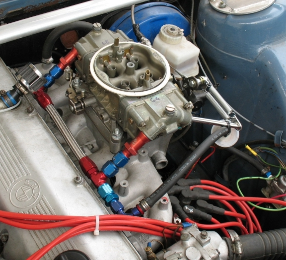

I've never seen a BMW M three bog.
Understood about the BMW. Just remember that the BMW has a DOHC head. Your push rod engine has a much smaller port cross section and much smaller intake valve curtain area. I'm not here to go round and round with you Mike, I really respect what you do and have always enjoyed your posts. I know you are going to build it I'm sure it will run, I'm just pointing out my concerns.

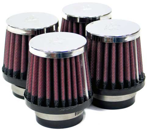

Ok then,...learning about what kind of CFM is required to support a certain horsepower goal.
A 250 c.i. Engine that will service 6000 RPM only needs 250 CFM to make 300 WHP.
The next hurdle to clear is how restrictive one of the little filters are, or conversely, how much CFM each one of them will pass.
250/6= 42 CFM....Each throttle body only needs to flow 42 CFM to support that power...
These four filters together will flow 600 CFM.....
Obviously, ill need 6 of the things, but at 164 CFM each...together they'll flow more than enough to go way beyond the horsepower that this engine will ever see.
But,...it's a commitment...6 of these things wil be over 200 bucks...If I go this route, it's over,..I'm not building anything else to filter/provide air to the TB's..
As much of an effort it will be to build the box.....with, or without a clear cover..putting six little hats like these on the TB's solve several issues...and save a butt load of work..in the end, 200.00 will be well worth it in contrast.

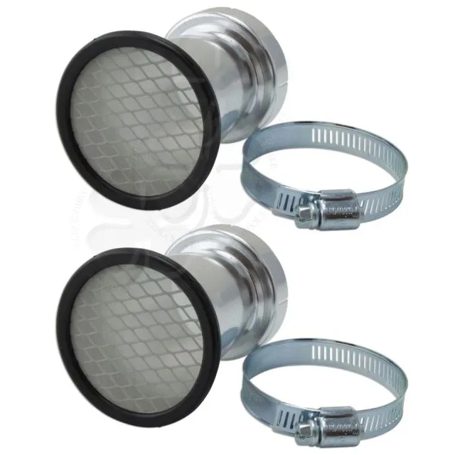

So now that you know you only need to flow 40-something CFM per TB, do you think these cooler looking velocity stacks would be suffient? You pop the filters off the end at the car show, and they look quite a bit better than those conical filters. Suppose the supplier has flow tested them?
Oh I'm thinking that the v stacks will probably flow that much air minimally...but in the long run, I'd be relying on a screen instead of a filter to clean the incoming air.
And when you look up close, you can see the large step that they make to create the clamp flange....I'm pretty sure that it necks down much smaller than the actual throttle bore diameter.
The red filters won't look as good admittedly....but they'll do a much better job of keeping crap out of the engine w/o plugging up. Have you seen how cars turn green in the spring down here?...that dust floats in the air for about a month......

I used those on my Diesel LD28 Falcon sedan. One filter flows enough to liberate 91 seat frame bending horsepower for a 2.8 liter Nissan engine.
6 x 91 = 546 hp.

Three Cow Bells like the one providing air flow to this 390 cfm 4-bbl in a 24 Oz would do nicely.
You can see why BMW and Nissan slanted the engine...brake booster clearance.
