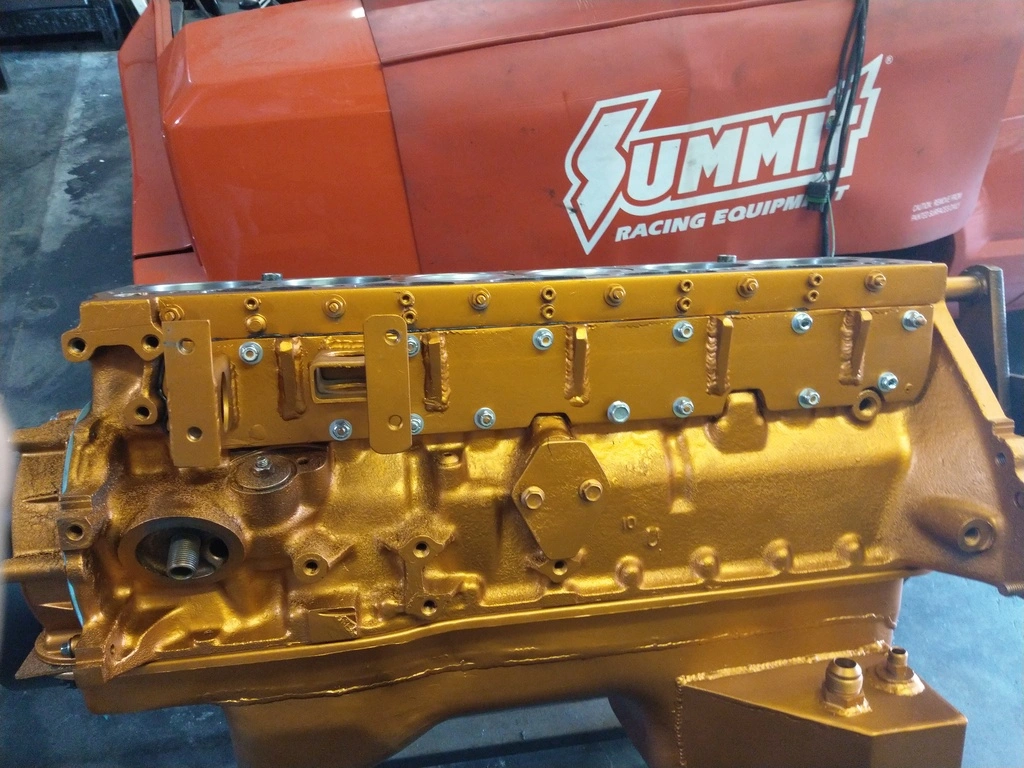

I started off this morning by sealing the side of the engine. As many ties as I've had this plate off, I finally think I've gotit down to a science.

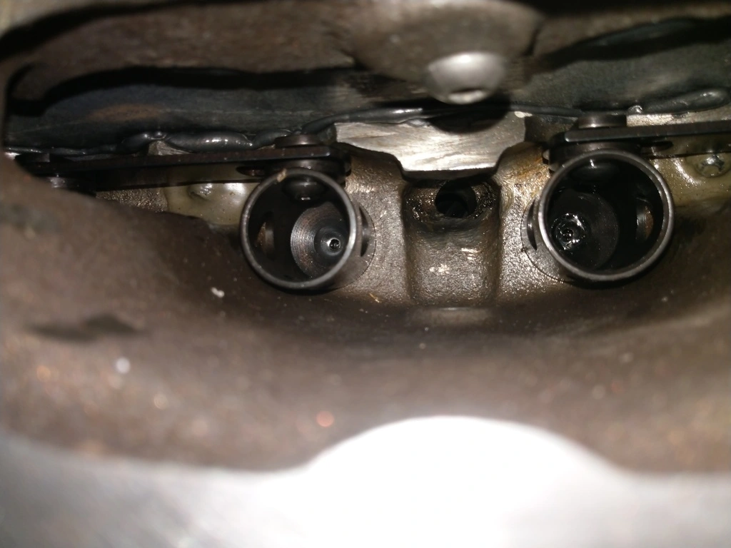

Even if I had the plate sealed properly, the studs would seep. Not any more though. I'm using nylock lock nuts to serve as gaskets to keep the oil form seeping out. I learned that I needed to set a really thick bead, and put that plate on there loose, and let it sit long enough to skin over. Then, when I tighten it down, the stuff doesn't ooze all over the place.
Just a neat little blob barely oozin' into the lifter galley.

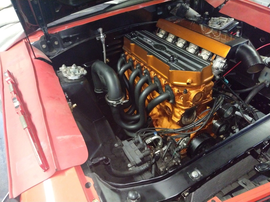

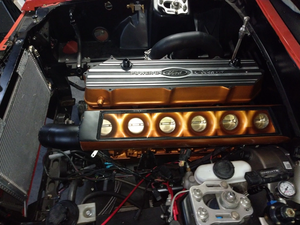

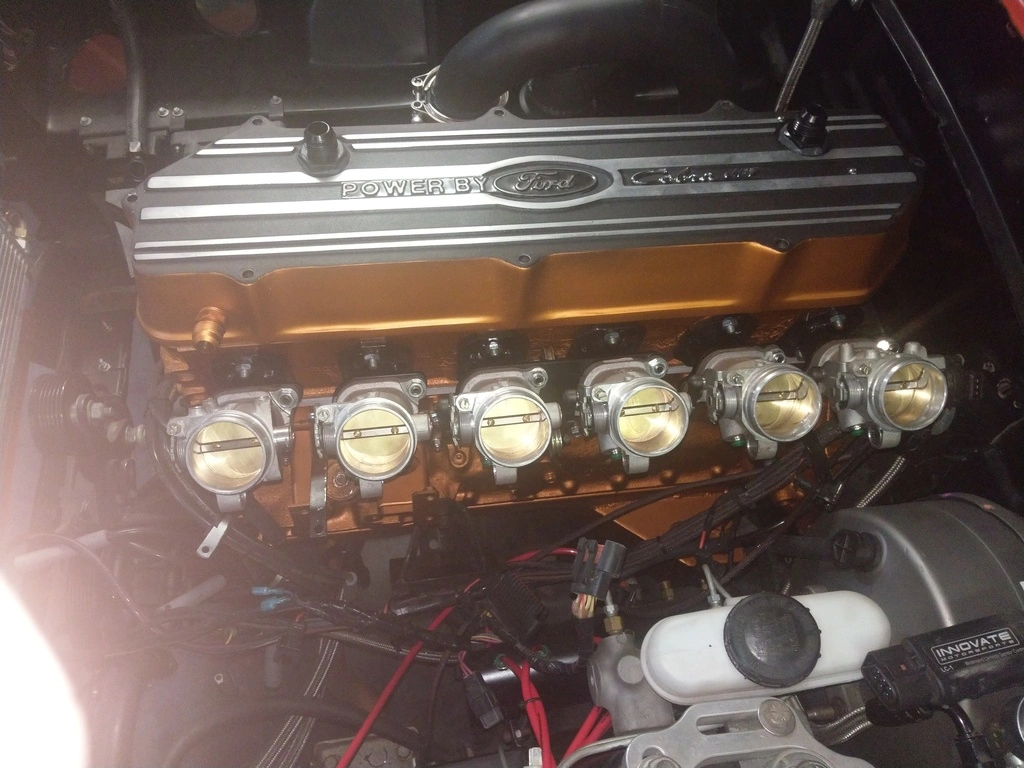

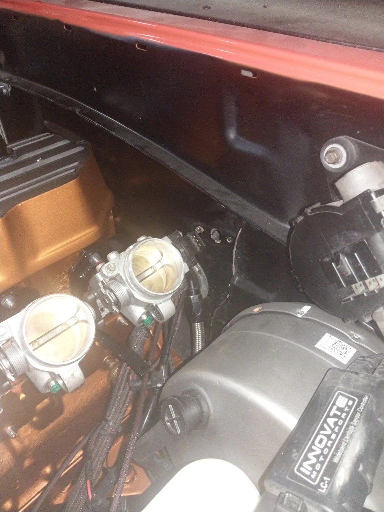

I need a couple of days to get it ready to run. The following pictures are mock up's.
I don't know what I'm gonna do about the throttle cable....It runs right into the the TPS sensor...Maybe drop the thing down an inch..
The head is on and torqued, but that is the only thing in these pictures that is complete. The headers are hanging by 4 bolts, the throttle bodies have just one nut holding them on. The airbox is just sitting there...The valves aren't adjusted, none of the hoses are ran, and that in of itself is a pretty significant undertaking.. the trans lines are just dangling, and the oil hoses have to be re-routed. Now that I shouldn't have blow-by out the ass, I should be able to put the breathers back on the valve cover directly, but now I have these -12 nipples glued in place....Another thing that I'll have to adapt. .If I was off tomorrow (my normal day off) I'd have the thing to about 90%......But I'm not off tomorrow.
I hope that is bulletproof glass; if it isn't the first backfire that breaks the glass will cause all the glass shards to be sucked into the engine.
Otherwise, it looks really nice. :nice:

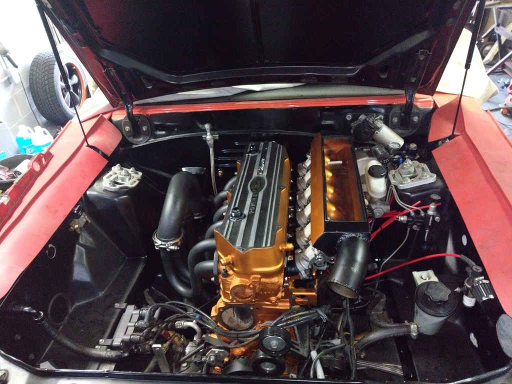

While i was recuperating in the shower after the last update, im thinkin' that im gonna shelve the ITB plan for now. Im tired of having to change stuff around. The mock up was a reality check of sorts. not only will i have to relocate the throttle linkage (leaving a hole in the firewall where the existing location is), but there's the linkage, the vacuum issue, the IAT,..tuning,...blah..blah, blah.....
i could put the old intake on there, and bolt the 70mm TB on the thing, and be soo much further along to running, (normally) it'd be night, and day.
As long as this particular re-do has taken, I'm none too eager to continue to keep throwing another obstacle in the path...
I'm not gonna throw the ITB idea away,....I'll just put it on the back burner...

It's because placing the ITB's on the transition elbows is a giant PITA. All 6 of them have to be placed on the manifold at the same time, because you cannot get the shaft through each throttle body if they're bolted on individually. It hits the radiator saddle. Trying to put the shaft through the throttle bodies while each one has RTV slathered on their bases, then moving the whole wonky contraption over to the manifold, and trying to set each one on the studs is just a big giant hassle.
The bigger issue is the interference. The TPS sensor is all over throttle cable, The bulkhead where all of the wiring exits is there, the fuel fitting is there,..... it's just a giant jug fck.
Lastly,....even after all of that is dealt with.. there's the "will it run right?", and what am I gonna have to do to get it there. There are 6 throttle screws..No common vacuum plenum, leaves me wondering if it'll run speed density, or whether it'll have to be converted to Alpha N...
And I know so little about Speed density as it is...Alpha N is like a carburetor only with separate injectors...
Add some Cell phone plastic mylar sheet to keep it intact and clean.
Alpha N and speed density, its all just gravey.....as long as the average throttle postion is right witin a few degrees, it'll idle ITB just fine.
